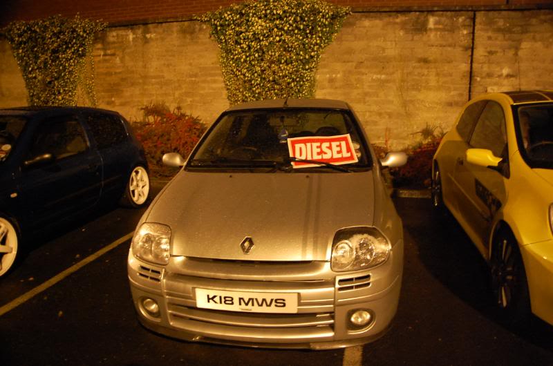

This one used to sound like that - we found a sign for it :rasp:
Turned out to be his belt pulley's IIRC
