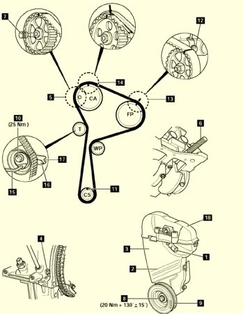

hmmm, i did an old clio 1.2 petrol myself a year or so back.....i cant see the DCi being much harder? might just do it myself....
Depending whereabouts you are I can lend you the 2 locking pins you need for the K9K. Crank has a pin aswell as the cam - the pump doesn't have a pin, just has a mark on the pin & a mark on the belt. I'd say doing a straight belt change is as easy as a 1.2, but doing the water pump means you've gotta take the diesel pump pulley off aswell as the inner plastic cover.
This might help.
