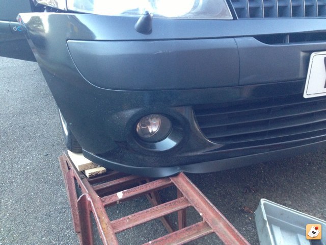

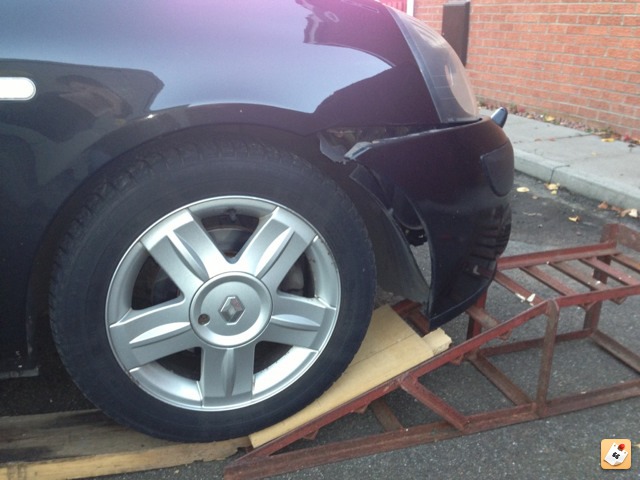

Wood slipped from between the wheels and ramps and the car fell onto the bumper.
Just about ripped the whole bumper off! Needless to say, I think I'll be investing in a set of lower ramps...

Luckily I managed to jack the car up and pull the ramps away. Bumper just clipped back in place, gutted about the marks it's left on my brand new splitter though! Even if it was only 20 quid

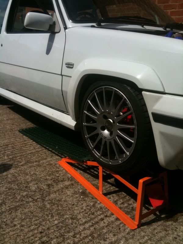

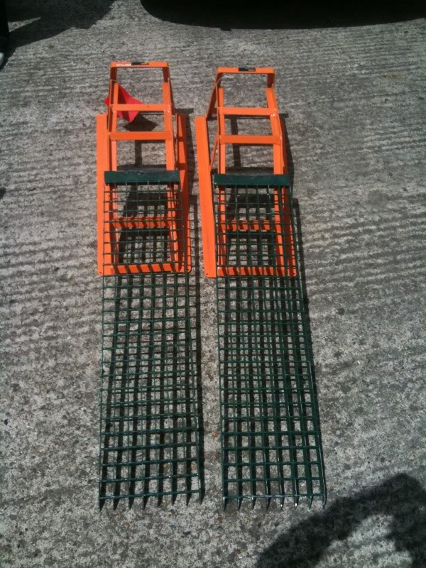

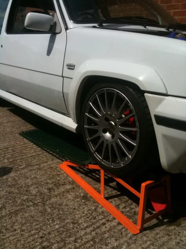

I always found ramps a pain kept slipping when I was reversing up and could not get the front of the car on them because of the angle, so I made some extensions at work that bolt to the ramps so they do not slip and makes the angle nice and shallow now so no issue with clearance.

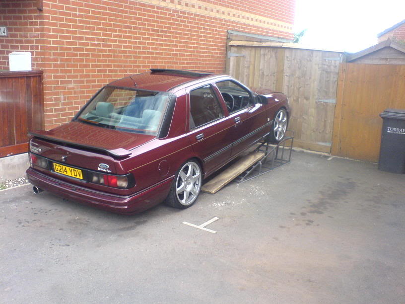

My dad made me these years ago but still couldn't get my old car up them without scaffold planks. We're nice and high tho.

Handy size, just as well considering you have to fix something every other time its out.

Ah that's not good always dodgy to use those ramps,That cossie is gorgeous i love old school ford's
