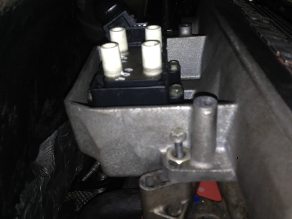

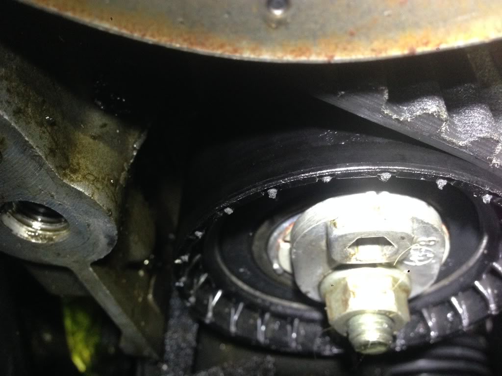

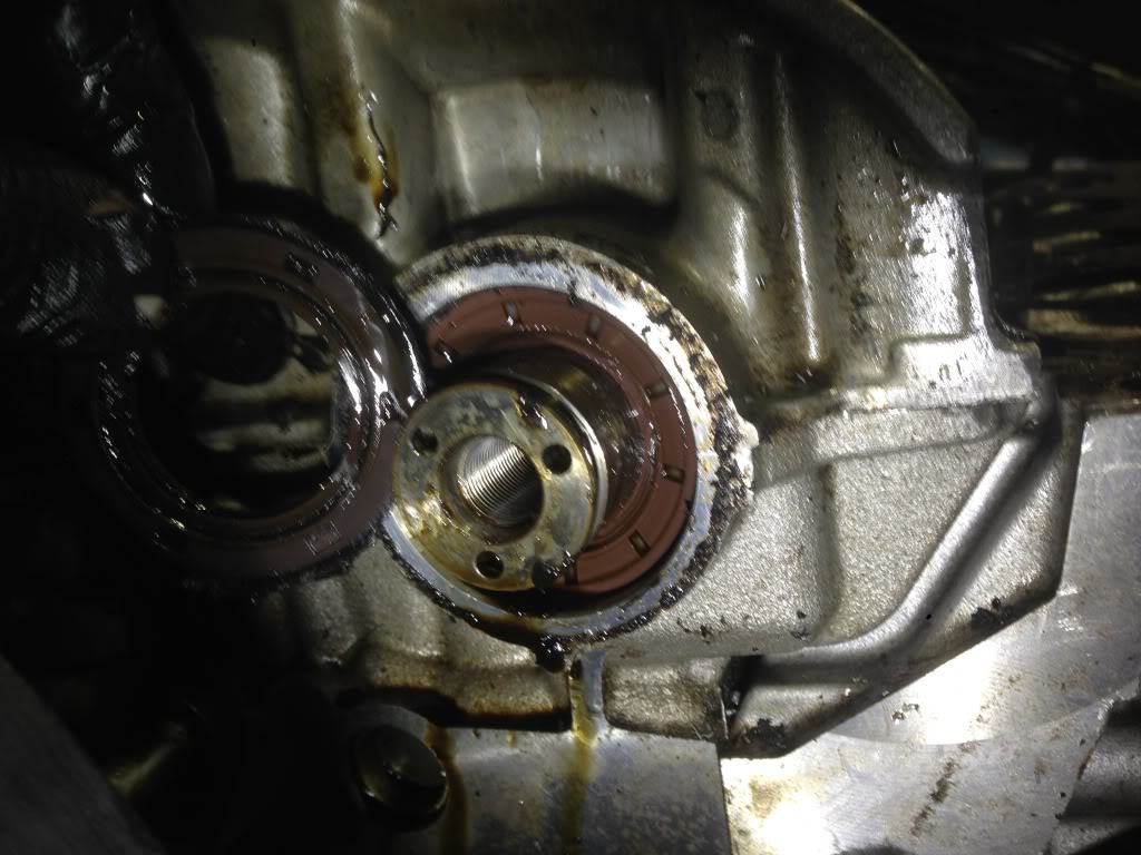

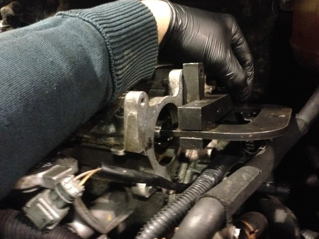

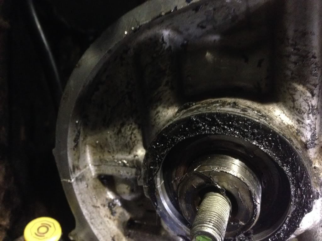

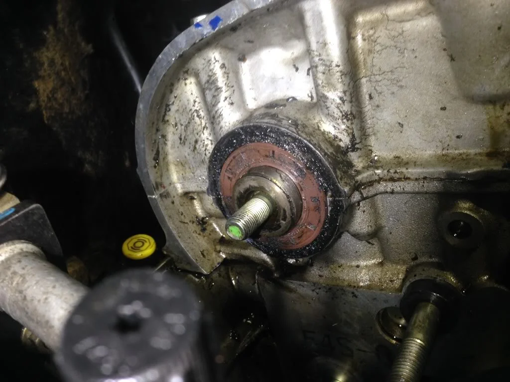

Yeh, I certainly found some interesting things..
Random bolt used on the inlet(I hadn't even undone this.)
Cam timing out as suspected.
Cam belt tension off the scale
4 camshaft oil seals?!
