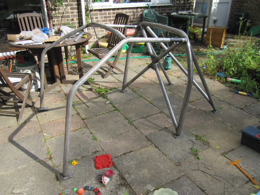

What model is it? Mine was a bolt in, so came in 2 parts pre-welded. The front and rear section are bolted together with a sleeve and plates welded on the floor to bolt through.
The platforms on mine are about 4" high so you might be able to get in there with the welder...
Here is what mine looked like, you can see how the 2 sections are joined.
