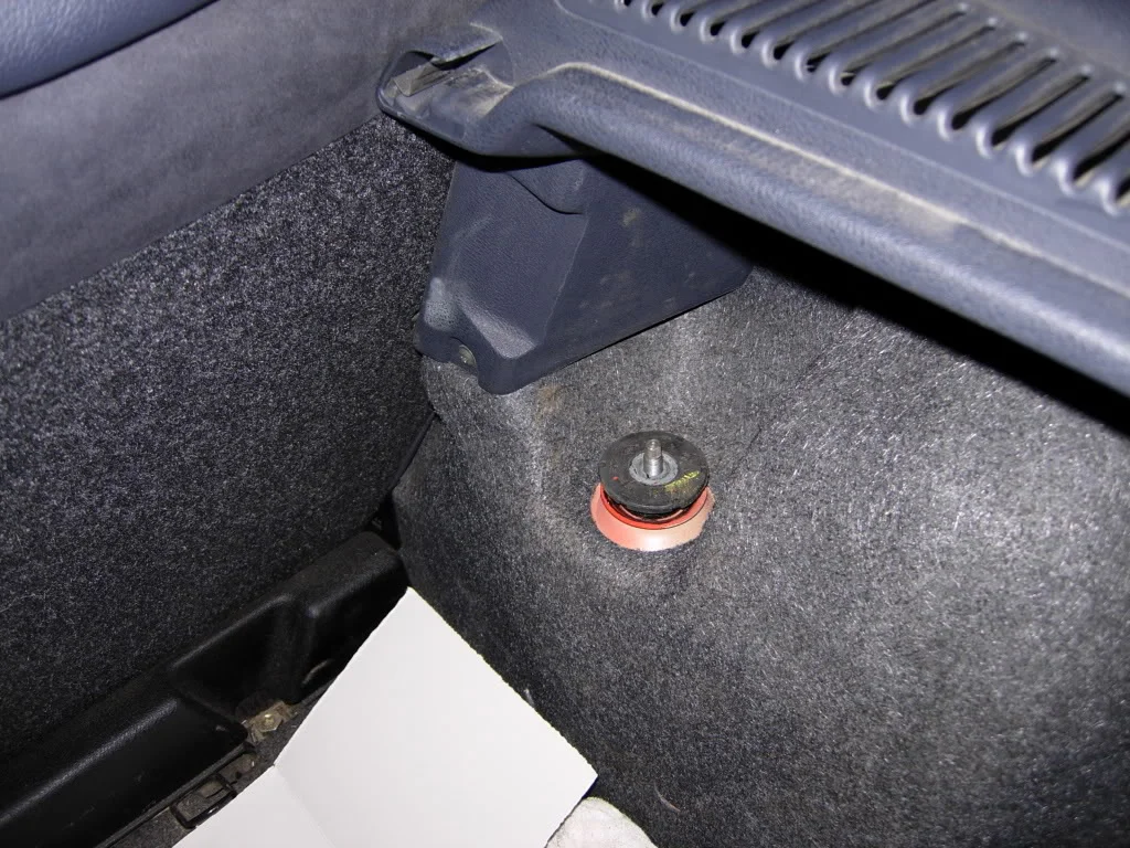

If some one could let me know the quickest and easiest way to drop the rear axle I'd really appreciate it.
  S4 Avant
These two?

Well you could, but the ones the other end of the dampers connected to the rear axcel would be far easier.
  BG 182 FF
Sound a silly thing to say m8y but make sure you have a trolley jack supporting the axle and lower it down with that or else you may damage the rear calipers and discs etc etc :) they are 18mm bolts btw that hold the damper and axle together :) saves fafing about for the right socket

The bottom bolts that connect to the shocks are seized solid, so I'm going for the top bolt approach
  340i
The bottom bolts will come off Dave...
Just use a breaker bar, get some leverage... Will be alot easier than undoing the top nuts!!!

How come it's harder to do it through taking the top nuts off?

you need 2 people ideally if you remove the top nut, it is more tricky to put back together

Top bolts removed, axle dropped, springs fallen out, shocks splayed all over the fecking place.
....but exhaust on :approve:
  S4 Avant
All back together, springs back in, shocks bolted down, just got to stick the decat on, and seal the system with halfords finest fire gum
