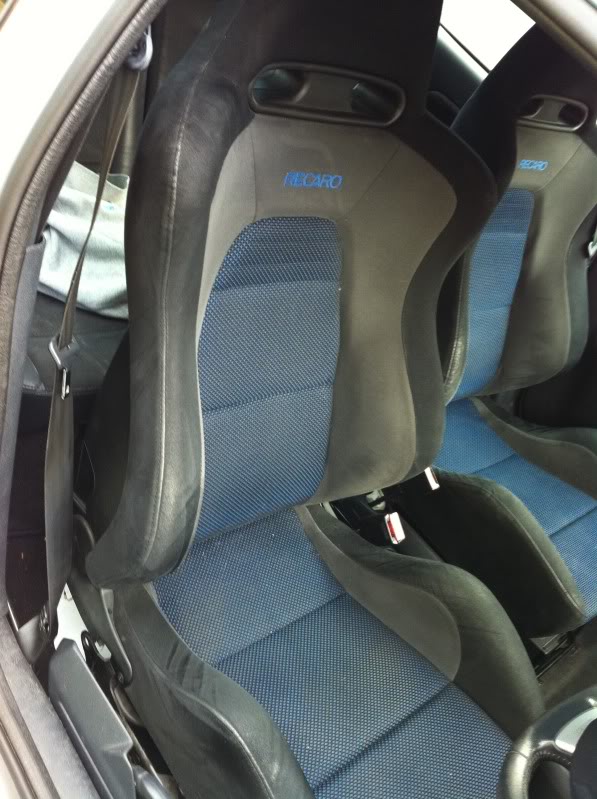

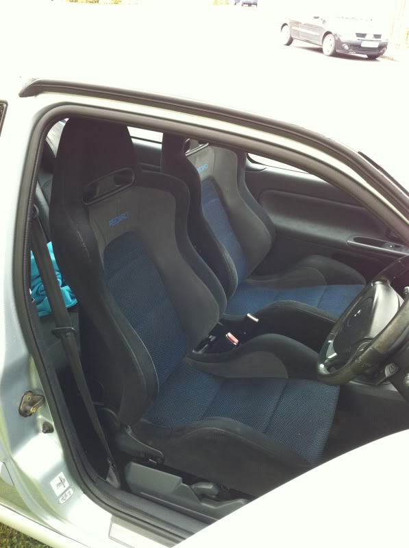

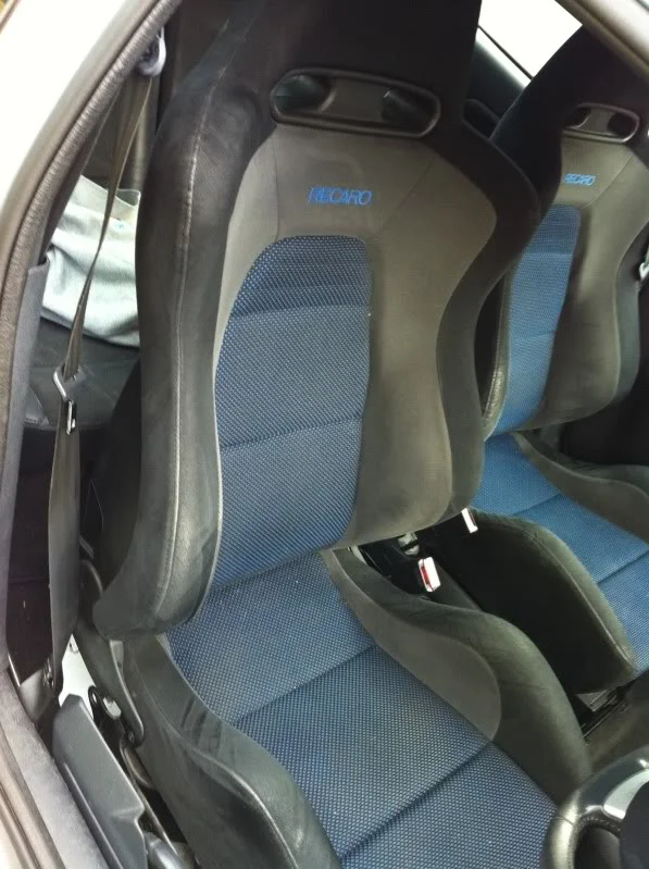

Im breaking my evo 6 and still have the front seats and was thinking about fitting them in my clio.
Iv seen a few pics of evo seats fitted to clios and wanted to know what is need to fit them.
