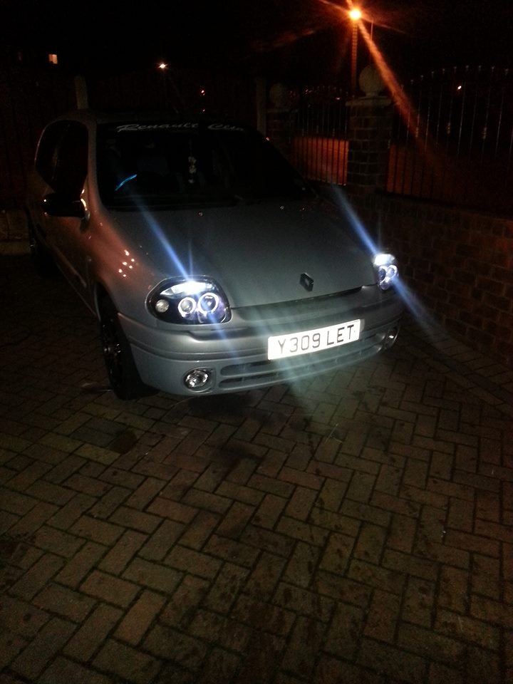

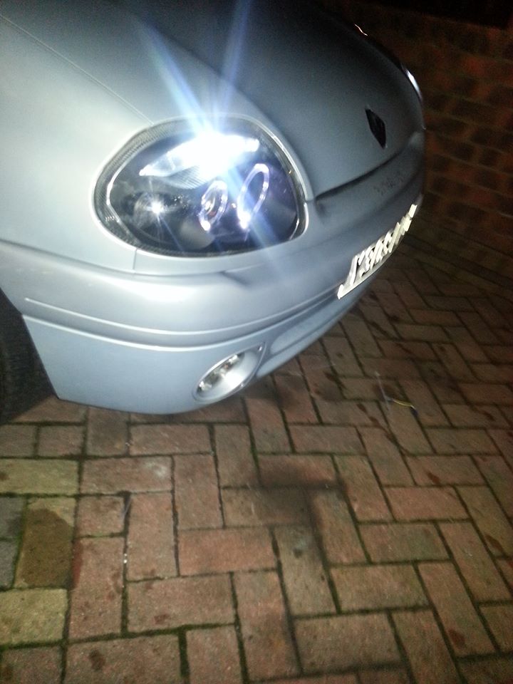

thanks guys, i just painted them over normal for now , be getting 172 front end at some point so i couldn't be bothered to mess around too much

looks rubbish in dark but its done and on at the front :D
