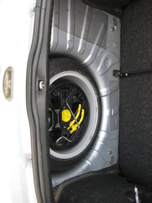

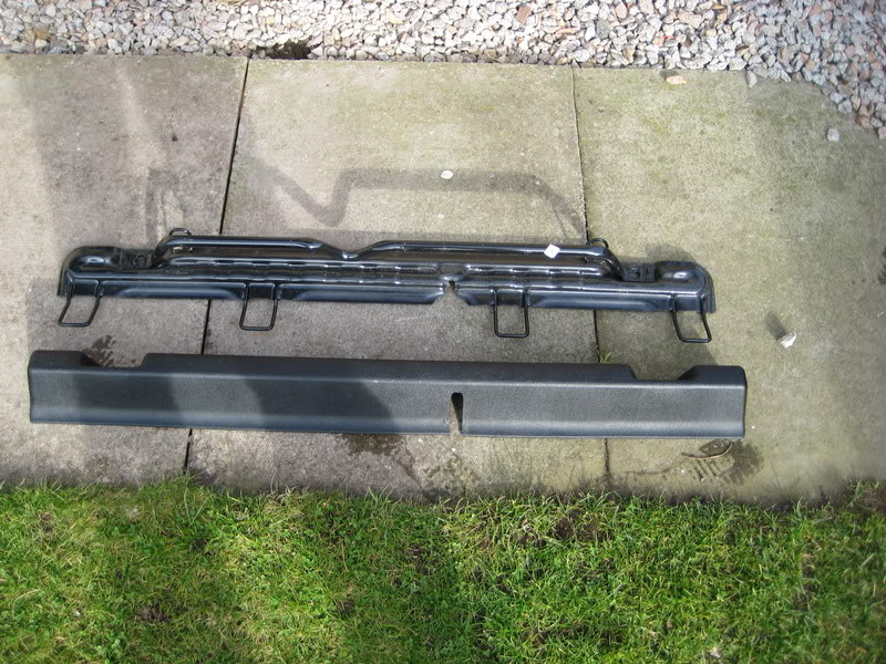

Thats the bar out :)
The bolts were quite tight, but i just slackened them a bit then tightened again abit then slackened them a bit and they freed off. Then i screwed the bolts back in with a bit of grease to plug the holes in the floor they came out of ;)
I couldn't be arsed lying under car spraying them with WD 40 where they come through floor, the worst that would have happened is they'd snap and plug the hole.
That would cause no issues neither as i have no intention of refitiing the bar, as i have no child seats etc to attach to it.
The only thing now is the boot carpet is a bit short now :(
So i put the ISOFIX bars plastic cover back in boot where bar was to hide the floor where carpet runs short.
