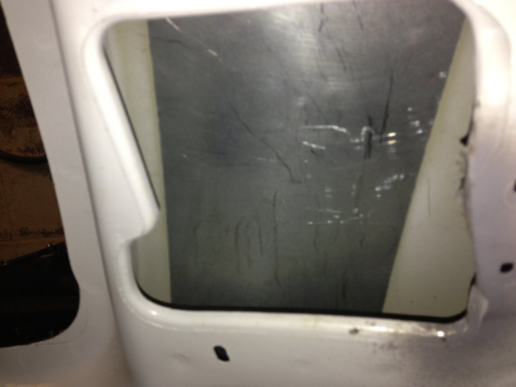

How to remove the tar in the offside C Pillar?!
len_beach
  E92 M3,172 track car
I know it's only one piece but I've started now and leaving it half done would do my t!ts in!
It's the one above the fuel filler which is much more hidden. Any tips or special tools?
Fill the void with scrunched up newspaper otherwise bits of the sound deadening will get stuck in the void. I just heated it with a heat gun and then used a wood chisel :)
len_beach
Cheers James. I thought about heating the outside of the panel too.
So you just used a wood chisel and cut your hands to pieces? ;)
Haha no I managed okay from memory but didn't use the news paper so lost it down the void and took over an hour to fish it out lol!
len_beach
Have you trimmed part of the panel there? It looks like you have more access than mine.

i did the one on the roof, and started the ones on either side of the car in the rear qtrs the other day.
all comes off quite easily if you have a decent heat gun and a decorating scraper.
