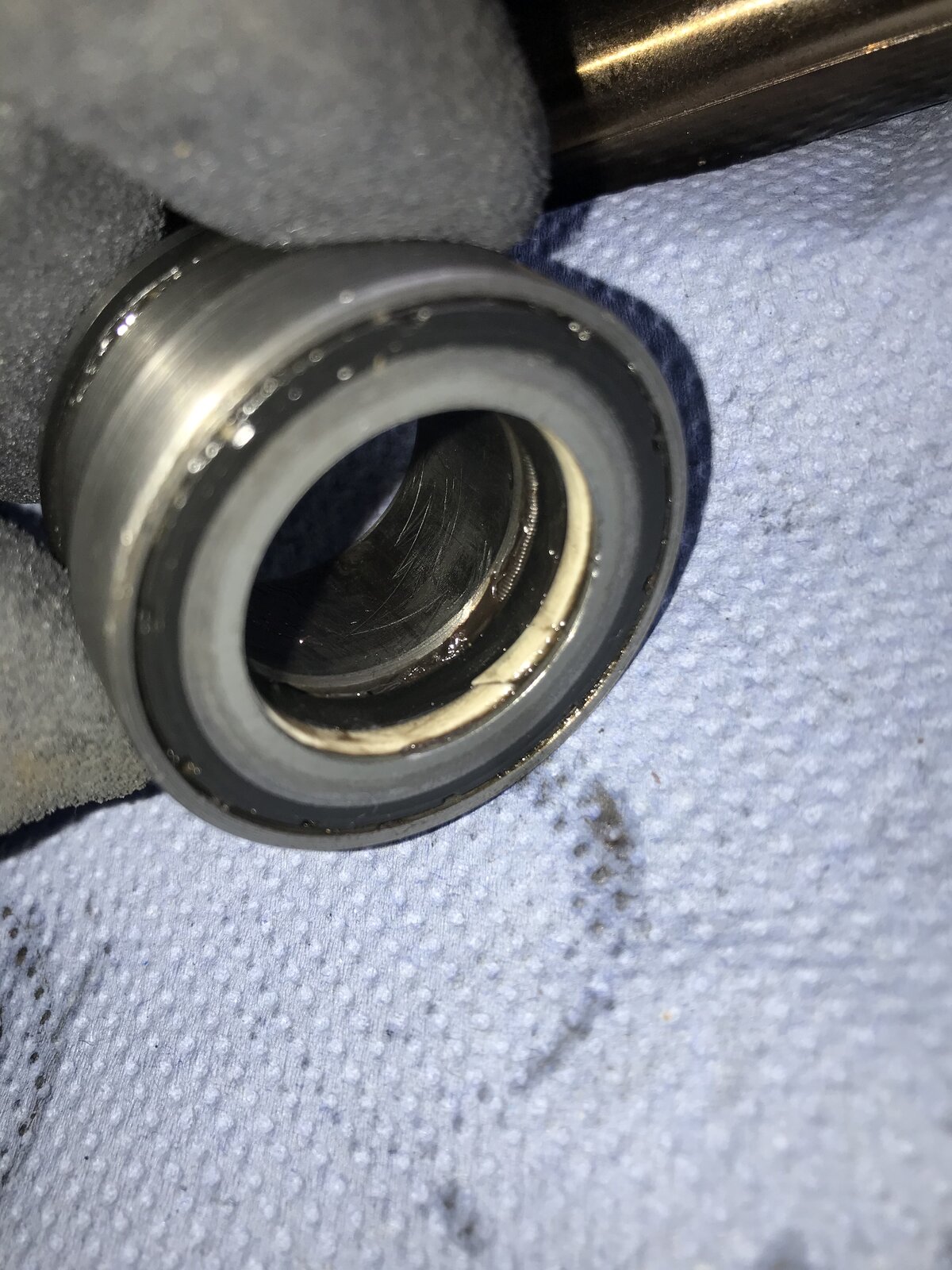

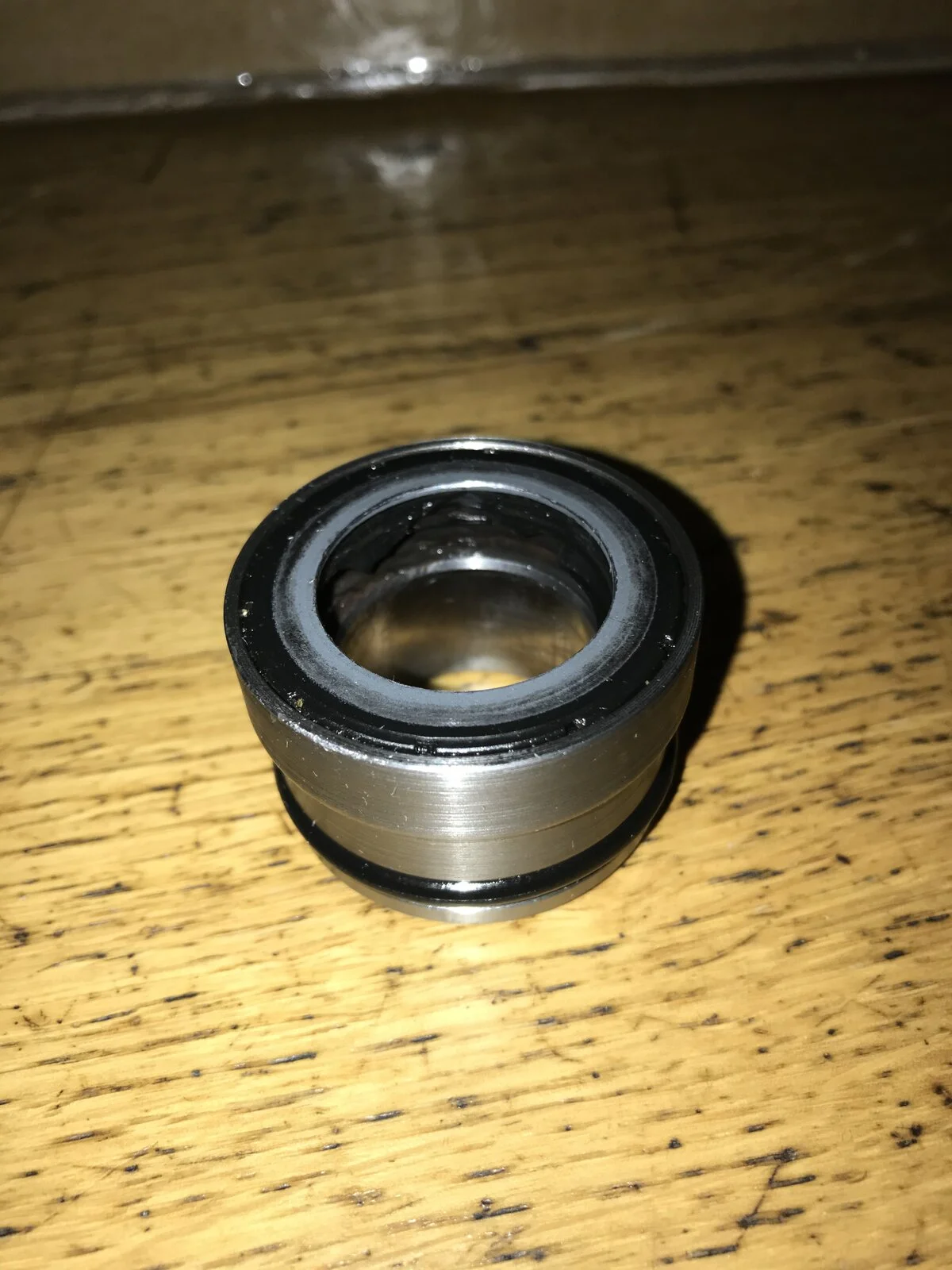

The seal inside this cylinder, does the cap come off? Because the seal is just being torn slightly and not budging
Yes I watched his to take it apart. The picture wasn’t so clear here is another. The black ring is just metal, looks like an oring I know
Well the seal inside seems to be joined to the metal end cap thing with the black ring. Nothing moves though, the rack only touches the seals and white seals but mine got a bit chewed up and developed play. Im worried of doing any damage so dont want to try whacking things out

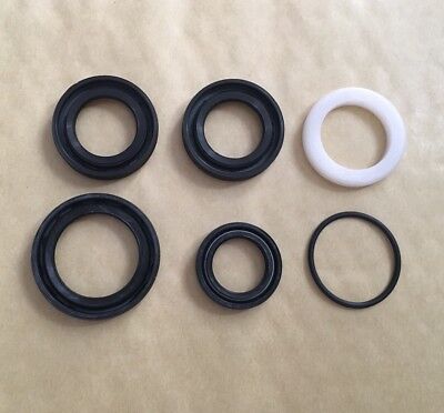

These are all the parts that's in Ilyas build of my quick rack... Dunno if that helps in any way.. maybe easier to replace that bearing than mess about trying to repair it..
Sent from my SM-G977B using Tapatalk
@Eddie555 Thanks mate, this is actually the brt rack I have, Ive been on contact with them and these seals seemed to be the culprit but I dont know now if they are meant to be replaced or the rebuild seals I bought actually includes them.

The black ring is in fact the seal, its 'infused' to the metal cap. What I dont understand is the hydraulic quick rack I had, it leaked out of the same place. Implying these old seals could be 150000 miles old are re used..
