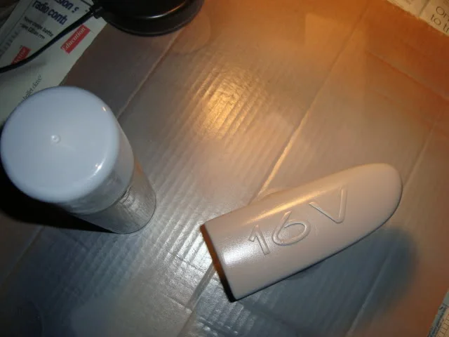

- The next step is to prime the Bullets.
- Firstly it is a good idea to give the bullets a clean, to remove any excess dust particles from the sanding. Either run them under water or use a cloth to clean them, before leaving to dry.

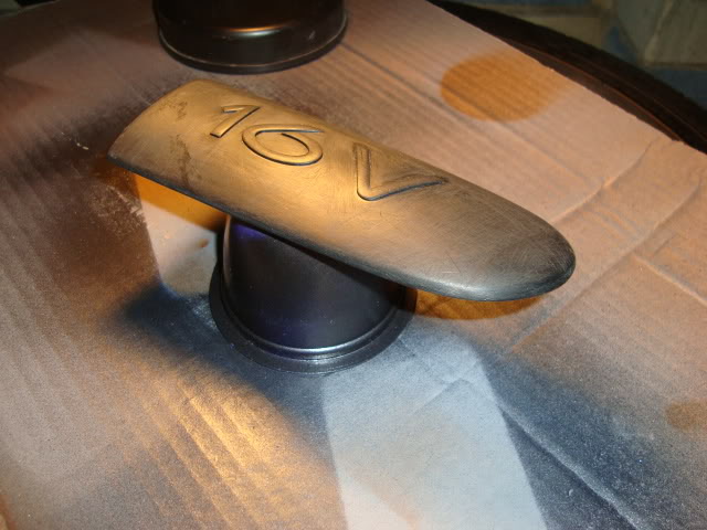

- Once dry, the Bullet is ready for spraying. I used Blu-Tack to stick my Bullet to an upside down pudding pot, so when it comes to spraying, you can get to all sides of the bullet.
- Now we can get down to spraying. I used Halfords Grey Primer but its up to you. Test spray the Primer on newspaper, so you can get used to spraying it, then move onto the bullet. Do several light coats, leaving roughly 15 minutes between coats, to ensure you don't get drip marks. Remember to do the sides.
- Once you have got a thick enough coat you are happy with, leave it to dry.

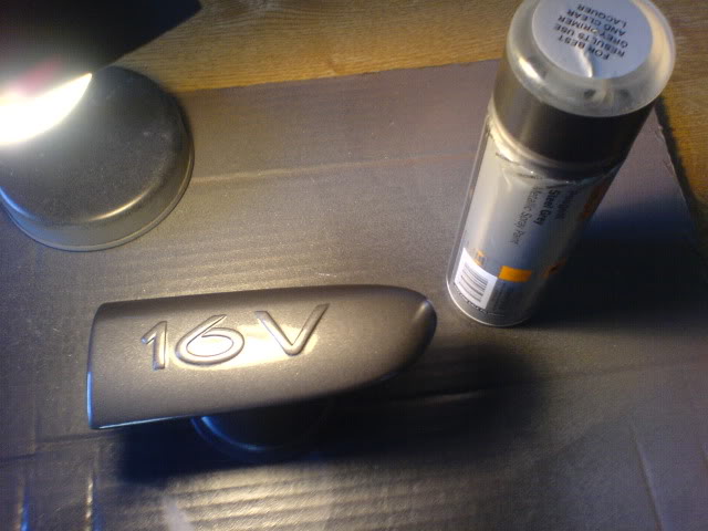

- Now we come on to spraying the Basecoat Colour. For mine I used Halfords Peugeot Steel Grey. Again similar to priming do several coats of the colour, use several light coats, repeating if necessary until you have covered the Bullet with an even coat.
- Leave to dry.

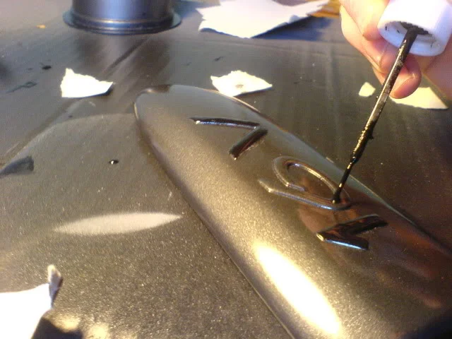

- I used a Halfords Gloss Black Touch Up Pen, to match my bodywork. You can do it how you like, but I used the Brush that came with the pen, very carefully going round the letters until I had a nice, relatively even coat, and had covered all areas of the letters, including the sides.
- A few tips:
I used a small piece of card to hold next to the part of the lettering I was painting, to give a nice straight line, and in case I knocked the brush accidentally.
Be very careful of getting to much paint on the brush, always dab it on some newspaper before touching the bullet.
I found it much easier if I supported my hand holding the brush with my other hand.

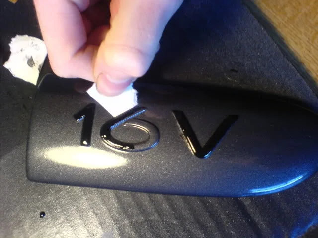

If you do get some paint around the letters, if your quick use a bit of card to lift it away. If not wait for it to dry then lightly sand it off.

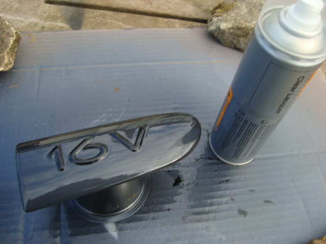

Step 5: Lacquering
- Once you are happy with the lettering, and have left it to dry, the final thing to do is the Lacquer. Again there are various ways of preparing before you spray the Lacquer. I just really lightly wet sanded any areas of imperfections on the letters or bullet with P1200 paper.
- Now you are ready to spray the Lacquer. This is the hardest one of the three to spray I found. Again do several very light coats, building up until the whole Bullet is covered, and there is a nice shine. Remember the Lacquer is very thick, so spray very carefully to avoid drip lines, especially round the letters. If you do get a drip, wait until dry and just wet sand it very lightly with a high grade Sand paper, before continuing spraying.
- Leave to Dry.

Nice guide mate and that's from a guy who works in a bodyshop.
The little card idea is ideal for getting it perfect round the letters, many people done it free hand no doubt.

Yea the card was a great help, although some bits were slightly easier free hand. Its all about working out what's best for you really.
Although I would still recommend people paint it really carefully, as if the card's not there. Don't just think oh I'll just chuck the paint on and the card will keep it neat, because if your not careful the paint can easily get under the little bit of card and ruin it. And you won't realise till you lift the bit of card off, by which time it may have dried slightly, so will be harder to clean the excess off.
So again just take it slow, use as small amount of paint as possible, and do little bits at a time!
