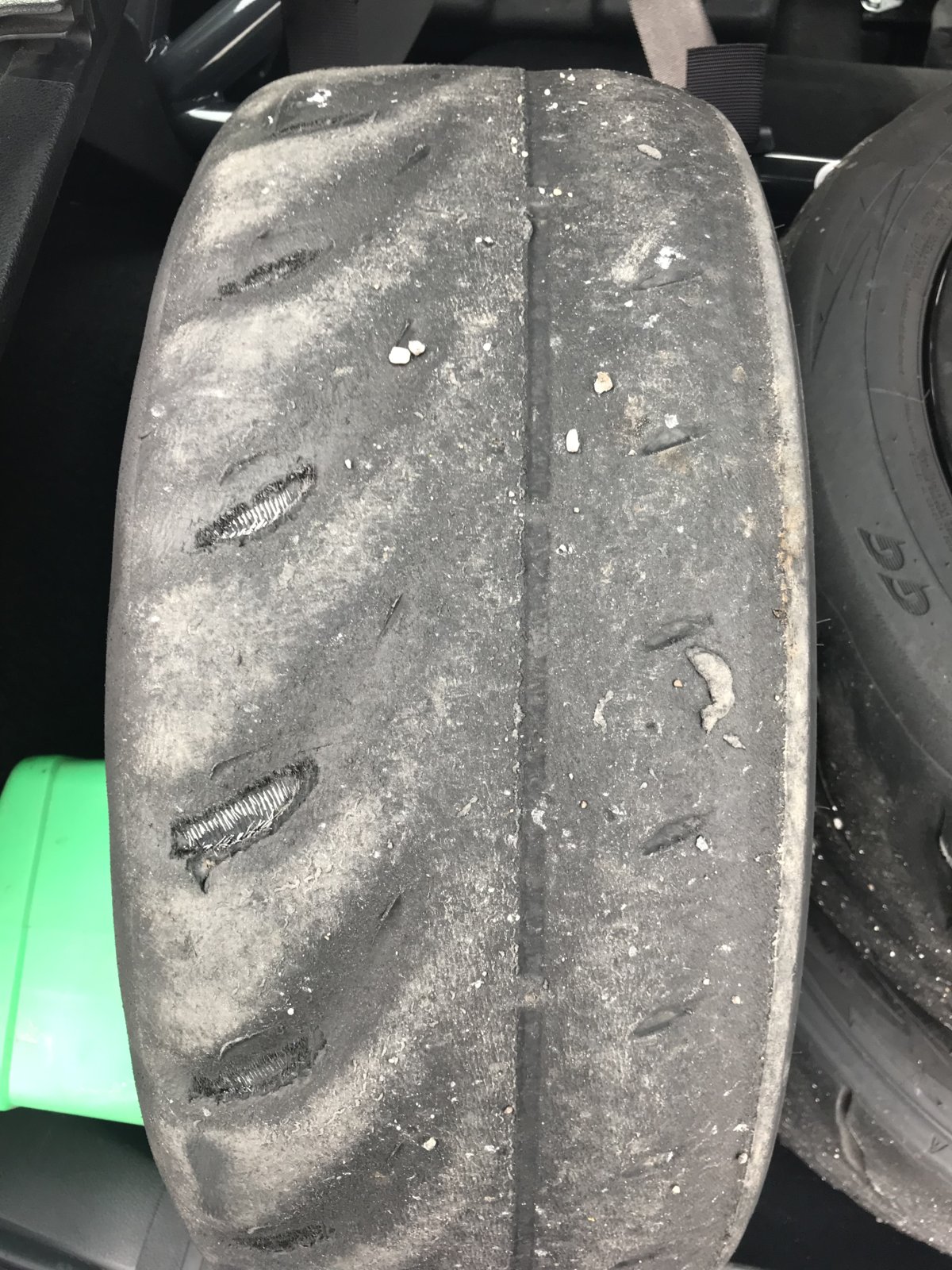

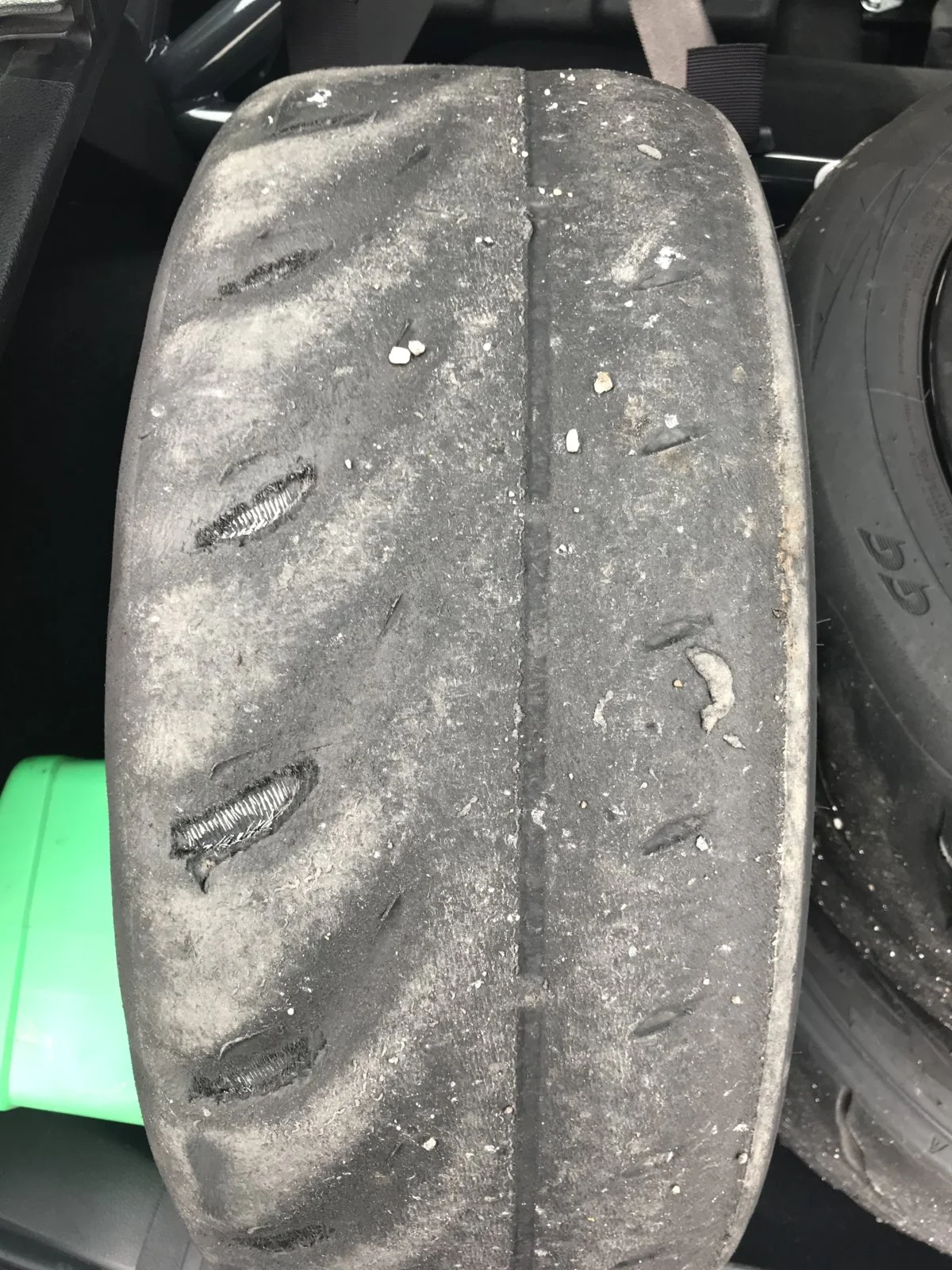

I’ve got PS Cup 2’s on at the moment, I’ve do two track days on them and although there is plenty of tread left they have lost a lot of their grip and feel. Guessing it’s how they are used regards heat cycles?
Managed to get the use out of these but did wonder why my grip had gone ? up to that point they were fine though.
