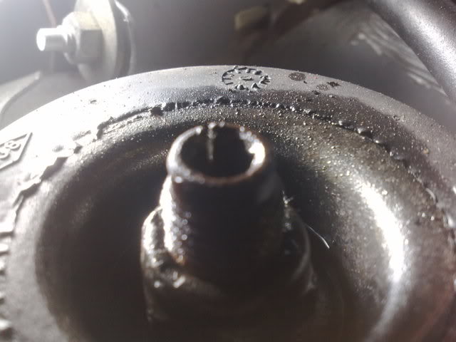

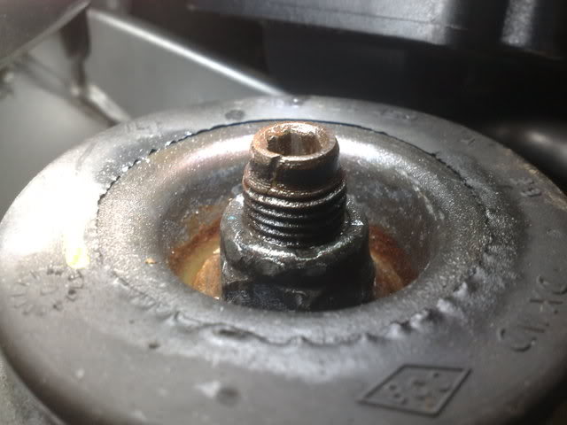

How would you undo these?
Waitey
Car  M3 Touring, AC Cobra
Fucked top mounts. The nut will not shift and both allen key holes are cracked/rouned?
Impact wrench just spins the strut shaft and spring top mount.
Tried it fred. Its just spins the spring top mount round and round and round.
I don't really want to be pulling an apex spring out of my leg lol
Get a vice or clamp on the strut to stop it turning, or cut a slit into the strut tops and put something in to stop then turning while using the spanner
Will do. Going to have another crack at it when i'm not so stressed :)
drill some small holes down one side of the nut the sharp chisel to finish splitting the nut ;-)
PS how will a air gun get it off if the hole lot is spinning and you cant grip the shaft anywhere ????
pour buckets loads of ease-it on, its a releasing oil, normally helps us in work if something won't budge
Grind some cuts into it them smash em off with a hammer. You'll need new damppers though, lol.
If you place a hand grenade on top of the nut pull the pin and shut the bonnet, you know when to open the bonnet again as you will hear a slight tap on the bonnet this means the grenade as detonated, open bonnet and ta da the nut is off easy when you have the know how and correct tools
Burn it, the car not the not. Problem solved?
....or may I suggest a hammer! ;)
I got them off with a 1800lb/ft air gun.
Took about 1 millionth of a second. I was very scared though.
