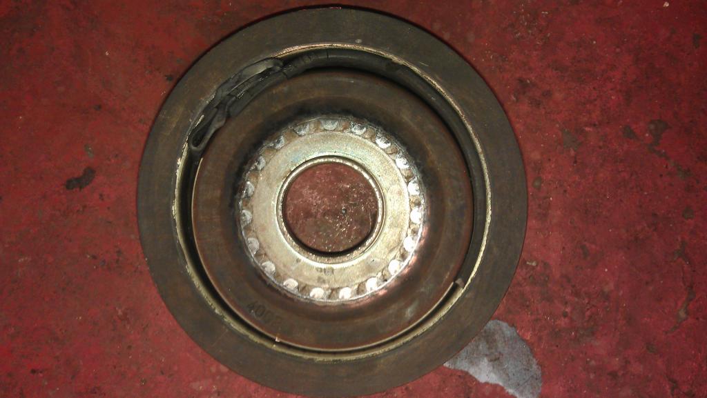

I drew a line on the crank pulley to check that wasn't moving and the line was in tact when I checked.

If if was just he belt that was changed that's the problem.
