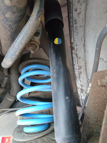

Suspension 10/17
Cup dampers front & rear

Looks a decent flamer you've found there. What's the ride like on the grams springs? I'm fancying a change but can't decide on different springs or go balls deep and get coilovers.
Im really impressed. I was looking at going with Cooksports again but the ride and drop on these is on par.
  Megane R26
Are they as stiff as cooksports? I read they are a bit more progressive, I'm finding the cooksports a bit hard as the roads get worse and bumpier.
Hmm I really don't know. I had a whiteline arb on my others and other mods so this does feel a bit softer over bumps. I think.. I'm impressed thou.

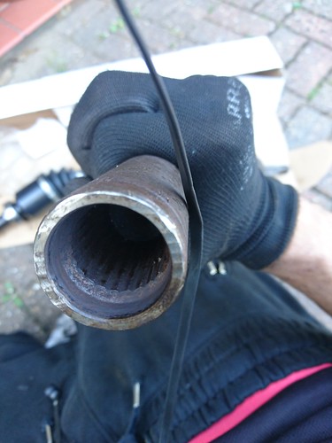

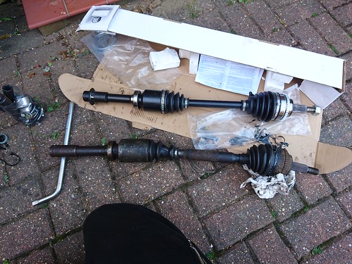

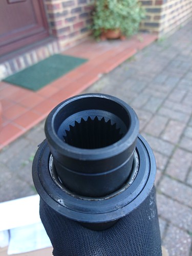

Horrible clicking /bang noise
I get a massive clonk /knock when going into reverse. Then I got into first and it fine, back into reverse and clonk again.
It does it when coming on and off throttle too. All engine mounts are pretty much brand new and torqued up right.
So I think it's inside the box or the OS driveshaft splines worn on the driveshaft where it slots on the gearbox. I belive it might be skipping a bit? Hard to explain but I saw a similar post on here with that being the culprit.

Does that shaft fit? As I can see it is not the Renault one and I think you will got some issues with the inner boot. I replace my shaft about 4 time and the only way to proper install a shaft on the driver side was to use genuine one.
  Megane R26
Fits good but inner boot will run on a small tab on the engine black and spill all the grease. I used a cabletie around the boot and it tightened it enough to clear the block by a few mm. 200 miles in and it's still perfect with a good enough gap.
I chopped that small tab off the block on my last ph1, will do the same on this soon.

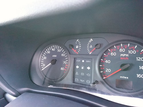

My sat nav decided to work for a few mins!
I was driving the car gently when the car totally died halfway around a corner. At the same time the sat nav screen flashed up!
The car then wouldn't start at first, cranking over but not firing up. I waited a couple of mins and it started?
Anyway, I have no idea what happened but tbe car dying seemed to fire up the sat nav display!
I input my address, moved off and the display went blank again! I can't seem to get it back.

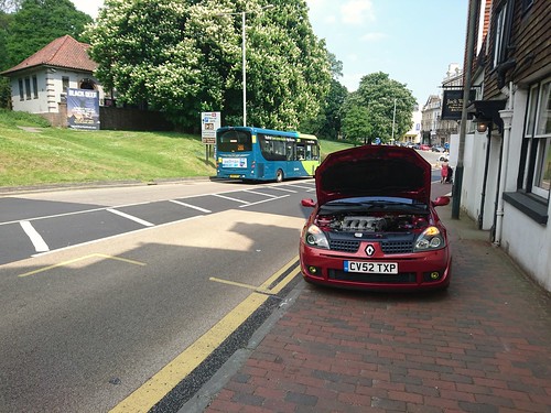

First break down!
Bogged down and won't start. Just cranks over,car is warm, have been diving for 20mins.
Will start after leaving it for 15mins but bogs down again when setting off.
Crank sensor? Throttle pedal?

The white wire from the engine starter could have a bad contact. The crank position sensor cause some missfires not just no start.
  Megane R26
I left it for 30 mins and it fired up again. Got it home and haven't driven it since.
I've ordered a new Crank sensor and coolant temp sensor and go from there.

Ha. Its all running spot on now after I fitted a few new bits-
New Radiator
New expansion bottle
New coolant temp sensor
New map sensor
New Crank sensor
