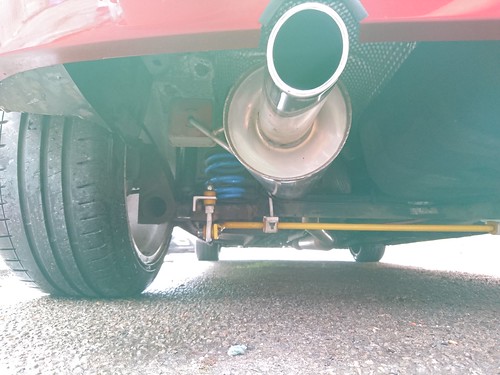

Whiteline rear arm is going on in the next few days after I sanded and repainted it.

Cup spoiler and Whiteline rear arb are going on.. For now.

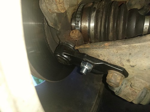

I was getting a slight knocking on acceleration so replaced both balljoints, has cured the issue.

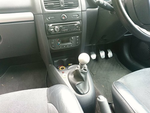

My ph2 gearstick had a really annoying rattle inside the actual knob which was driving me crazy so I sourced a ph1 shifter to replace it with. Mmm so much nicer and feels way better and more premium.
