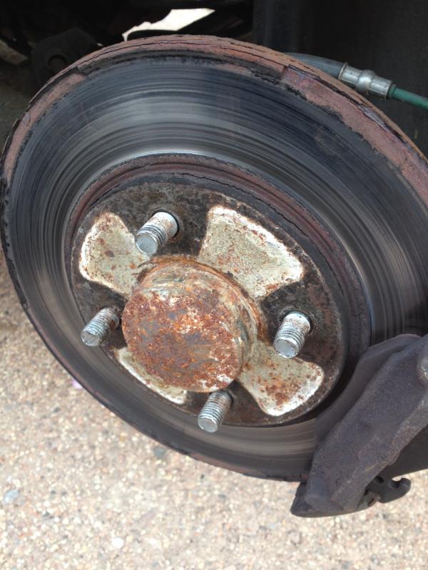

This is probably a silly question, but how does this cover come off if I wanted to get to the hub nut?
It's an interference fit mate, so get a chisel/screwdriver and hit it from the back on the slightly overhanging lip and it will pop out.
