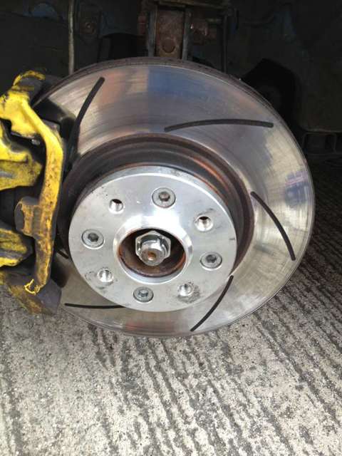

Hello,
I've got some 15mm hubcentrics, however looking at it and today getting round to fitting them it turns out I may need some shorter wheel bolts.
I.e my standard bolts are hitting the hub before running out of thread.
Does anyone know what size I need?
Cheers
I'm guessing you've got the bolt to hub spacers? Common problem I think.
I'd just measure how long you existing bolts are and how much thread is too long, and minus them.
Thinking about it the thread length you need can't be longer than 15mm, coz that's the width of the spacers?

They're second hand mate they come with bolts - I.e bolt the spacer to the hub. It's bolting the wheel to the spacer where I'm having issues.

Get your wheel off and put the wheel bolt through the hole and measure the thread sticking out. Obviously this needs to be less than 15mm. Measure and find out how much shorter bolts you'll need.
My Turinis had about 19mm of thread into the hub and my 2118's had 17mm. Standard bolts total thread are 23mm long iirc, aftermarket ones may be bit longer. Know TPi polarised ones are 27mm thread length iirc.

You can buy custom bolts from demon tweeks. Standard are 26mm long 60 degree fixed seat type and m12 x 1.5. So 20mm bolts will be fine.
