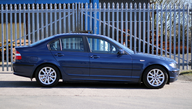

Any recommendations for a glaze I can use on my Mystic Blue BMW?
BMW 320 by bensambrook, on Flickr
Gally
Prima Amigo is still to be beaten in the Glazing sector. So easy yet so rewarding.
Have a look at Waitey's recent threads. His Tvr is a similar colour to the Bmw.
