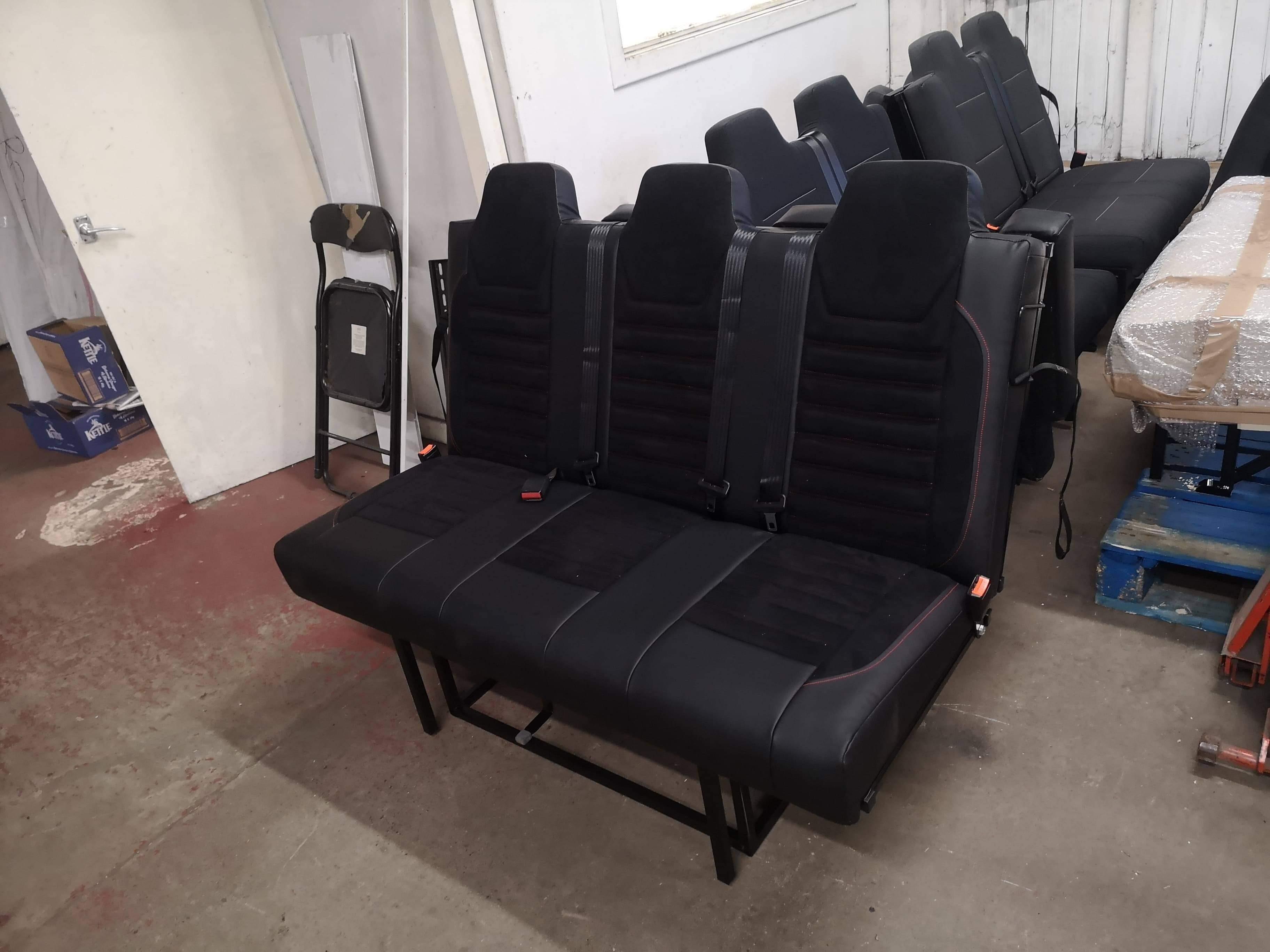

I buy some sh*te
I also got the seats returned and my bed made.

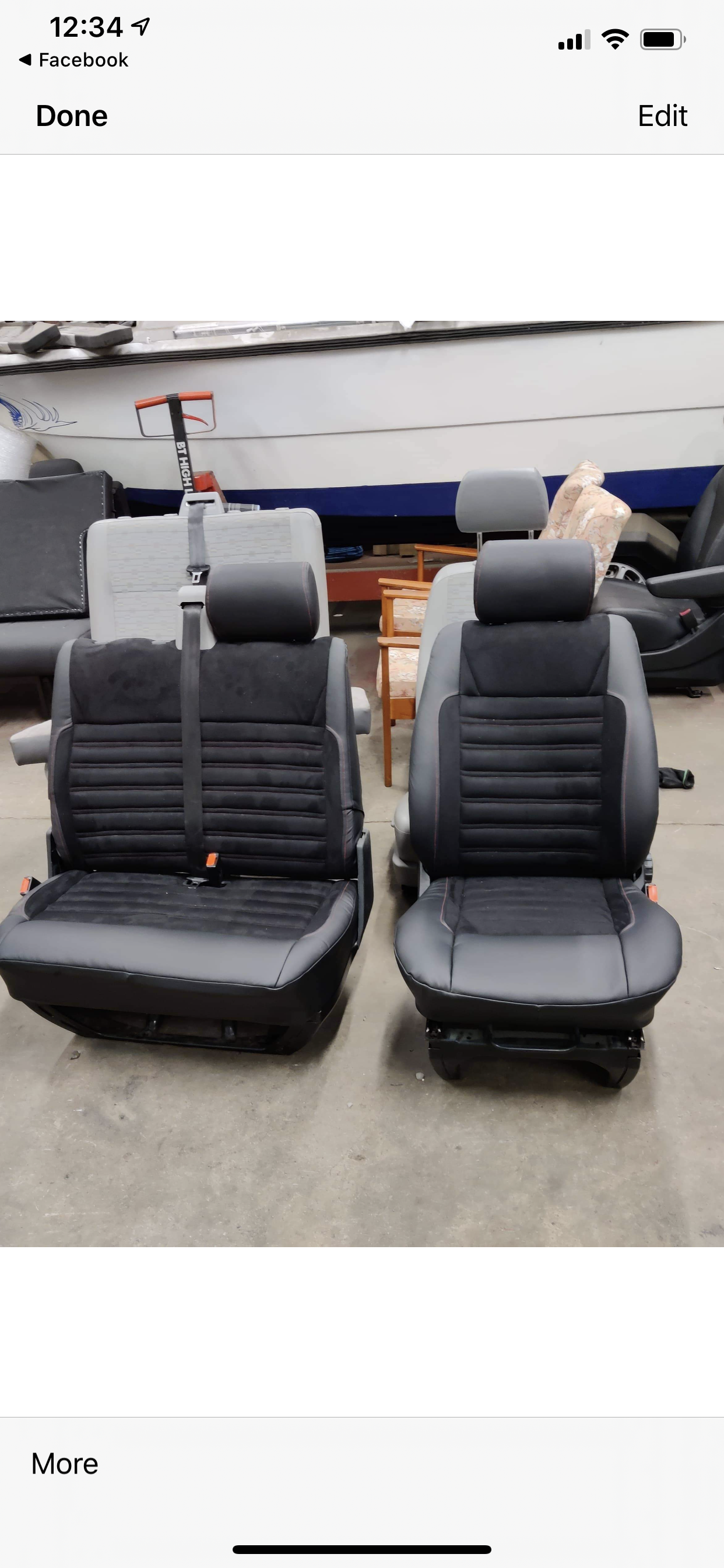

Those covers look a terrible fit?
Aw thanks. [emoji23]
I’m assuming you mean the front seats. My first impression wasn’t great either with the photos. But when I went to see them in person it made sense.
The passenger double seat has a stitched seam half way up the back rest and it looks better in person.
The drivers seat does looks a bit baggy. So I might get it removed and some new foam added.
A long way to go with Paint before worrying about that anyway.

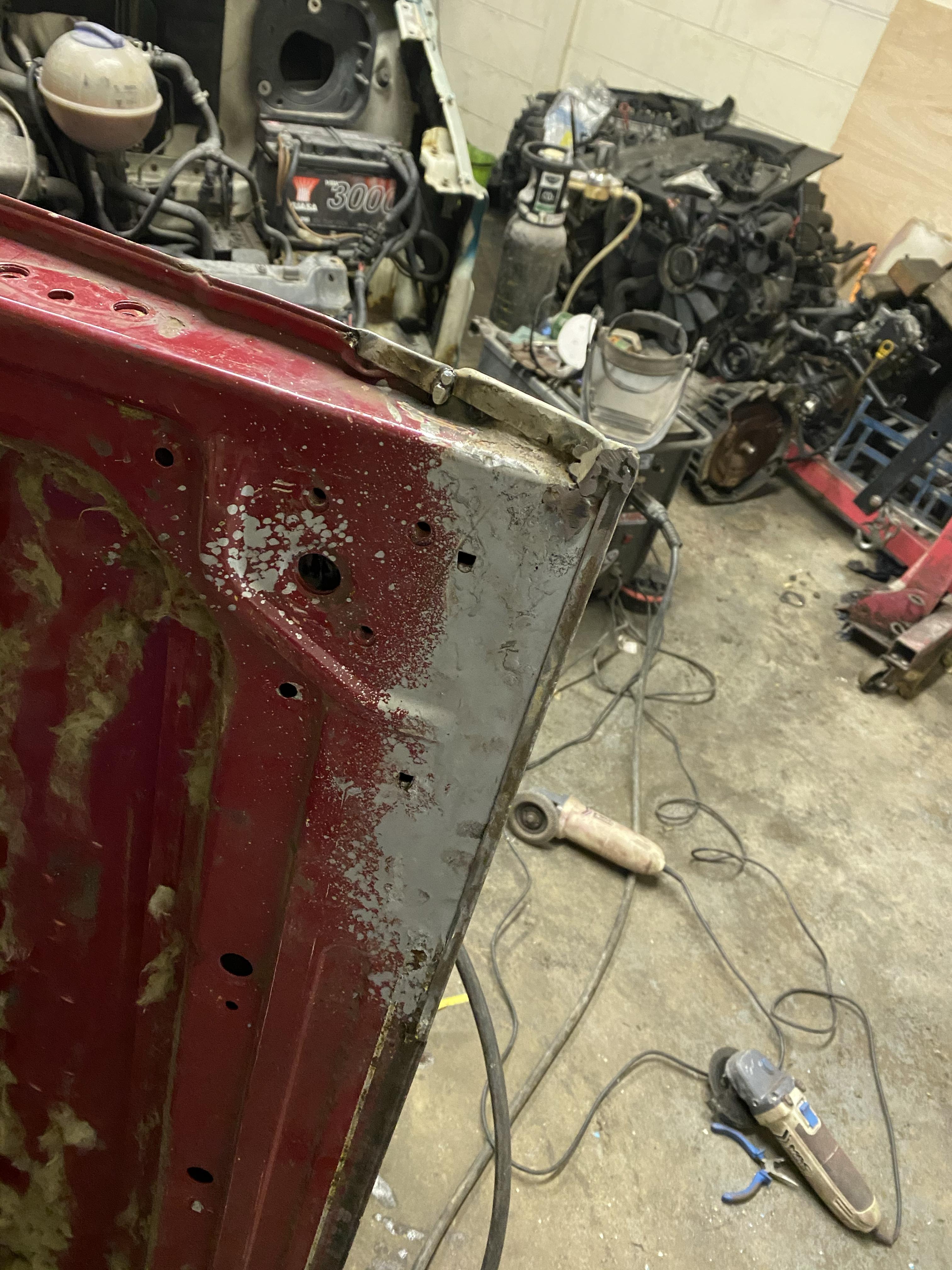

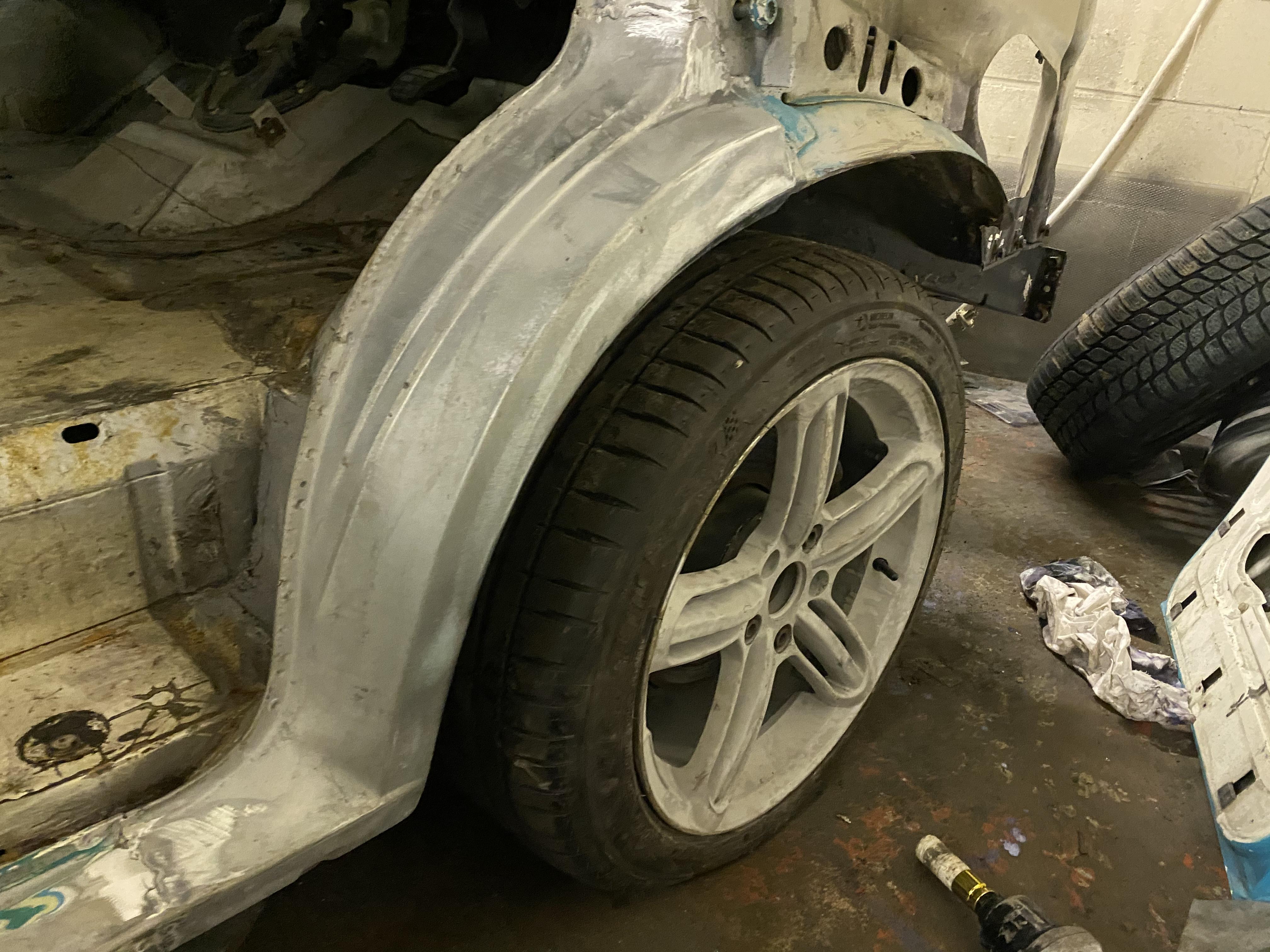

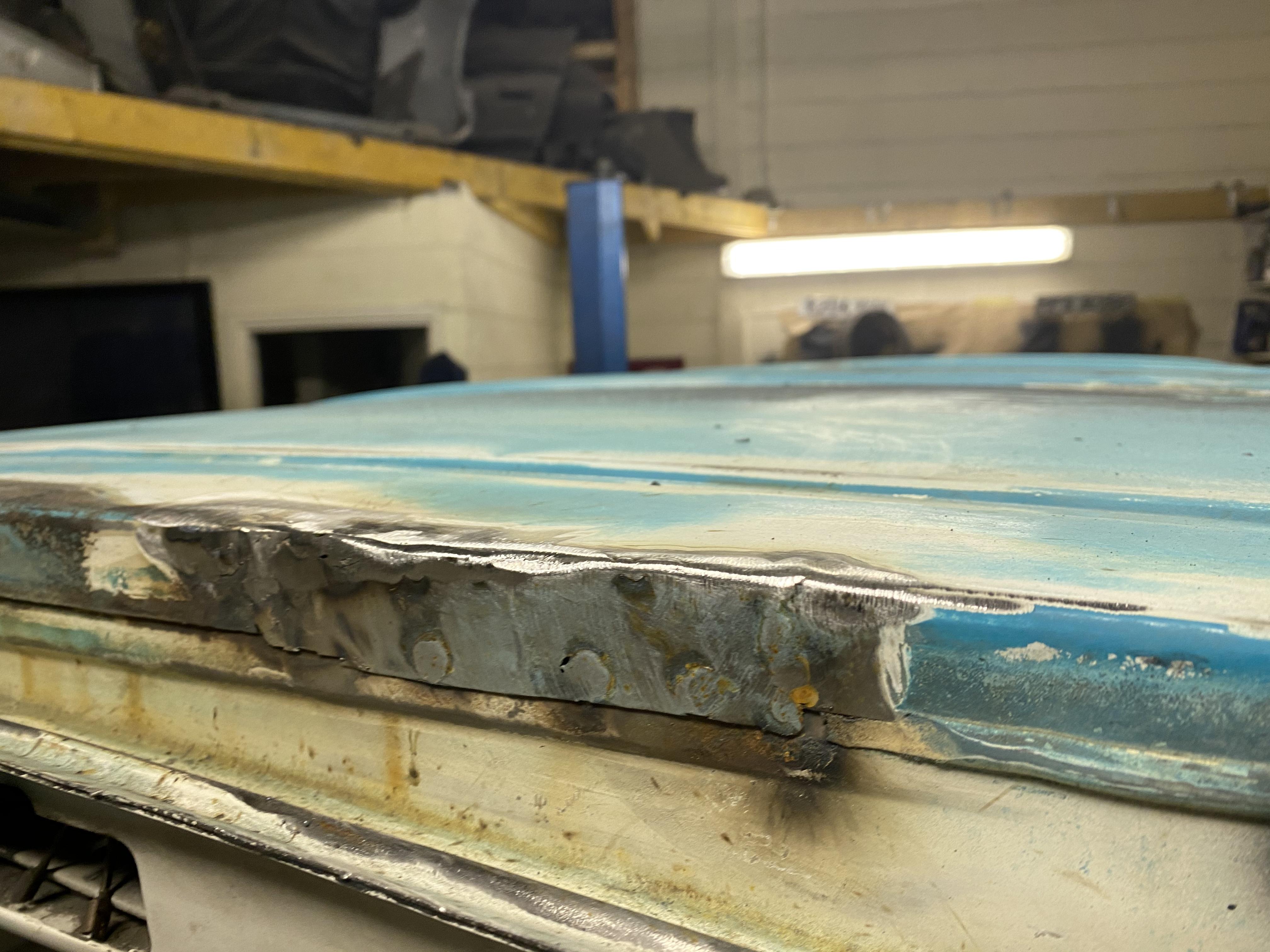

Front arch welding finished. I’ve ground it back a bit more and it will have a little skim of filler before paint.

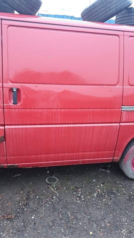

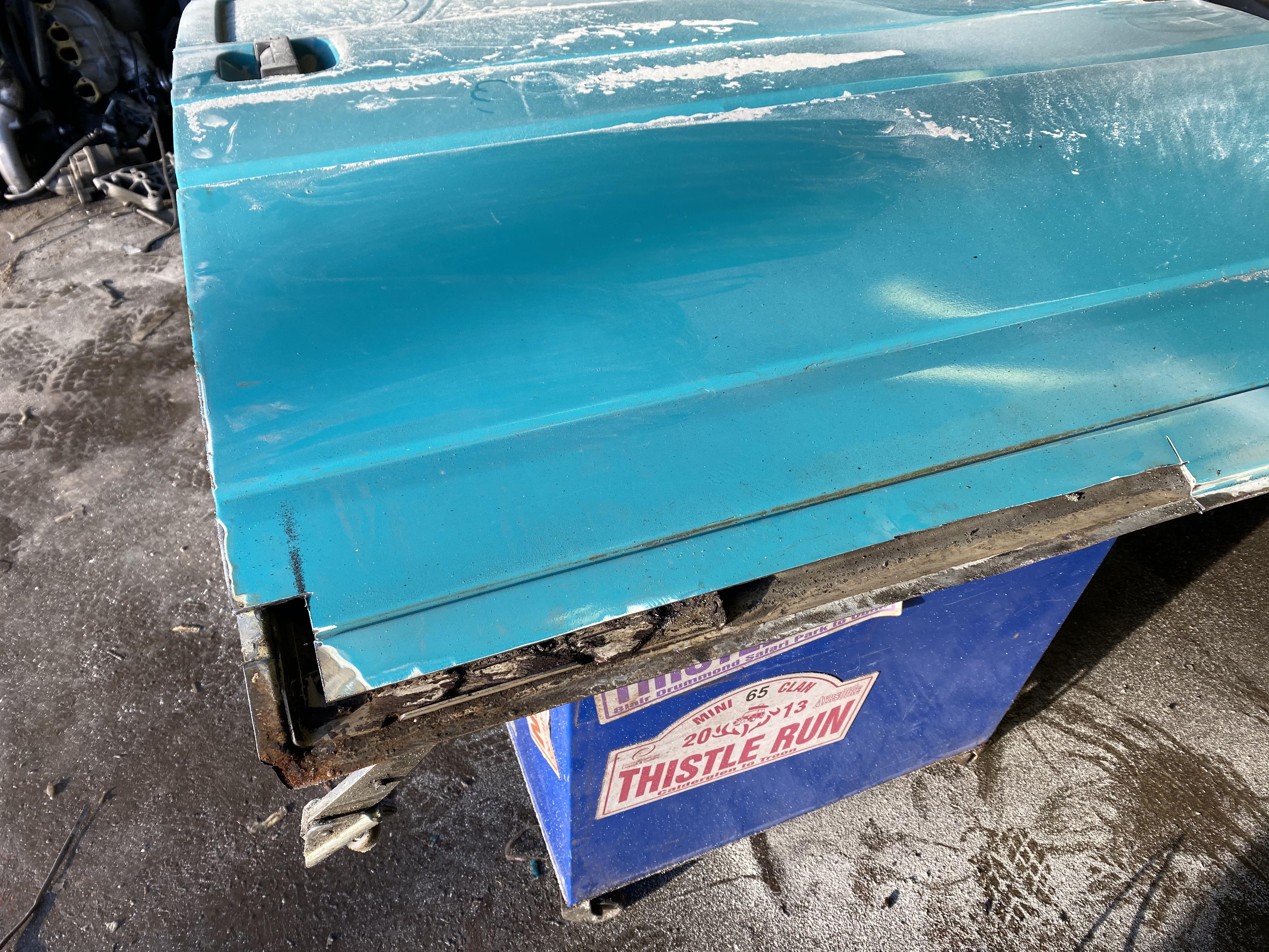

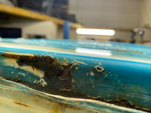

I then started on the sliding door. First I’ve cut off the bottom section that was looking a bit rusty.
That but is looking pretty straight forward. I’ll make a repair panel up and welding it in soon.

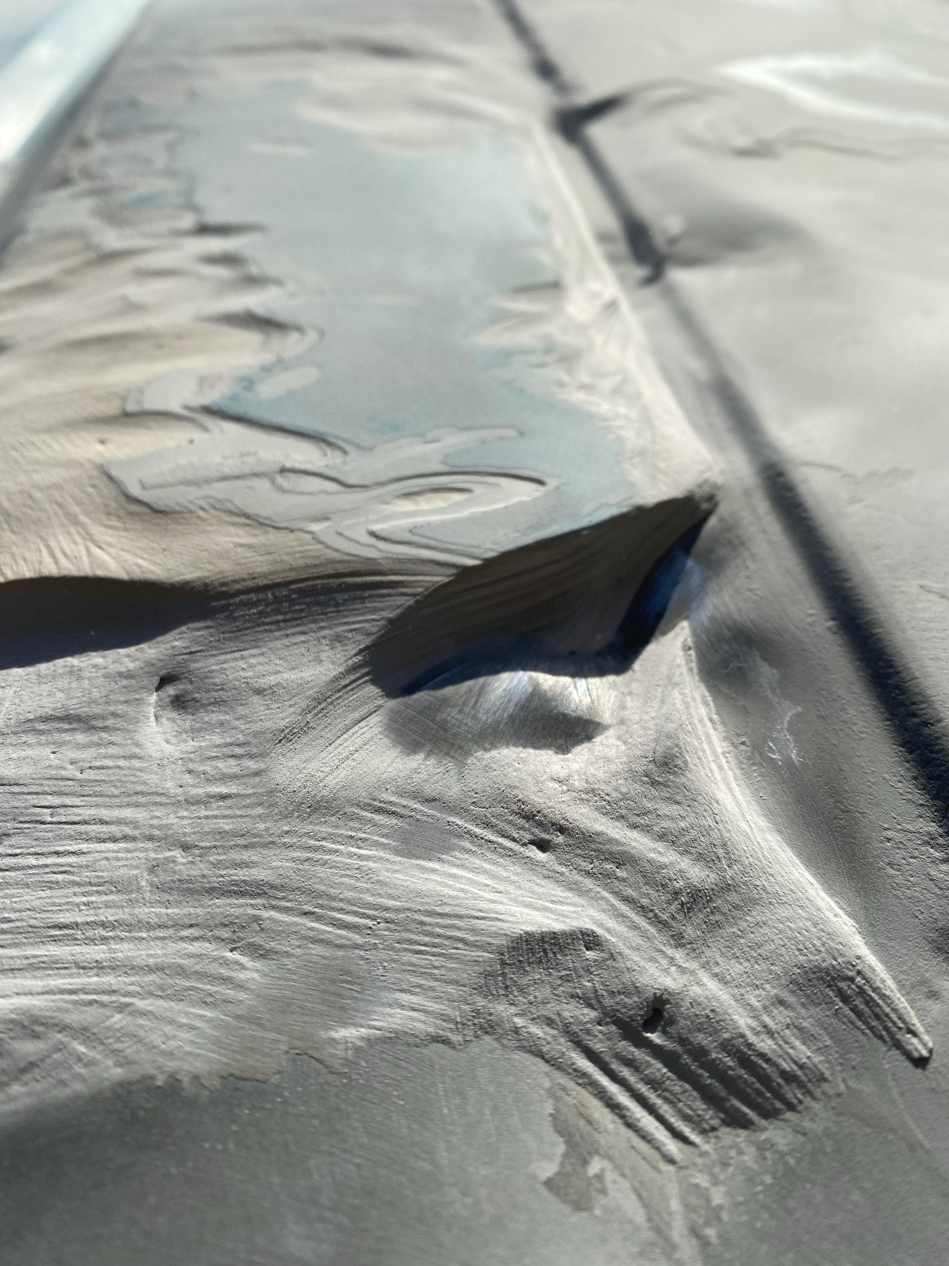

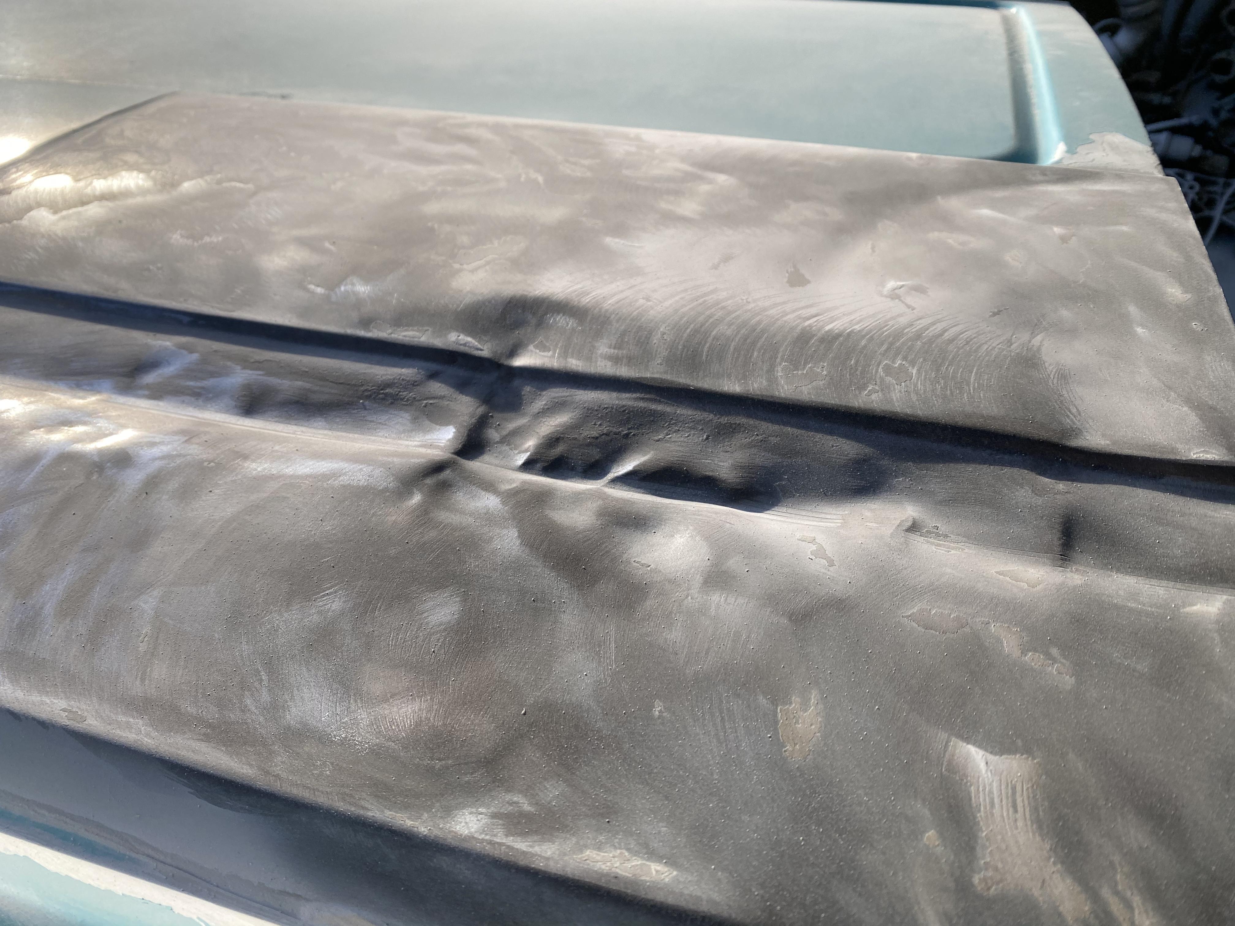

But I then started digging in where there was a crack in the paint (filler alert!!!)
So it’s had a bit of a hit. I don’t thing any attempt has been made to pull it out. Then just loaded on 2” of filler. It had a big mess but there is only one way to see what you have and that’s to wire wheel the lot out.
I’ve stopped there with the sliding door. Just seeing it it’s worthwhile continuing with this one. But a bit of a look around and I would be paying £350 ish for one that might be just as bad. So I think this will get repaired.

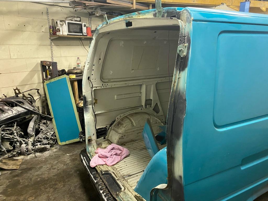

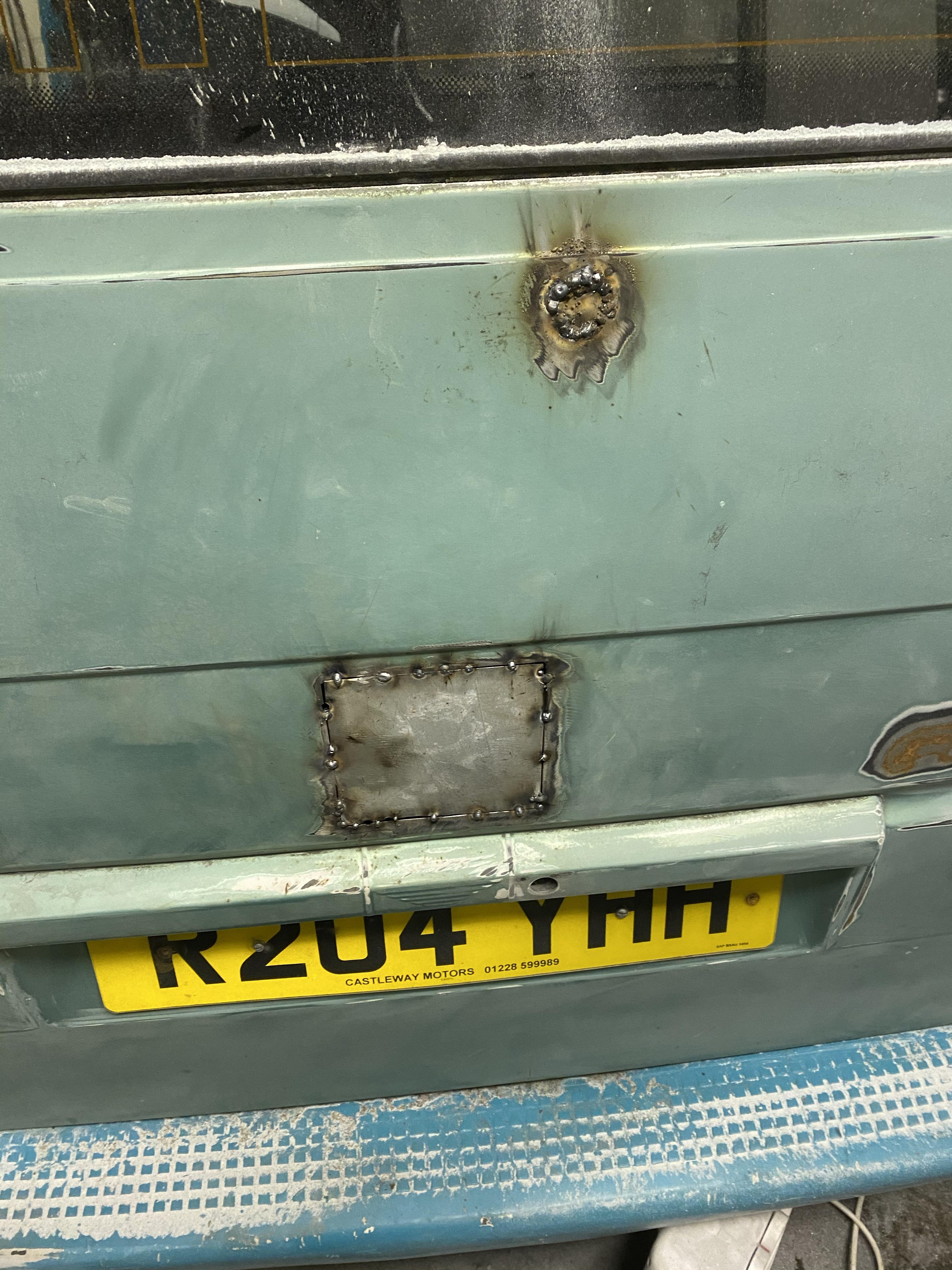

While I make that decision. I’ve moved on to the tailgate.

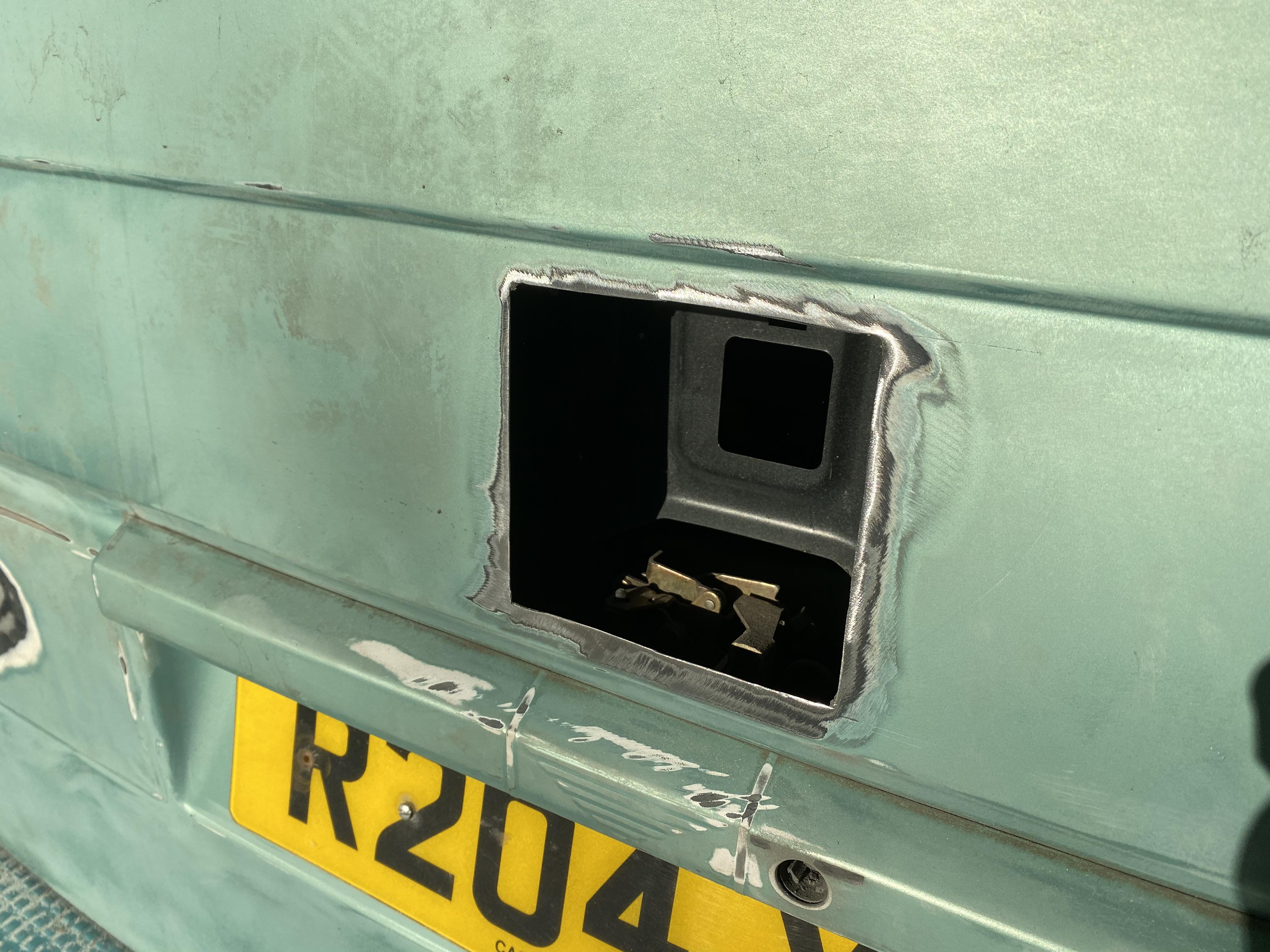

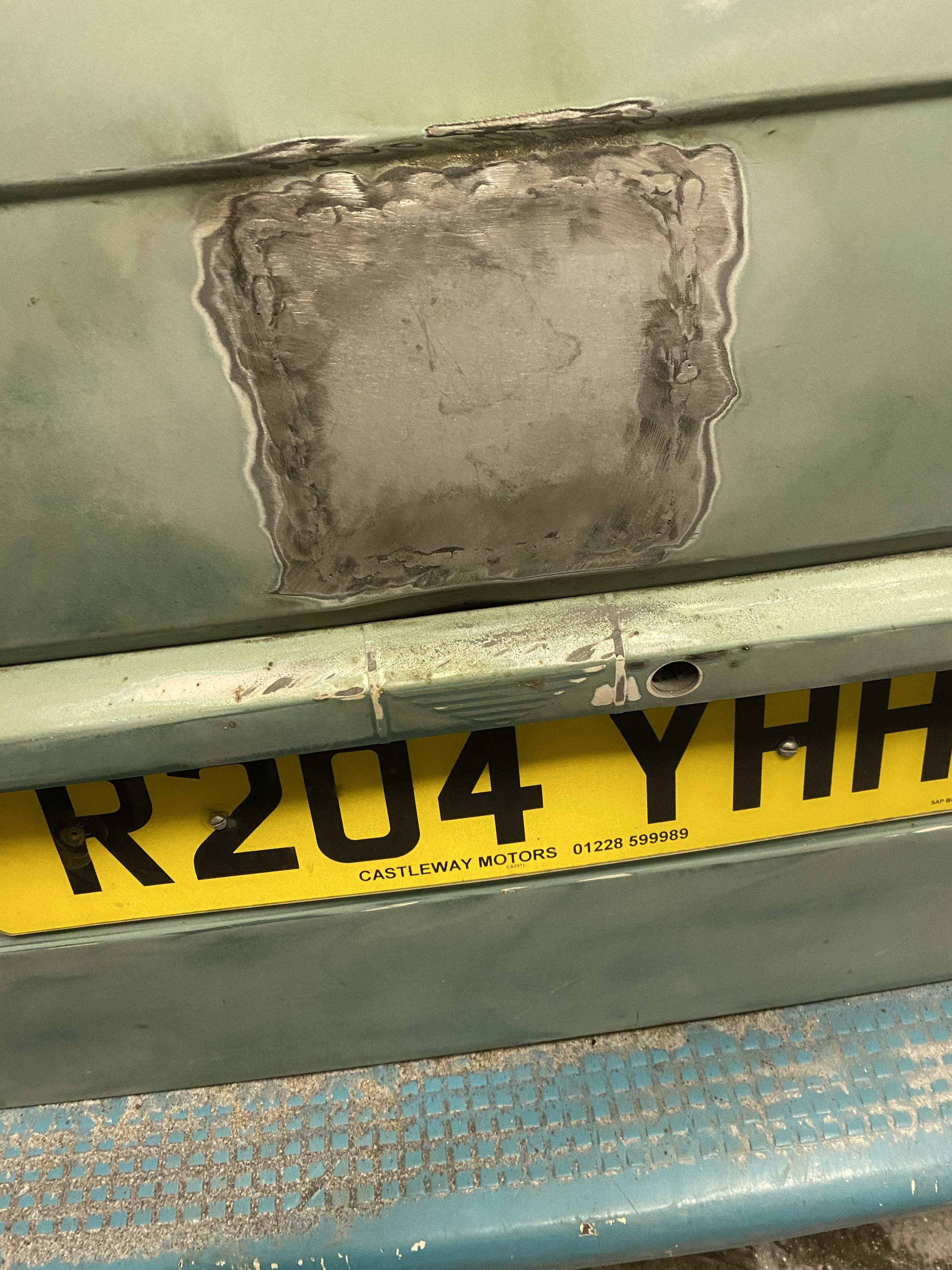

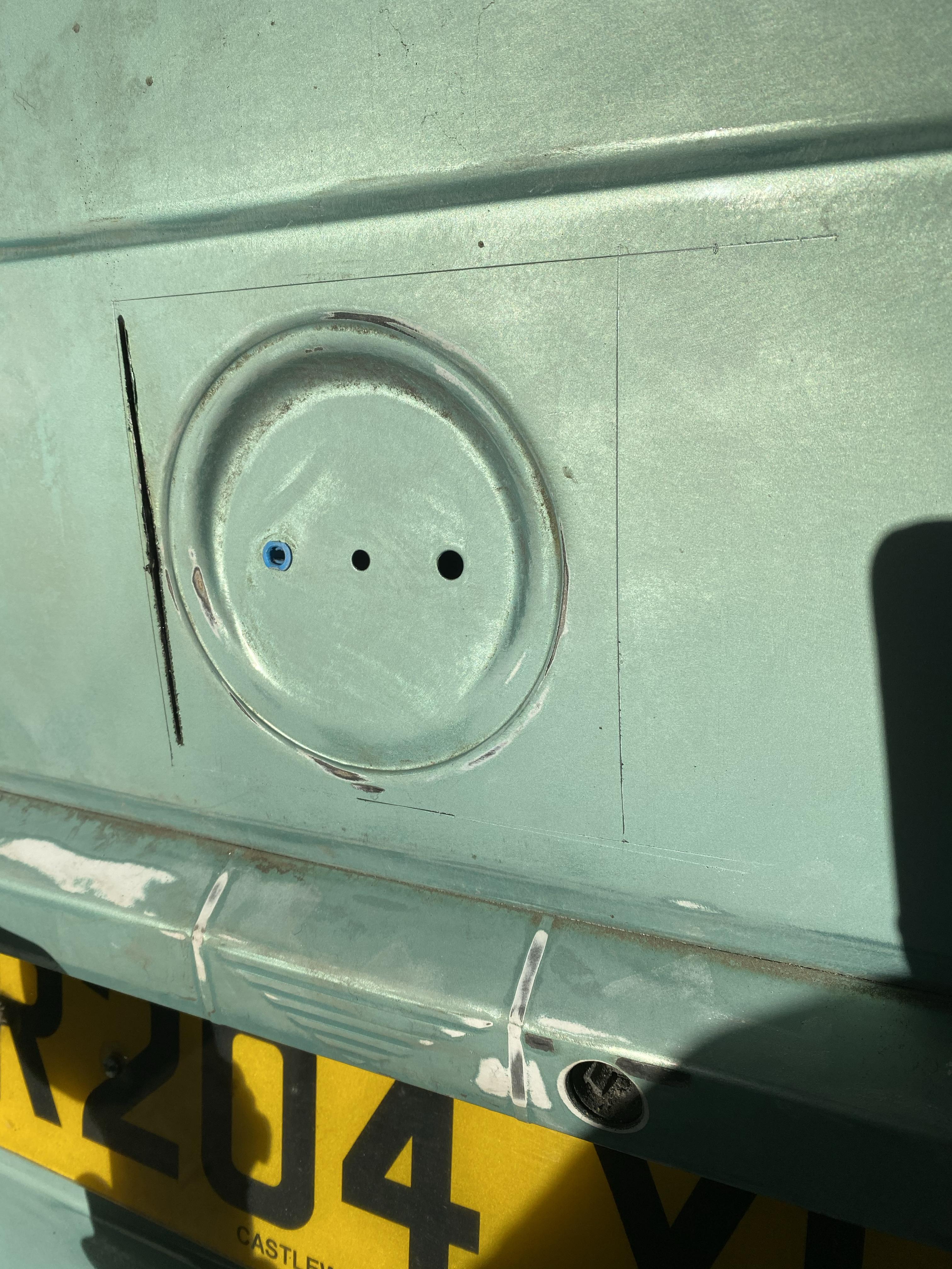

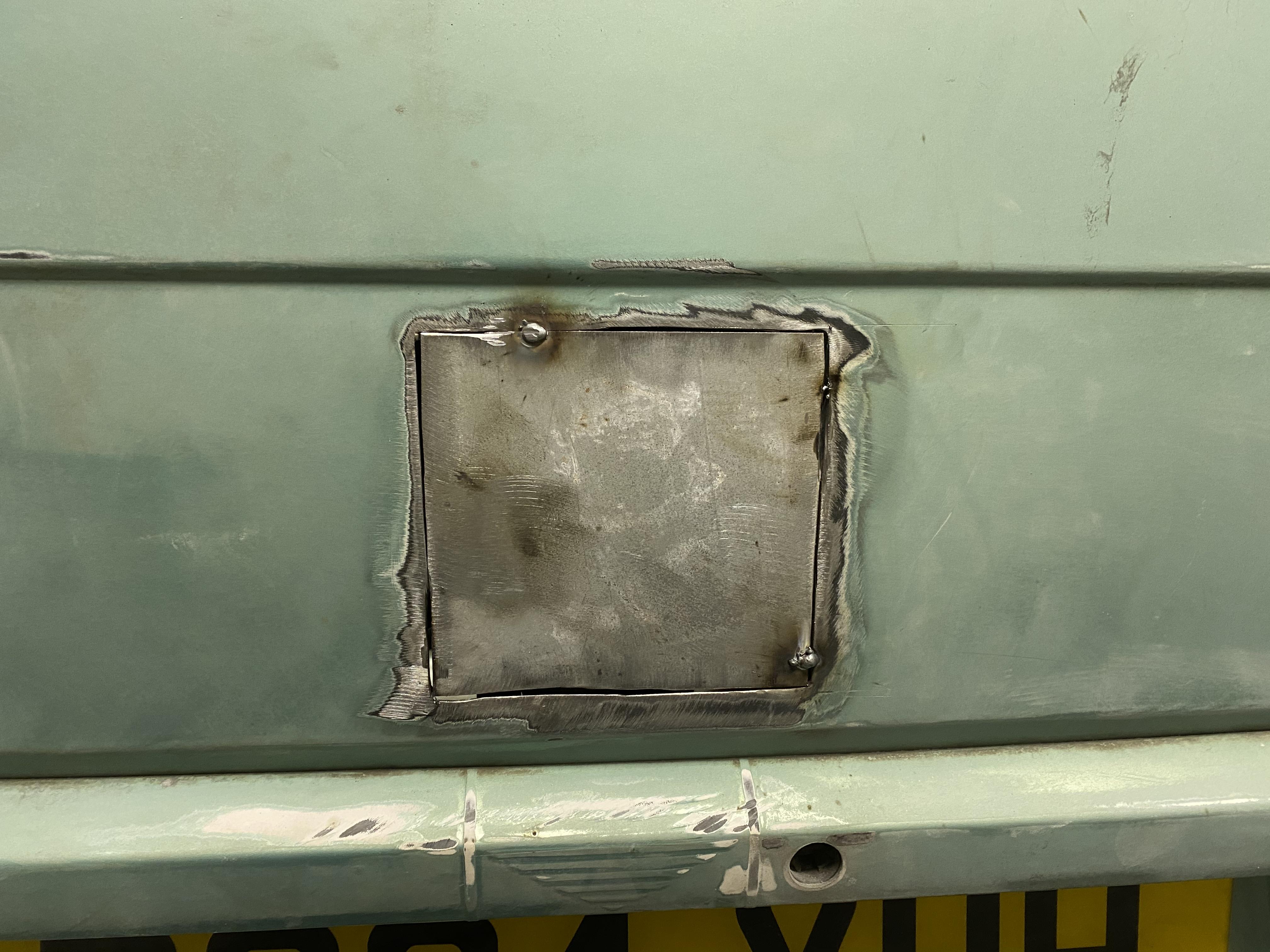

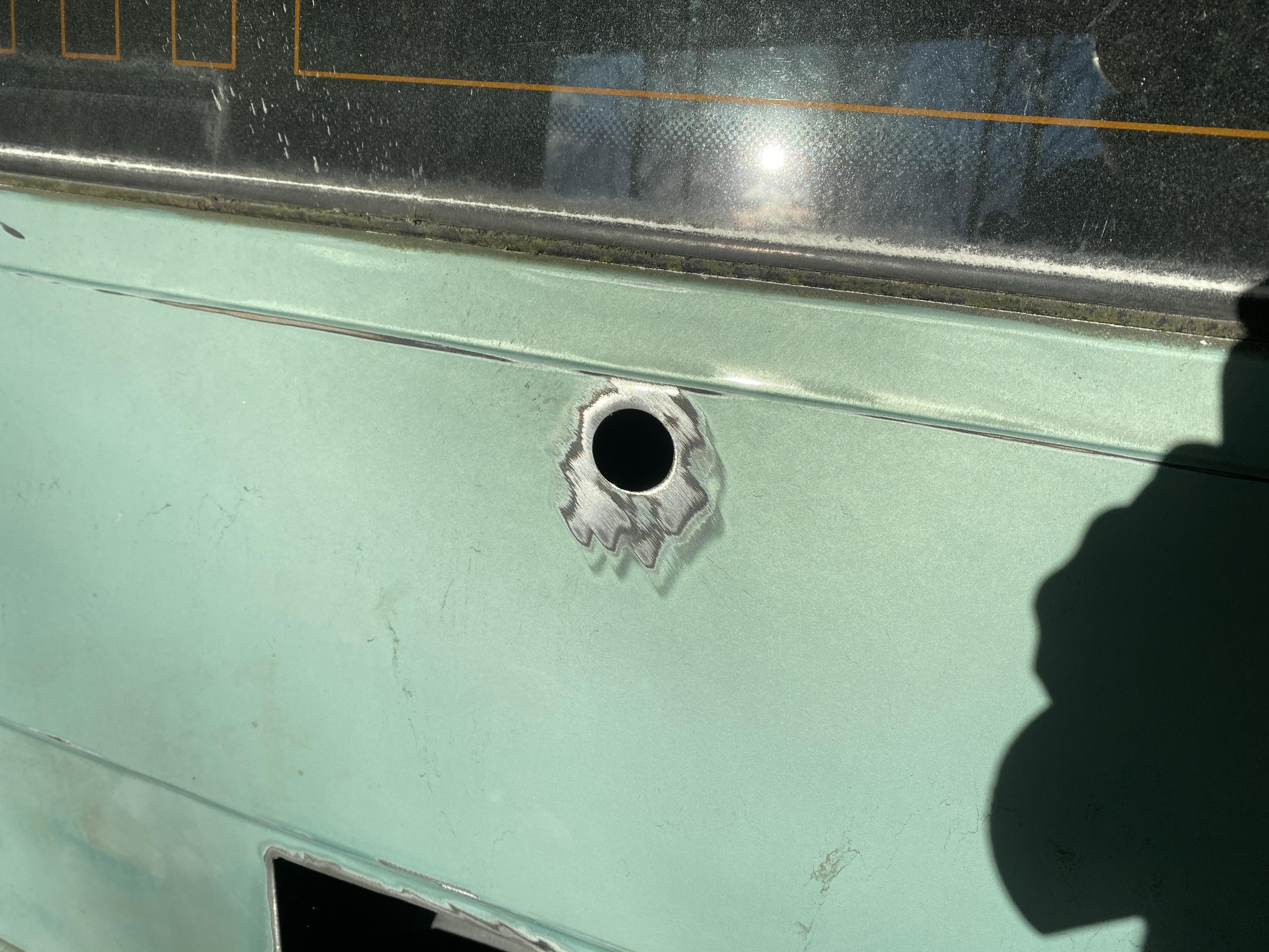

It has a hole for a rear wiper. But I have no desire to find or pay for a rear wiper. So I’ve welded a plate behind.
Same goes for the rear badge. Sure I could get one. But the little fixings brake all the time so they are quite expensive and are not available new.
So I’ve cut out the badge hole and stitched in a bit of 1mm steel.
Very happy with the end result there. A little bit of panel warping above the mod. But i think it will work out fine.
So just the sliding door and then the windscreen surround to finish. Fit the side windows. Then it will be stripped down for paint.

So a good amount of time in the garage today.
The van is booked in to the paint shop for the 17th Feb so I’ve got to get it ready to go over the next 2 weeks. The deal was to have the van fully prepped. All repairs done. All sanding done. Pretty much ready for panel wipe and primer.
So there are a few jobs to do before the sanding starts.

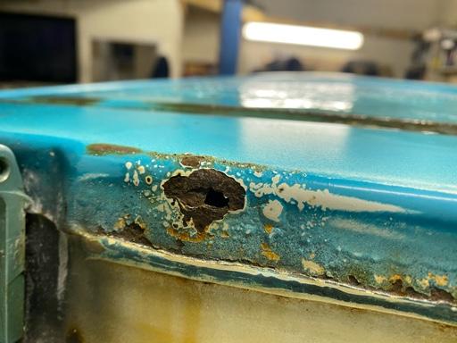

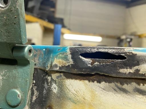

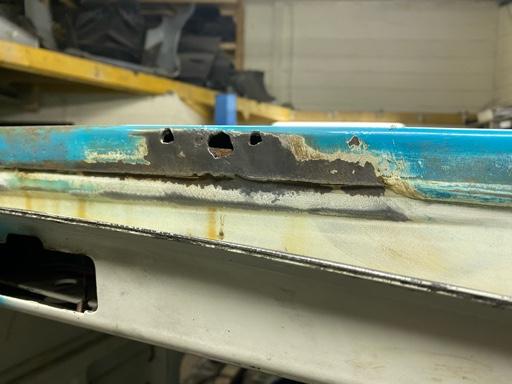

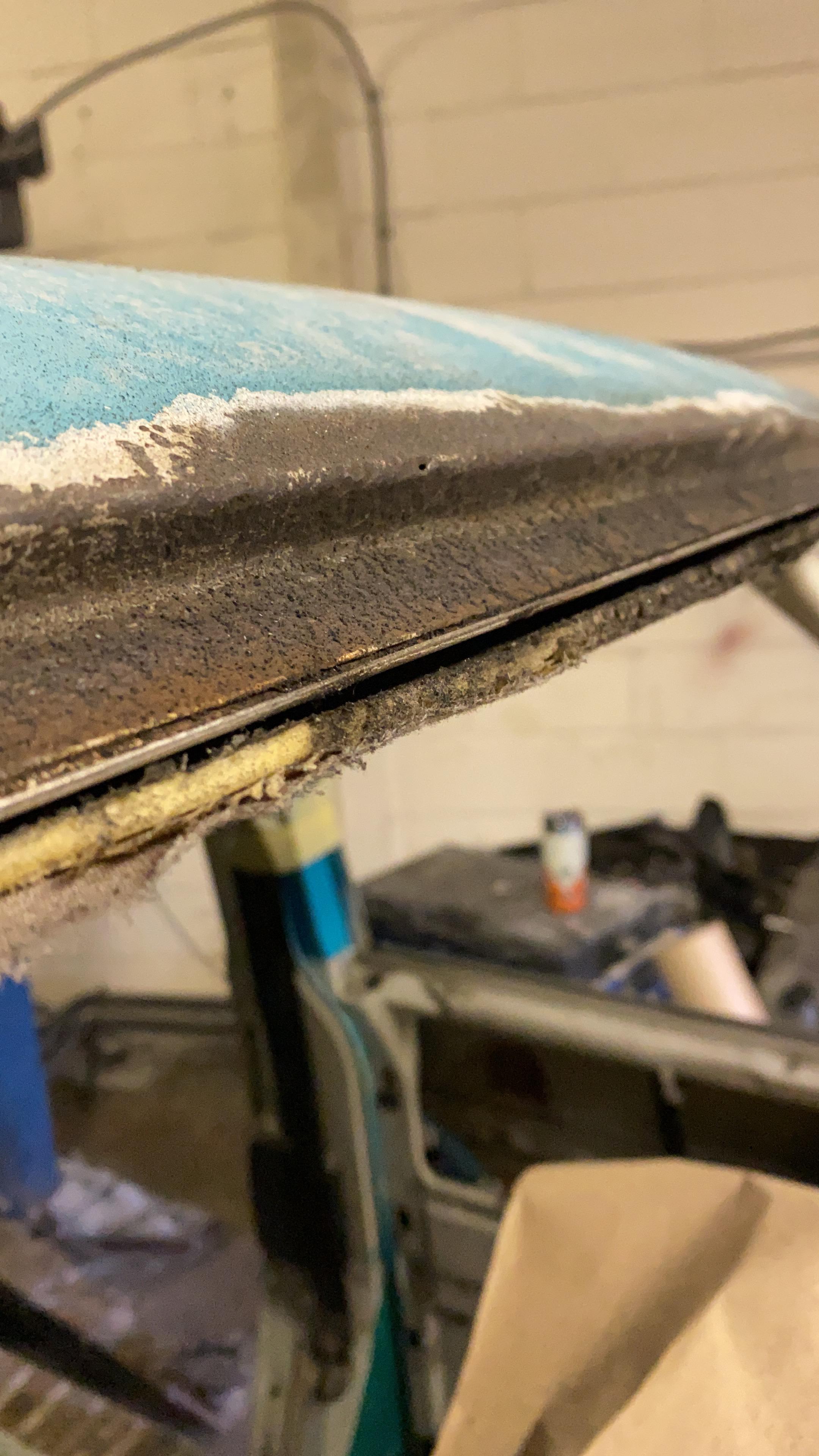

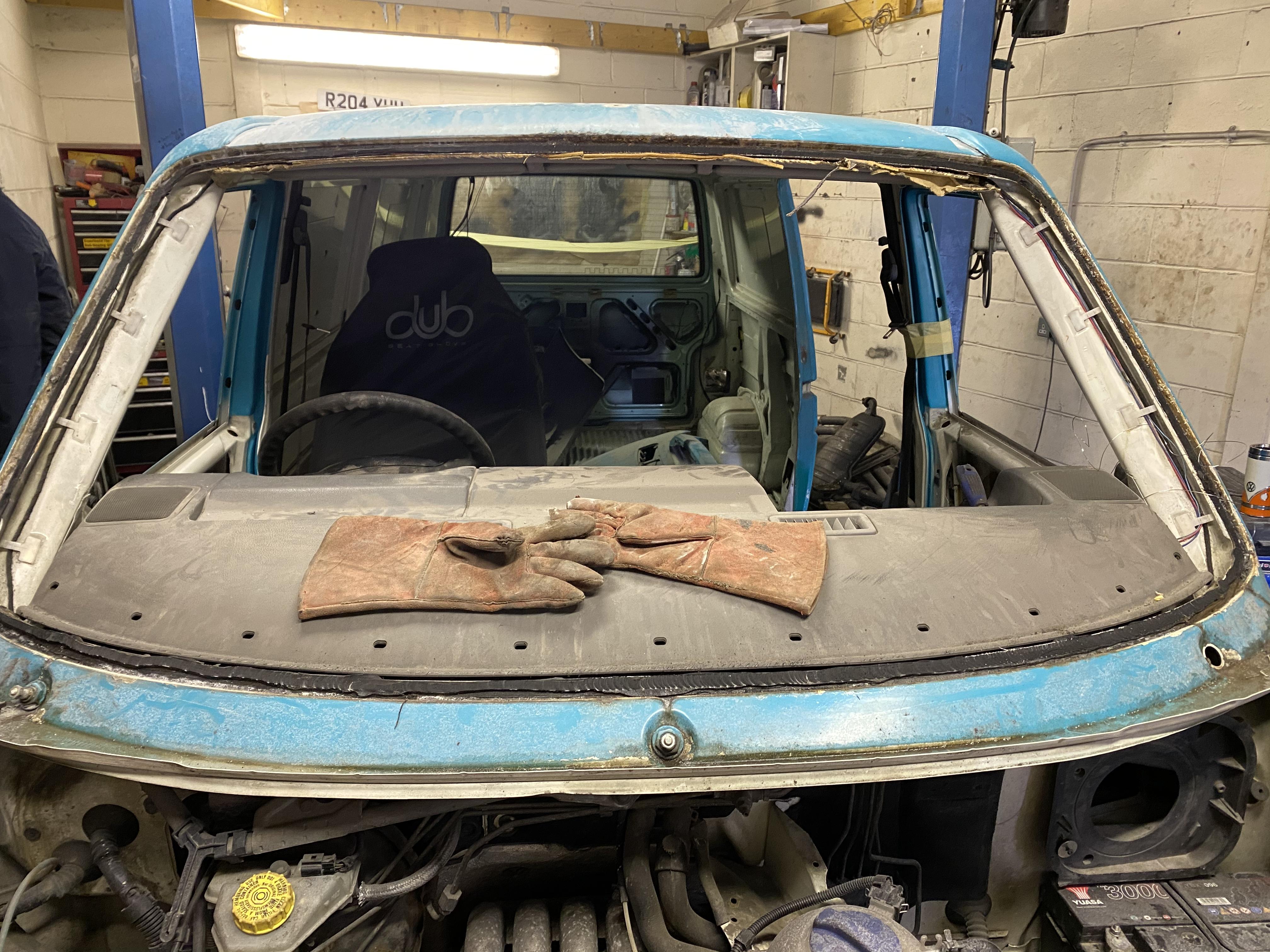

One. The windscreen on these tends to let water in past the rubber trim and they rust the screen surround. I removed the windscreen with a bit of difficulty and did end up cracking it. Not the end of the world and I’m going to see about maybe replacing with a heated screen.
All removed.

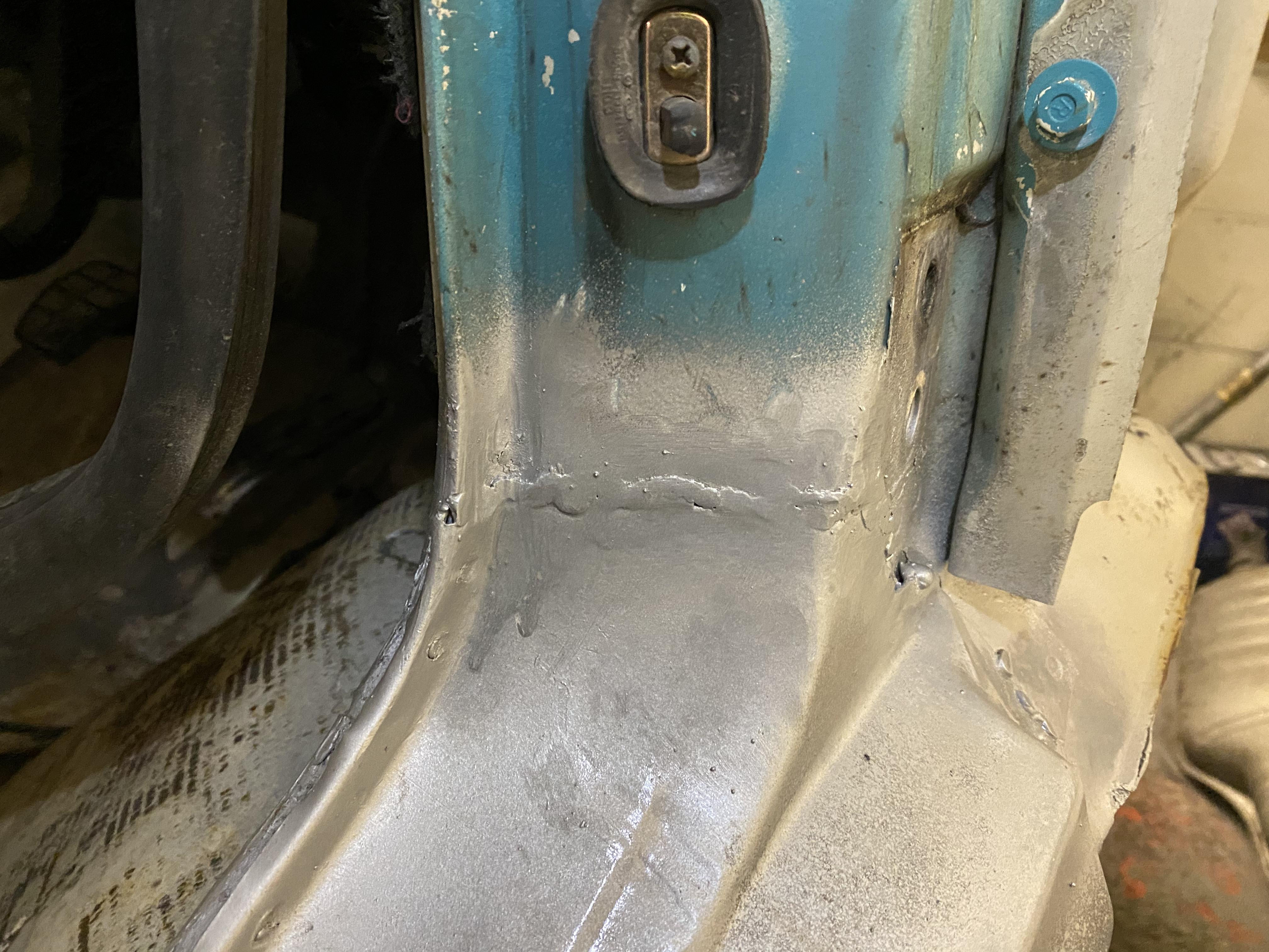

Sealant removed and rust ground back this was the worst bit.

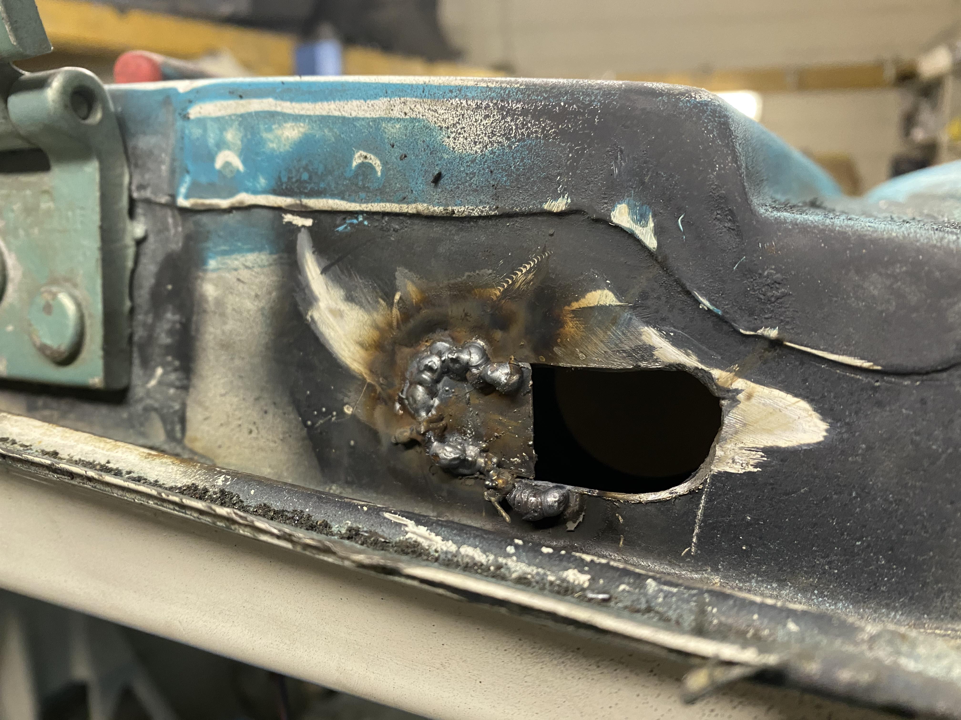

One little hole welded up and ground back. Just need to get some rust remedy in there now and an etch prime.

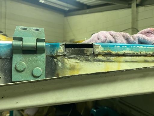

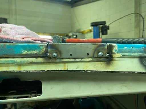

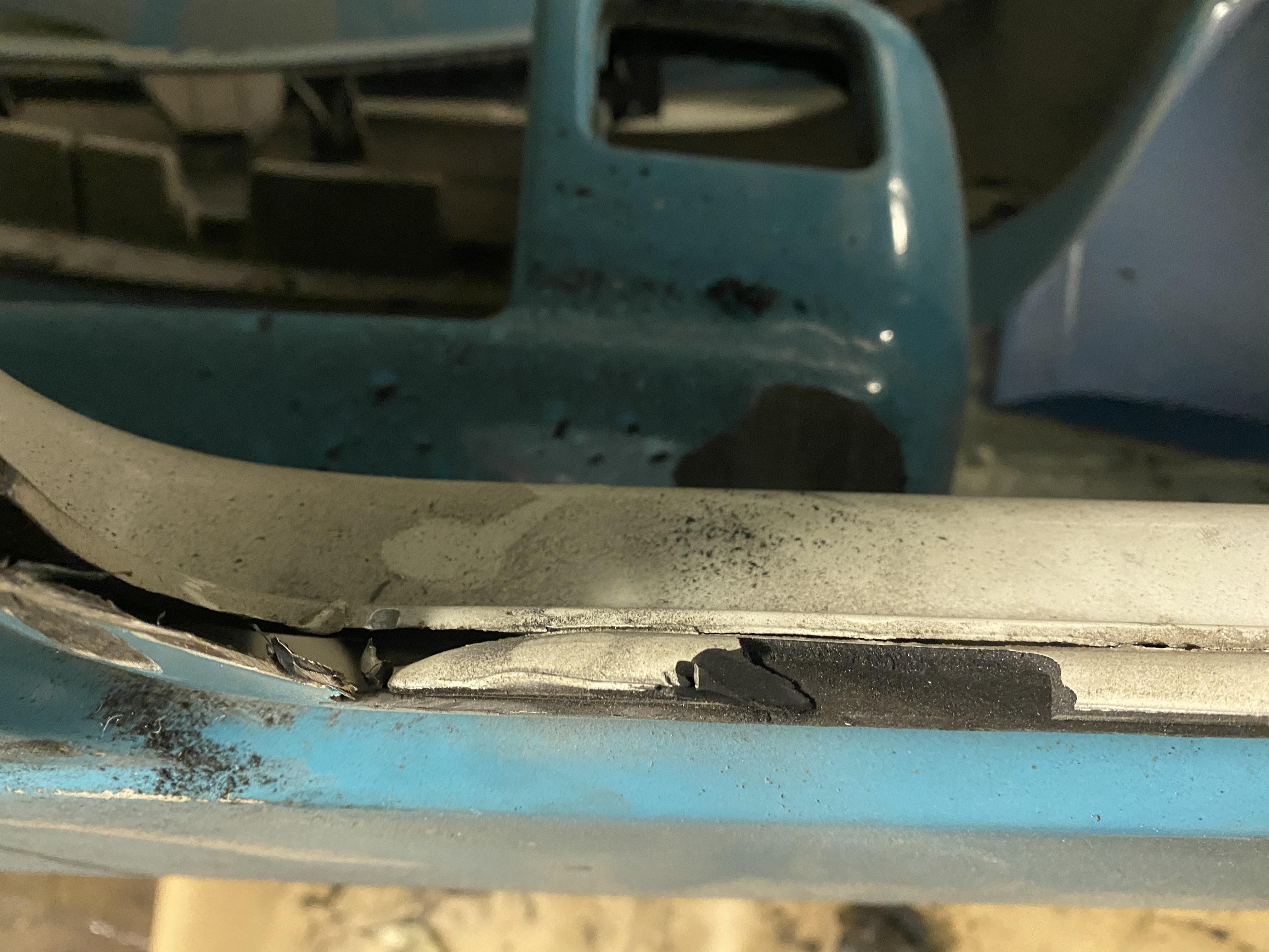

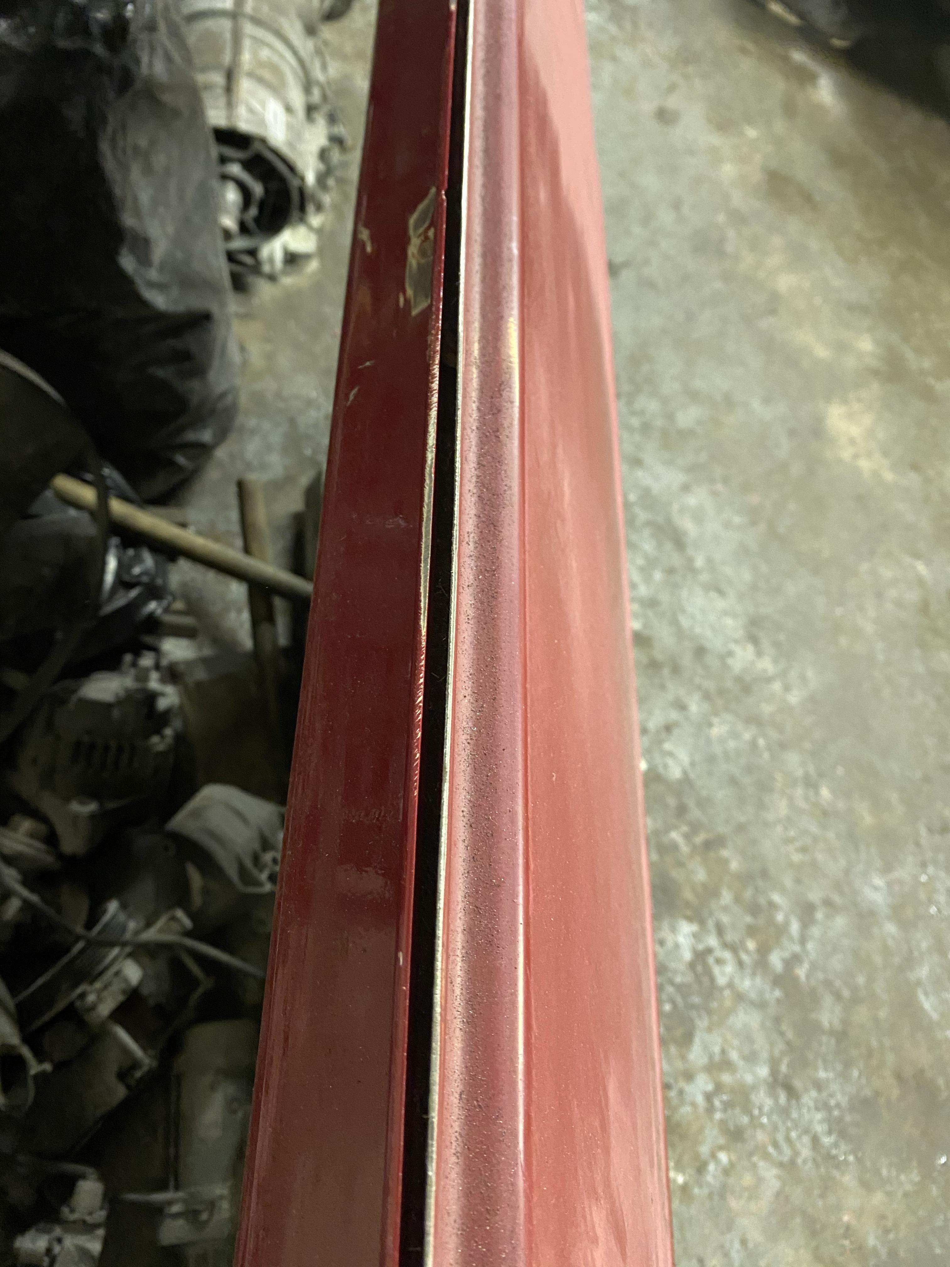

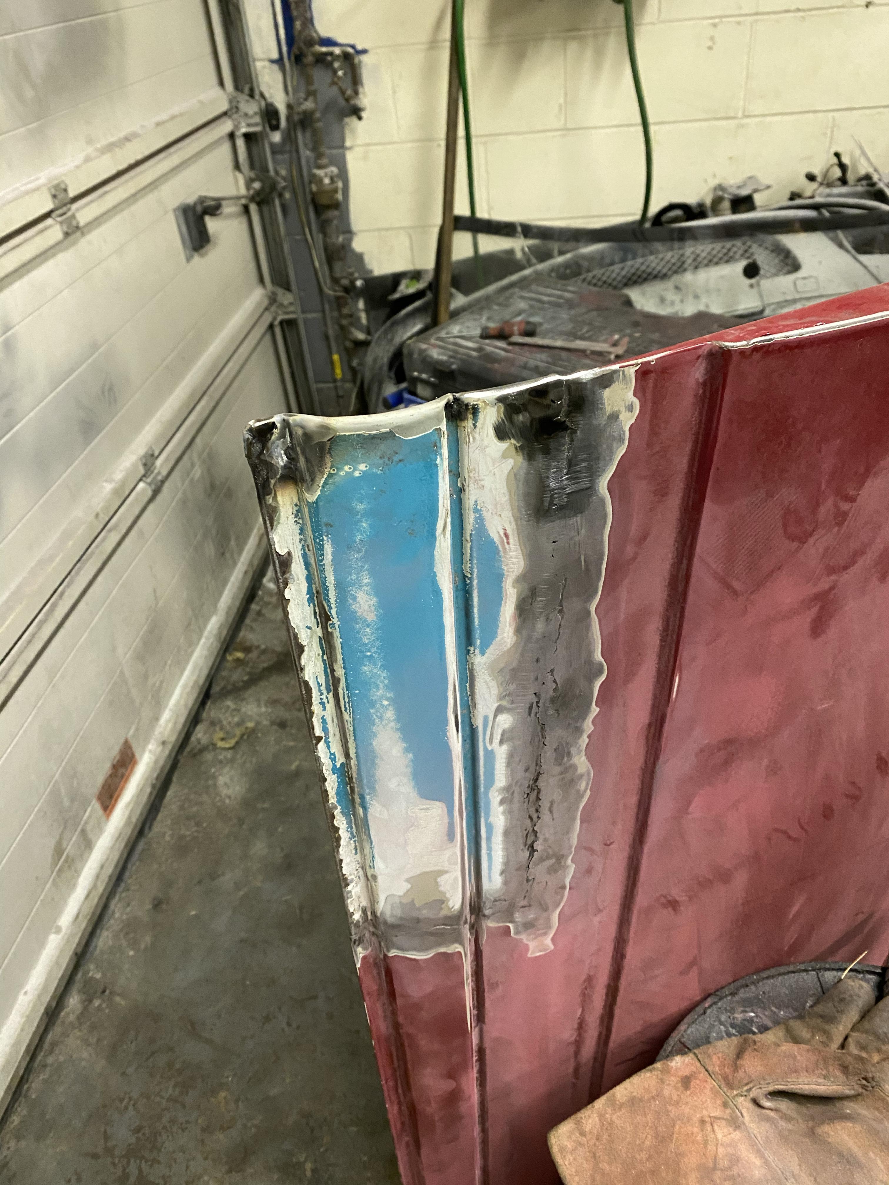

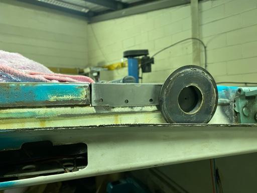

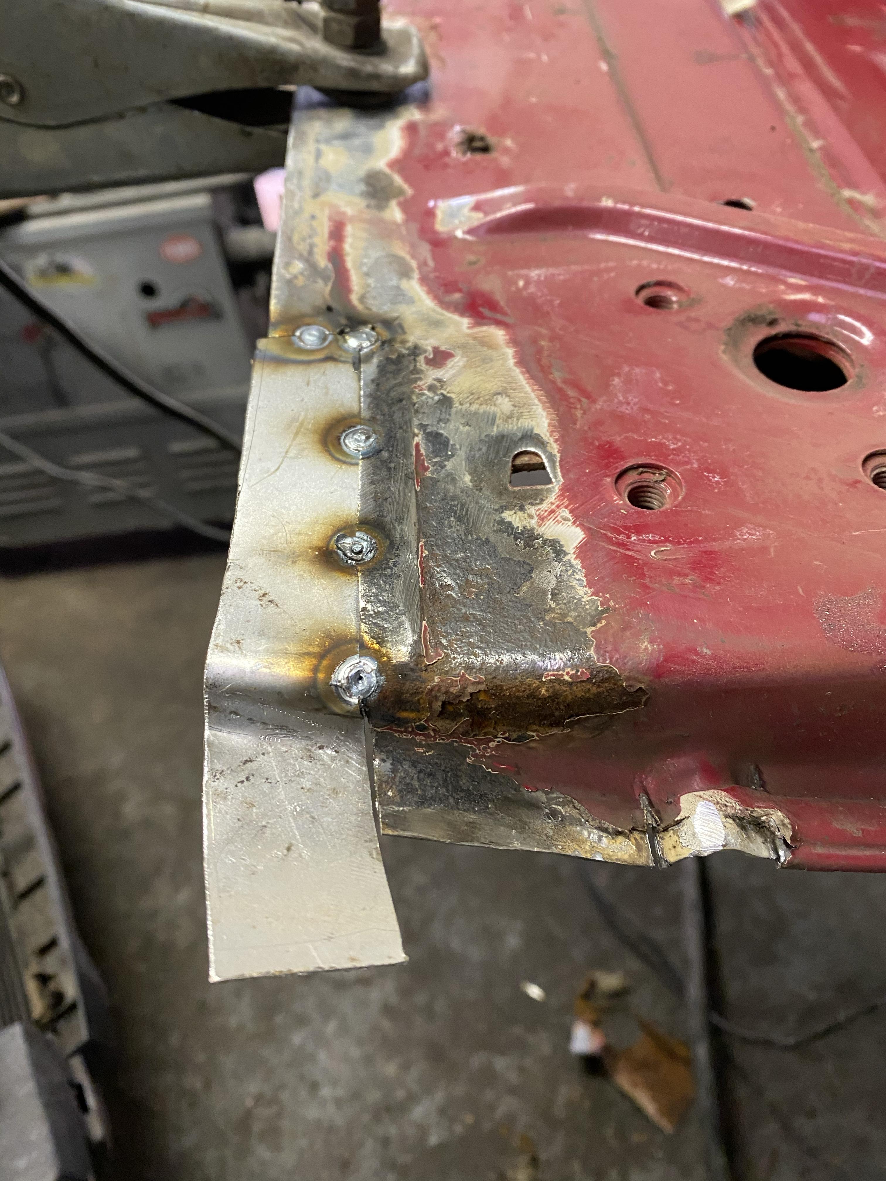

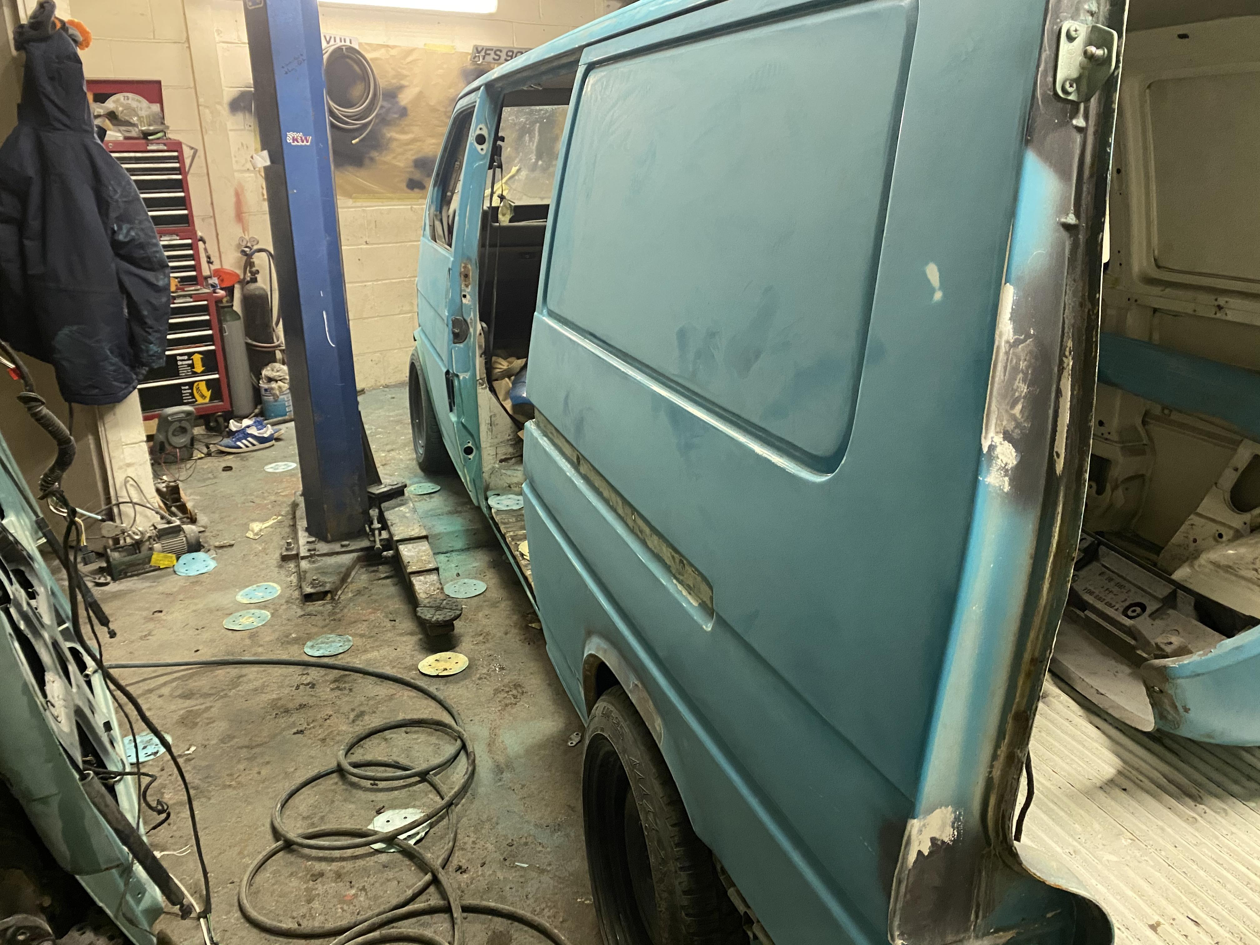

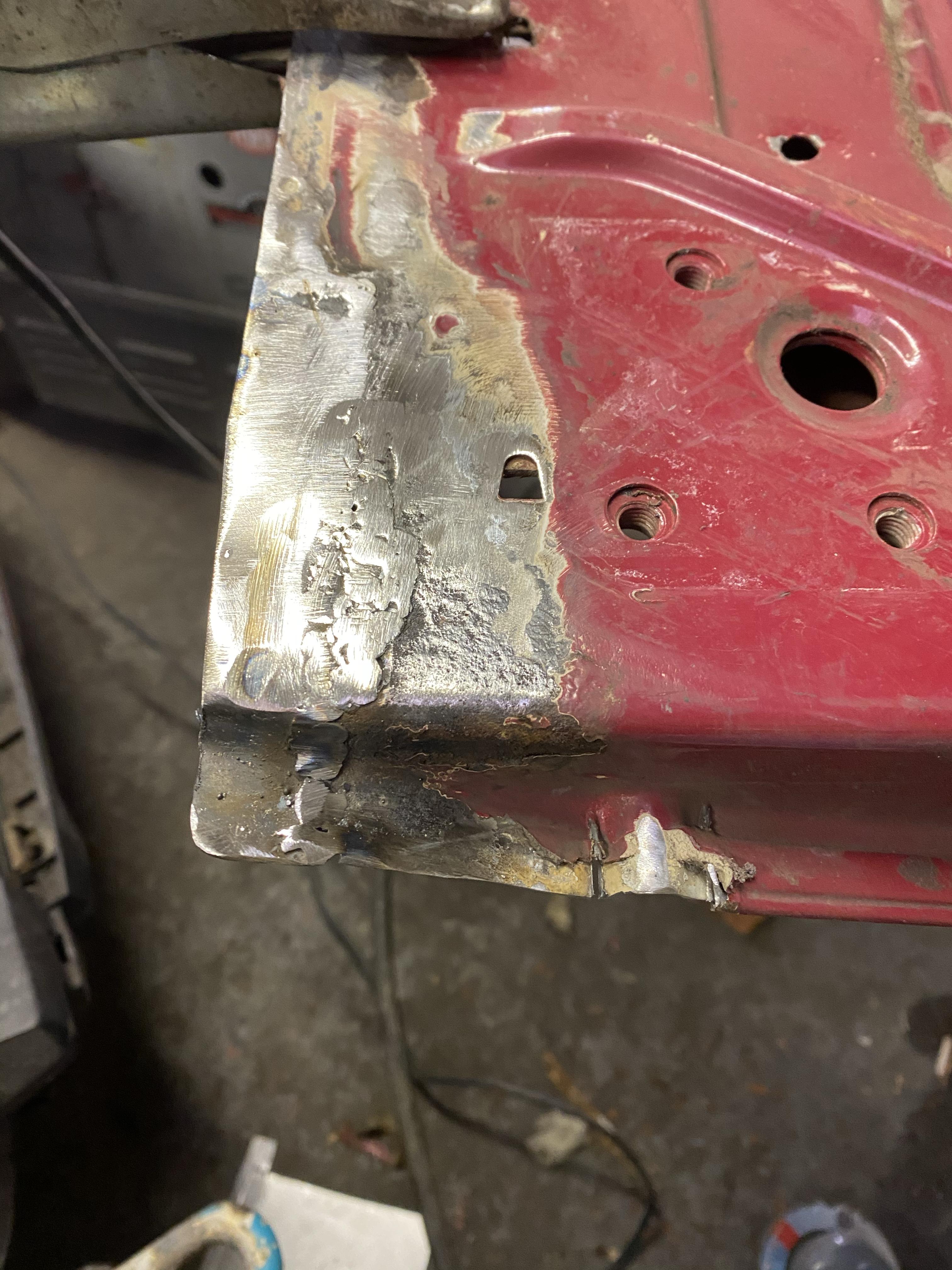

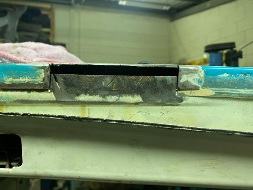

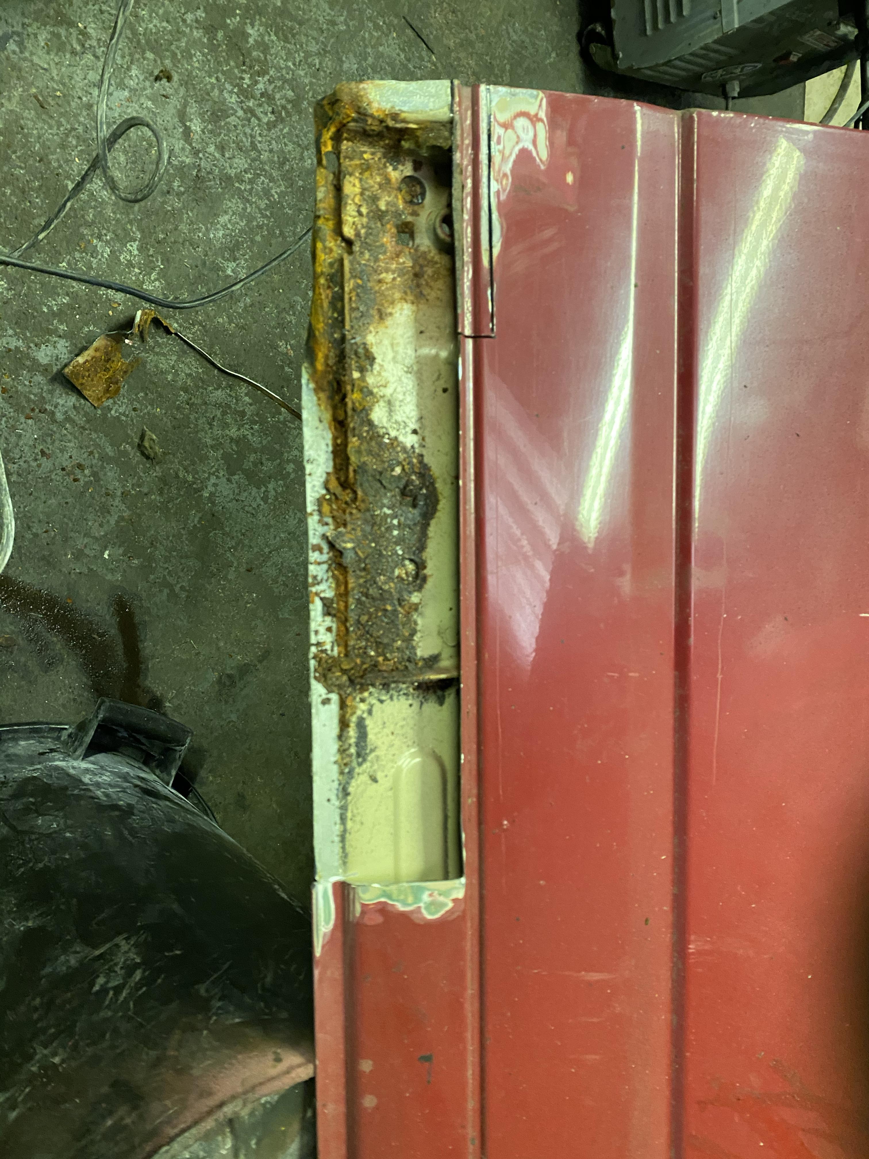

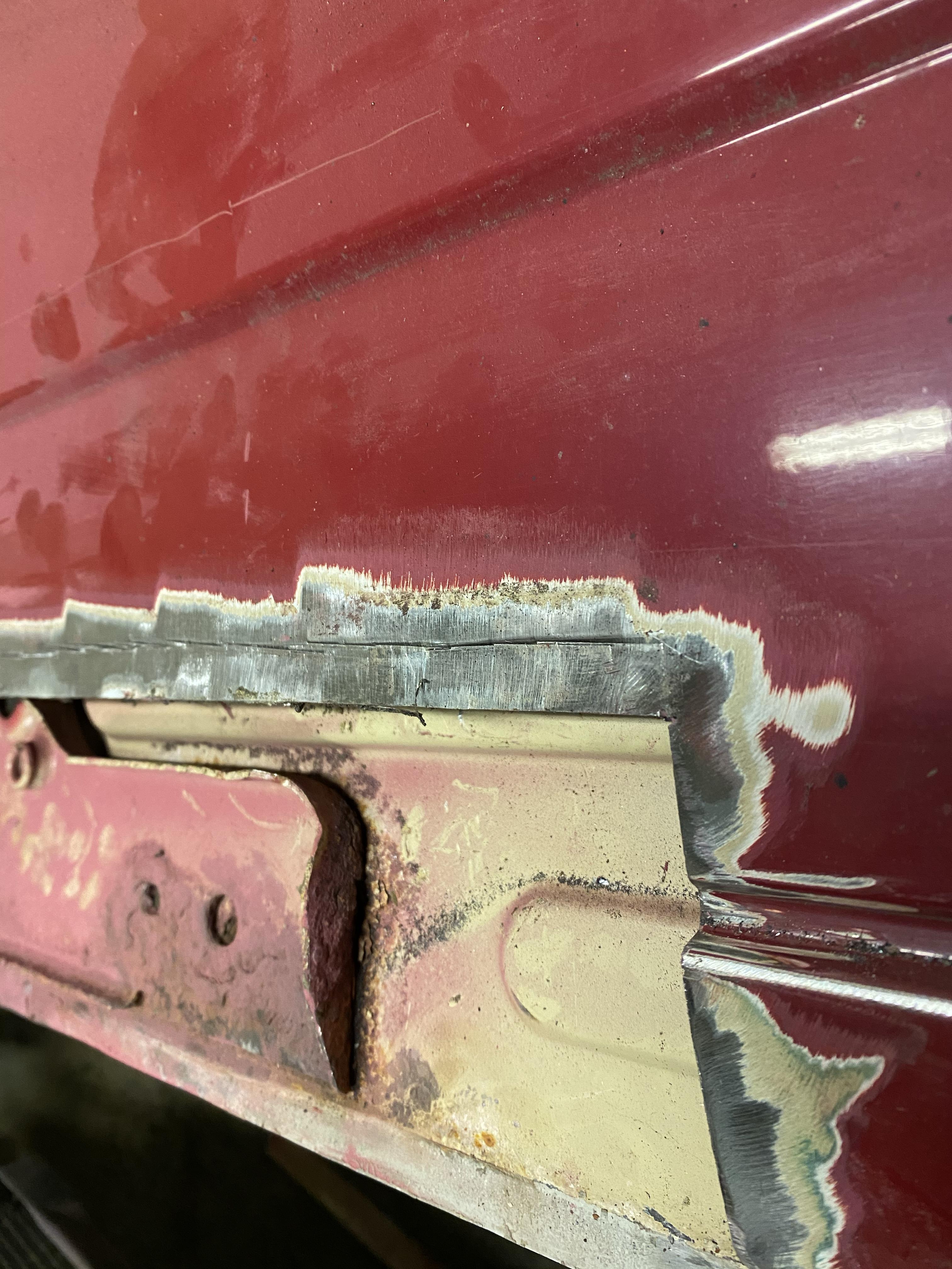

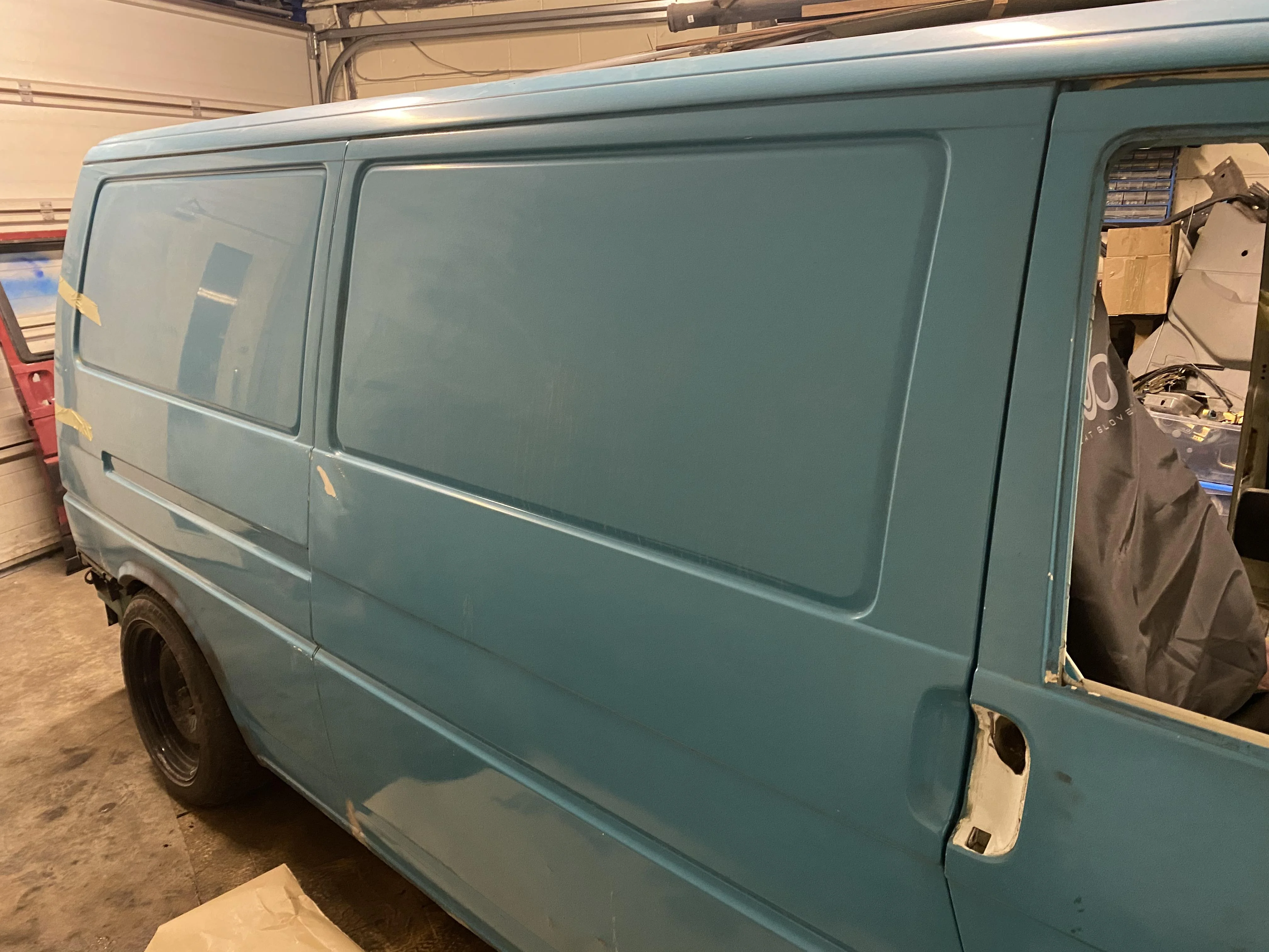

Second. I moved back to the sliding door. I was going to push out and repair the dent but got another door locally for £40. It has some rust in the same place as my door but no dent.
Lip repair section made up abs tacked in.
Fully welded and ground back with a flap wheel.

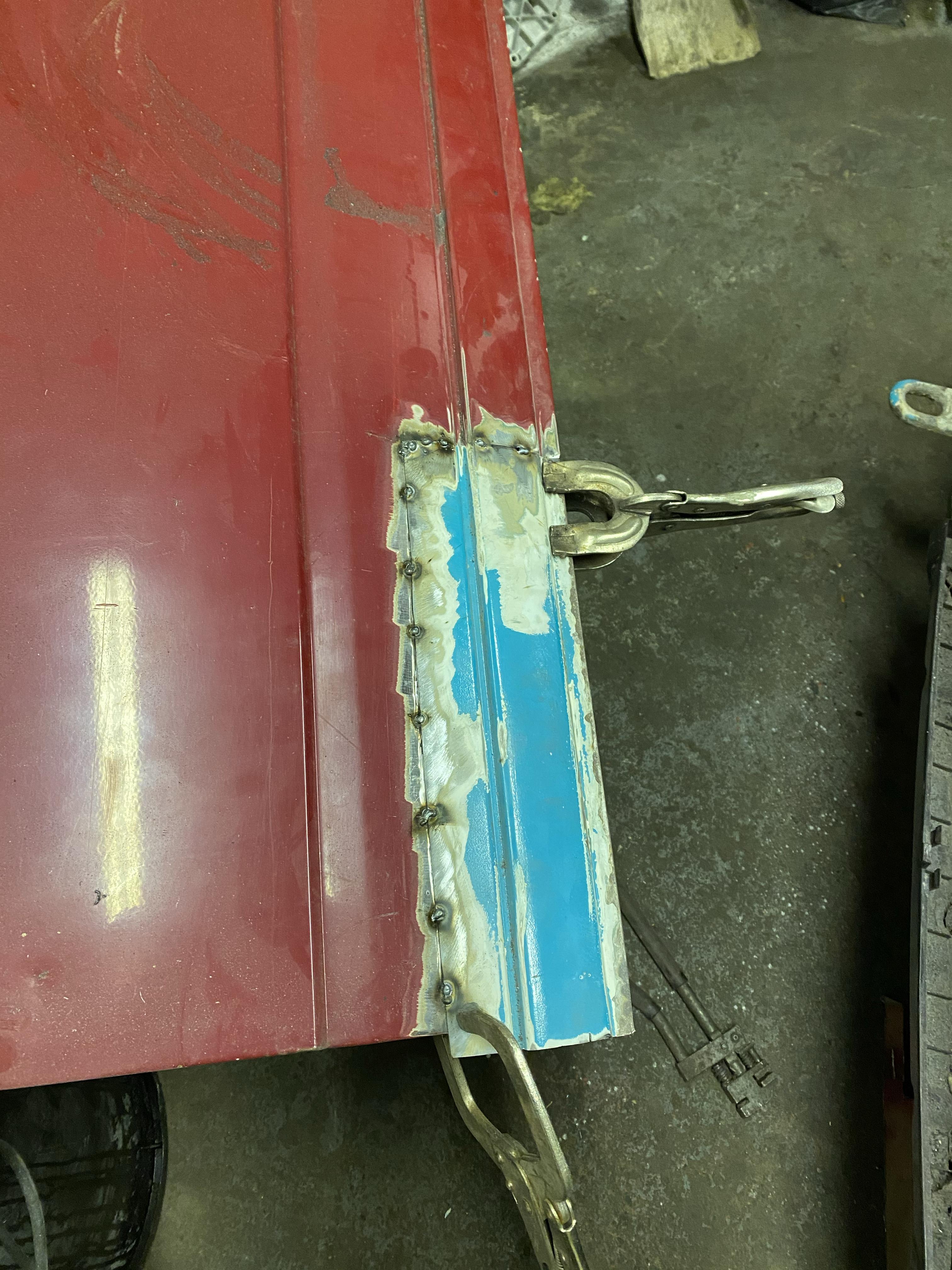

I then cut out this section from the middle of my other door a will weld that in tomorrow to finish it off.

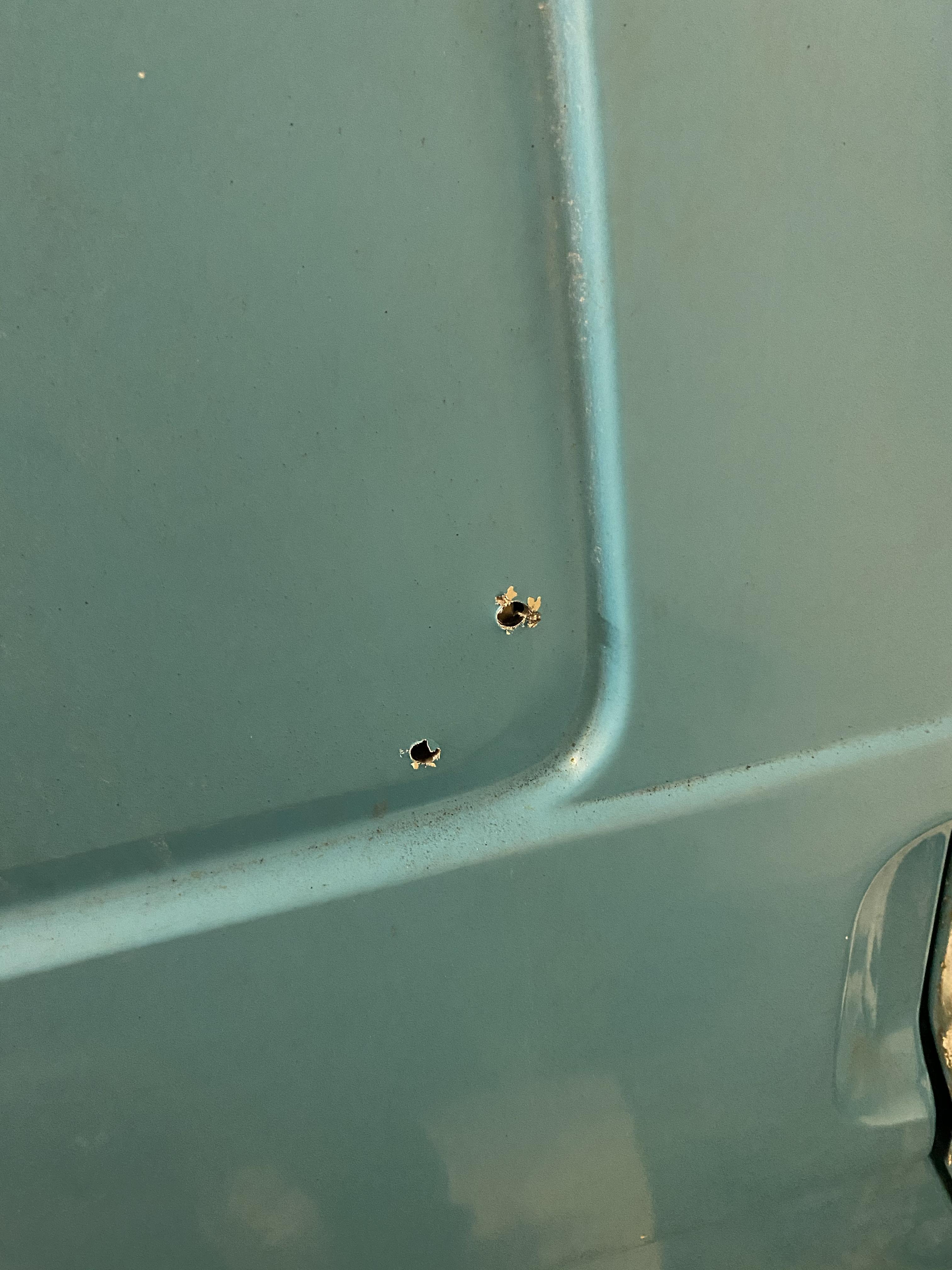

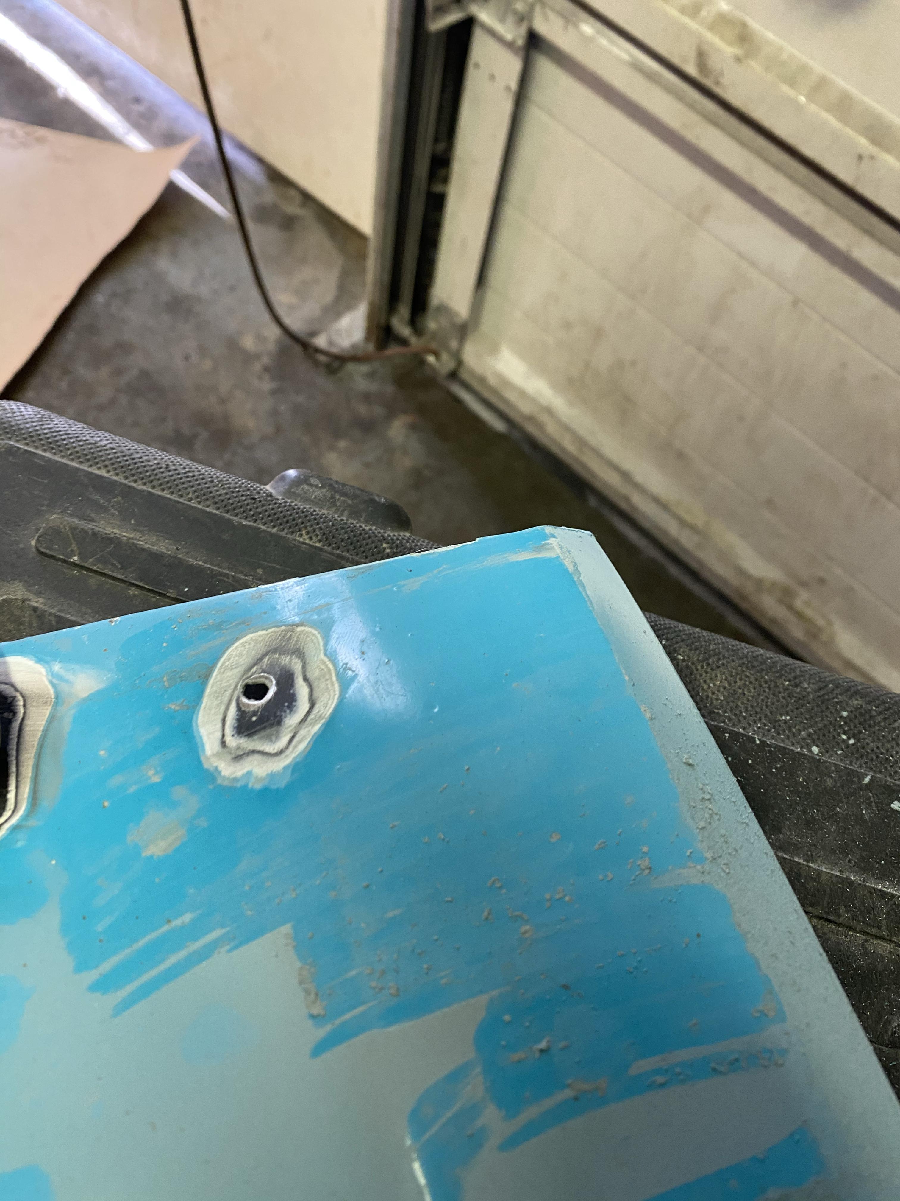

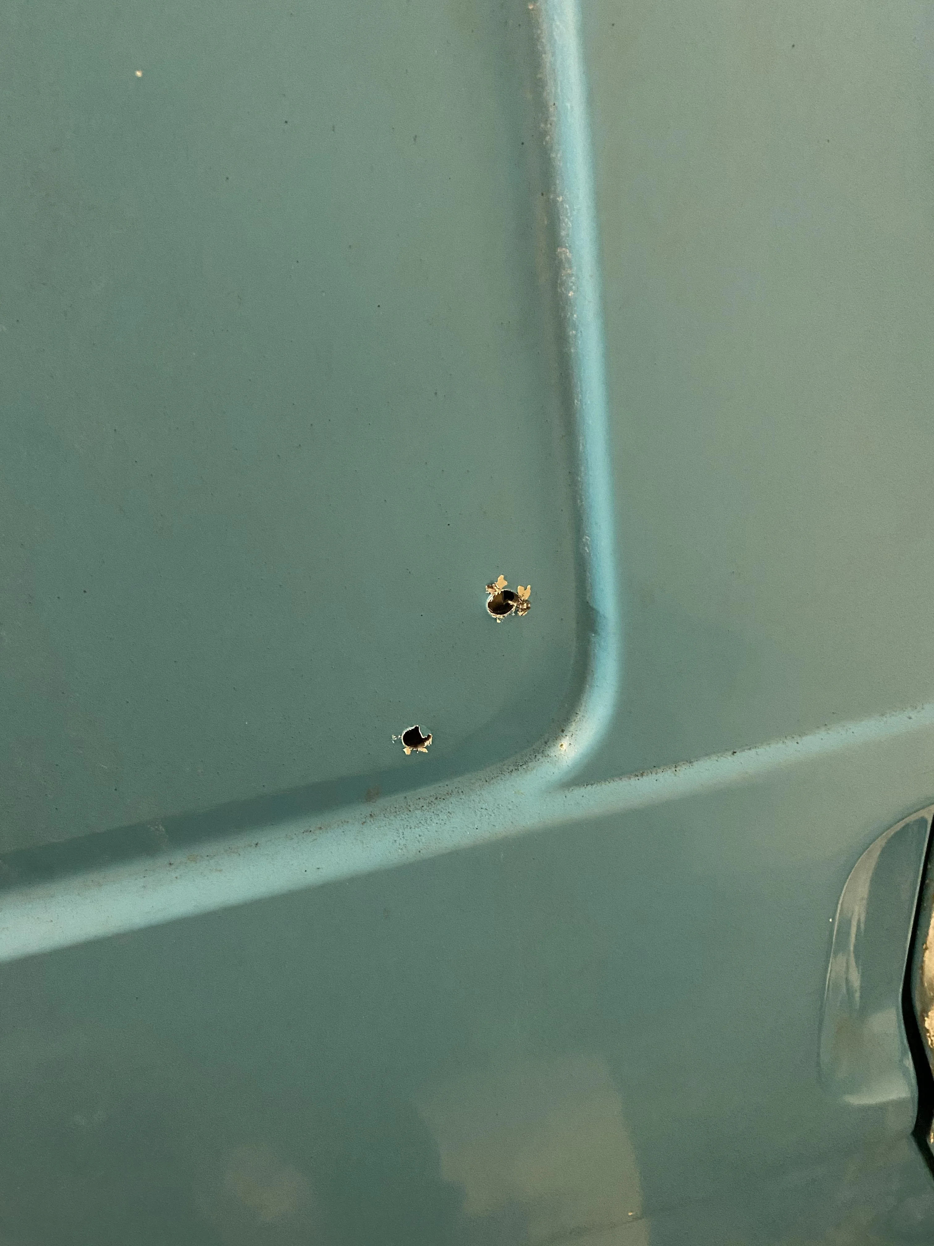

And finally. I had two little holes in the front panel from the previous owner fitting two eyelets.
Ground back. Welded then flap disc to make it smooth.

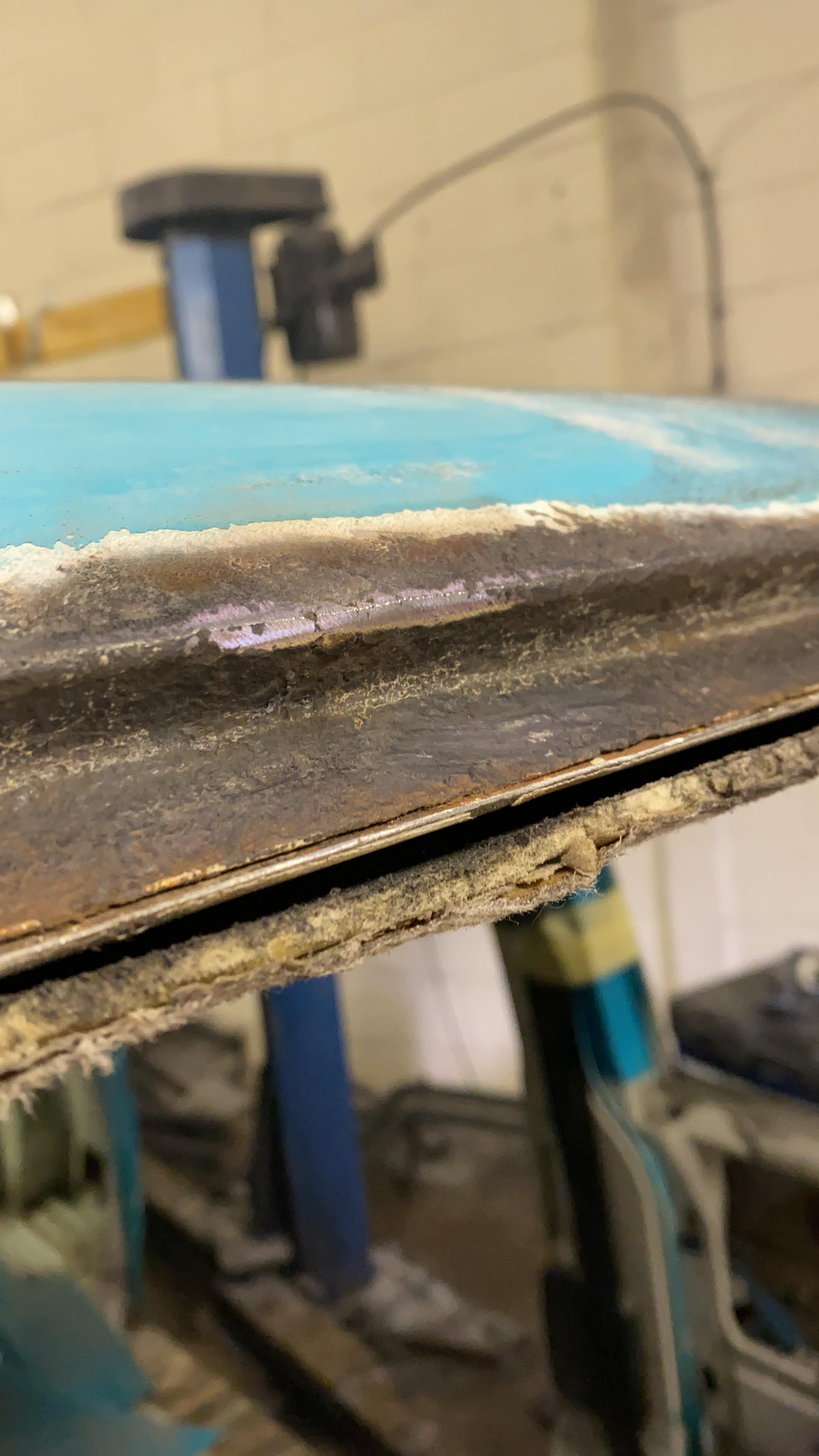

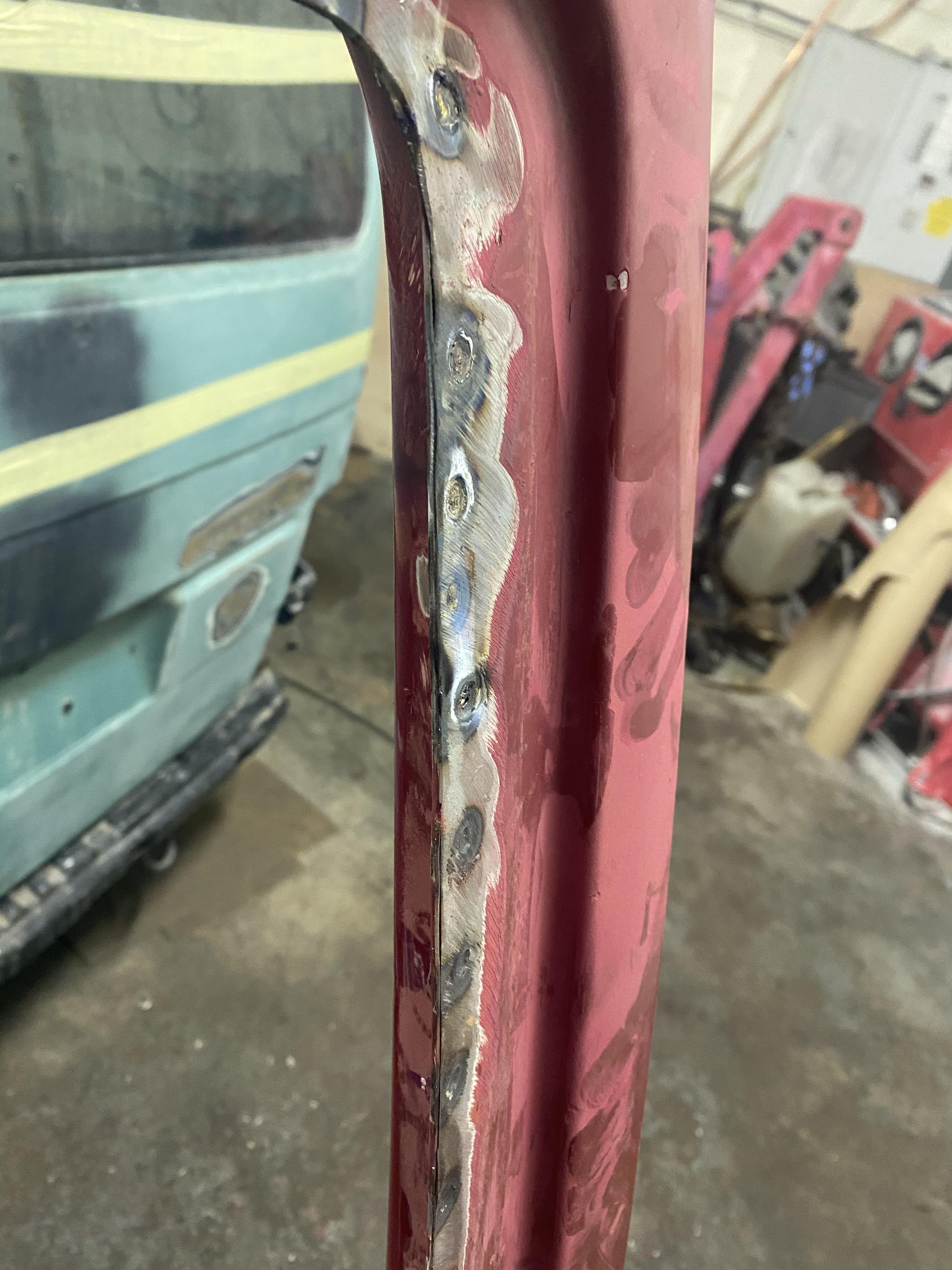

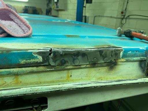

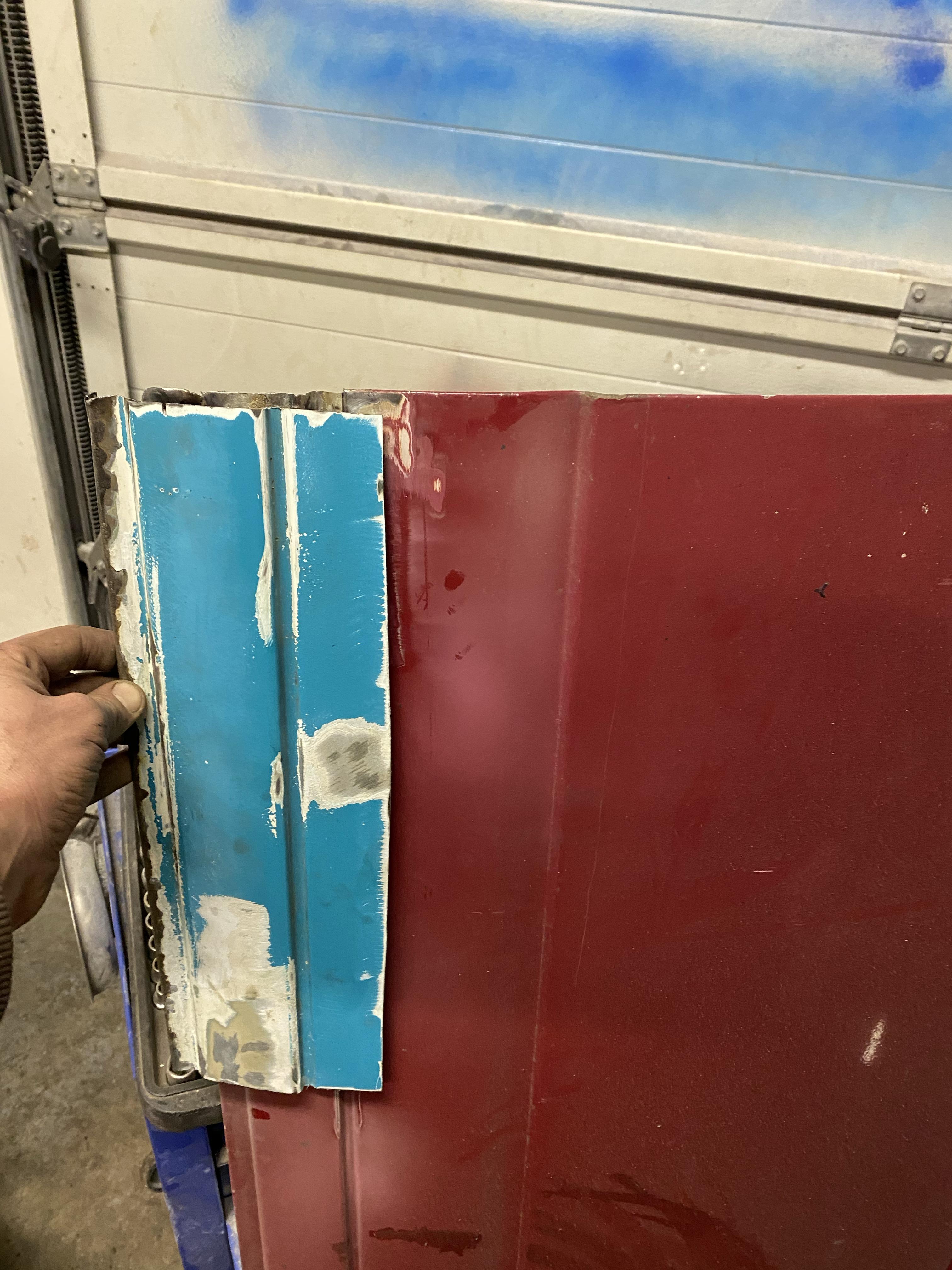

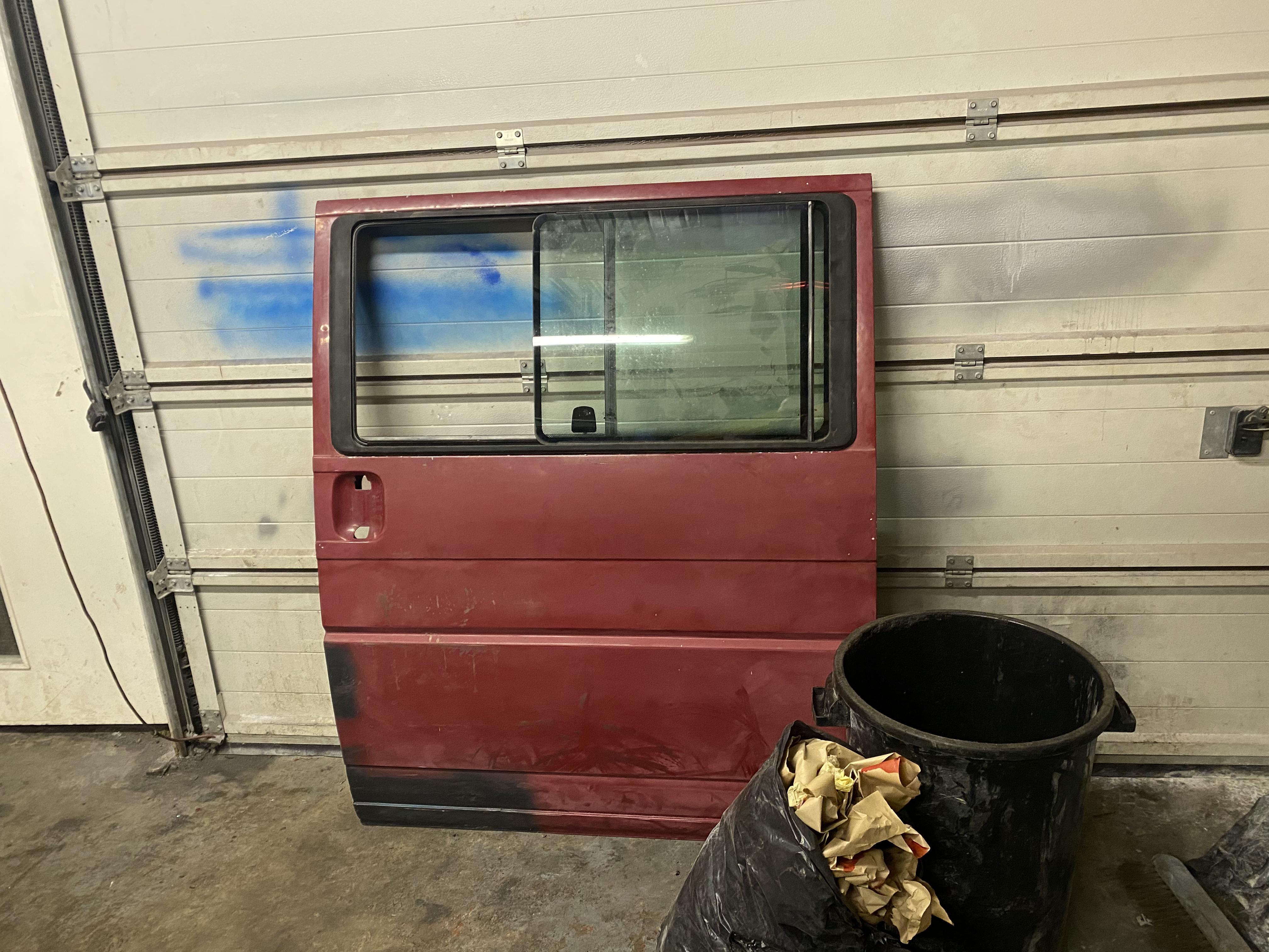

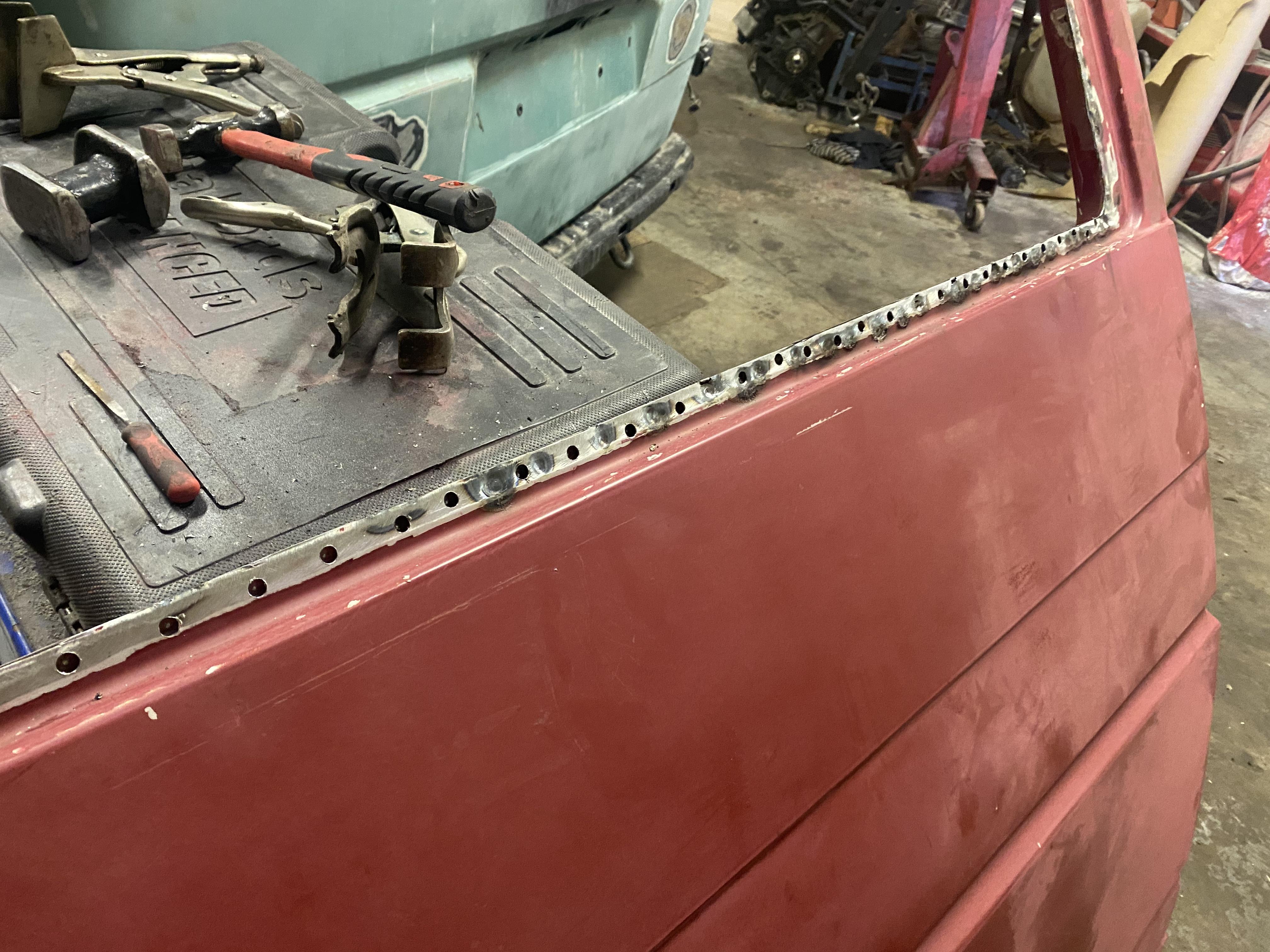

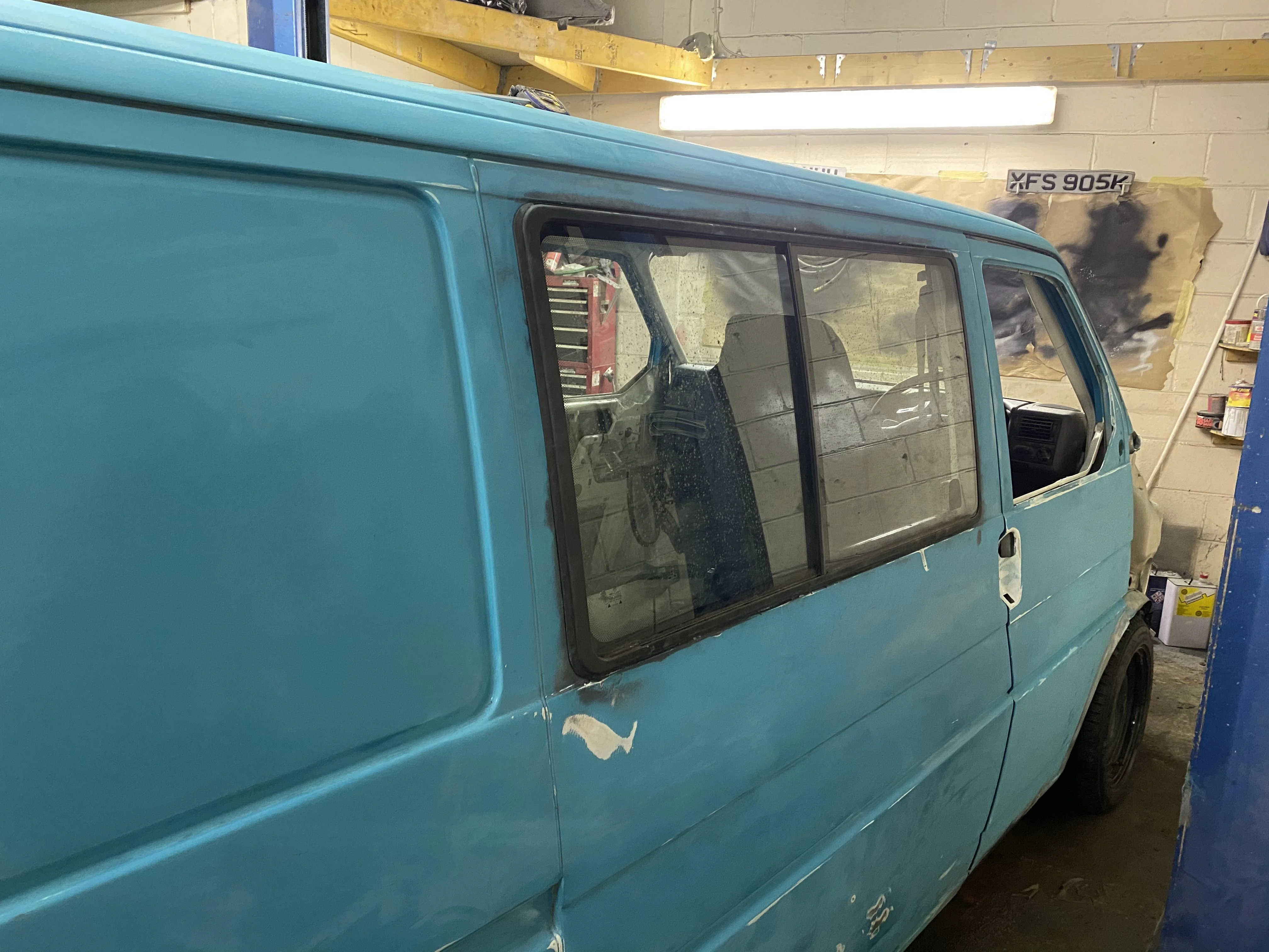

Sliding door almost finished. Just the window to fit. I bought 2nd hand VW caravelle windows. Which are a bit more complicated to fit that aftermarket windows.

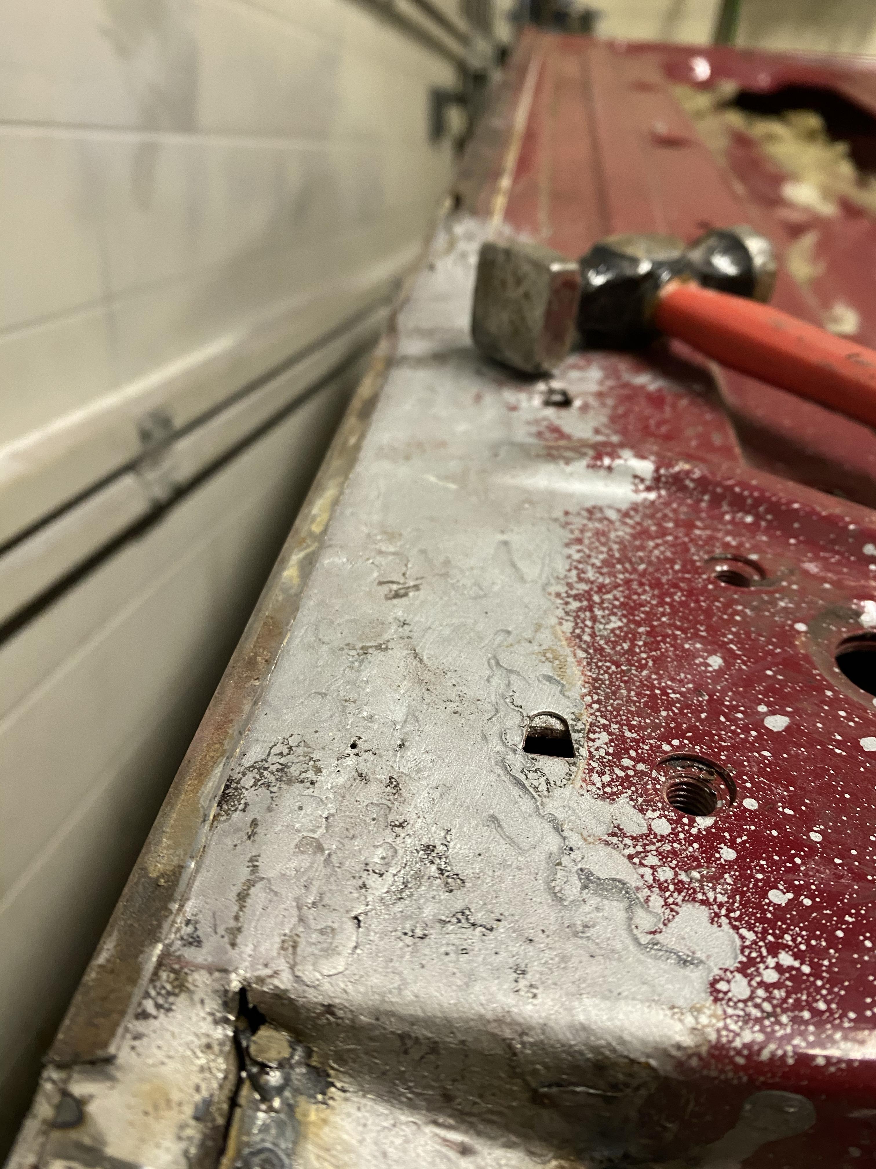

First I cut the skin out. But as you can see there is a gap between the inner and outer skins. If you just try to fit the window. It will sit proud.
So first you have to hammer and dolly the out skin flat. Then you can grind the paint back and spot weld it together.
The bottom edge wouldn’t spot together. So I drilled a load of holes and got the MIG out the plug welded it.

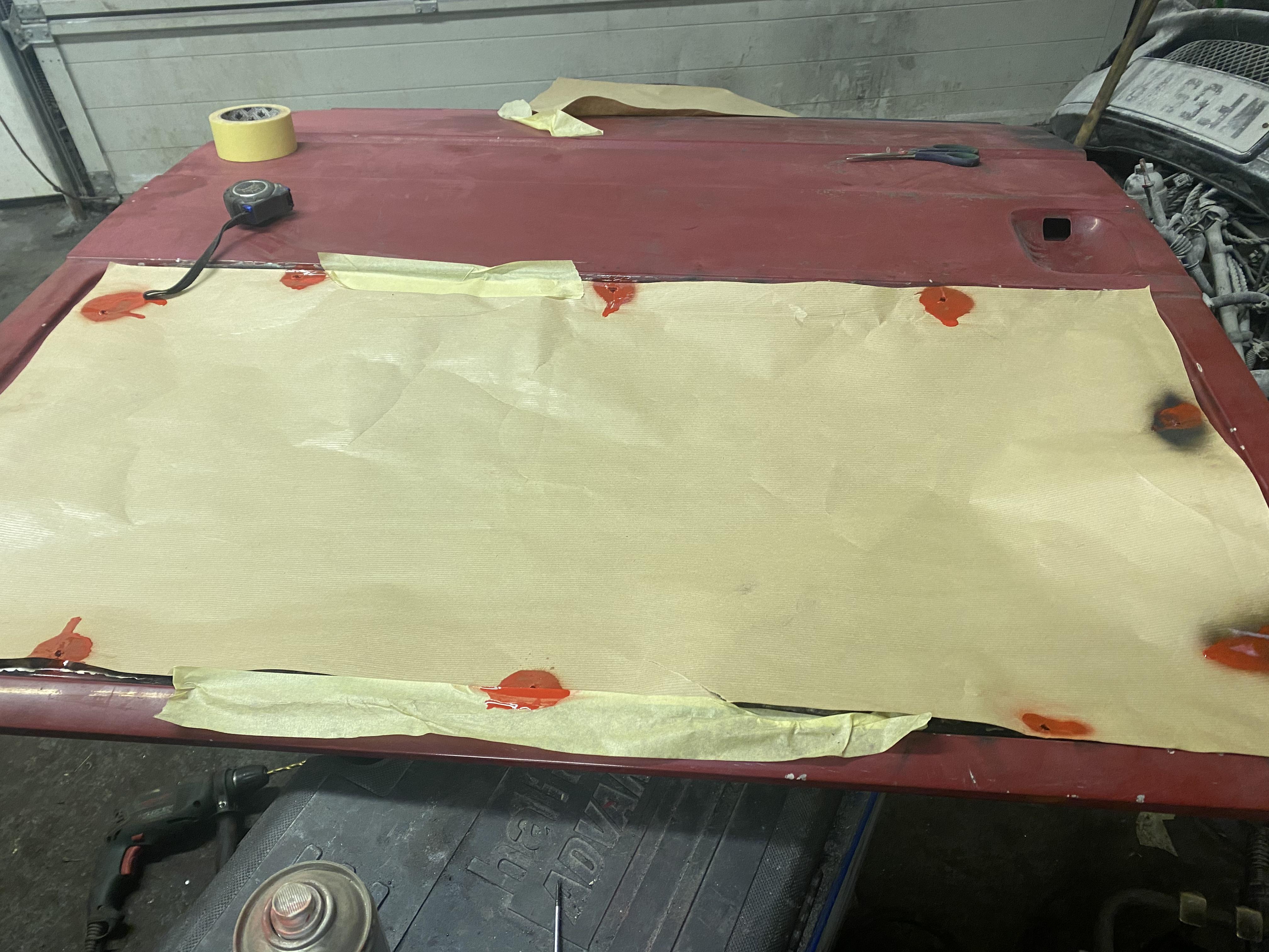

Then I quick template and some red paint to mark through for the drill marks.
And finally 10 holes like this welded up and ground back (they were for an insulated panel I removed.
And it’s in. Fit is pretty good. It needs to come in a tiny bit at the bottom. Will be a combination of dressing the welds back and more hammer and dolly to get it perfect.
All in was 3-4 hours work I think.

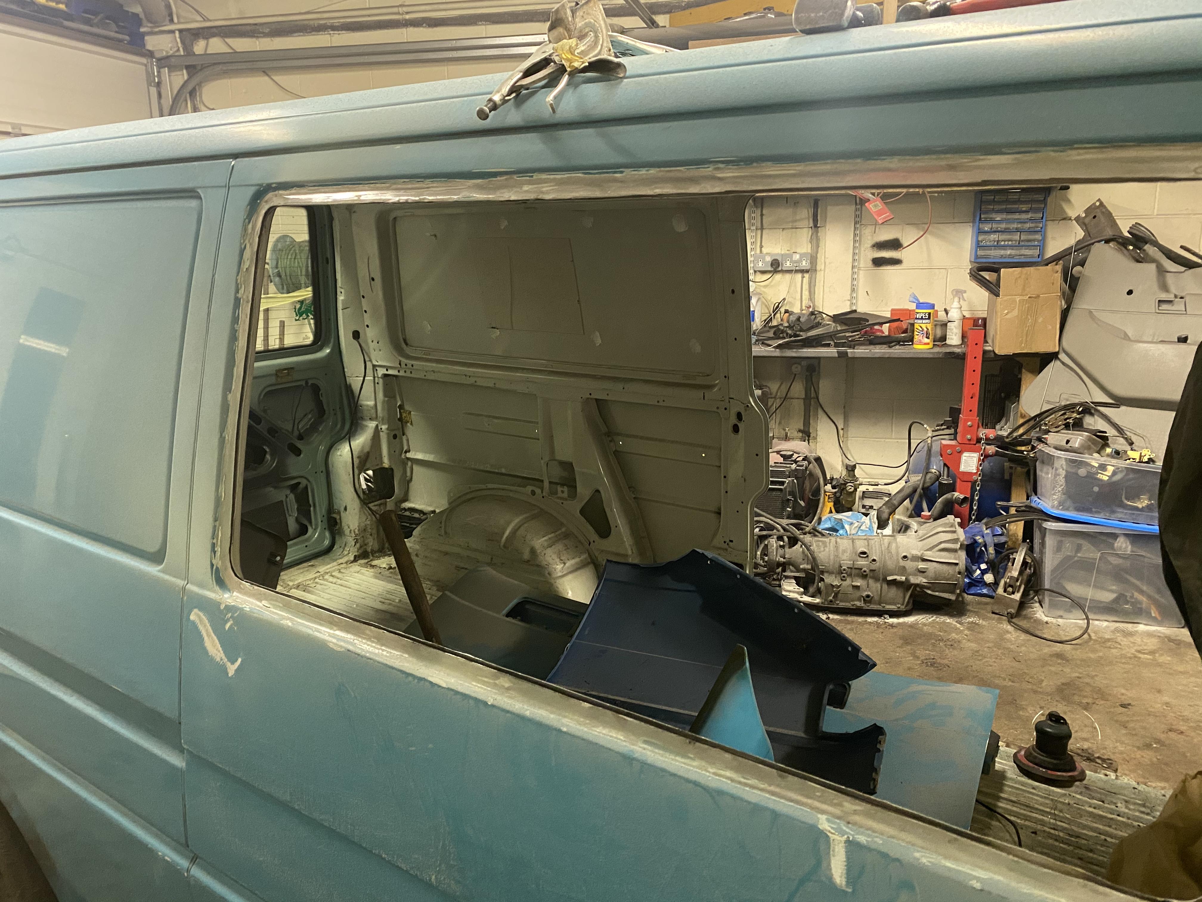

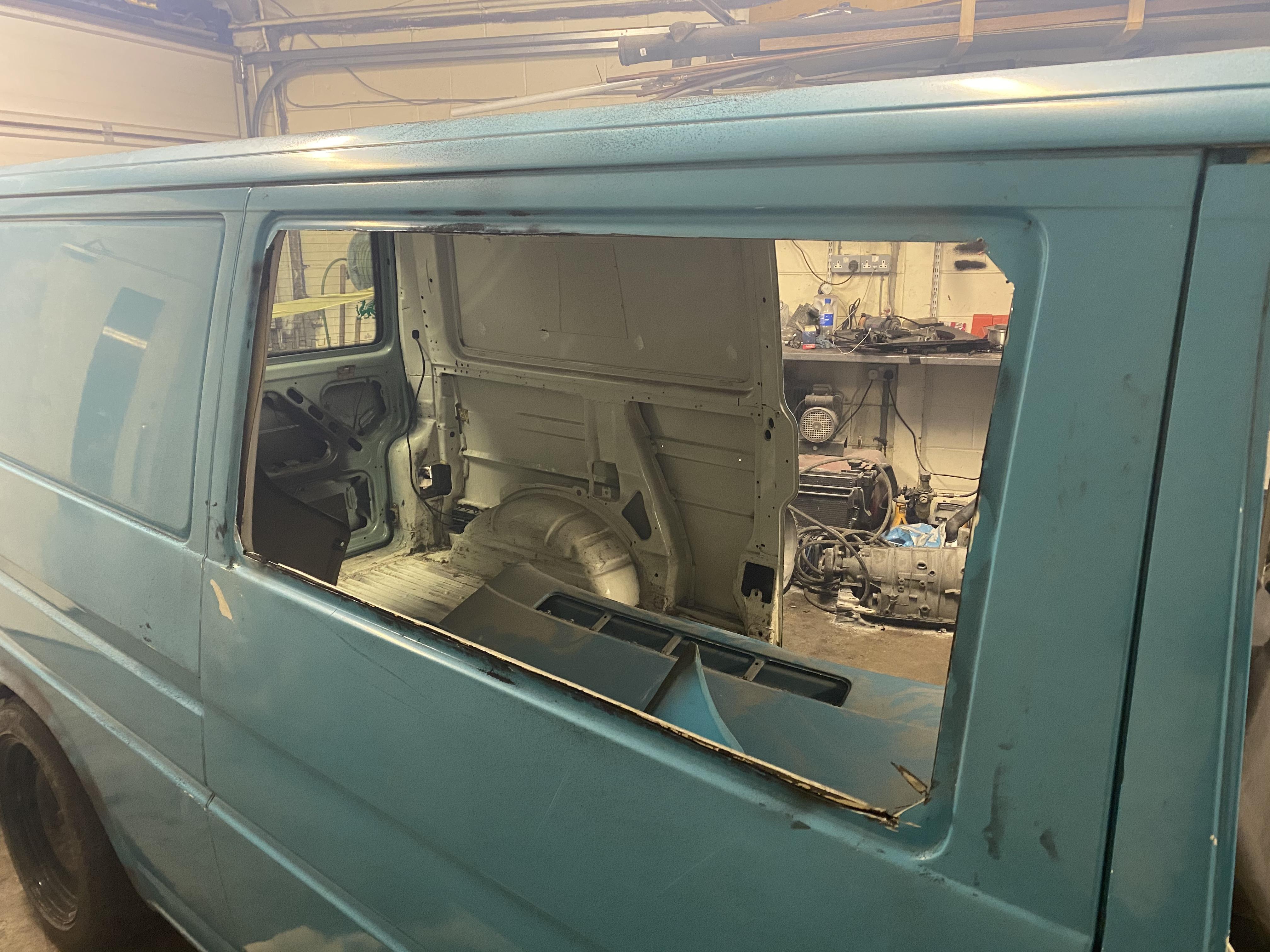

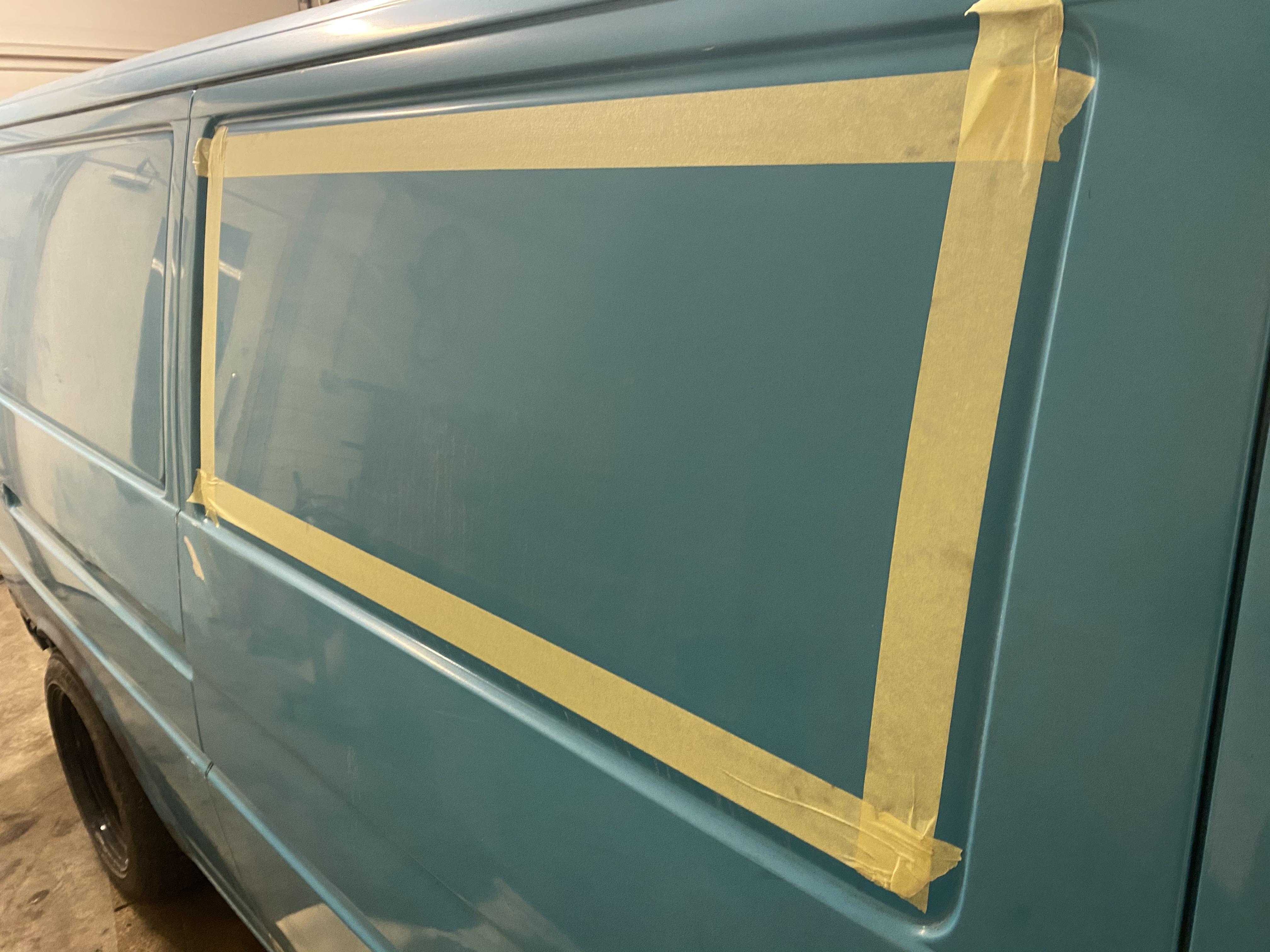

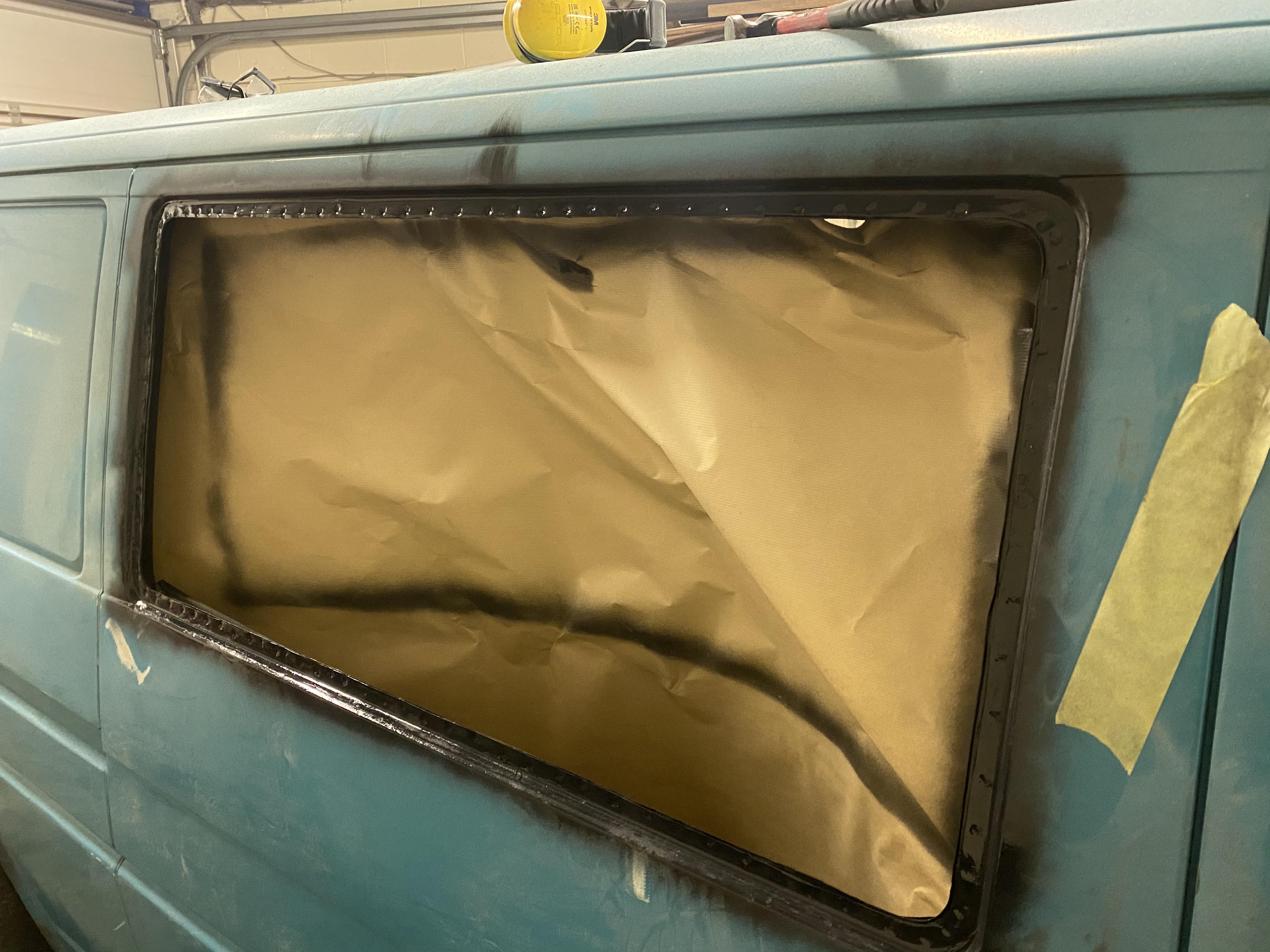

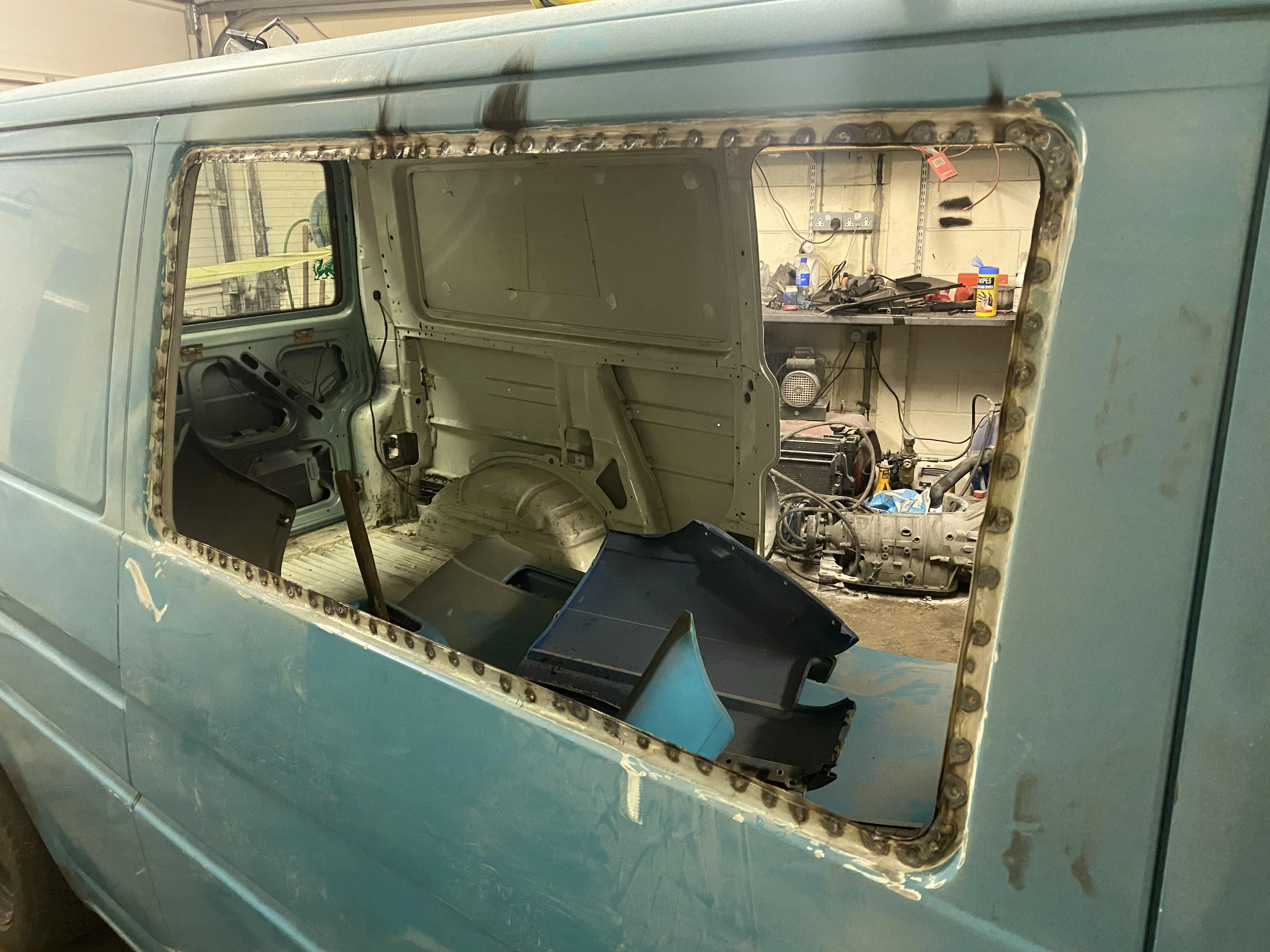

So two hours start to finish that’s the off side window aperture done.
Started like this.
Pilot holes first.
Then a straight edge using the masking tape.
Roughly cut out.

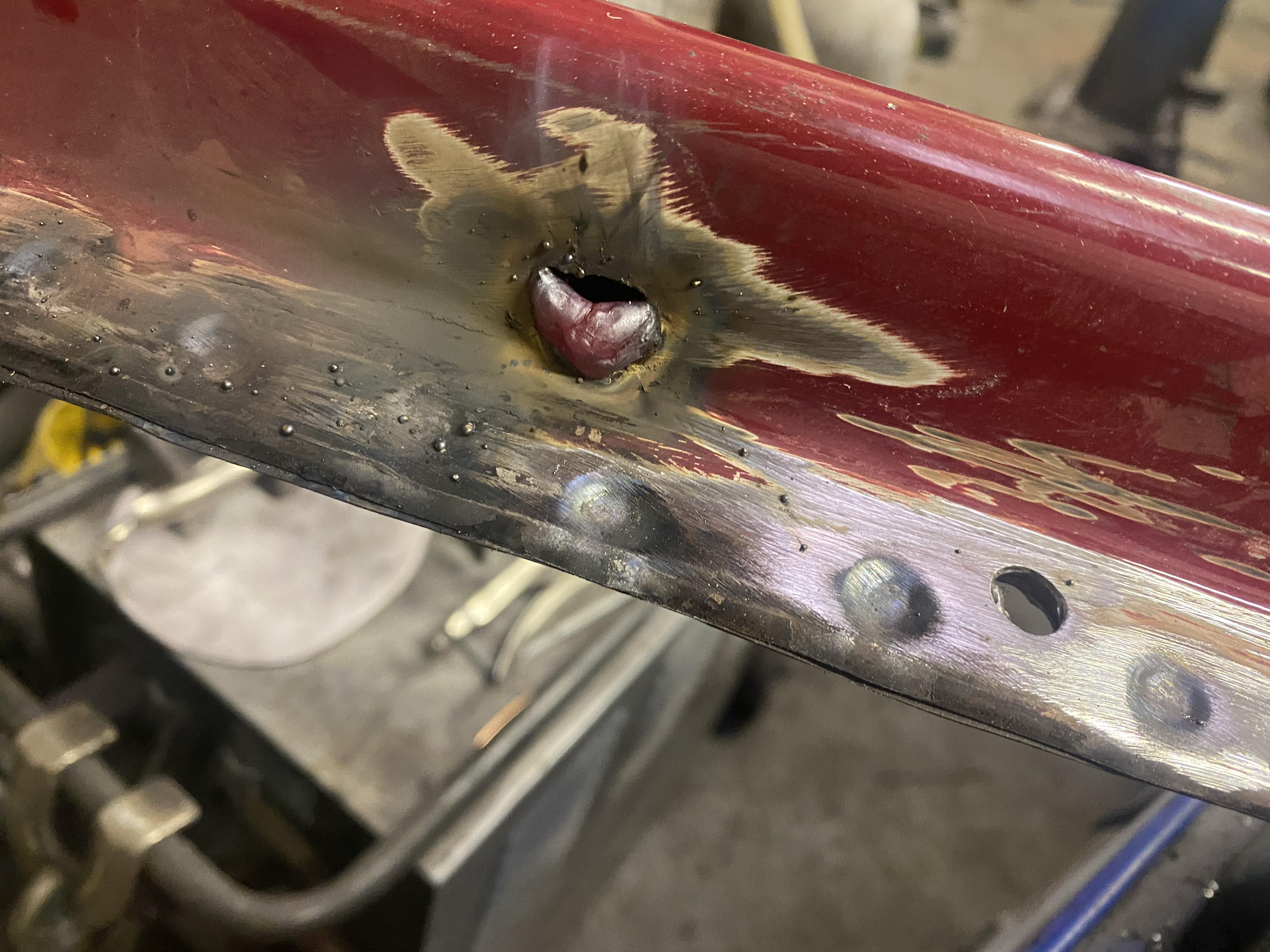

I then dressed back the sharp edges and picked this sealer out between the inner and outer panels. Cut myself in the progress.

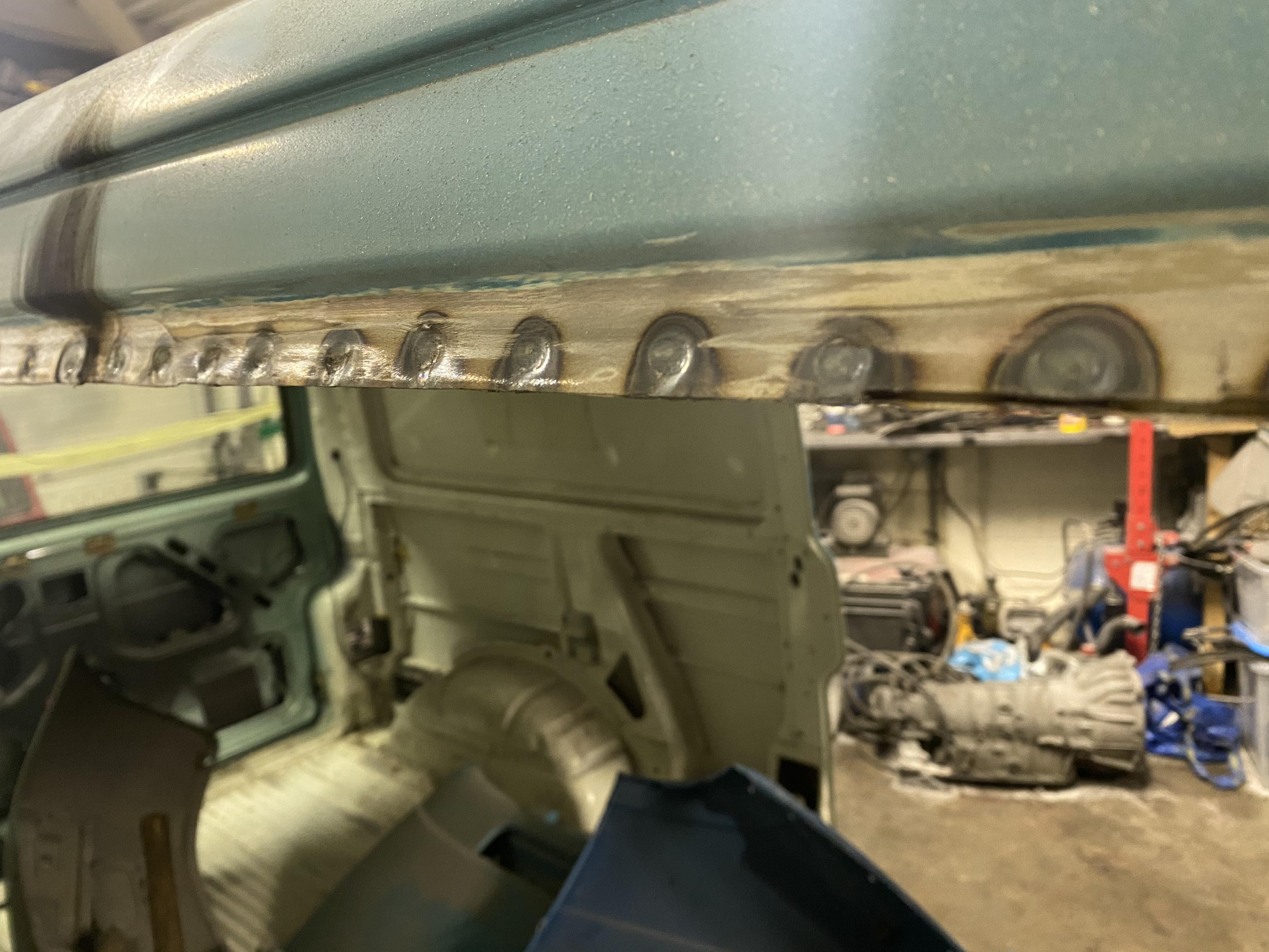

Paint all stripped off and ready for spot welding.
Some decent spot welds. This is so much quicker than plug welding. Also less messy and noisy. But it’s a heavy bugger so a bit of a workout.
All done.
And some etch primer to finish. I’m very happy with it. A lot quicker that the other side and the end result looks factory. Just 10 holes to drill in the right places for the window to bolt in. That’s for another night.

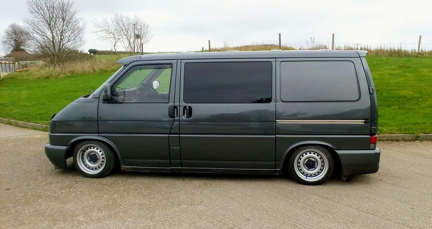

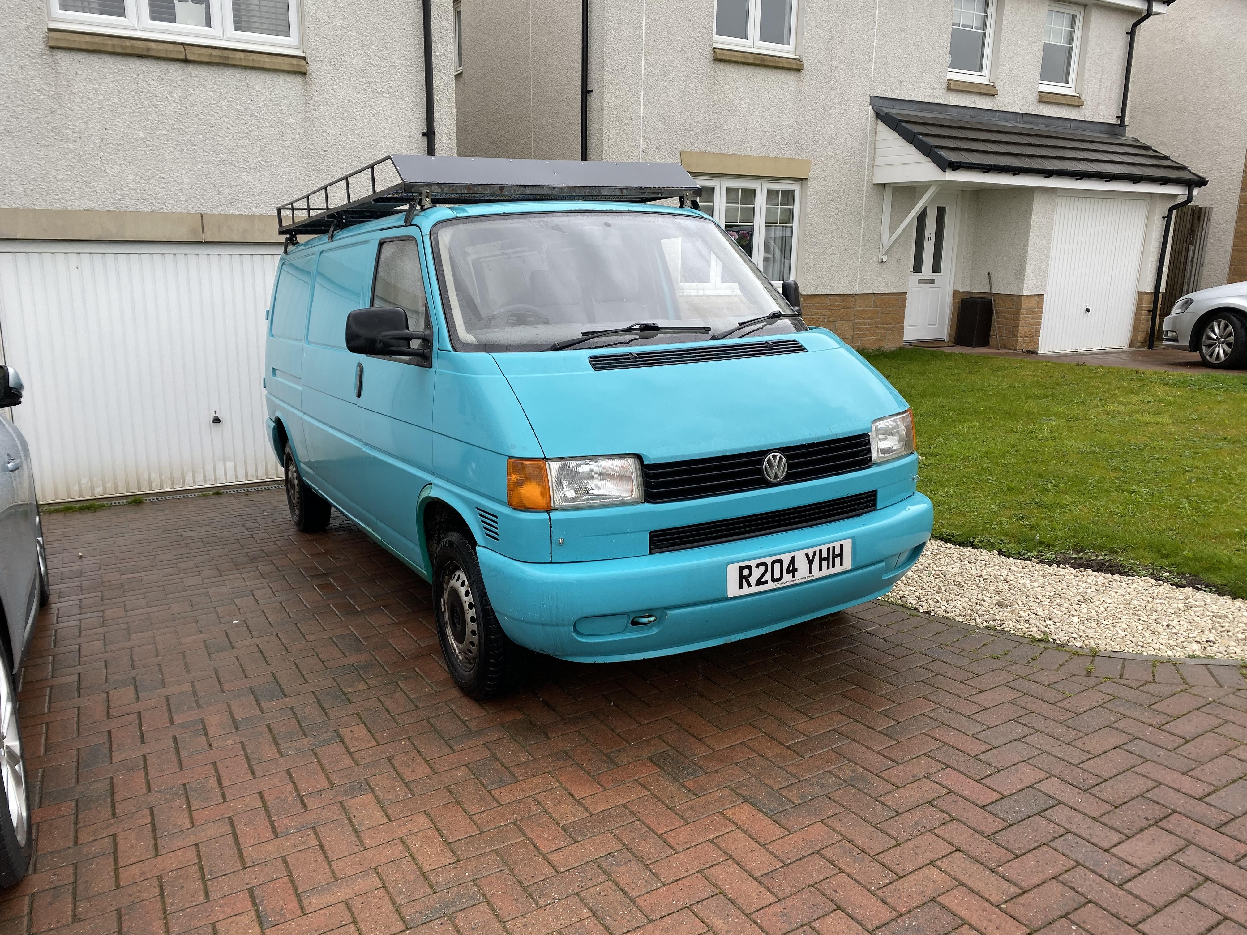

Colour the Van is now. I think it’s close to VW pistachio green.

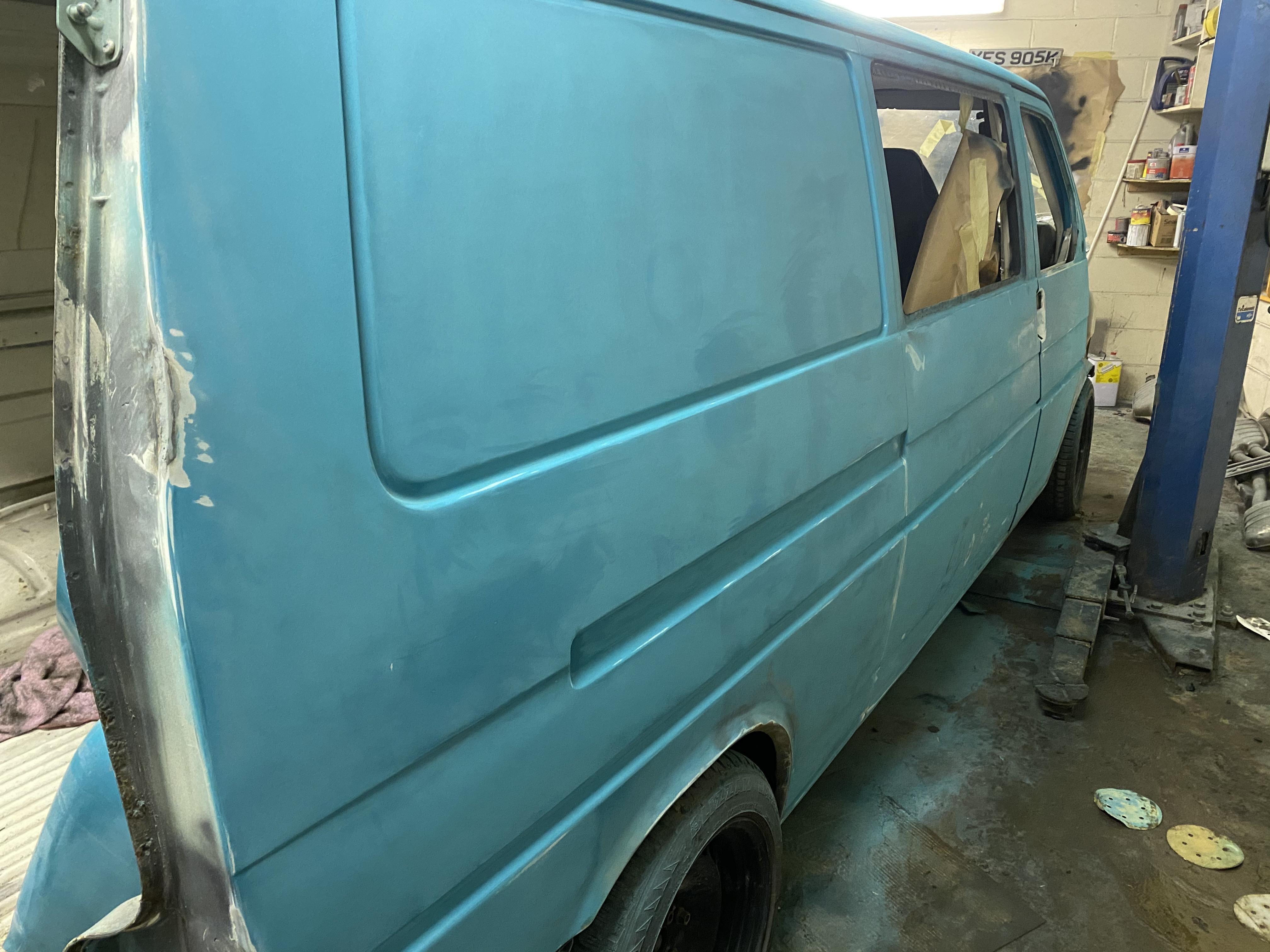

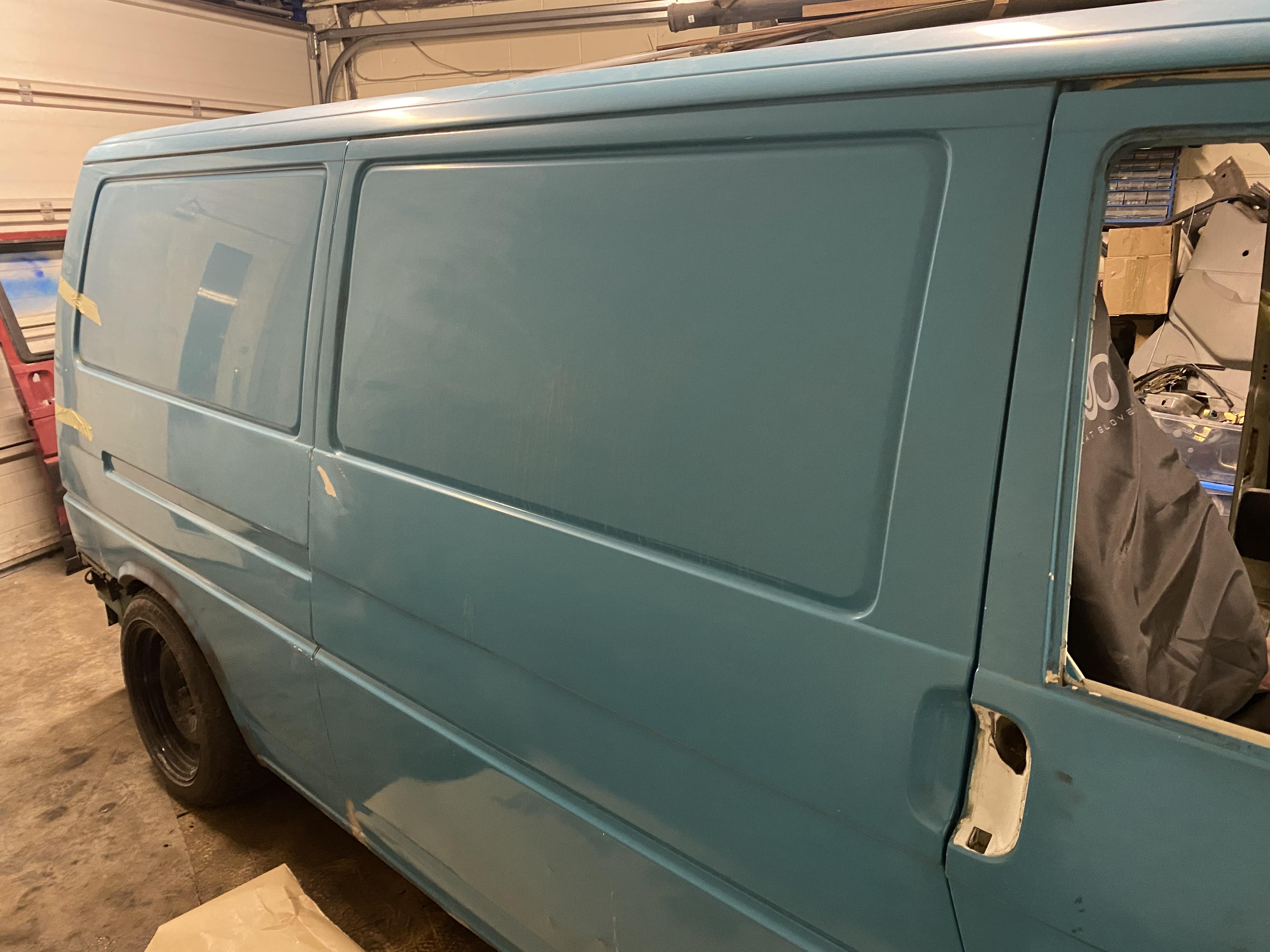

A few hours tonight just sanding the body. Both sides of the van done in 240 grit in the DA.

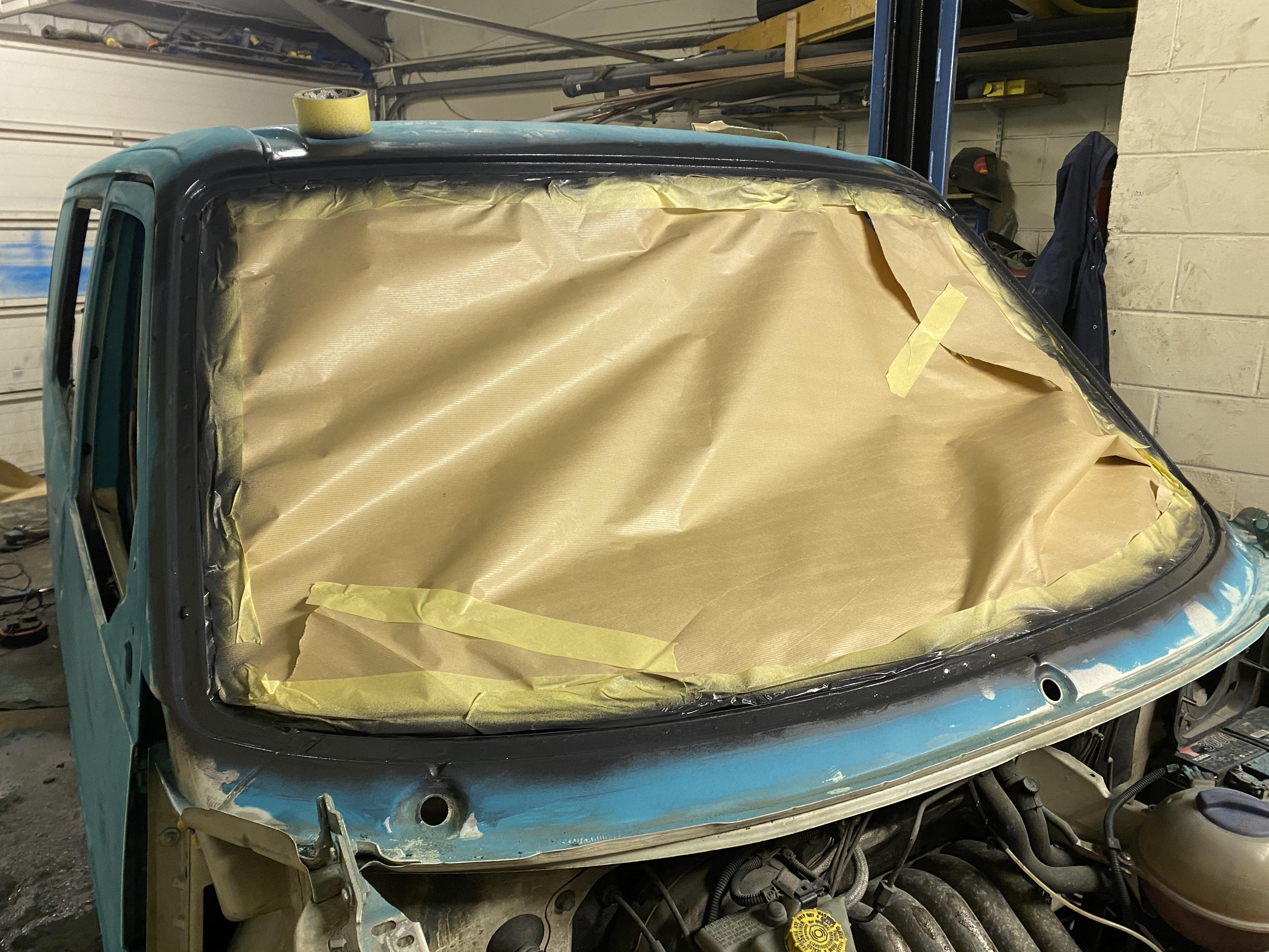

And some rust converter round the windscreen surround.
I’ll let that cure and etch prime tomorrow. Hopefully my welding wire gets delivered tomorrow and I can finish a few bits of welding.

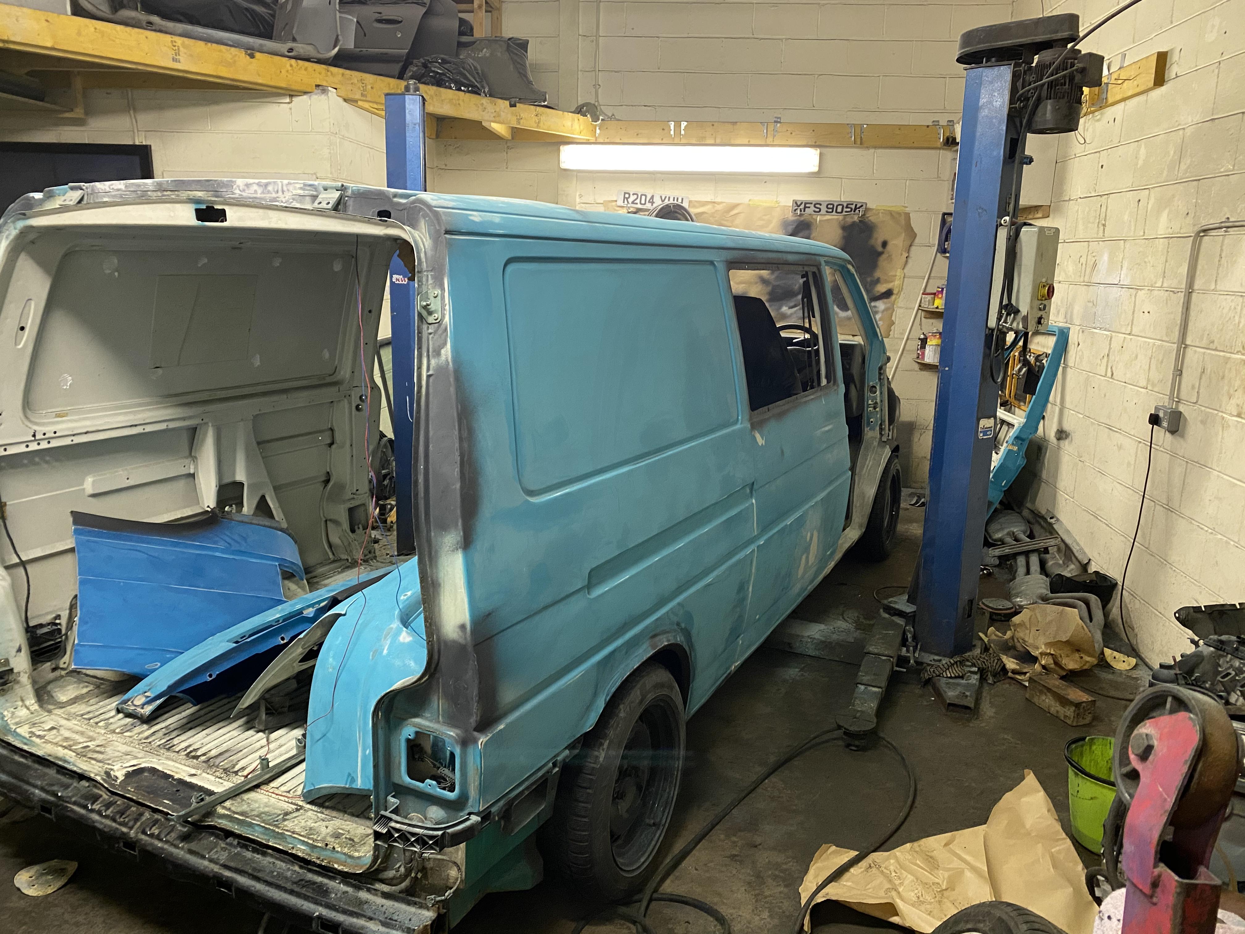

So it’s been a week since I’ve updated this but not because I’ve not been working away on it.
I had two little rust spots at the back of the roof.
Etch prime around the windscreen.
A little weld repair and reshape for the wiring grommet in the tailgate.

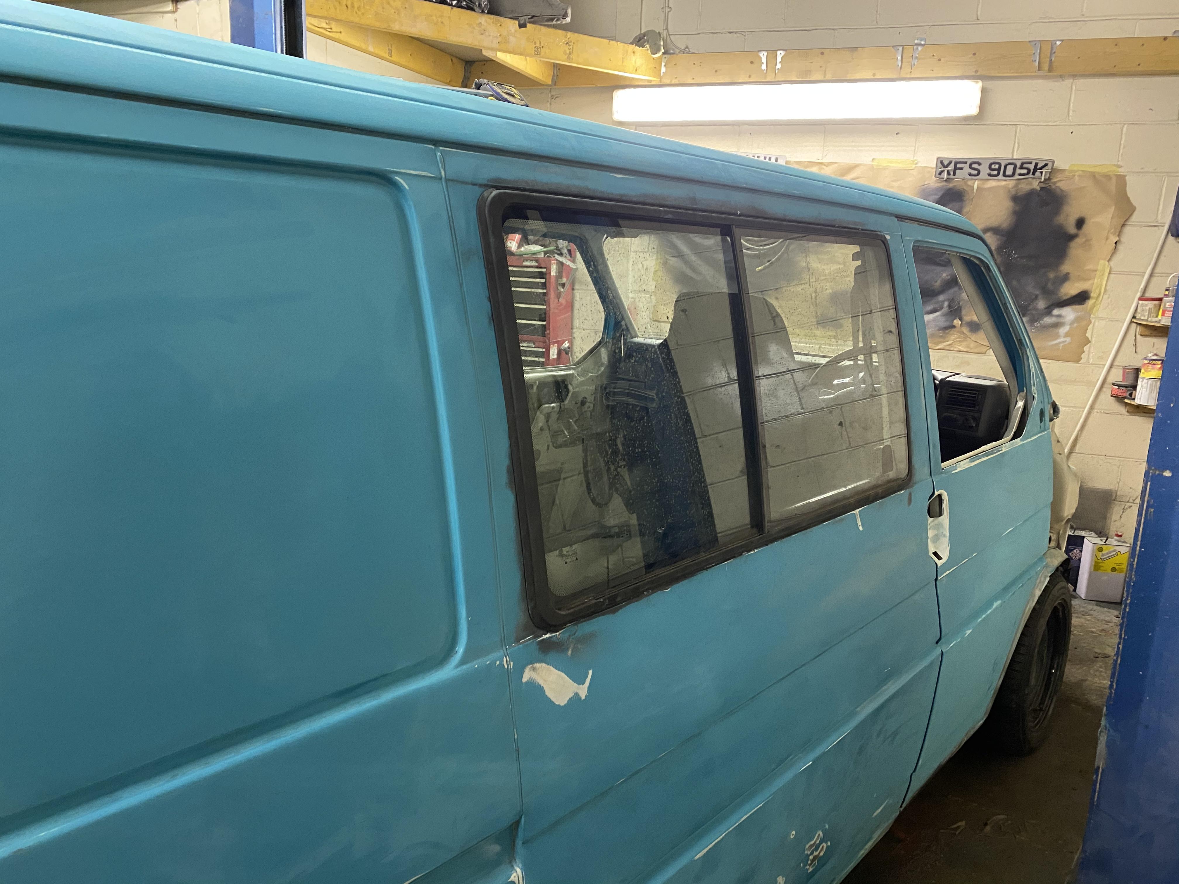

Side window fully fitted.

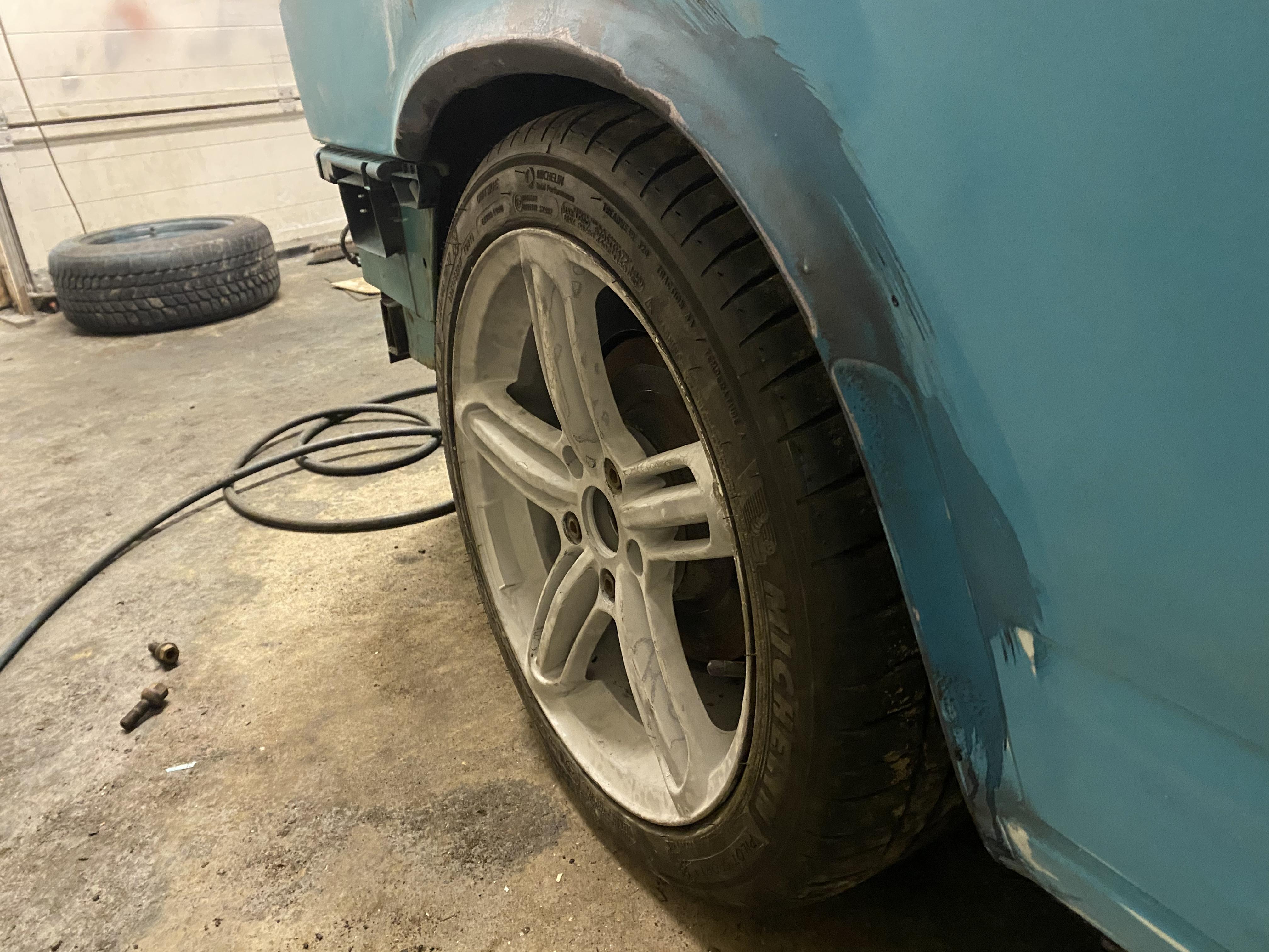

I had a tyre fitted to the wheels I’m changing to. Just the check clearance. Looks good with a bit more tuck than the banded steels which is what I was after.
Loads of room at the front. No need to roll the arches.

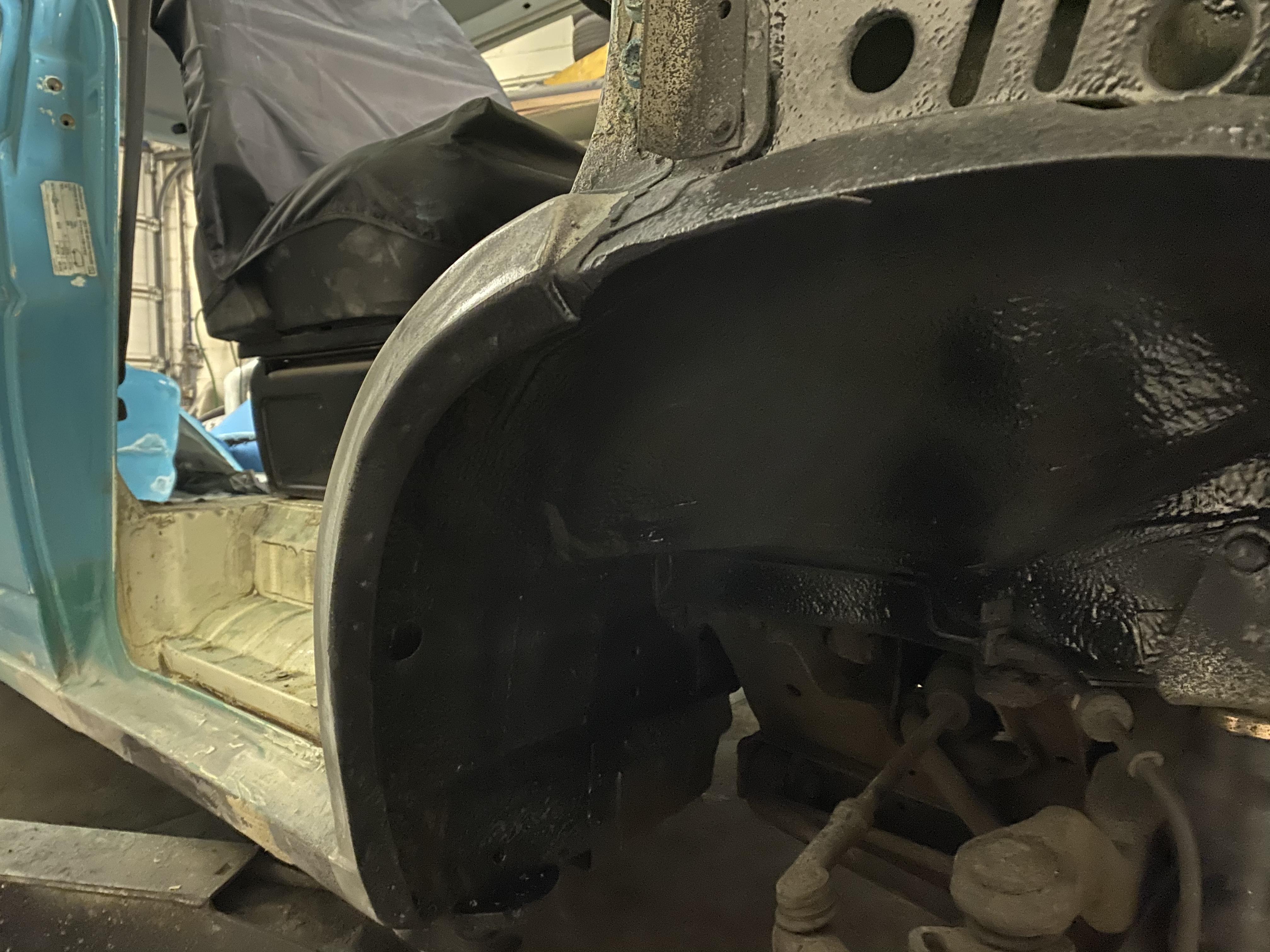

Inner wheel arch repair seam sealed and gravitex stone chip.
And a final fit of filling and sanding done. Now off to the paint shop for the next few weeks.
