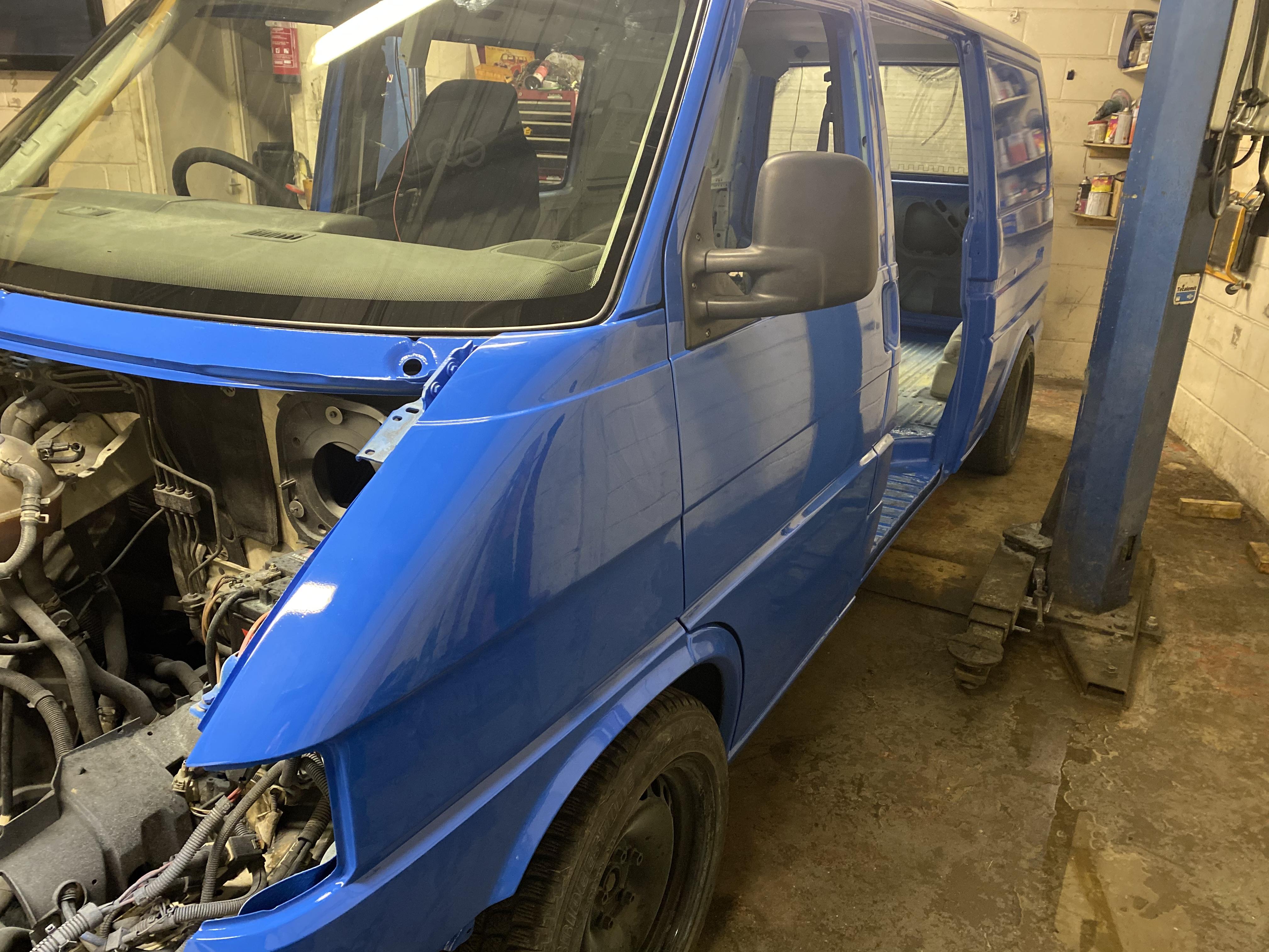

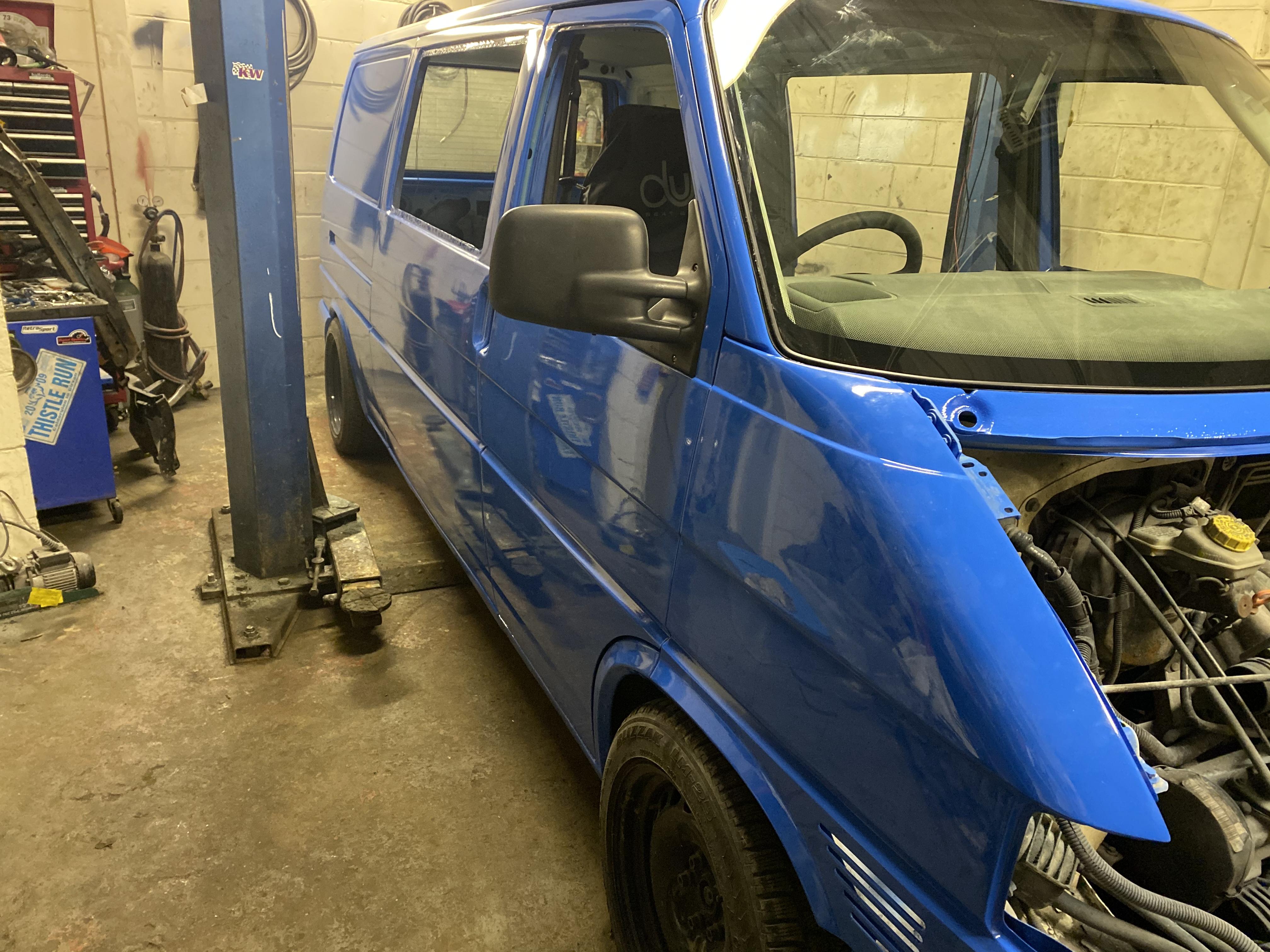

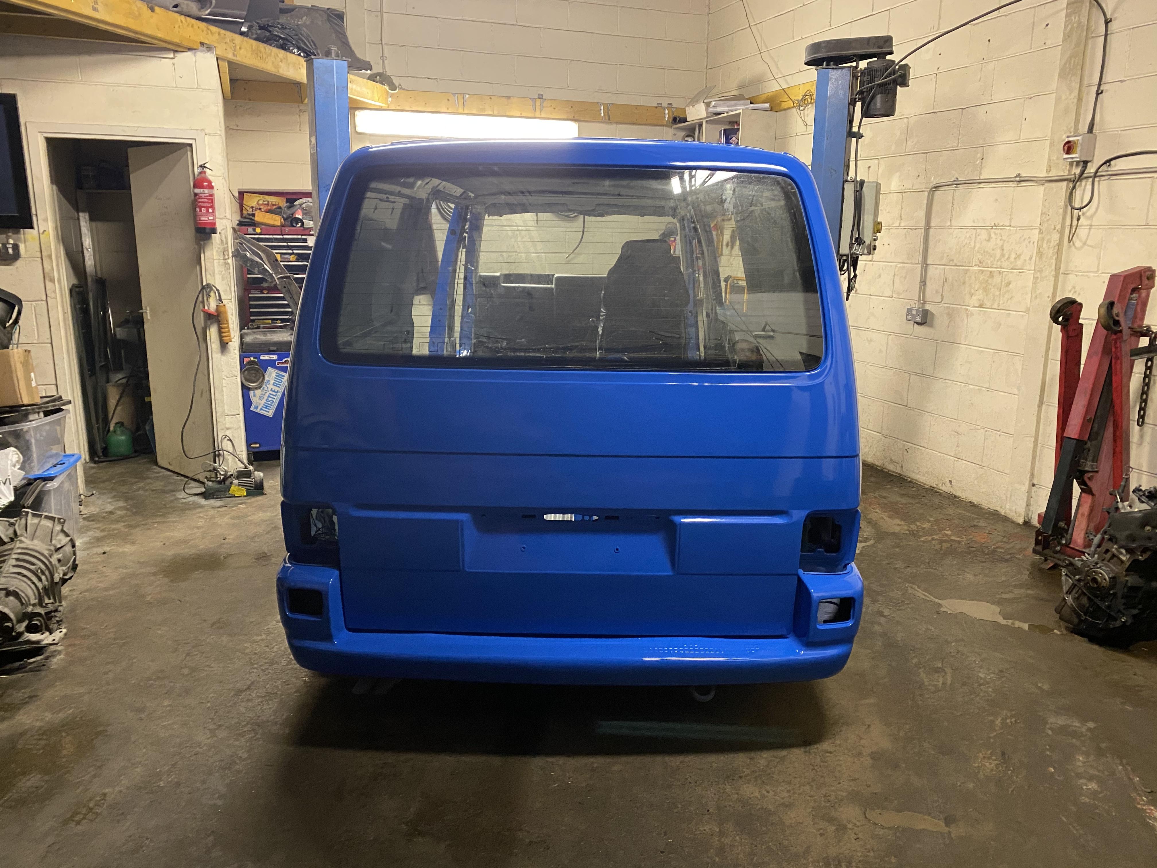

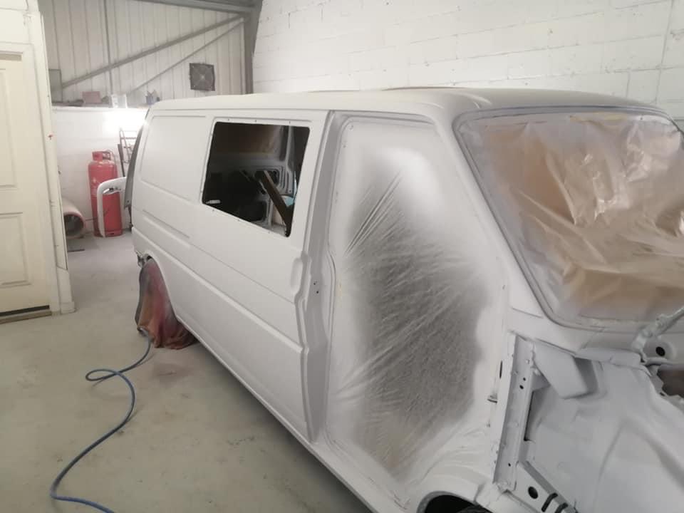

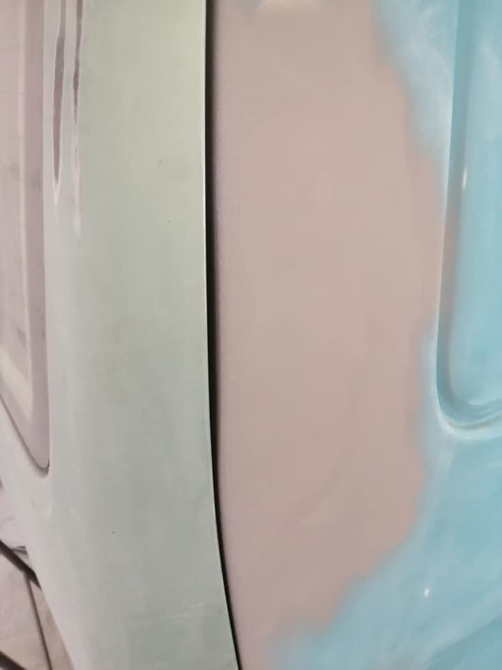

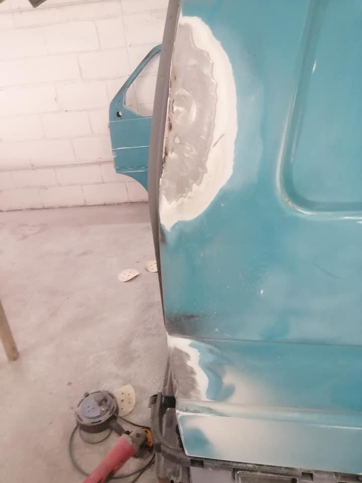

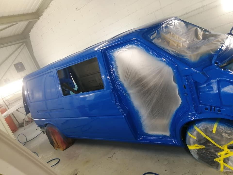

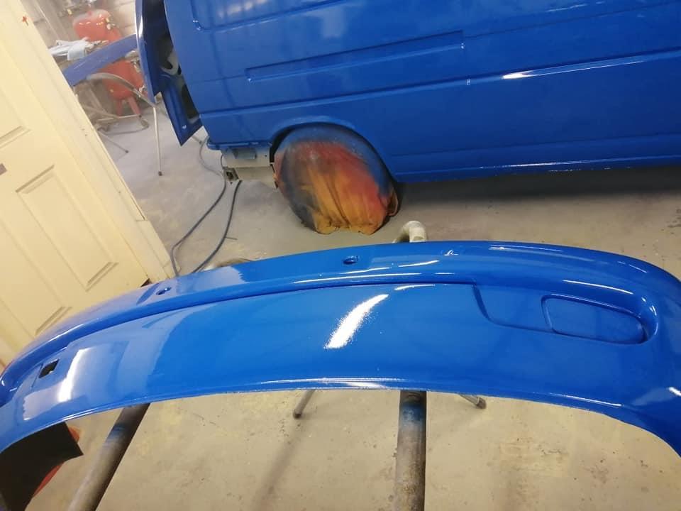

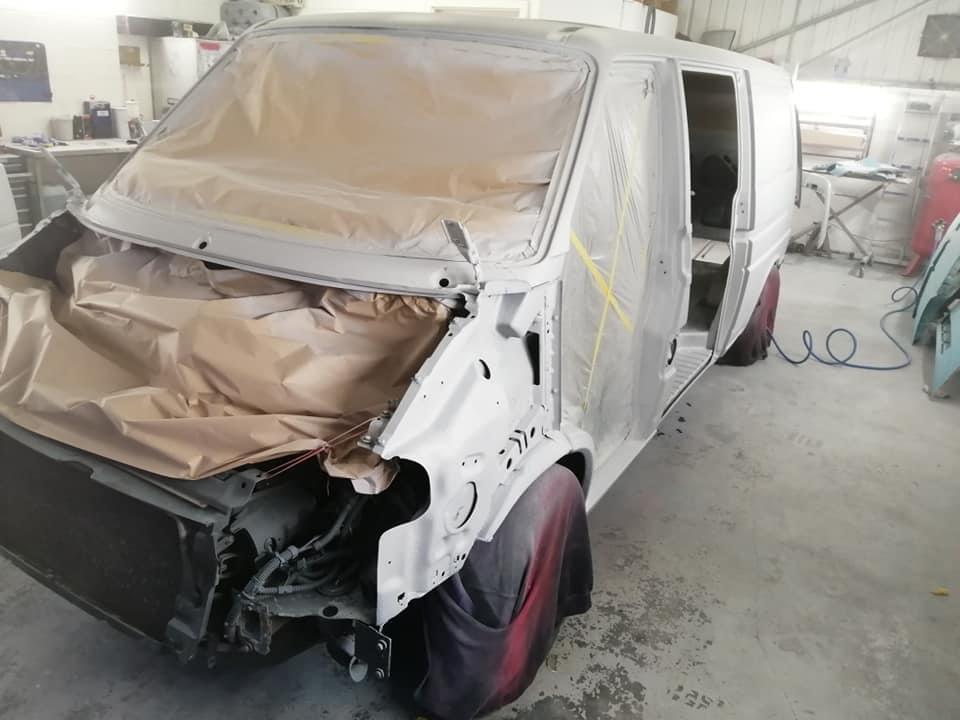

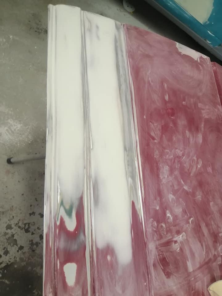

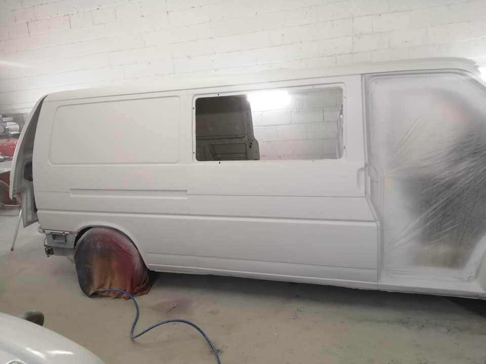

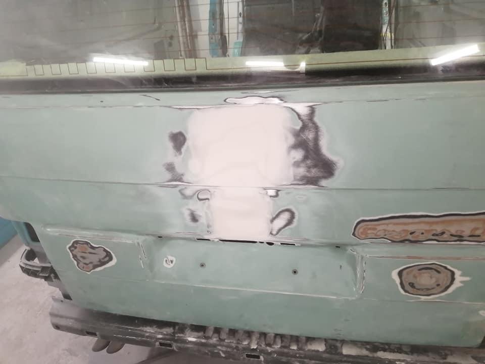

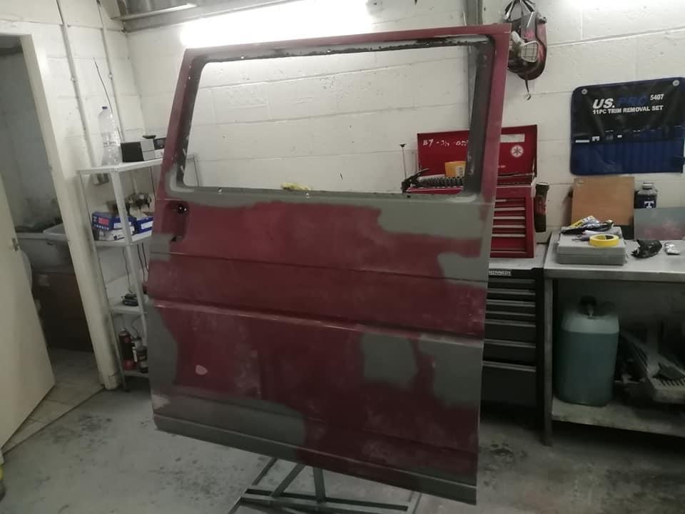

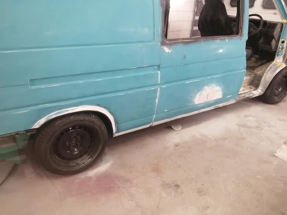

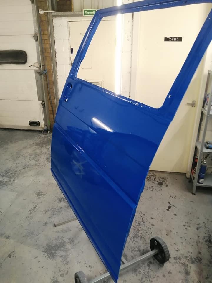

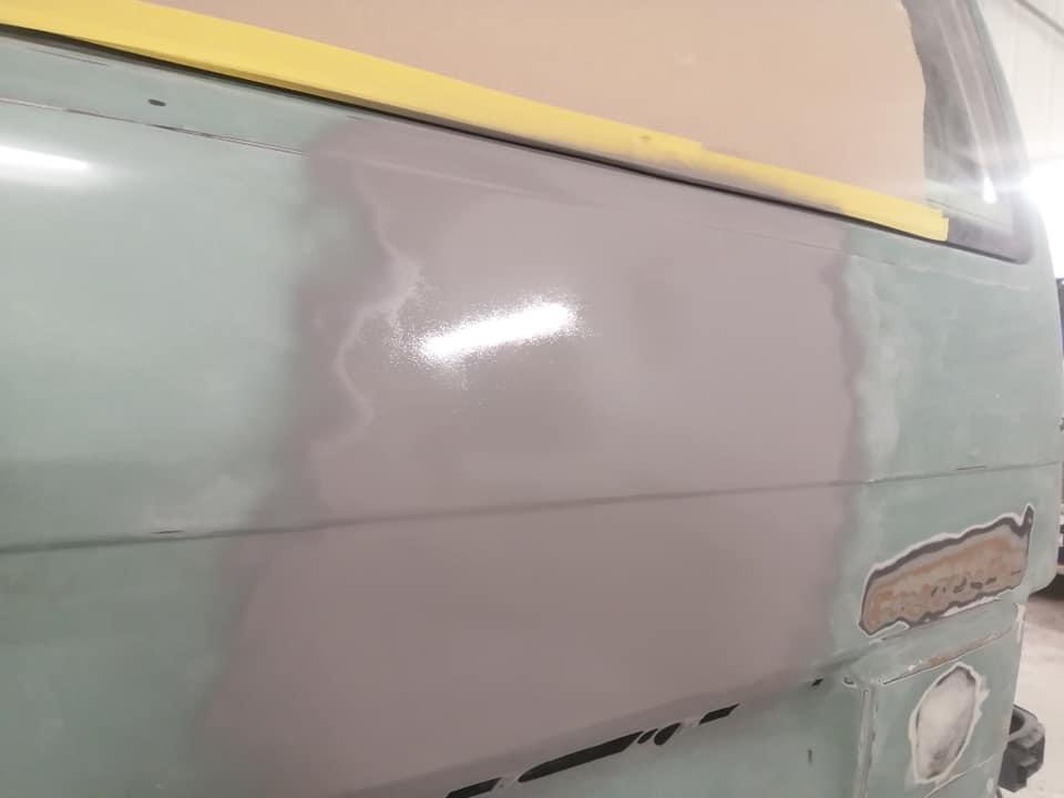

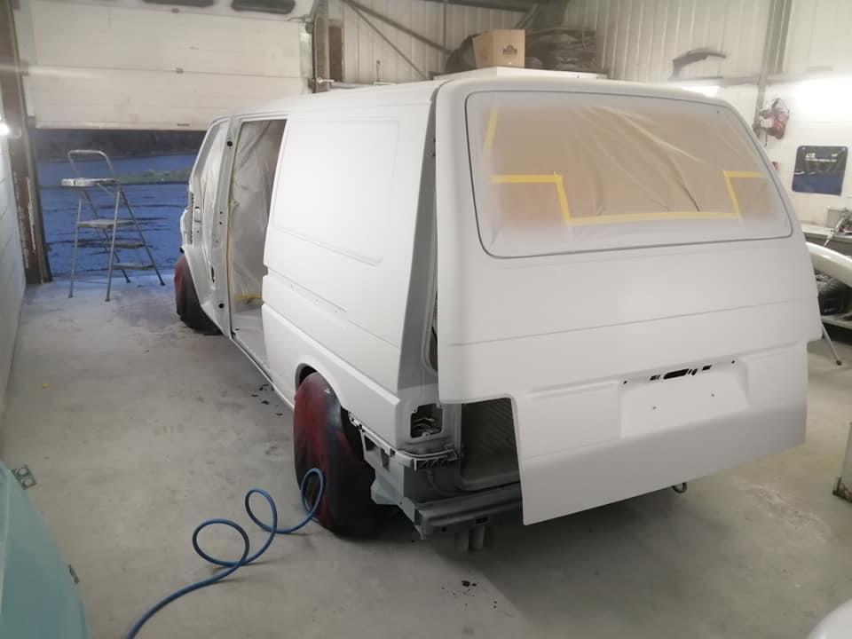

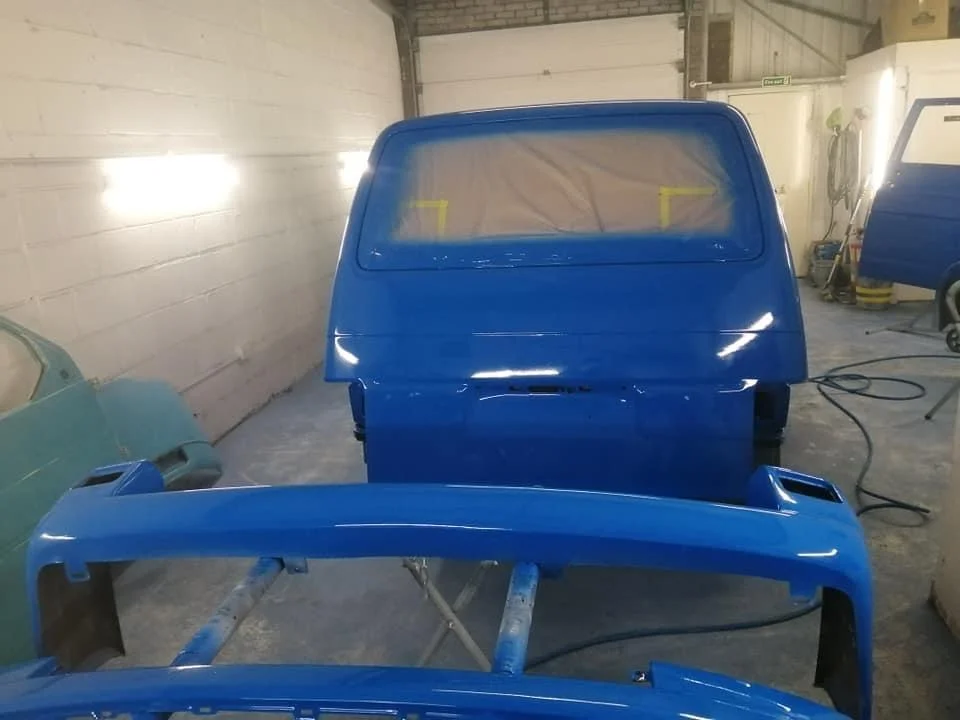

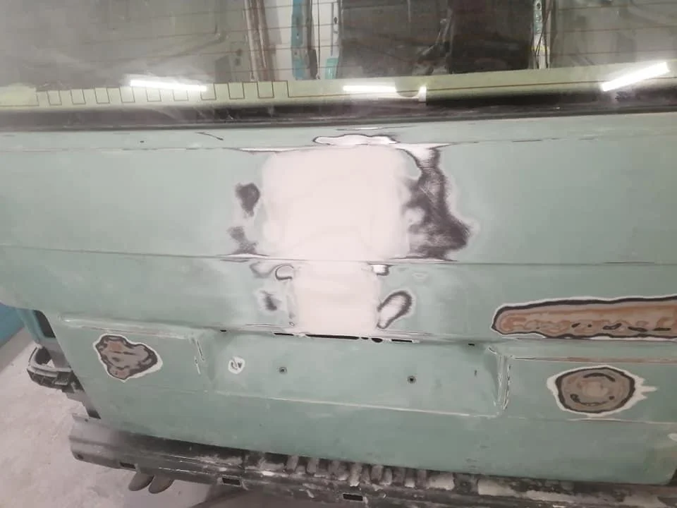

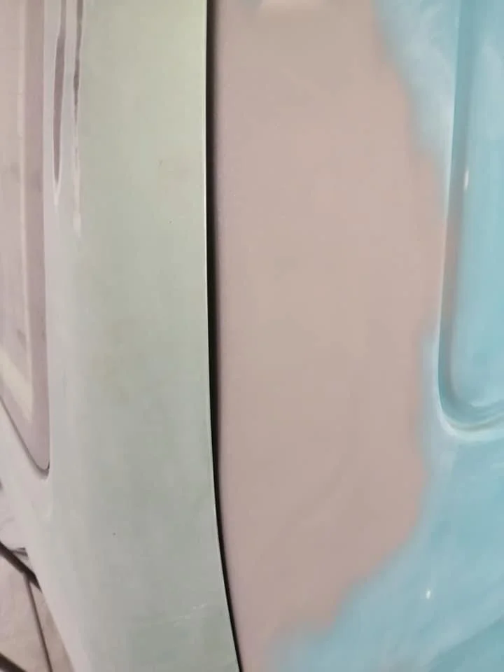

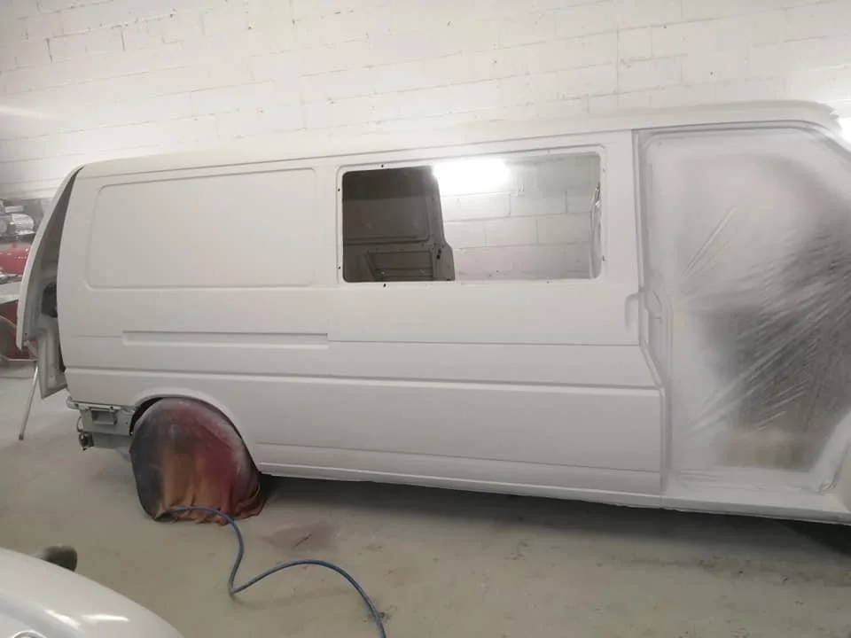

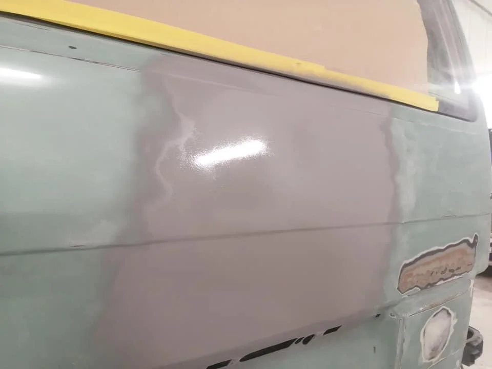

Update from the paint shop. I’ve left them to finish some of the repair work.
In primer next then it should be in colour by Tuesday.

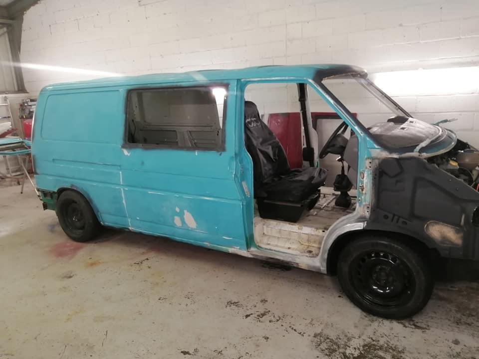

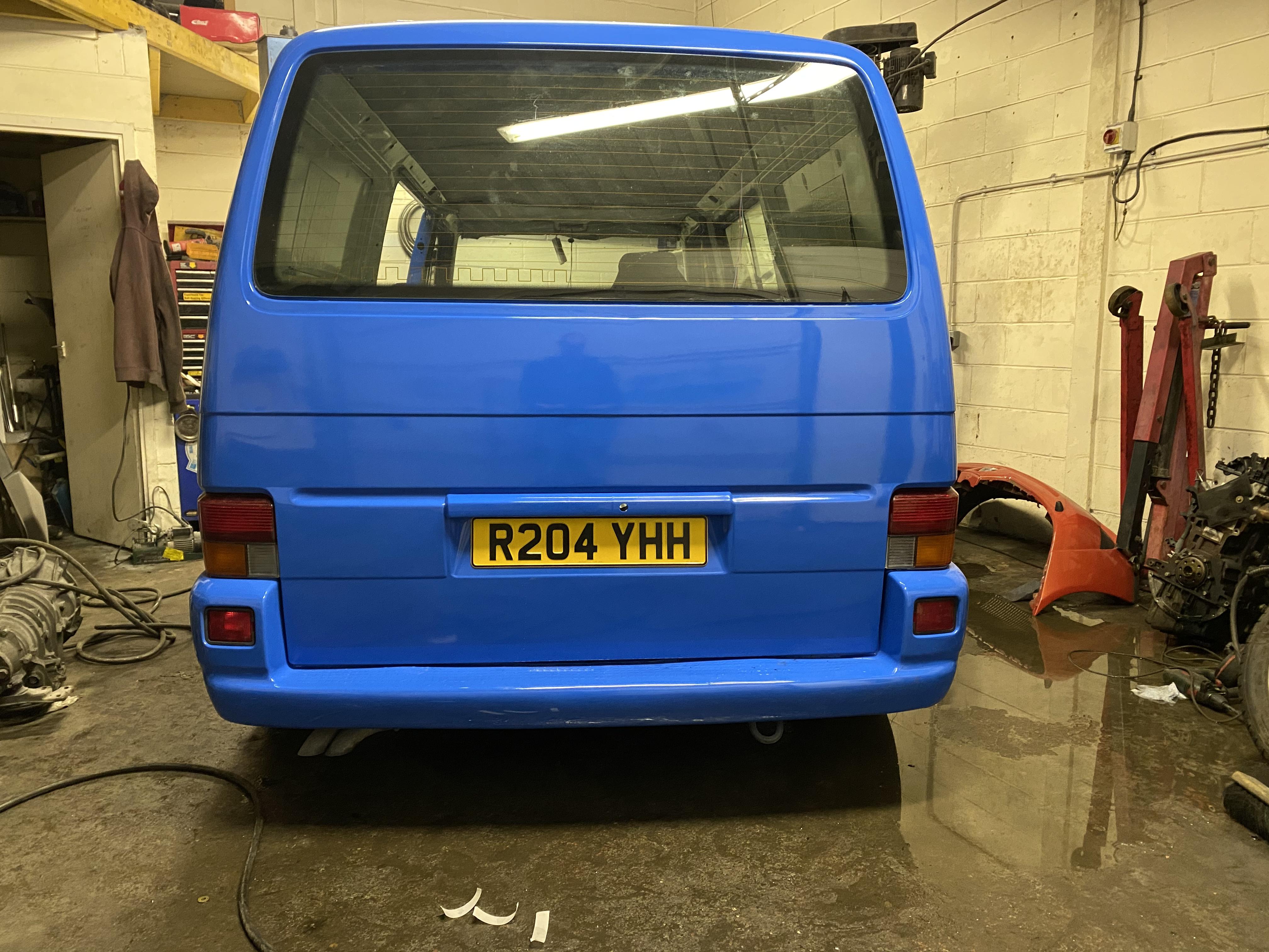

Most of it was brought back to the lockup tonight. Very pleased and excited to get it back together.
I’ve still to get the doors and bonnet back.
The new windscreen gets fitted on Wednesday and I’ll be working to carefully put it all back together without scratching any new paint.
I don’t expect the next bit to be exciting. I’ll just be cleaning and putting things back together.
Then off for an MOT. I think some new brakes and a driveshaft will be in order before it will pass.

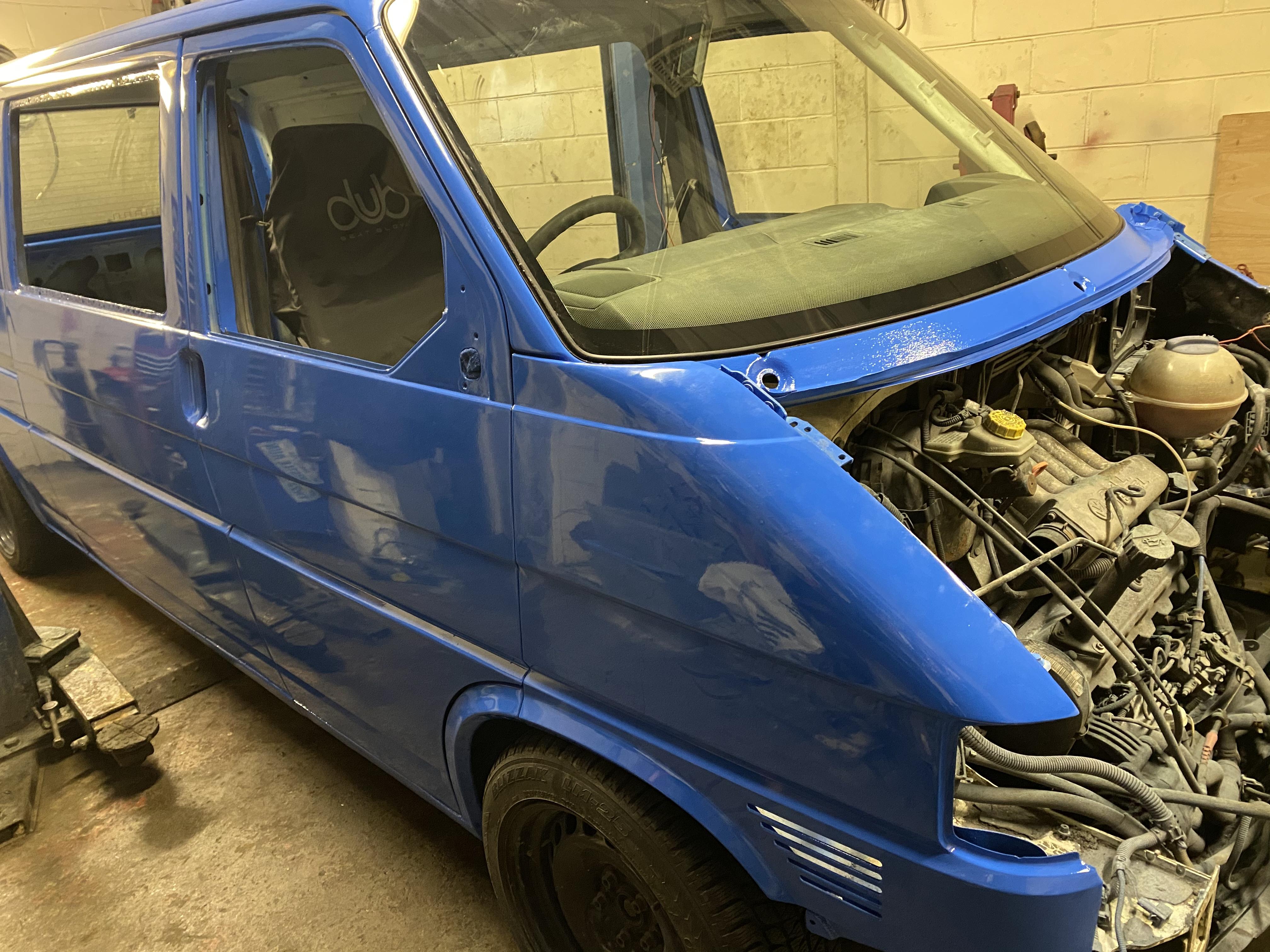

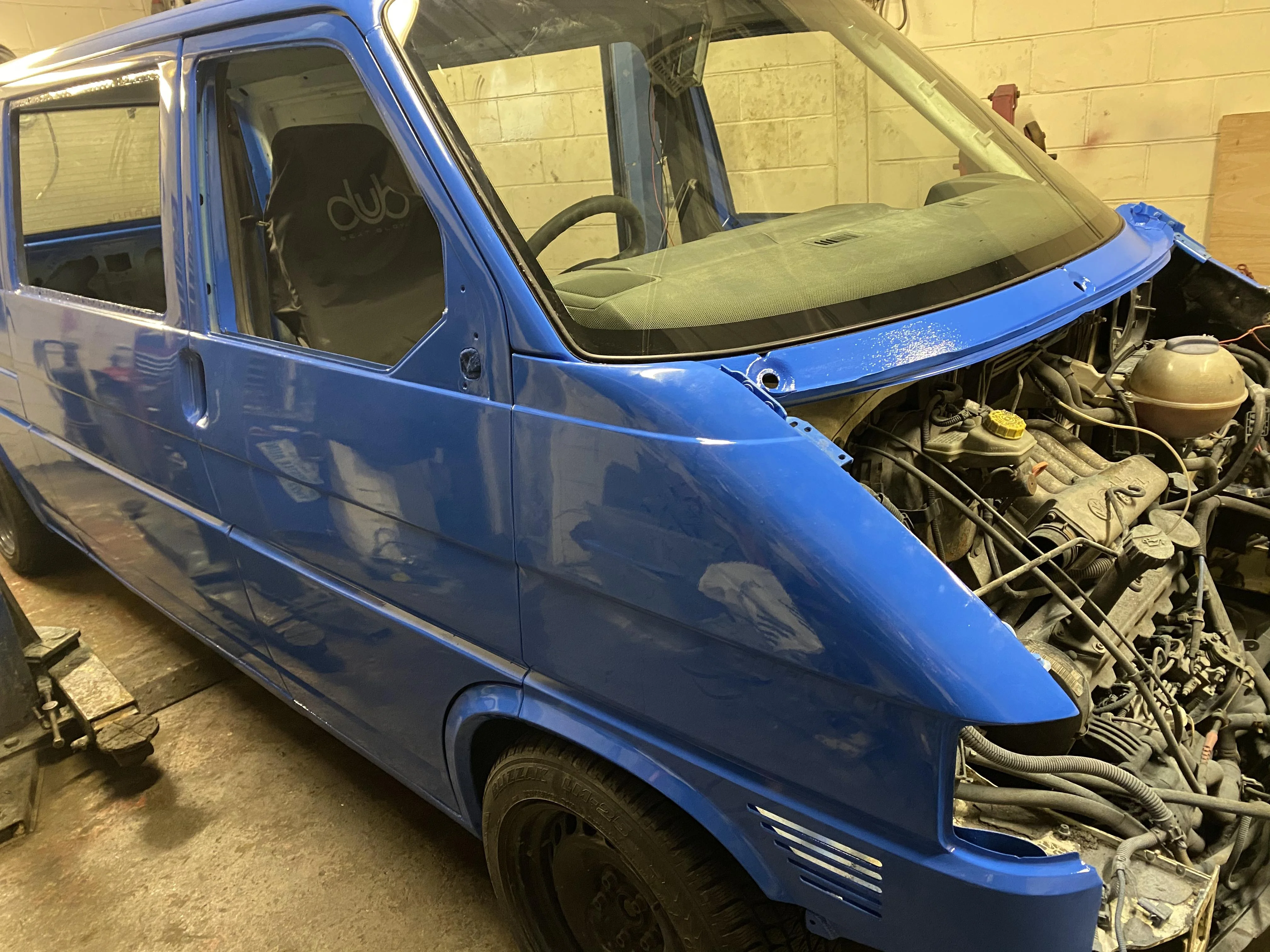

New windscreen fitted today by Scott-Glaze. Good service. Came from Perth to me and fitted a brand new screen for £200.
Also found some time tonight to get the drivers door abs latch on. Plus the drivers side wing.
Very happy with how it’s looking. Can’t wait to see what it looks like built back up.

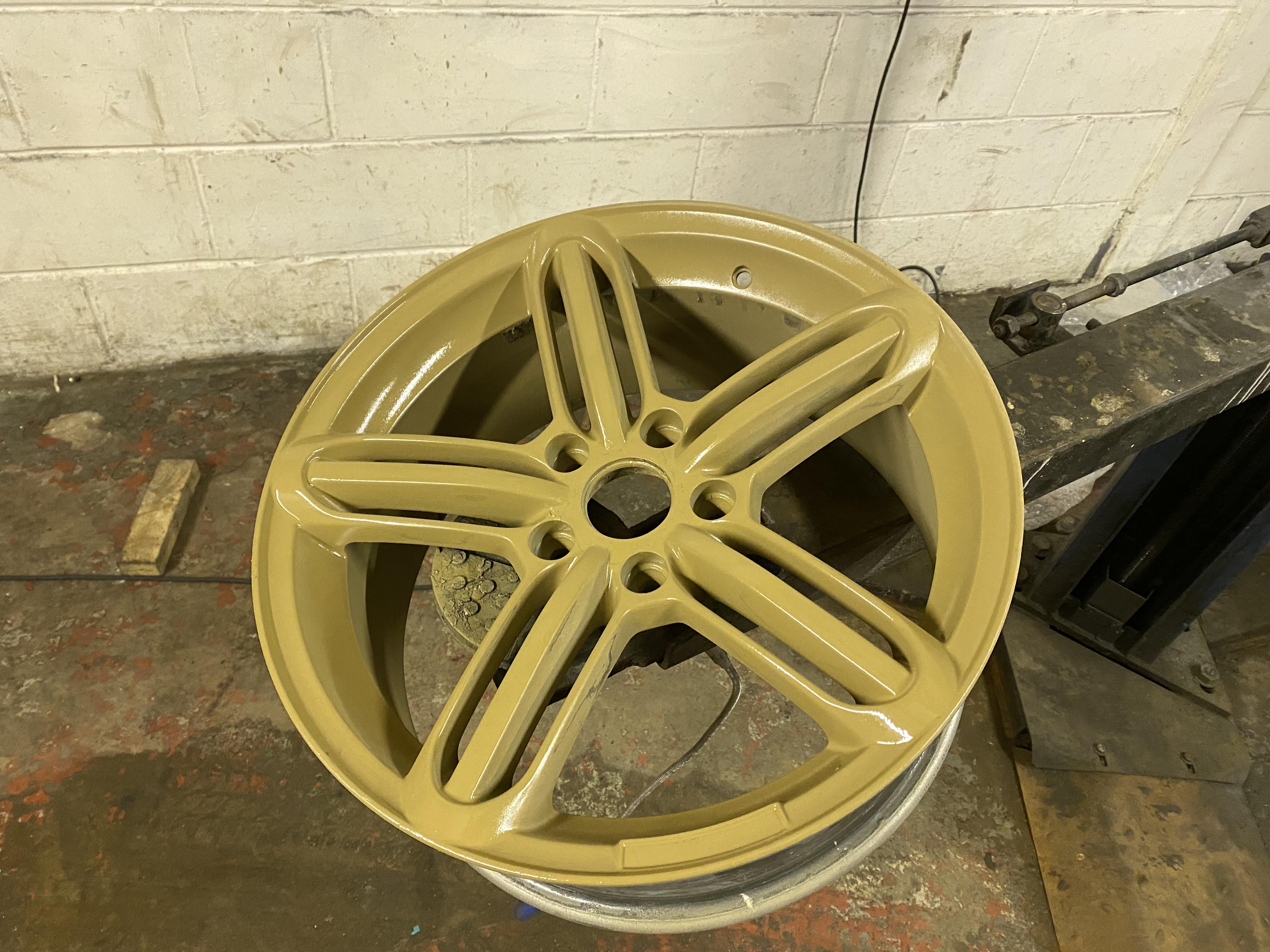

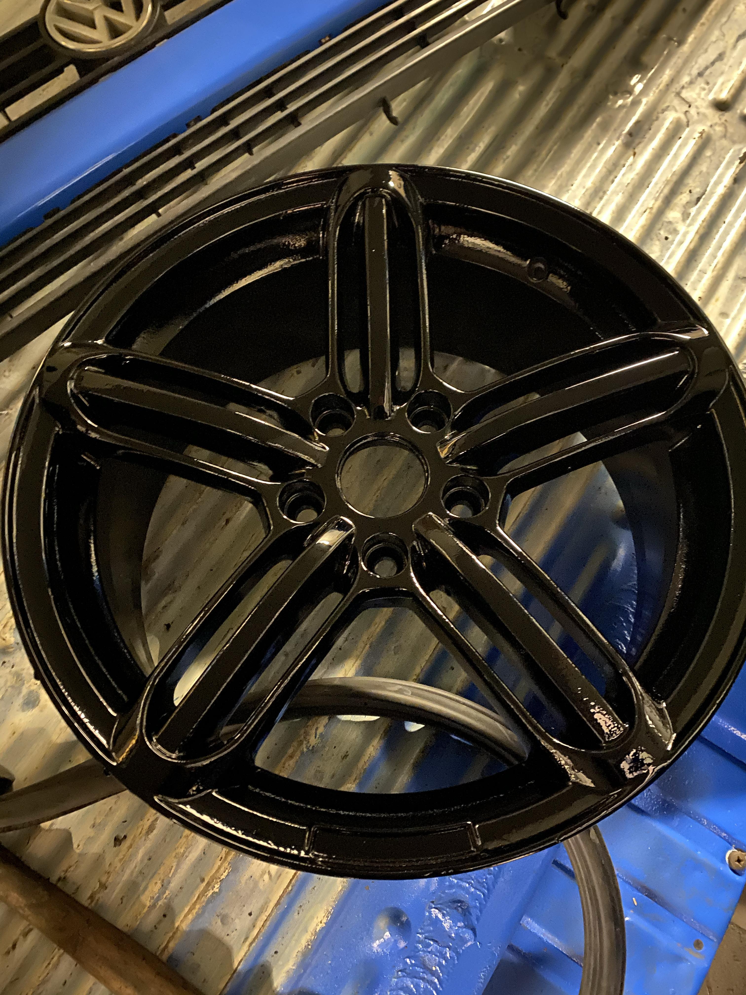

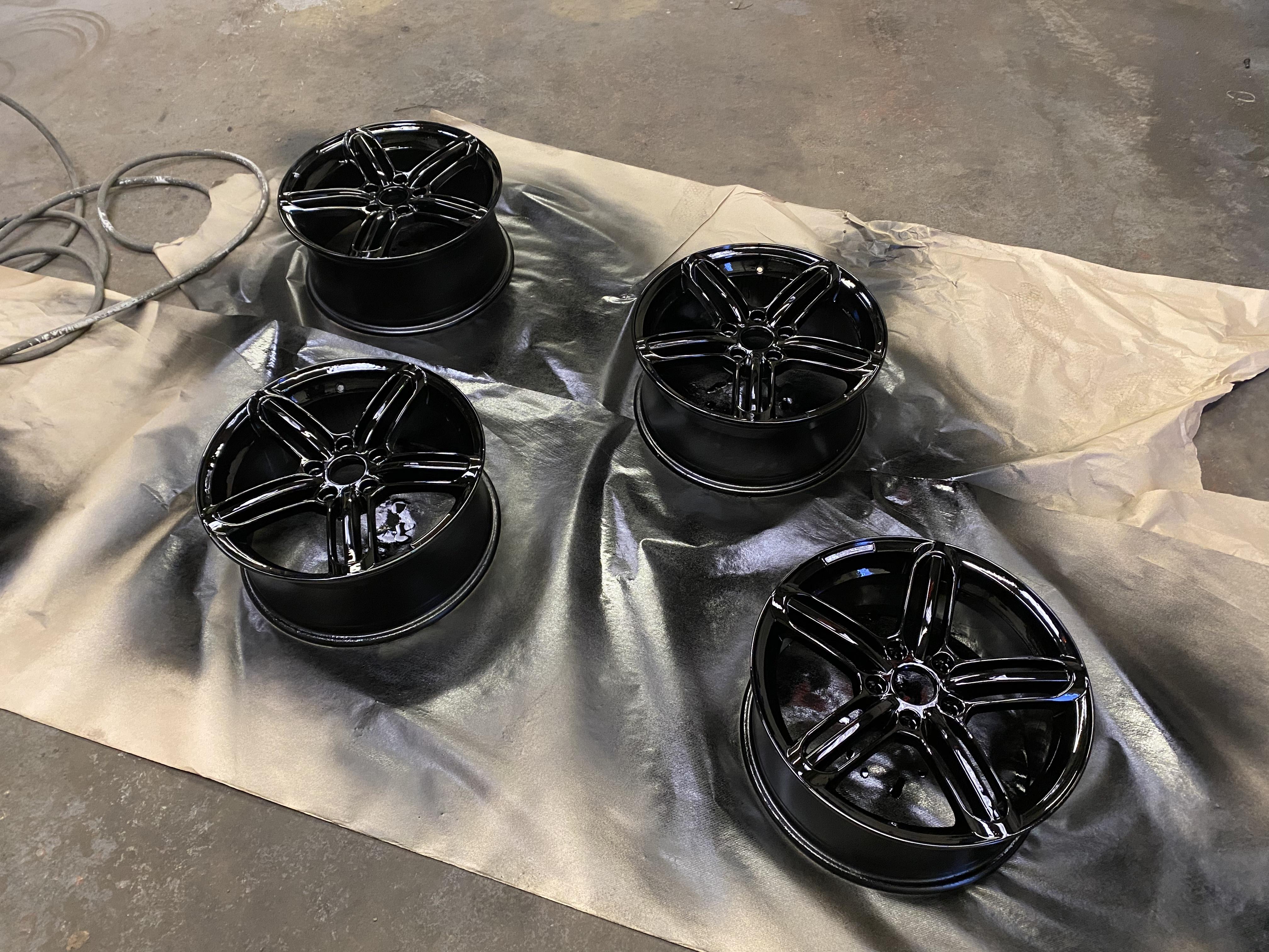

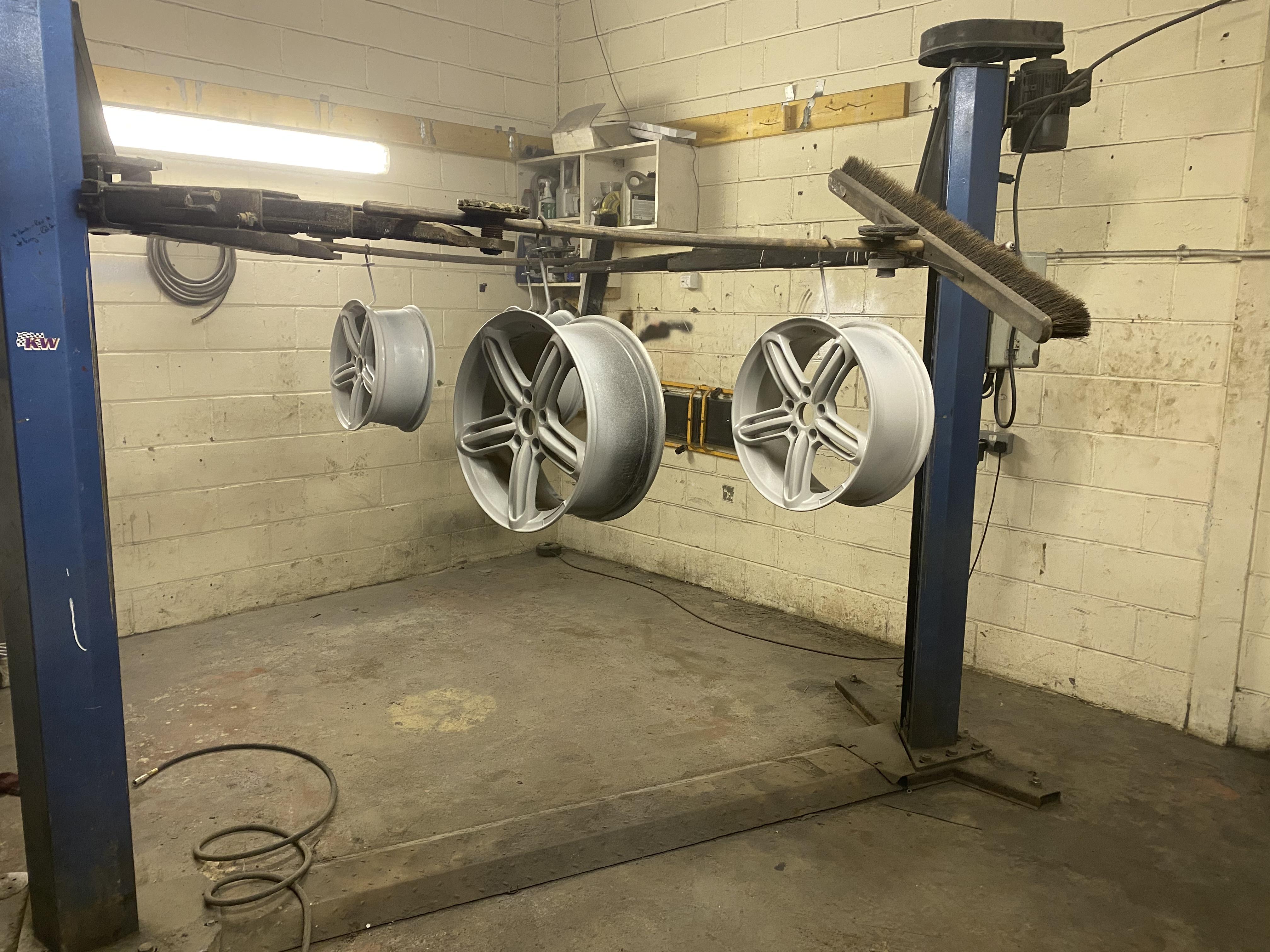

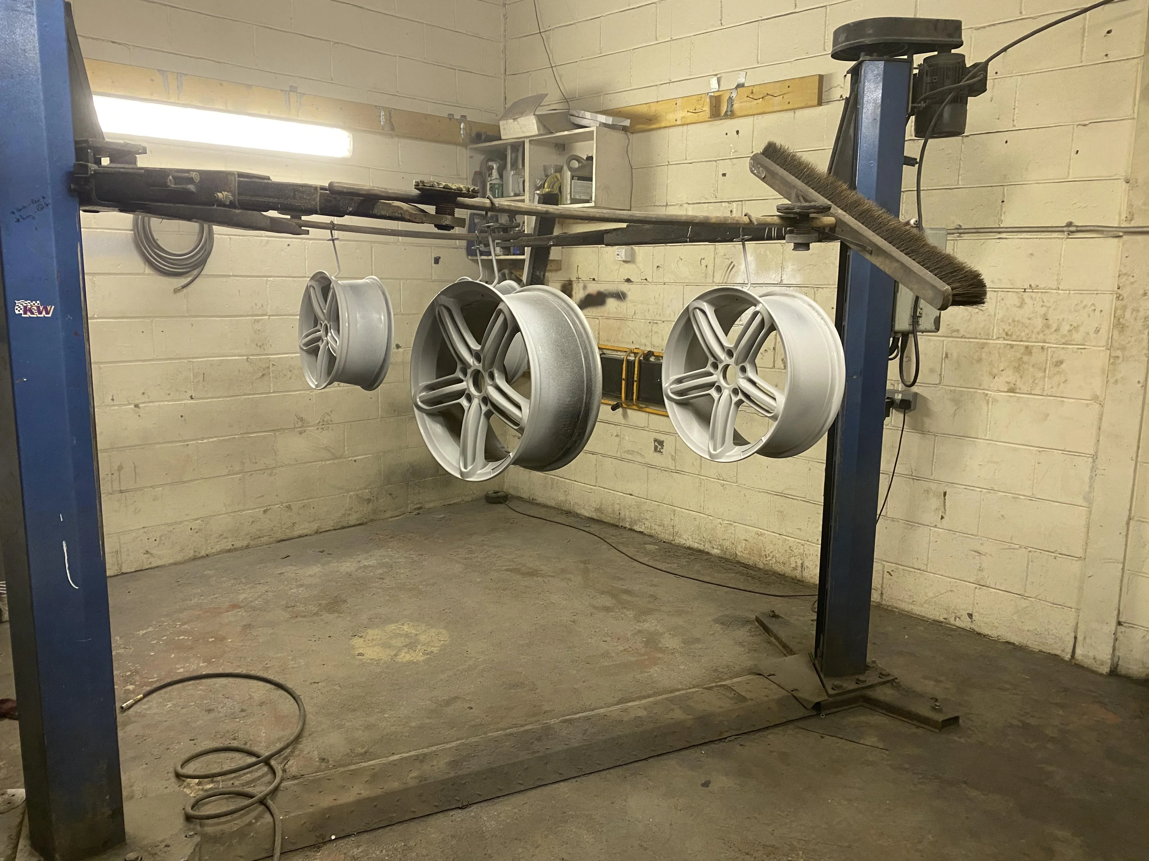

Spent most of today messing about with the wheels.
I have stripped one a while back so had to sand back 3 wheels then etch prime them.
Just me that gets a prodrive Impreza feel from the primer?
Also got the sliding door on. Means the van can be moved outside without raining causing any problems. Unfortunately the new rubber seal is causing it not to close properly. I’ll need to figure something out.

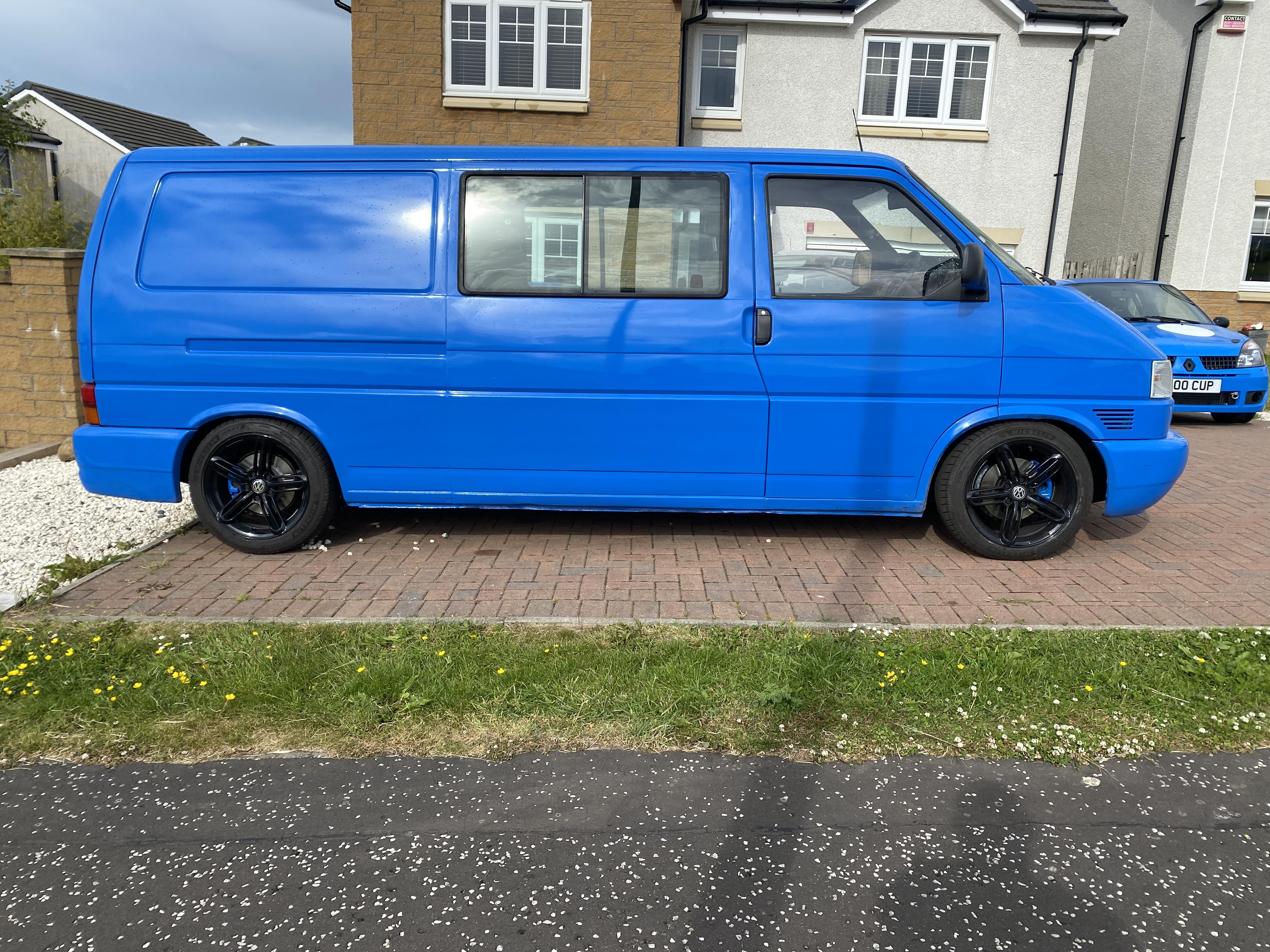

Wheels painted over the last week.

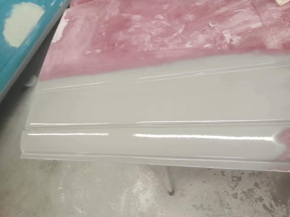

I had a few problems with this first attempt. There were a few runs. And some dry spots. Yes it’s a little orange pealy but that can be wet sand and polished out.
So I sanded back the front face and laid them flat. Looking good so far. I’ll let them dry today and see what the end product is like.

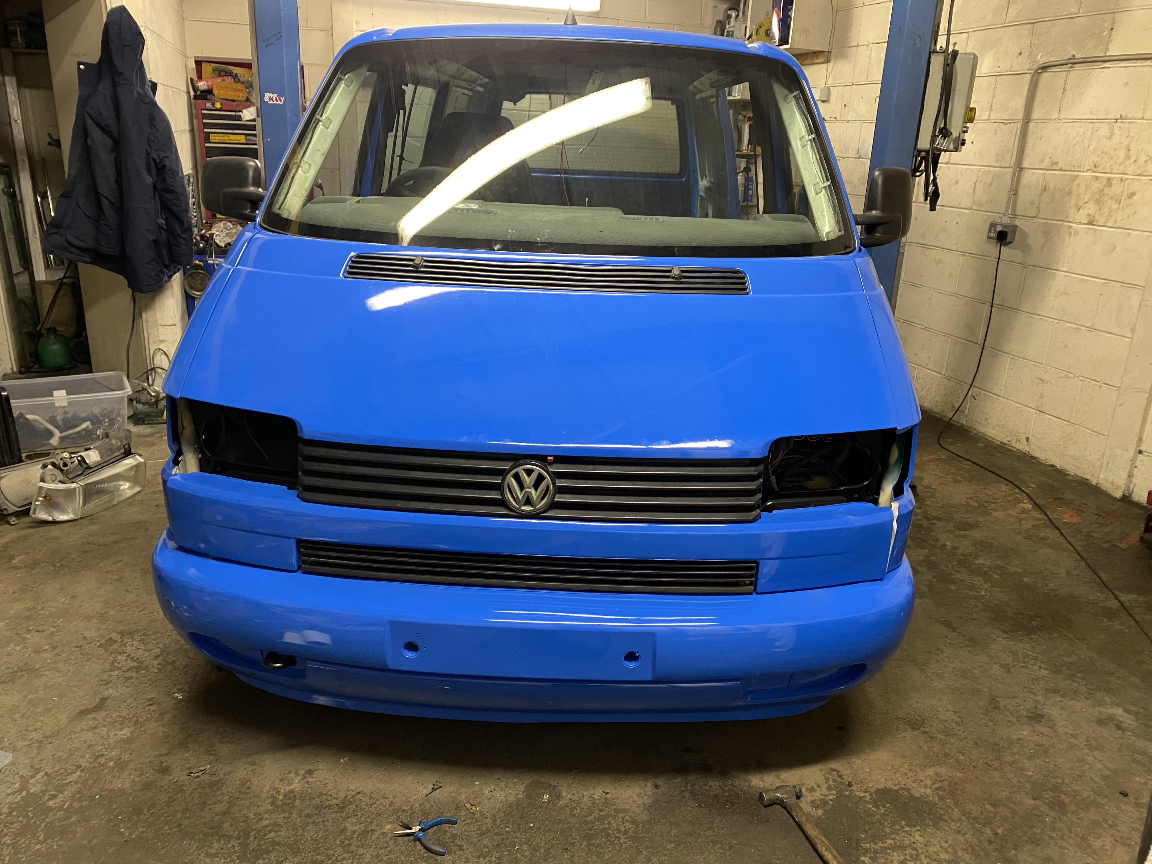

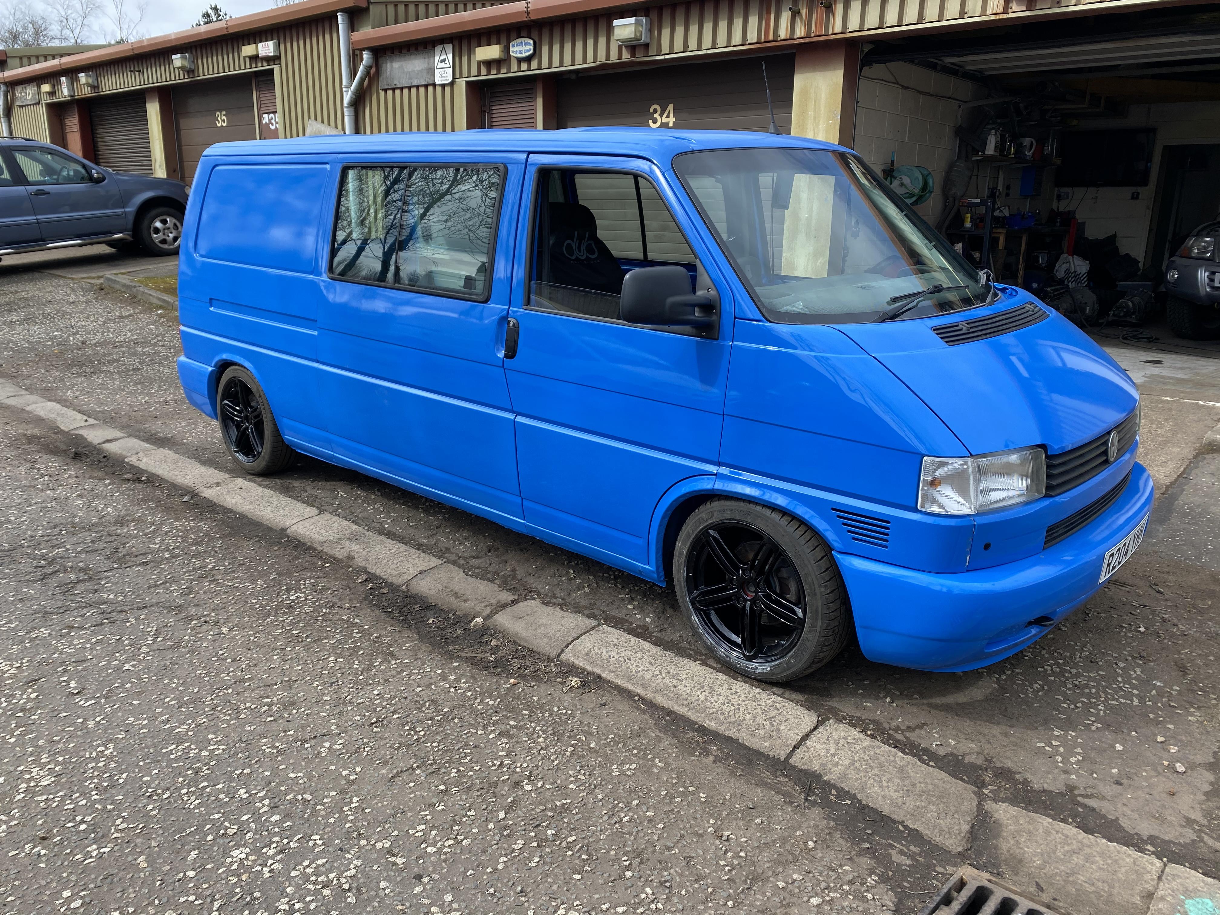

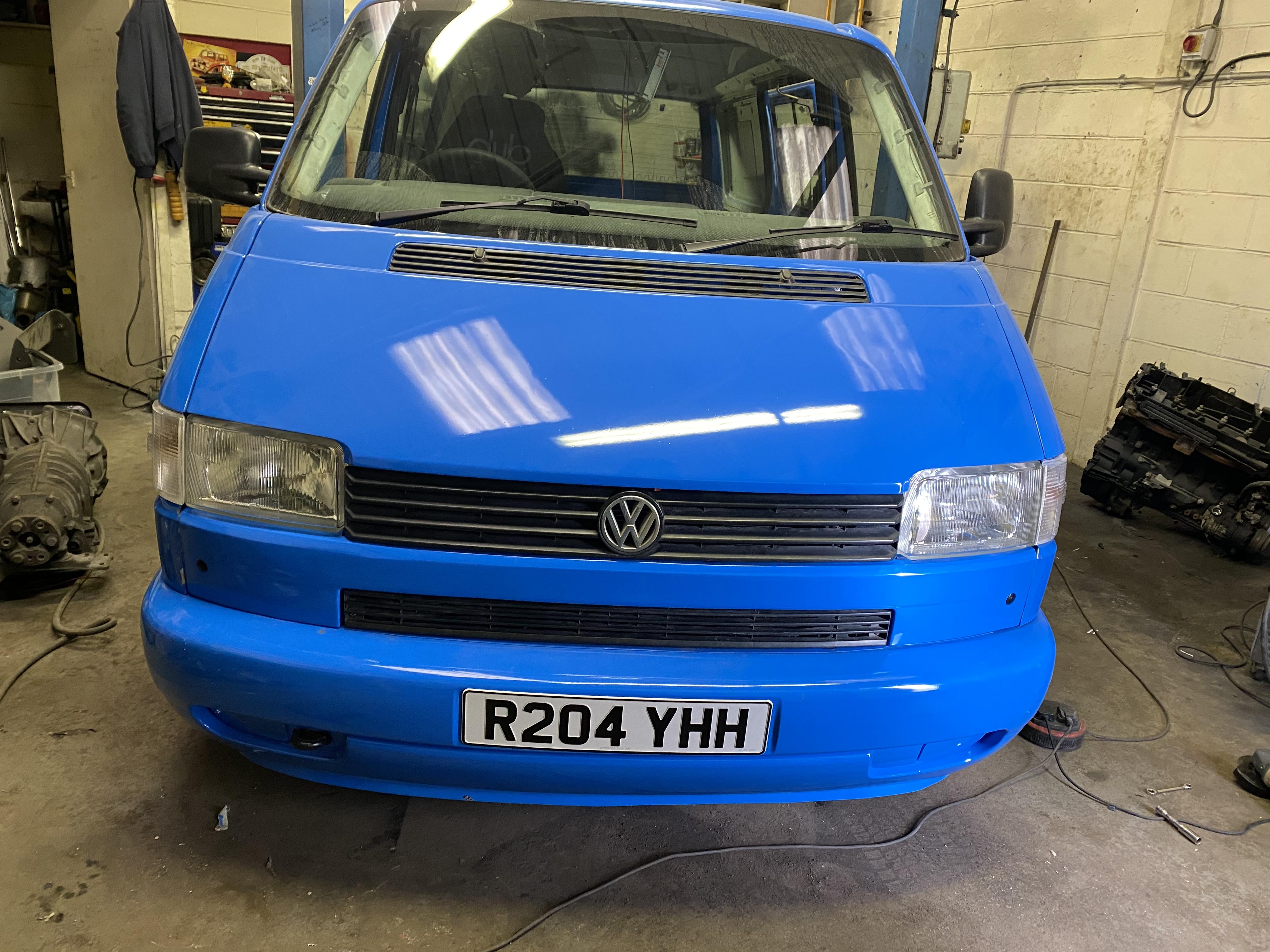

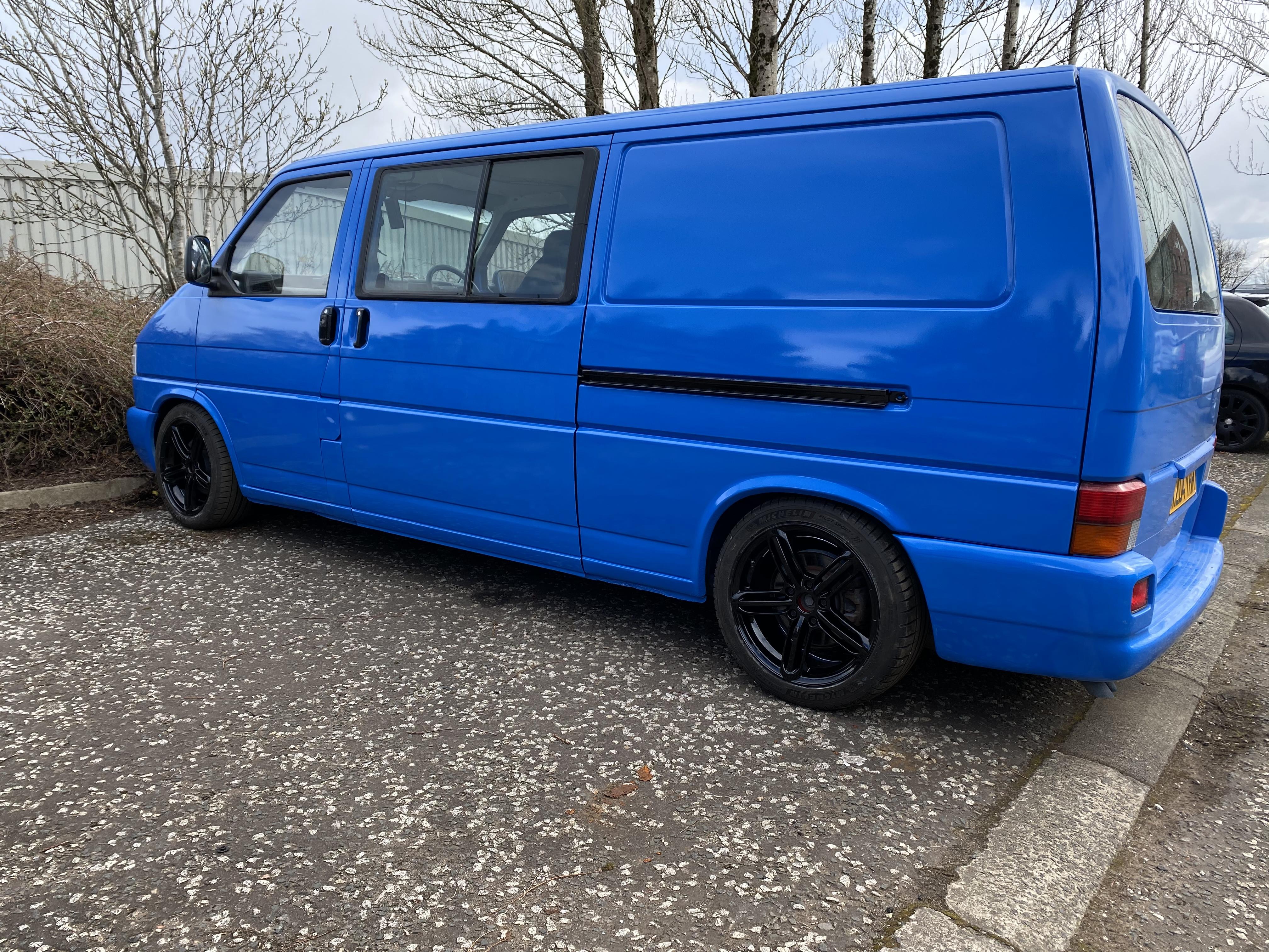

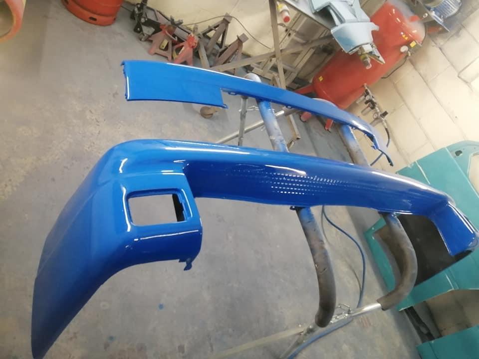

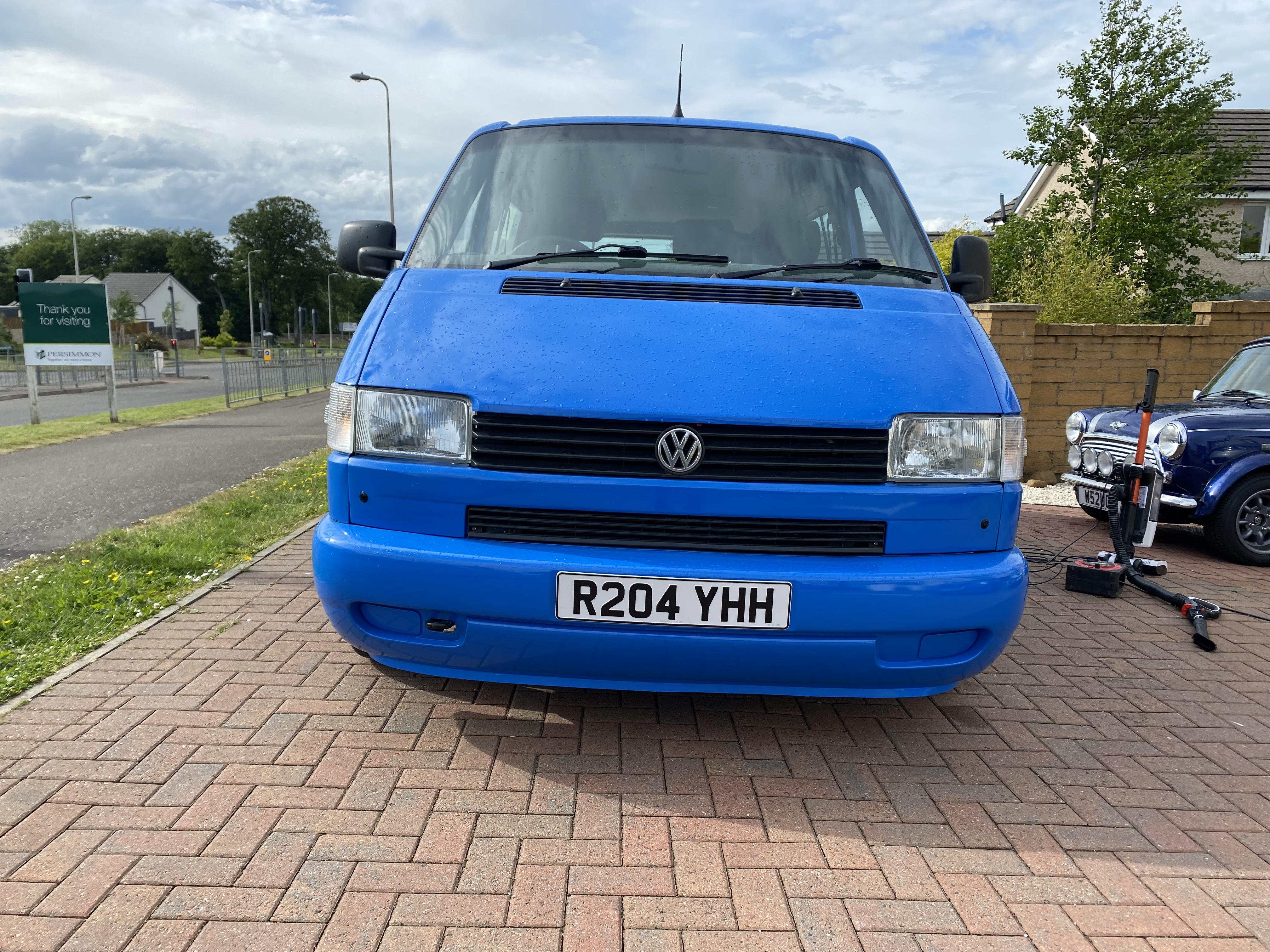

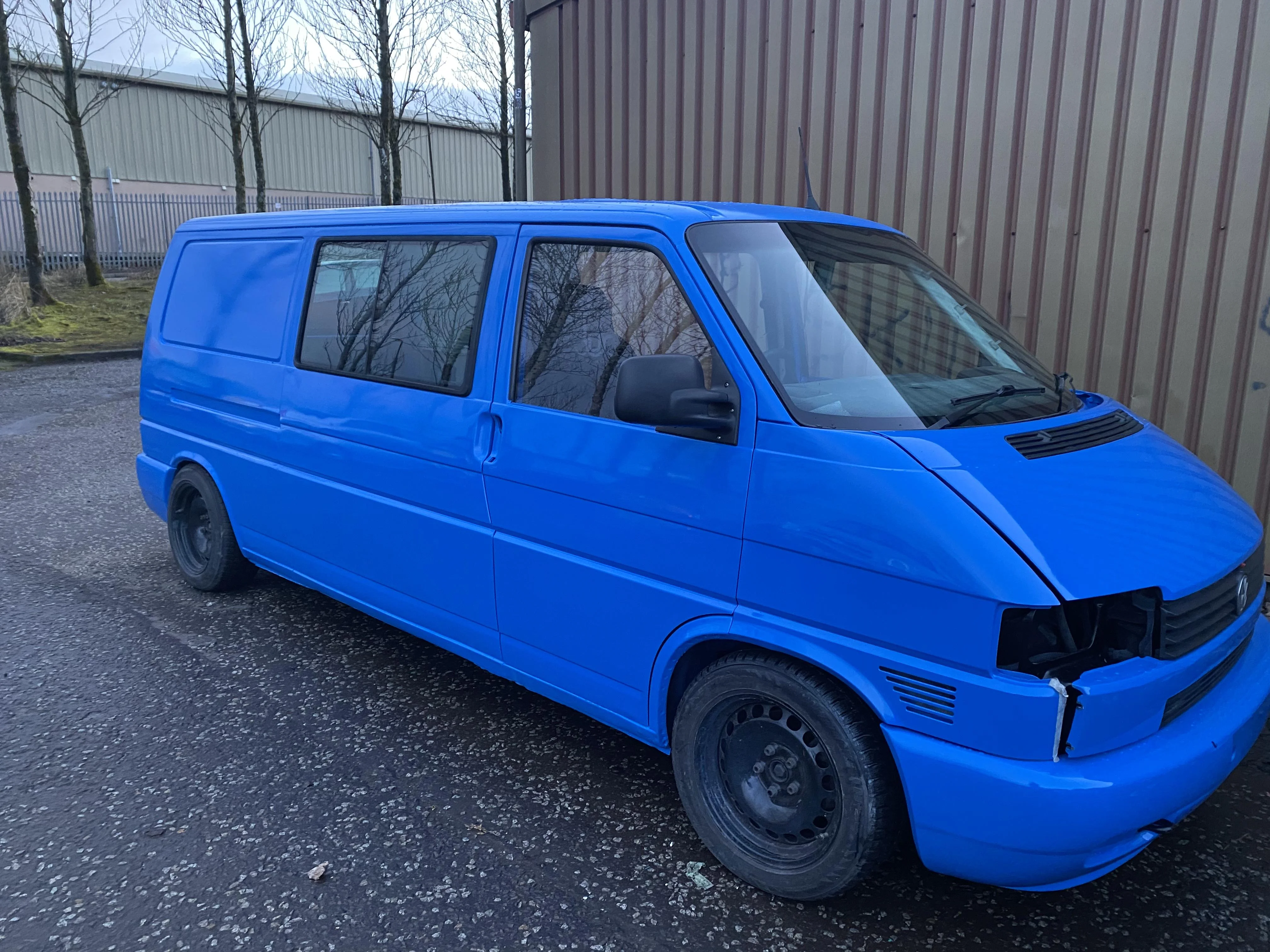

That’s the big sexy van got a face finally. I’ve fitted a few other bits like door handles.
Almost time for the MOT. I think I’ll just wait until everything is done inside and out before that though.

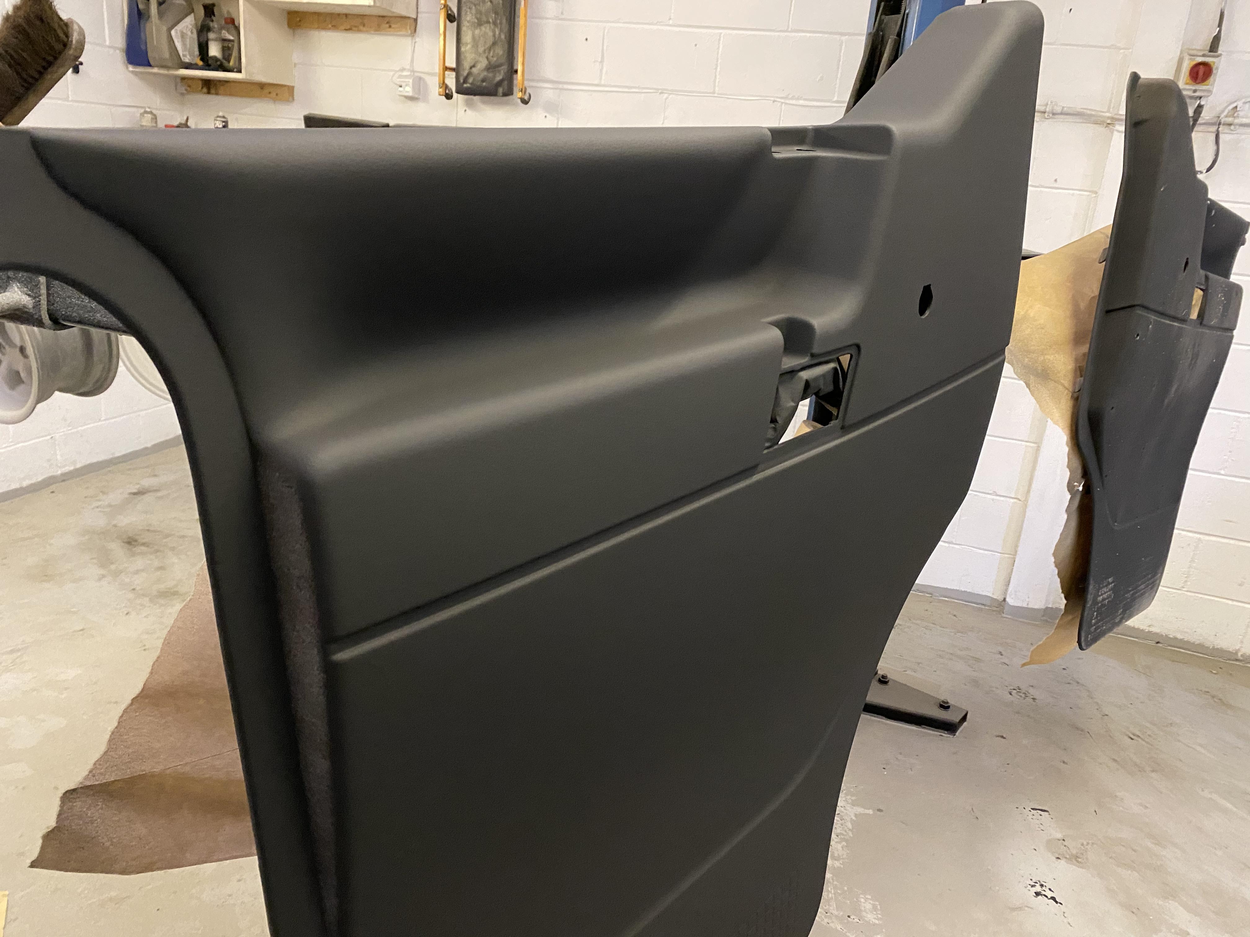

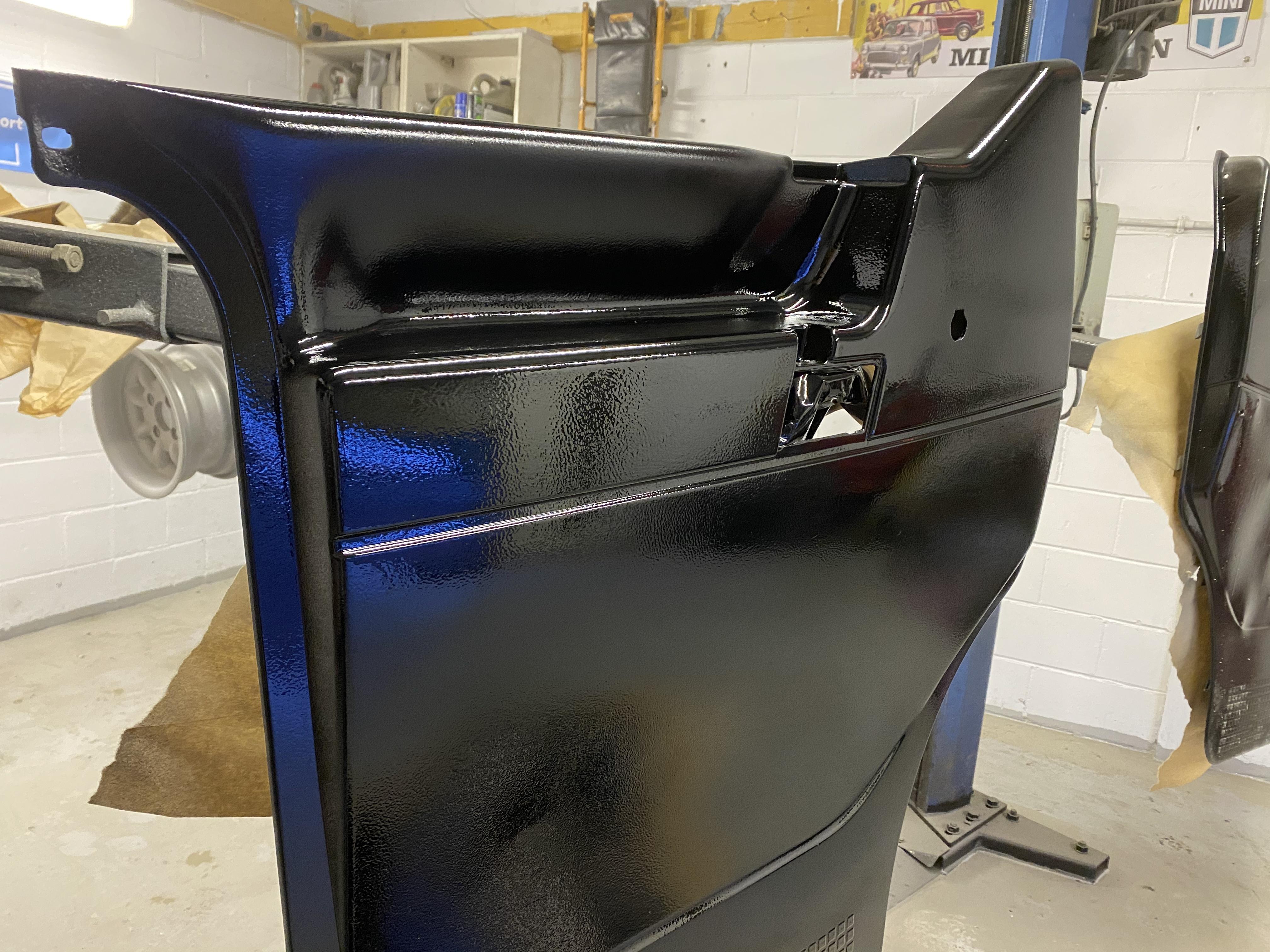

I’ve been cracking on with the interior starting with painting the front door cards.
Quite happy with how they have turned out with a 2k matte black. but they do seem to mark easily so they might need a lacquer of some sort.

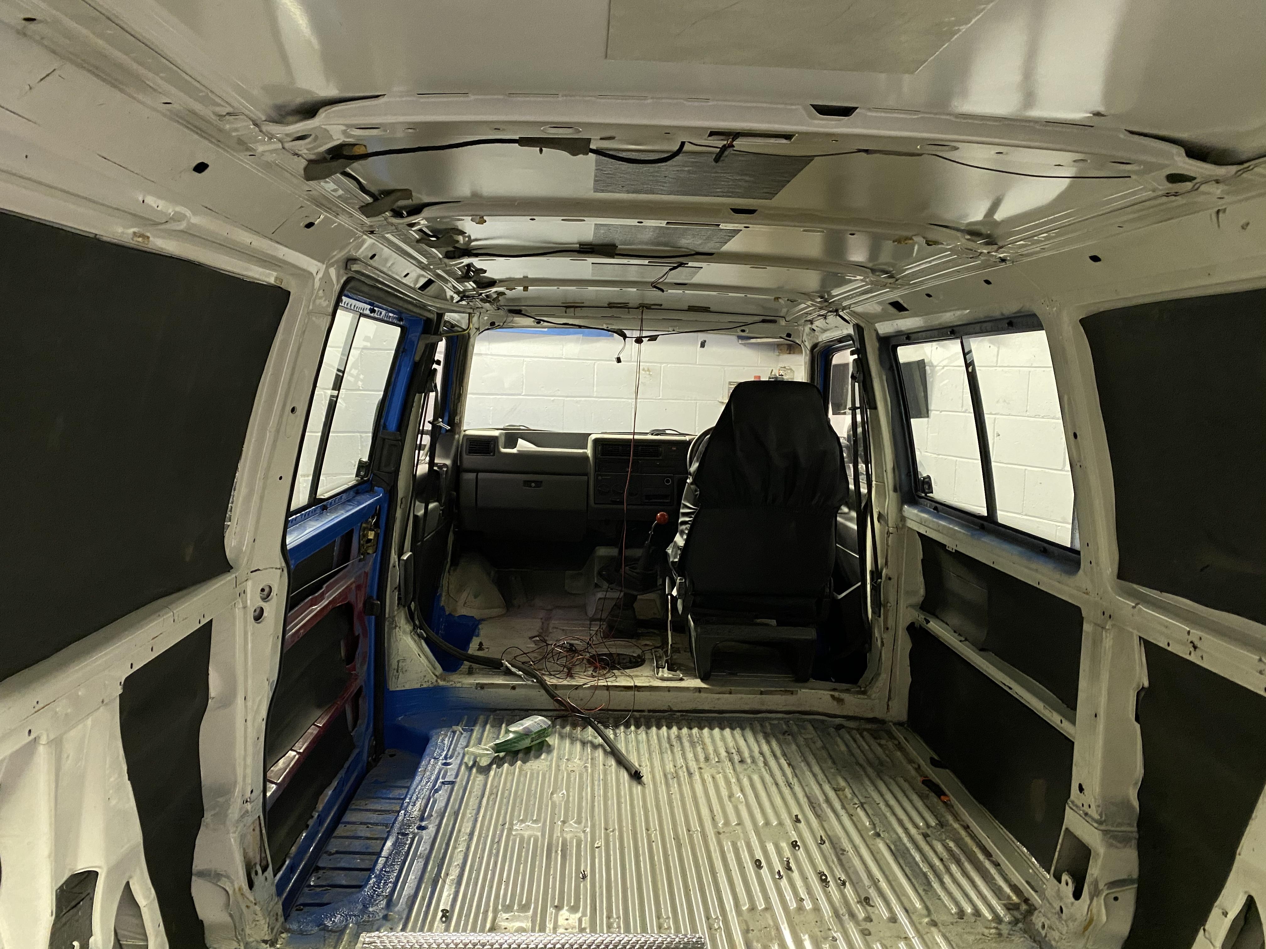

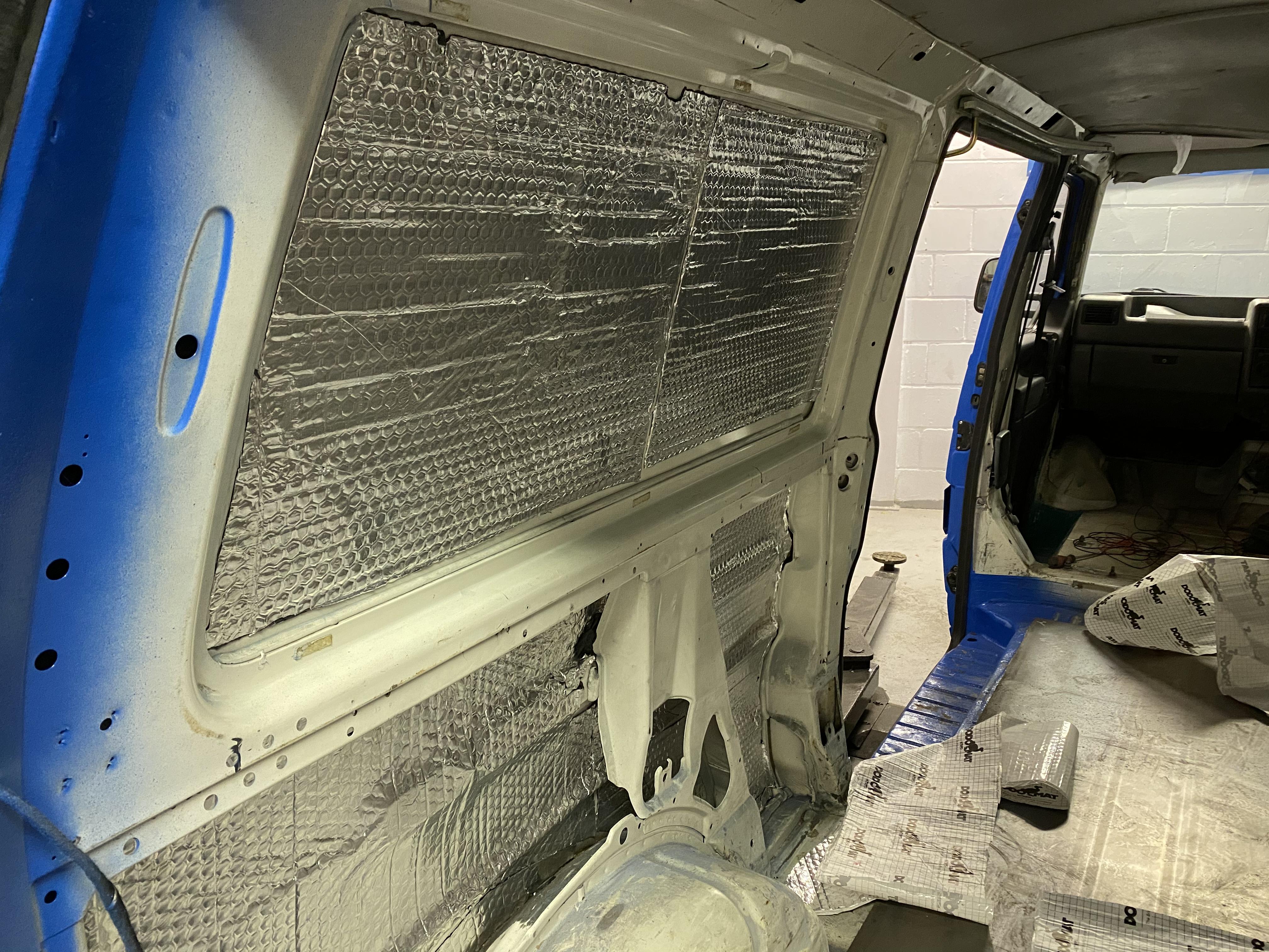

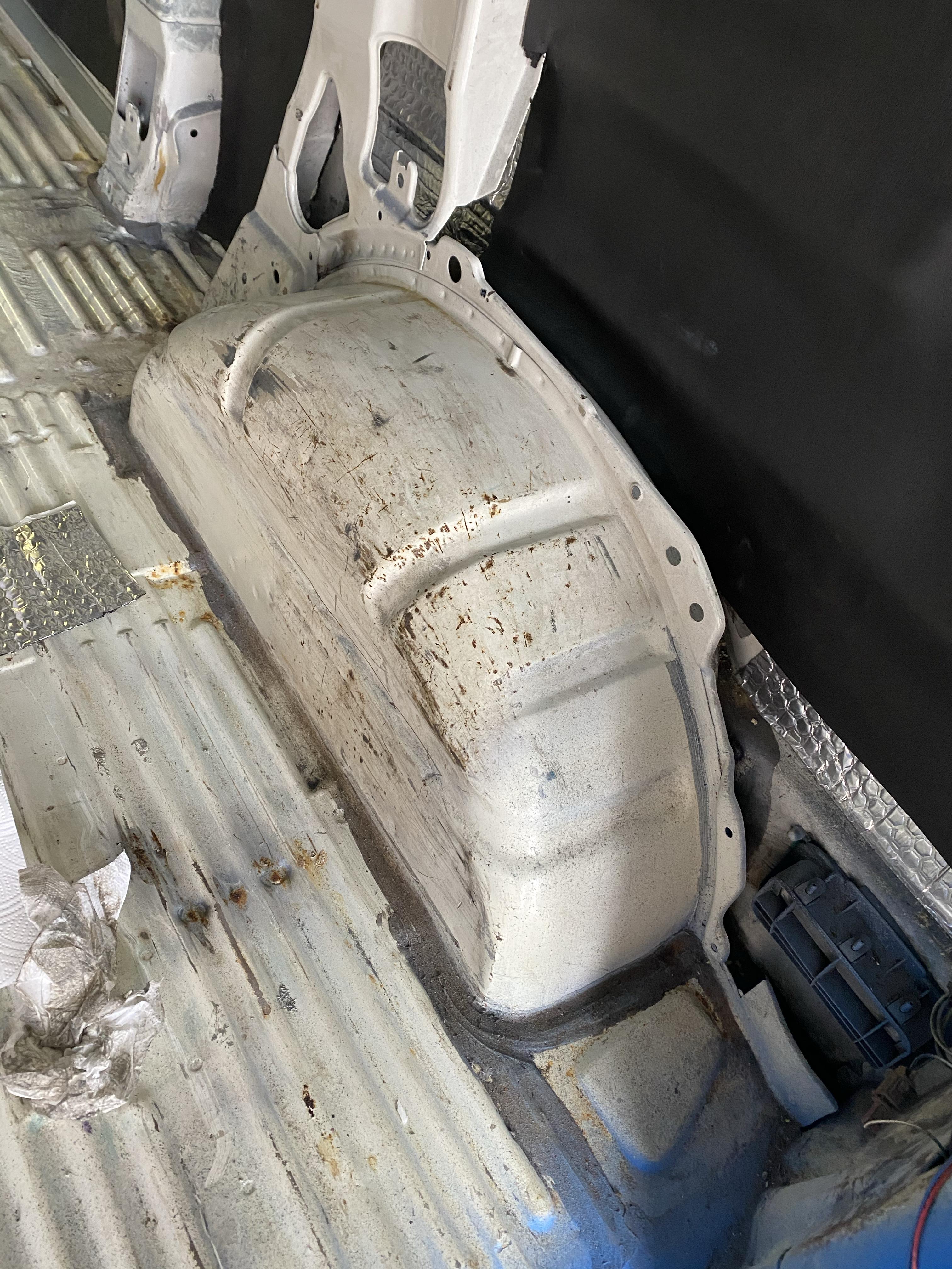

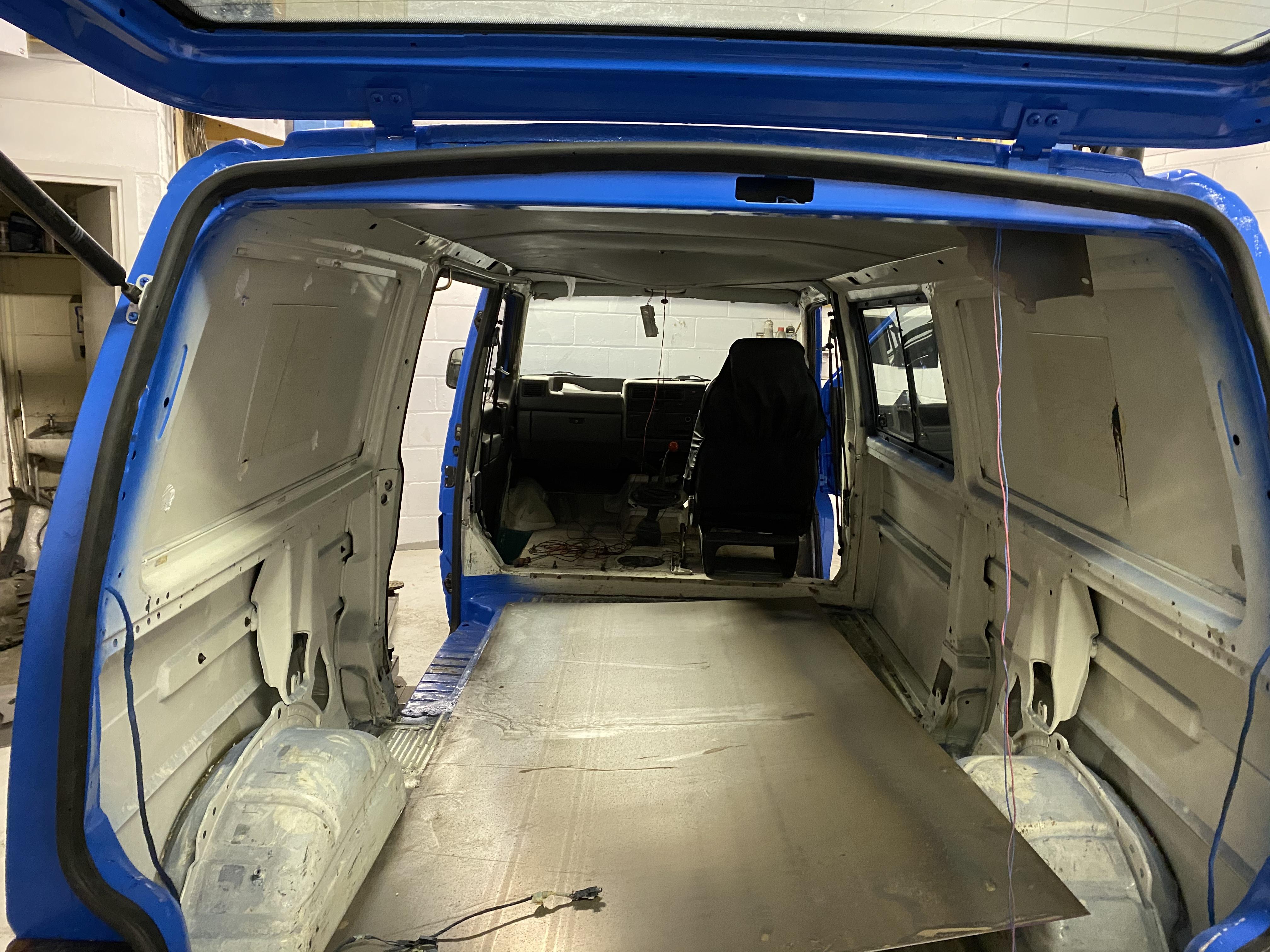

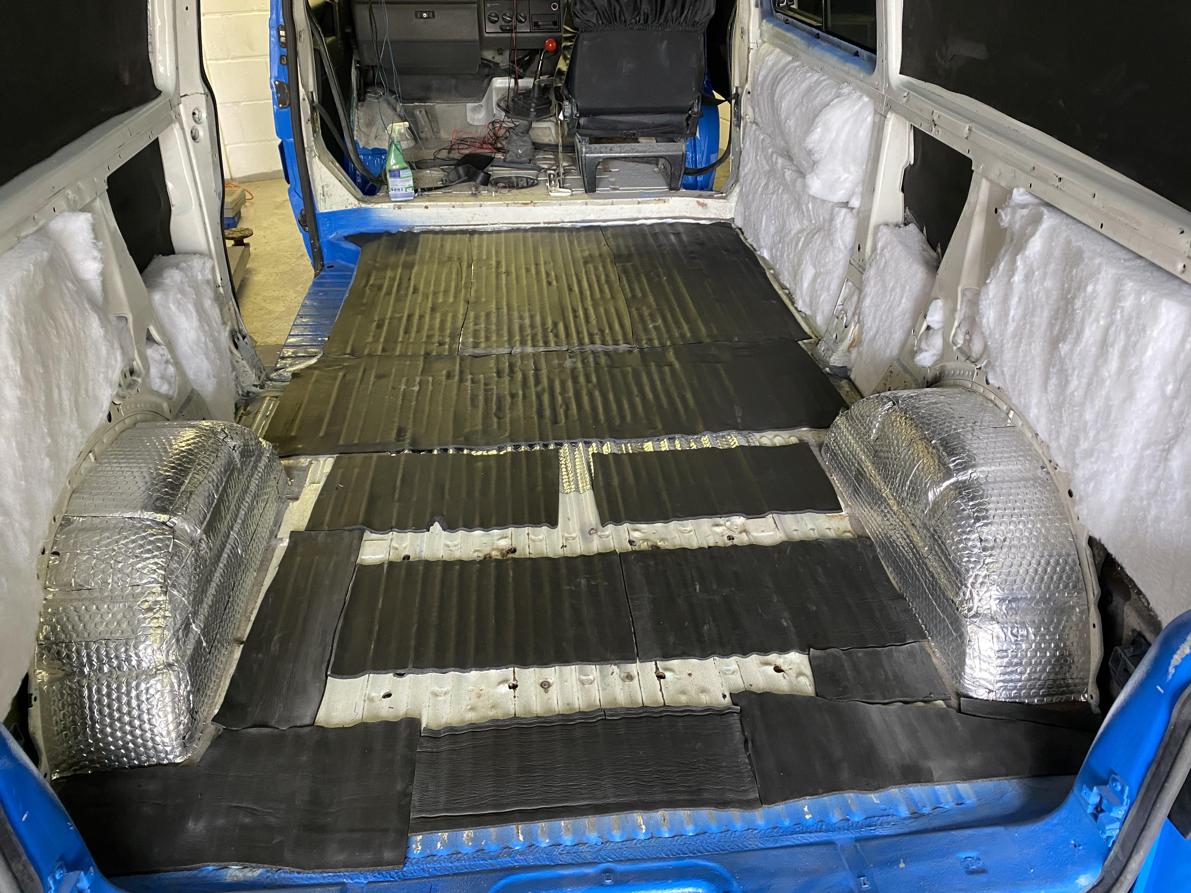

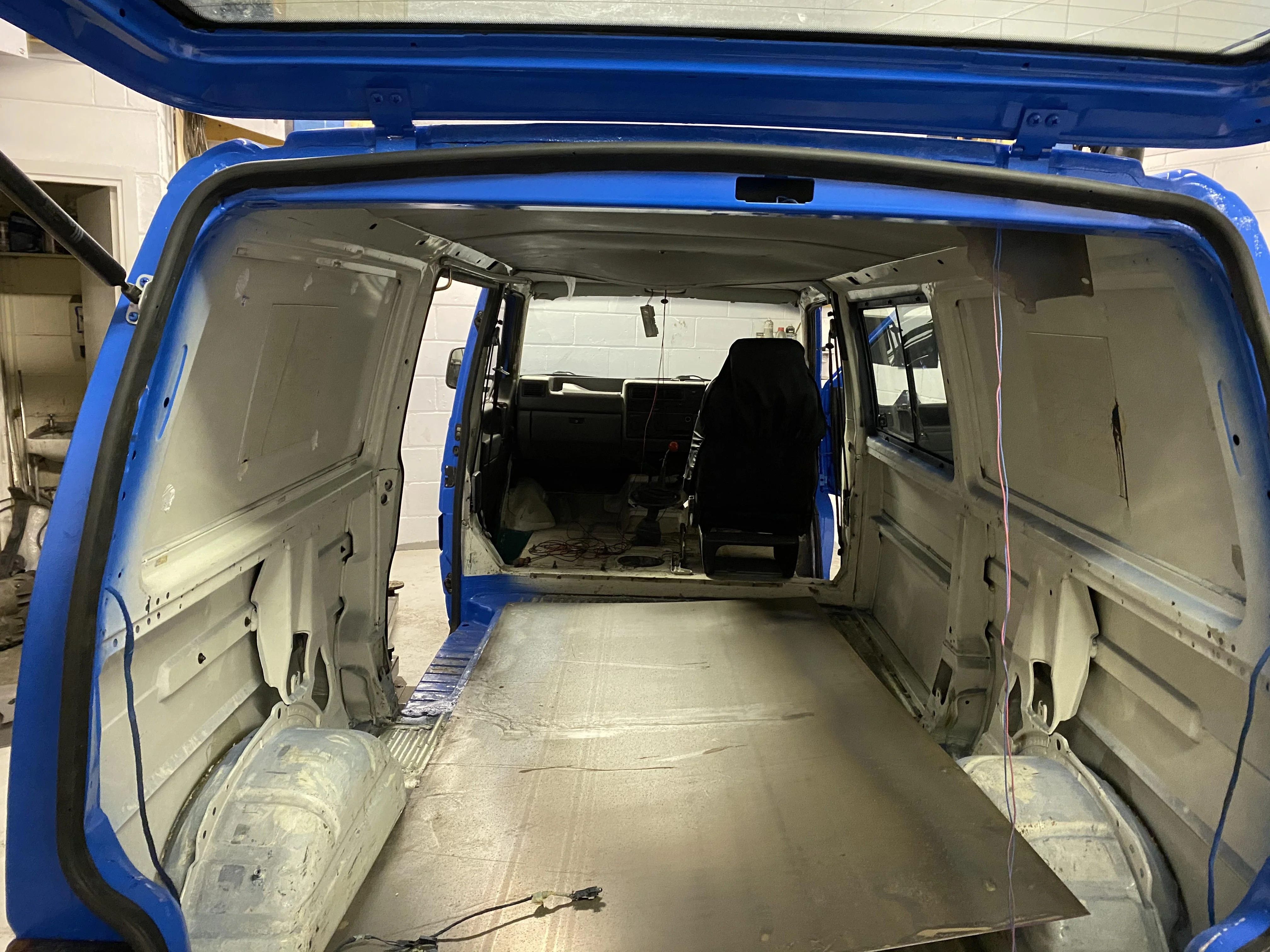

Then it was a case of the sound deadening and insulation for the rear.
Started like this.
Foil backed sound deadening from Dodo matt.
Then closed cell foam for the insulation.
Roof and floor to go. Both layers go on the roof and just the deaden stuff on the floor.
I’ve got a recycled plastic “wool” to go on last just before the ply goes on. I’m off work for a week so that’s a job for next week.

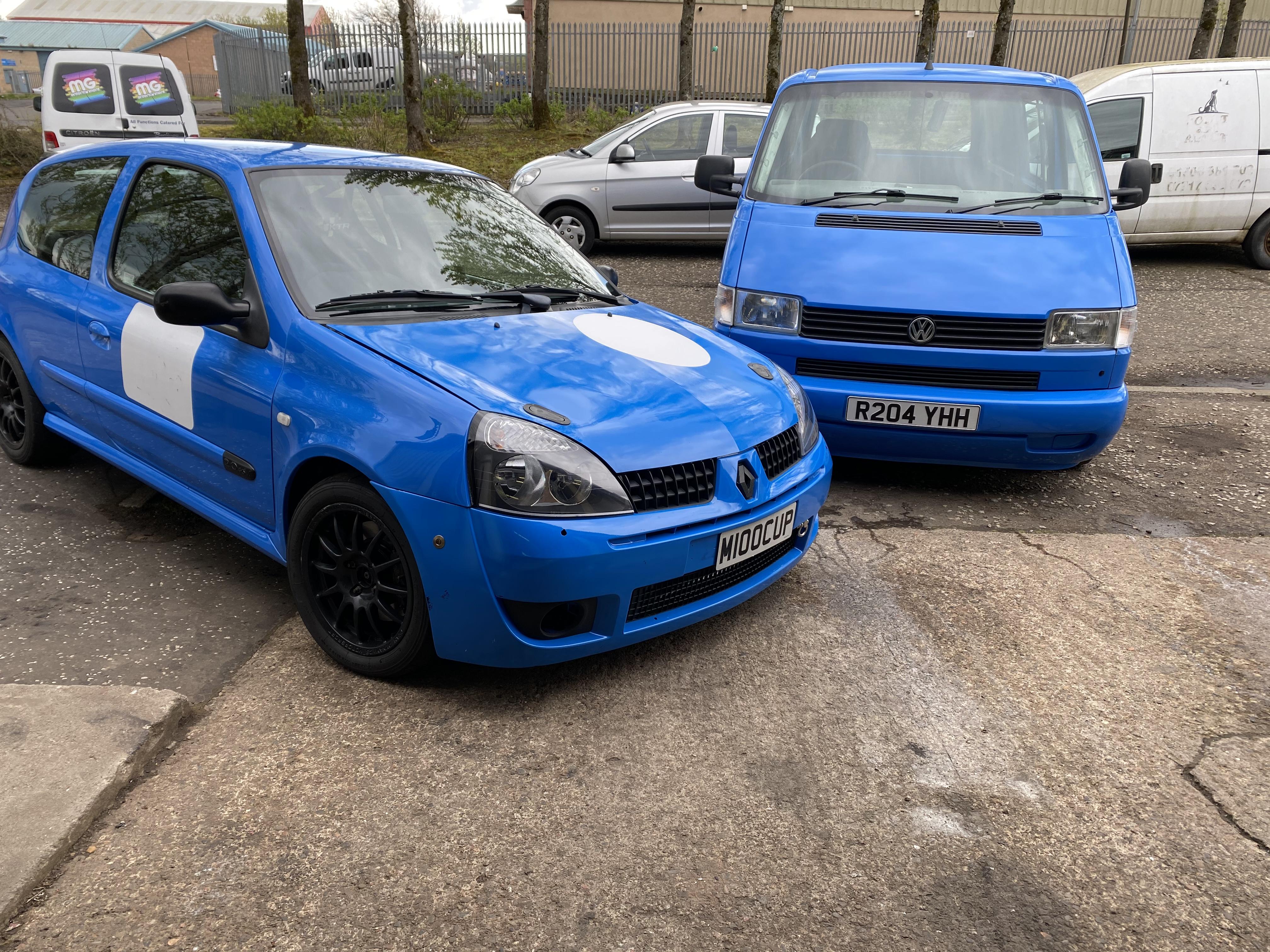

I took the opportunity to take a photo of the van with the clio when I had to use the little car to give the big diesel a jump. Very happy with how they look.

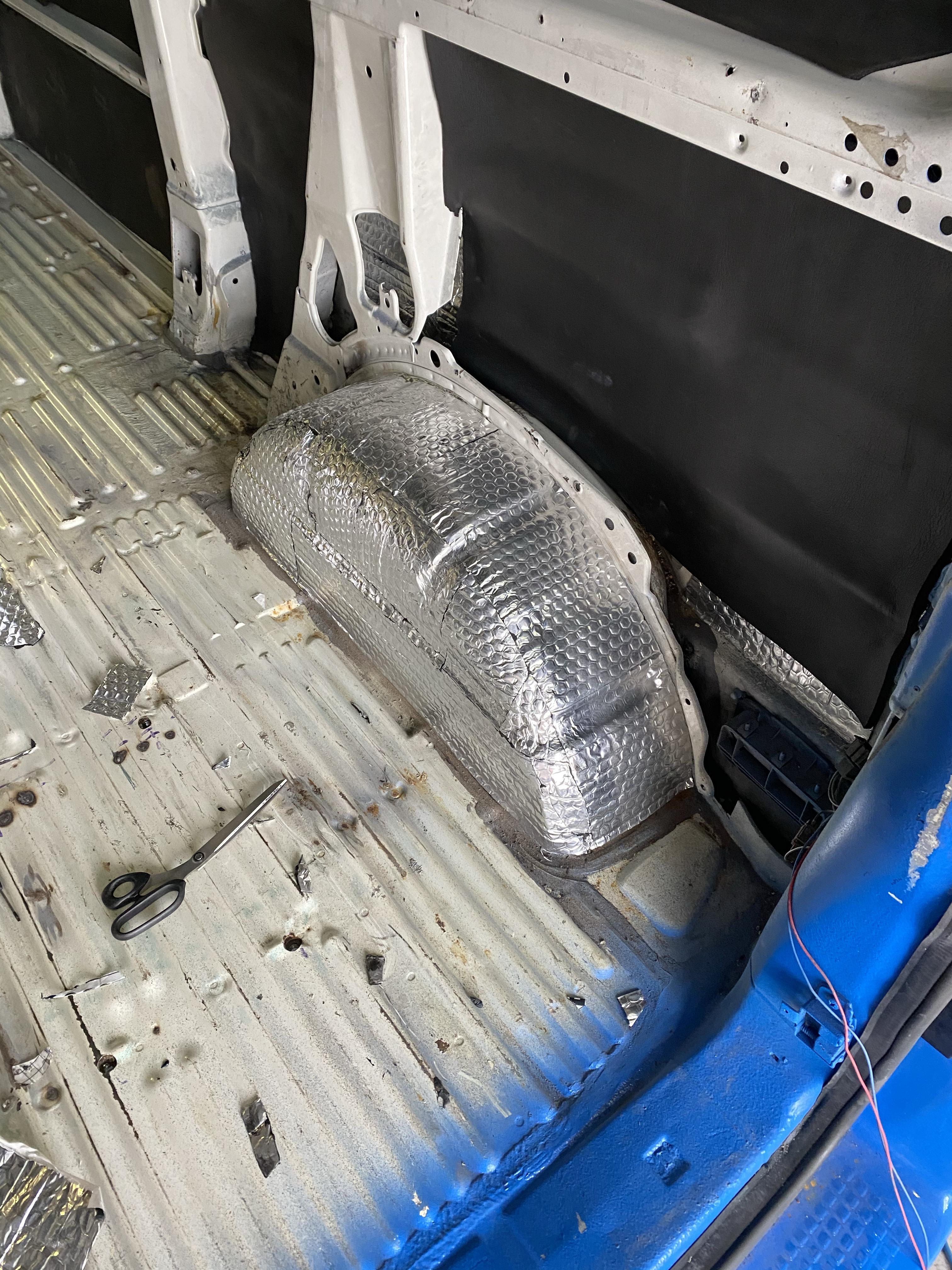

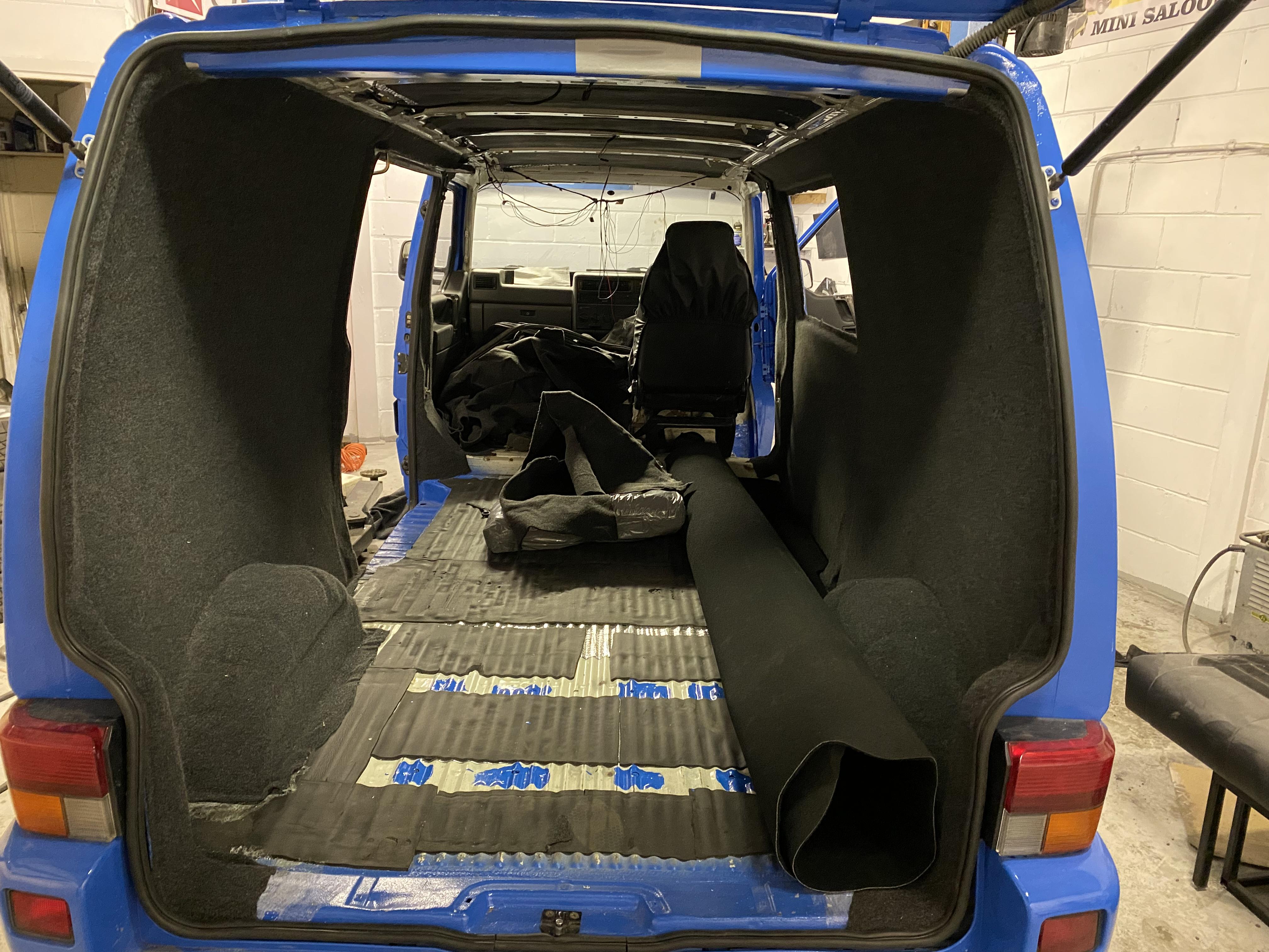

Wheel arches deadened / insulated.

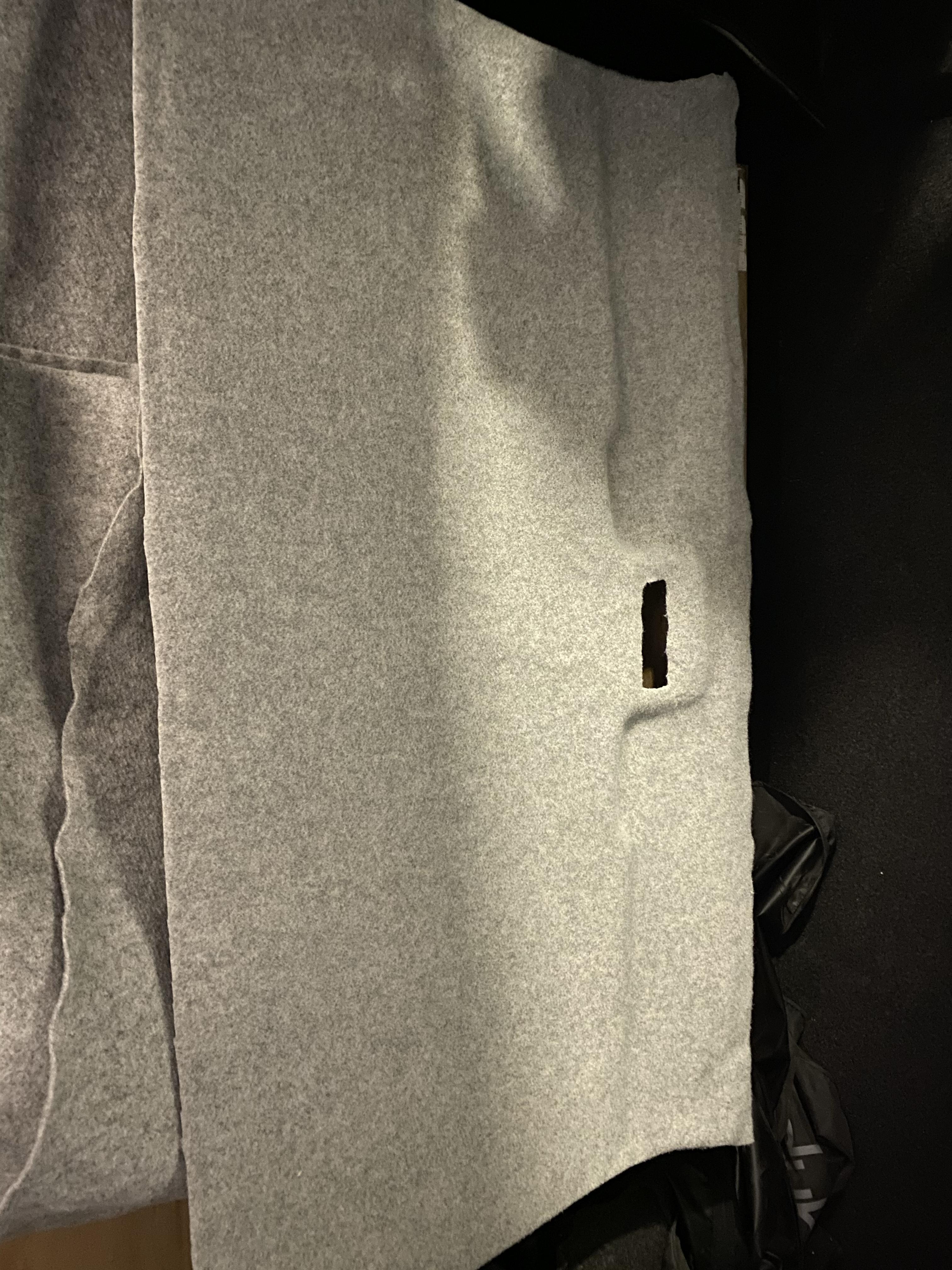

This took ages but doing it like this means you can lay the stretch carpet straight on to it and it will take the contours of the arch and look nice.
Then insulated the floor, leaving space for where the bed bolts to the floor. I’ve also stuck the thermo fleece stuff and insulated the roof.

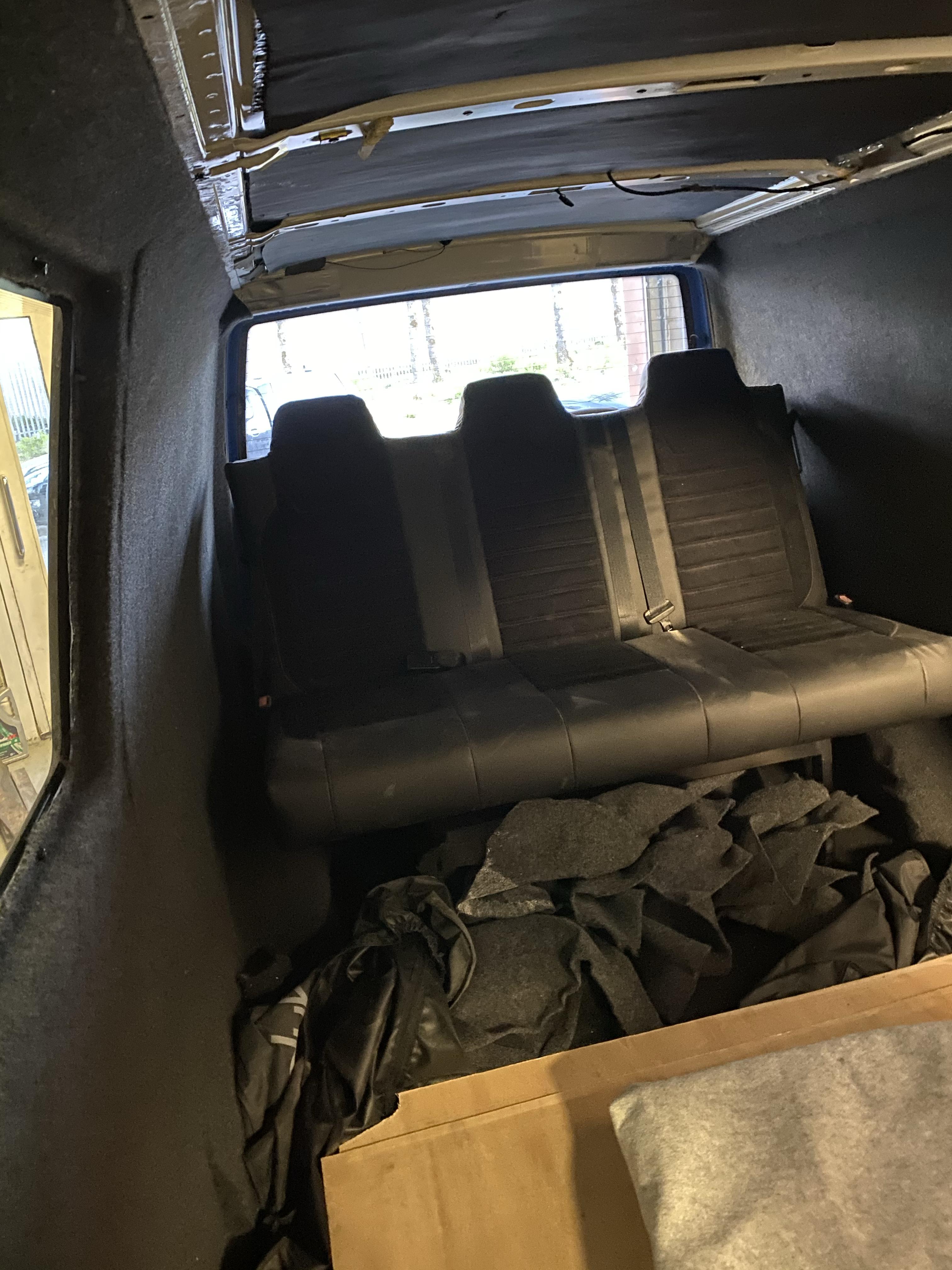

That’s where play was haunted. I had my ply side panels delivered but couldn’t screw them on until I get more thermo fleece. I’m collecting some spare from a mate tomorrow so not a disaster. I’m hoping to be at least 50% through the lining tomorrow.

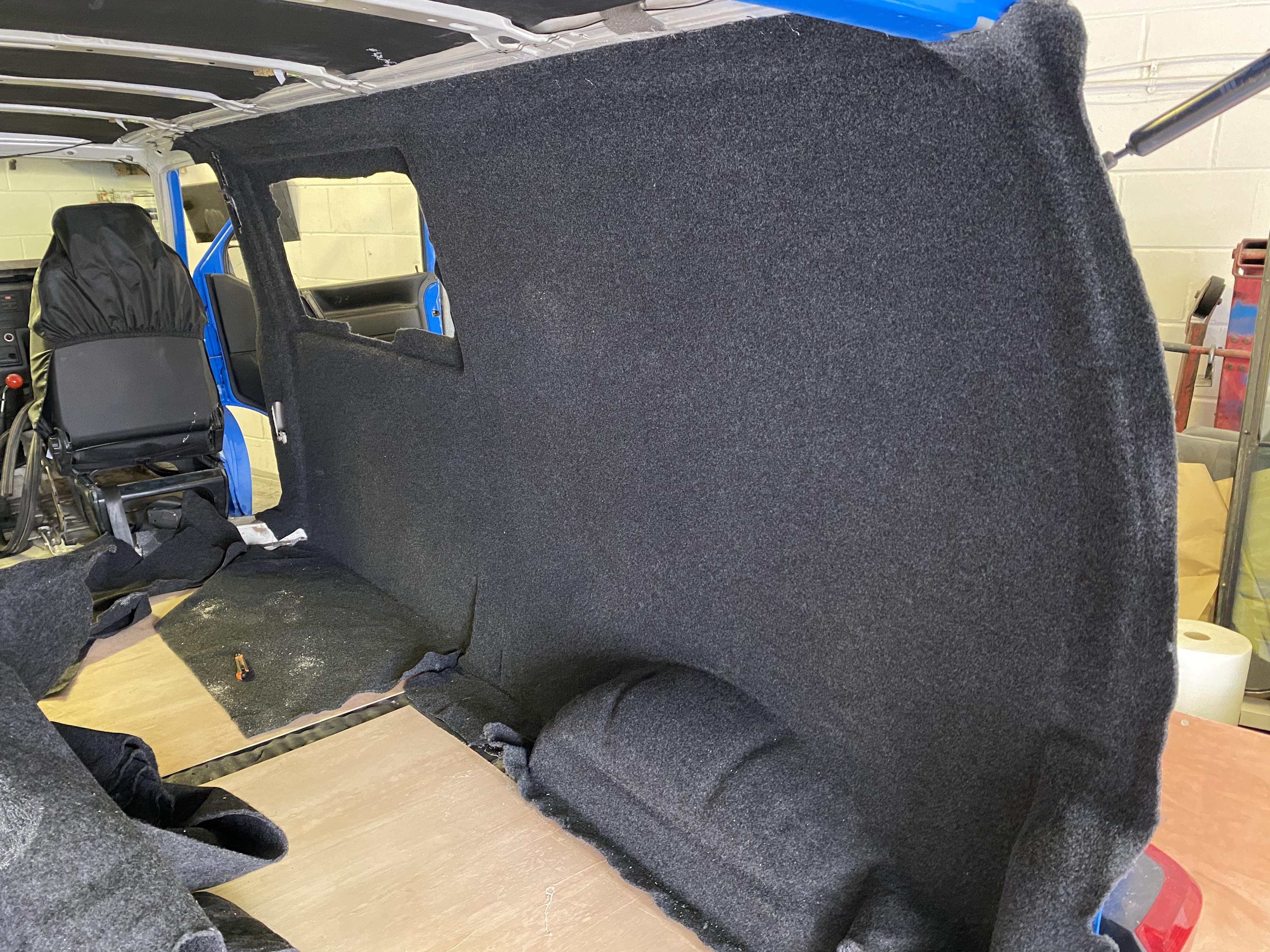

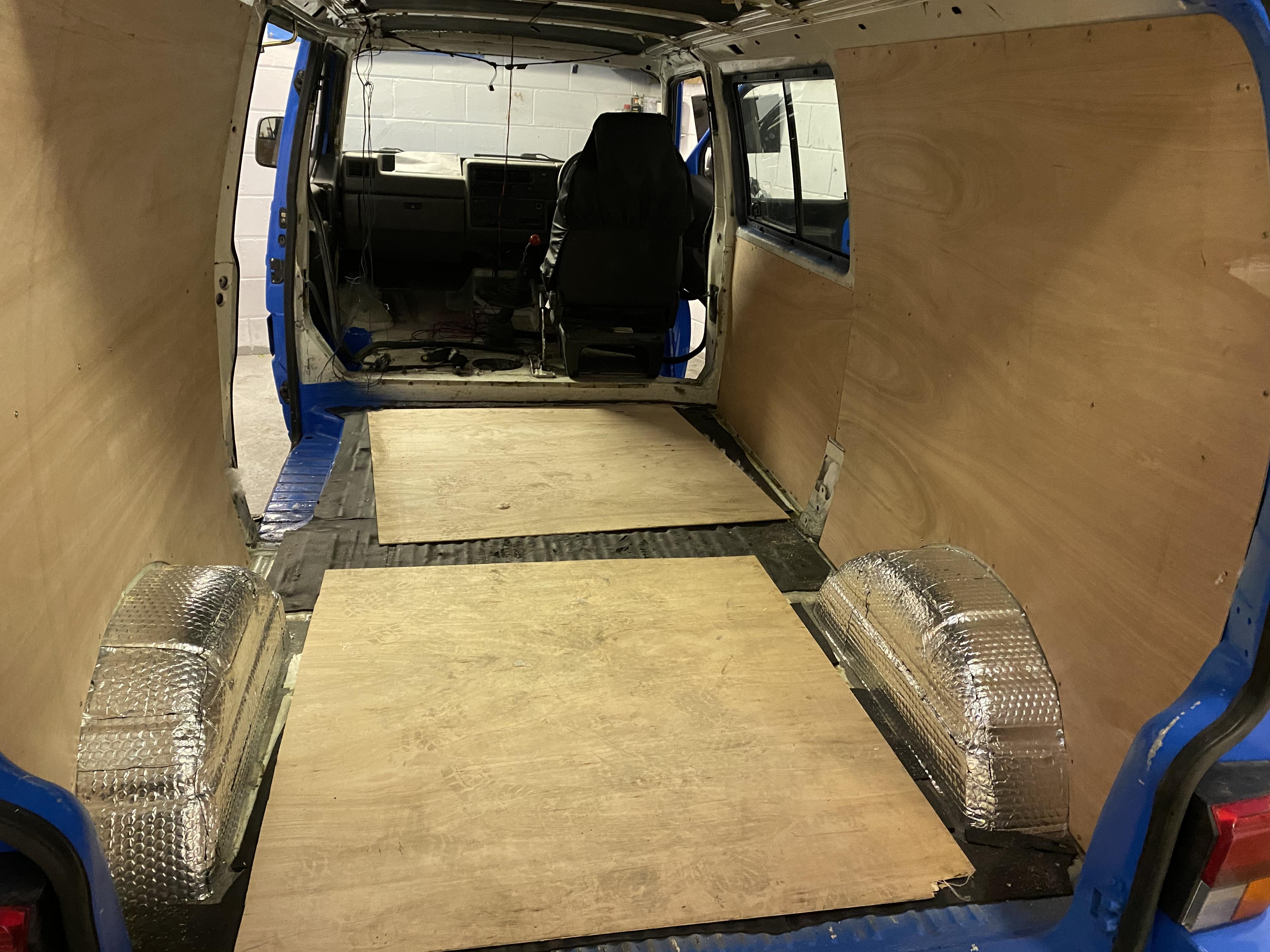

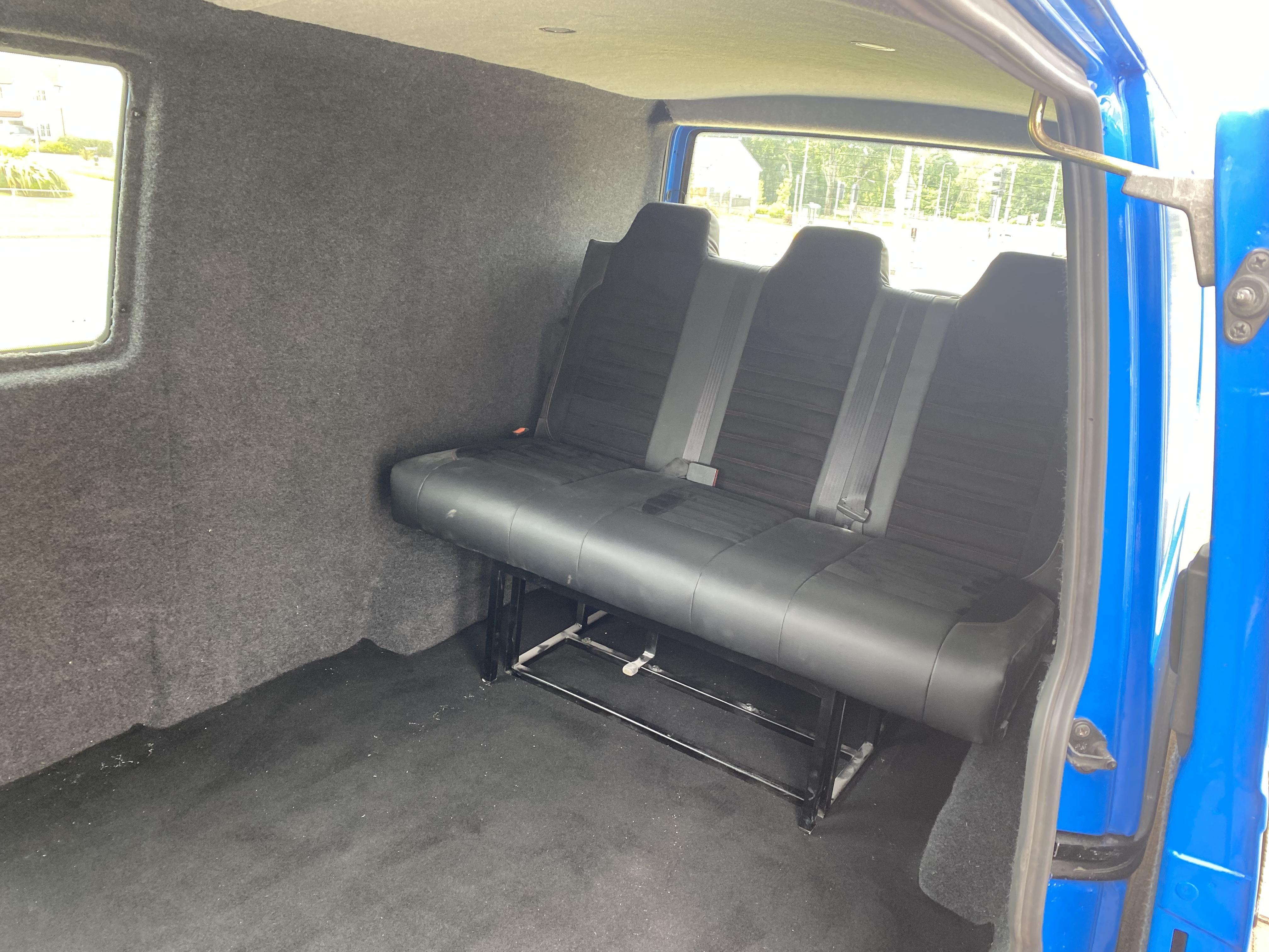

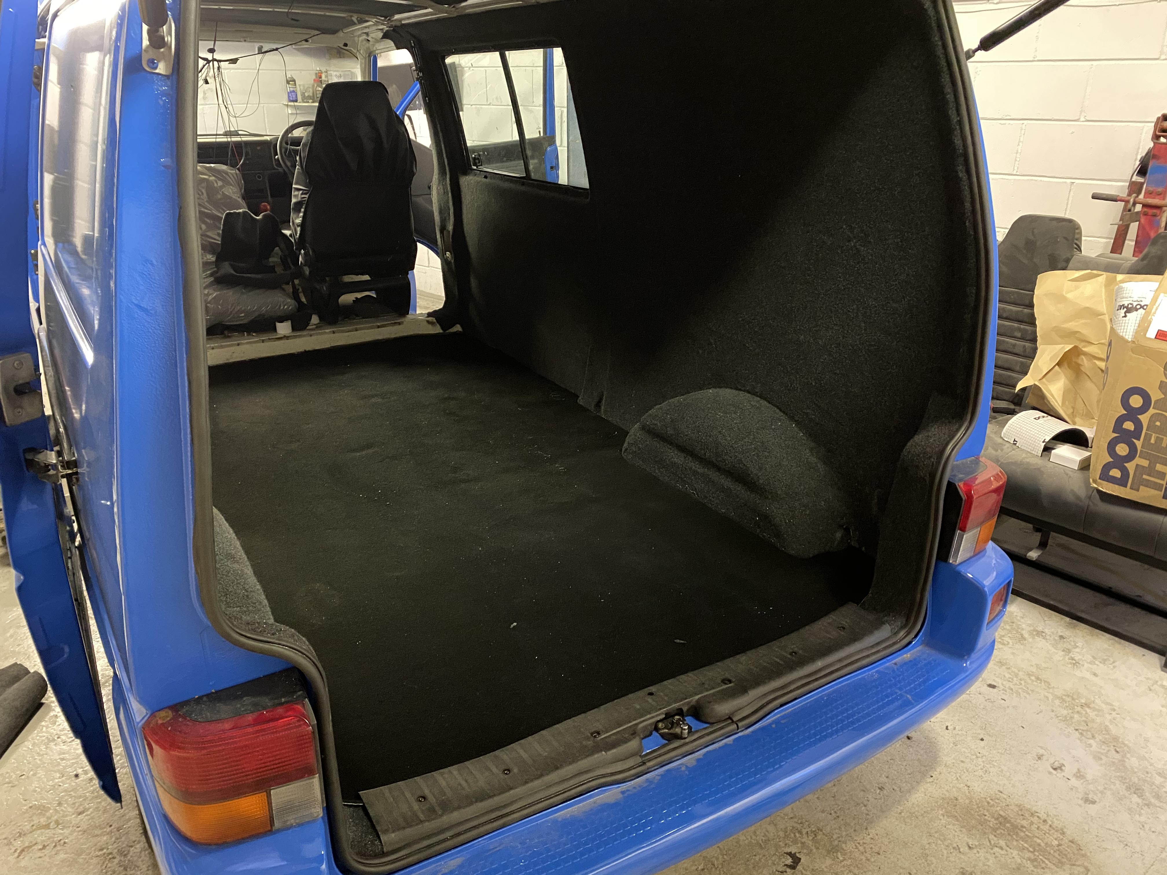

Decent result today got the remaining insulation in the ply panels screwed on and one side of the stretch carpet done. Very pleased with how it’s looking. What people say is true, a very forgiving and easy material to work with.
Passenger side tomorrow then it on to trining the individual trim panels for the sliding door, tailgate and headliner.
Lining complete, side window refitted and flooring down.

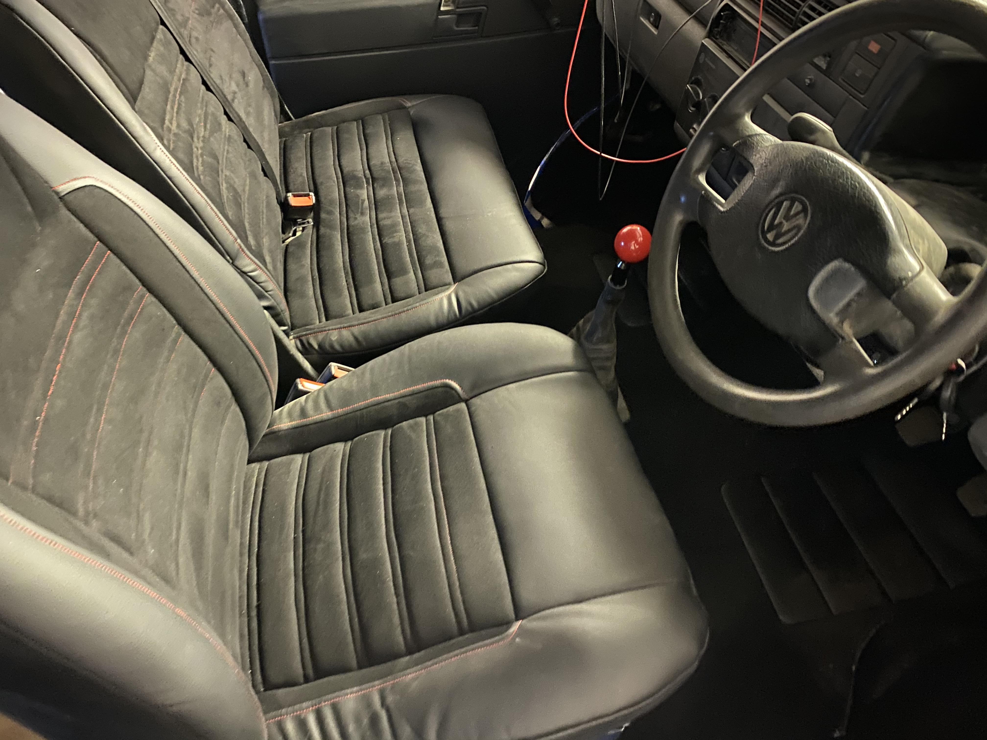

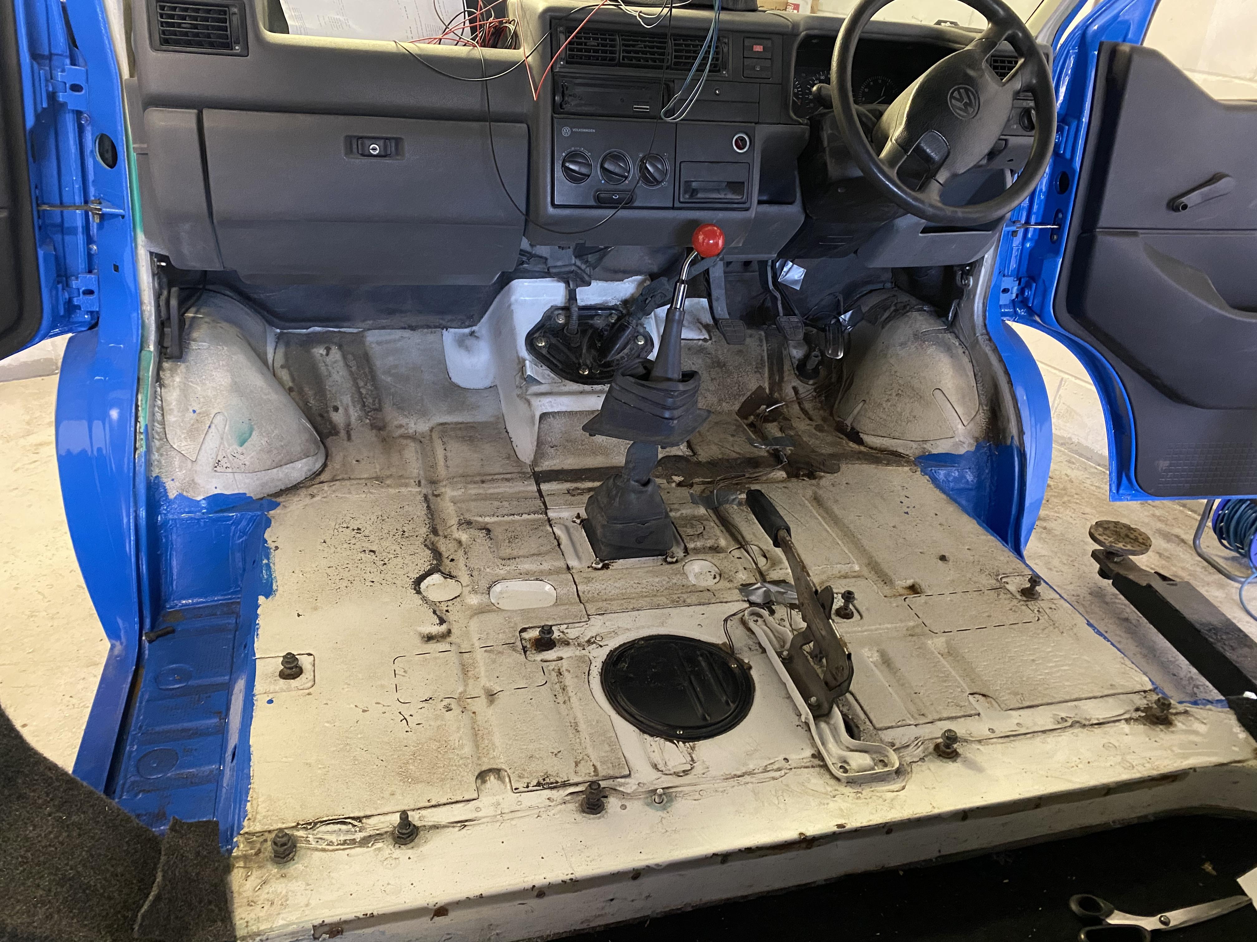

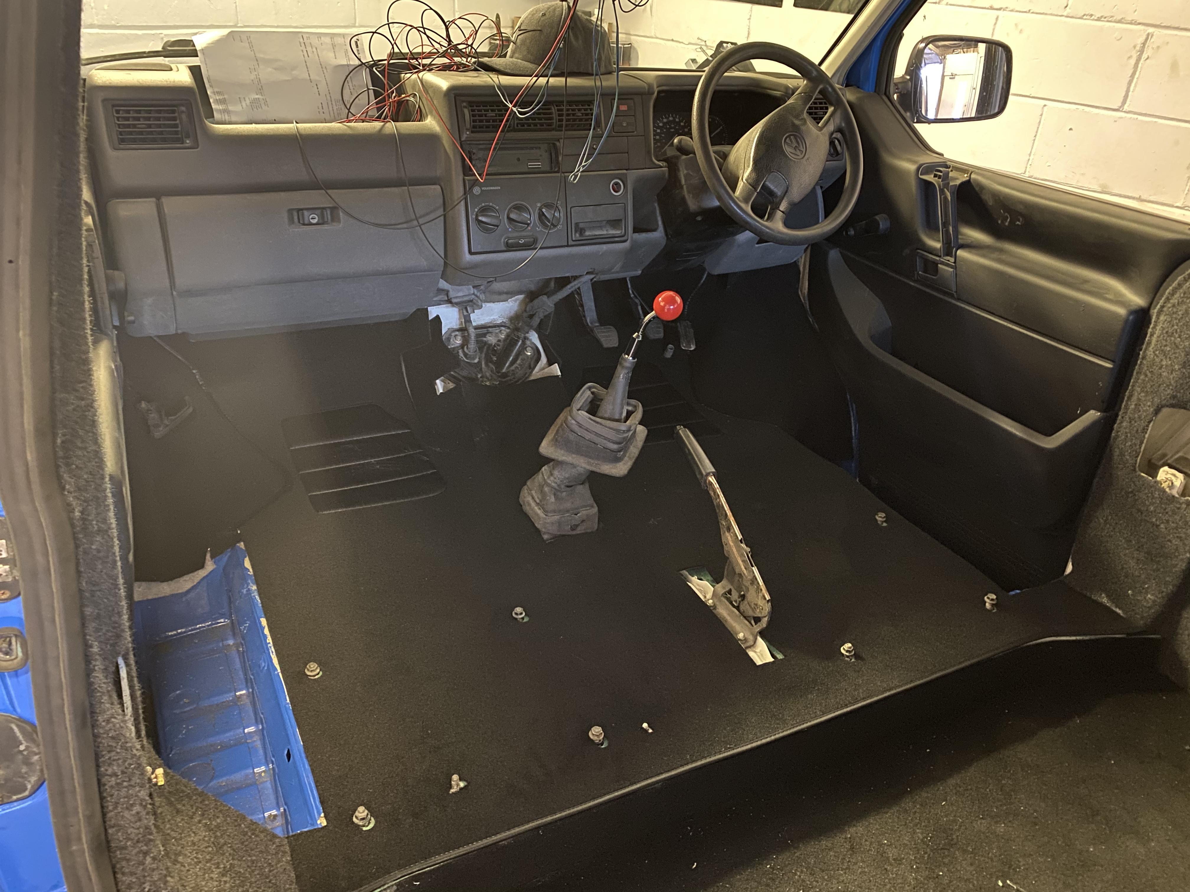

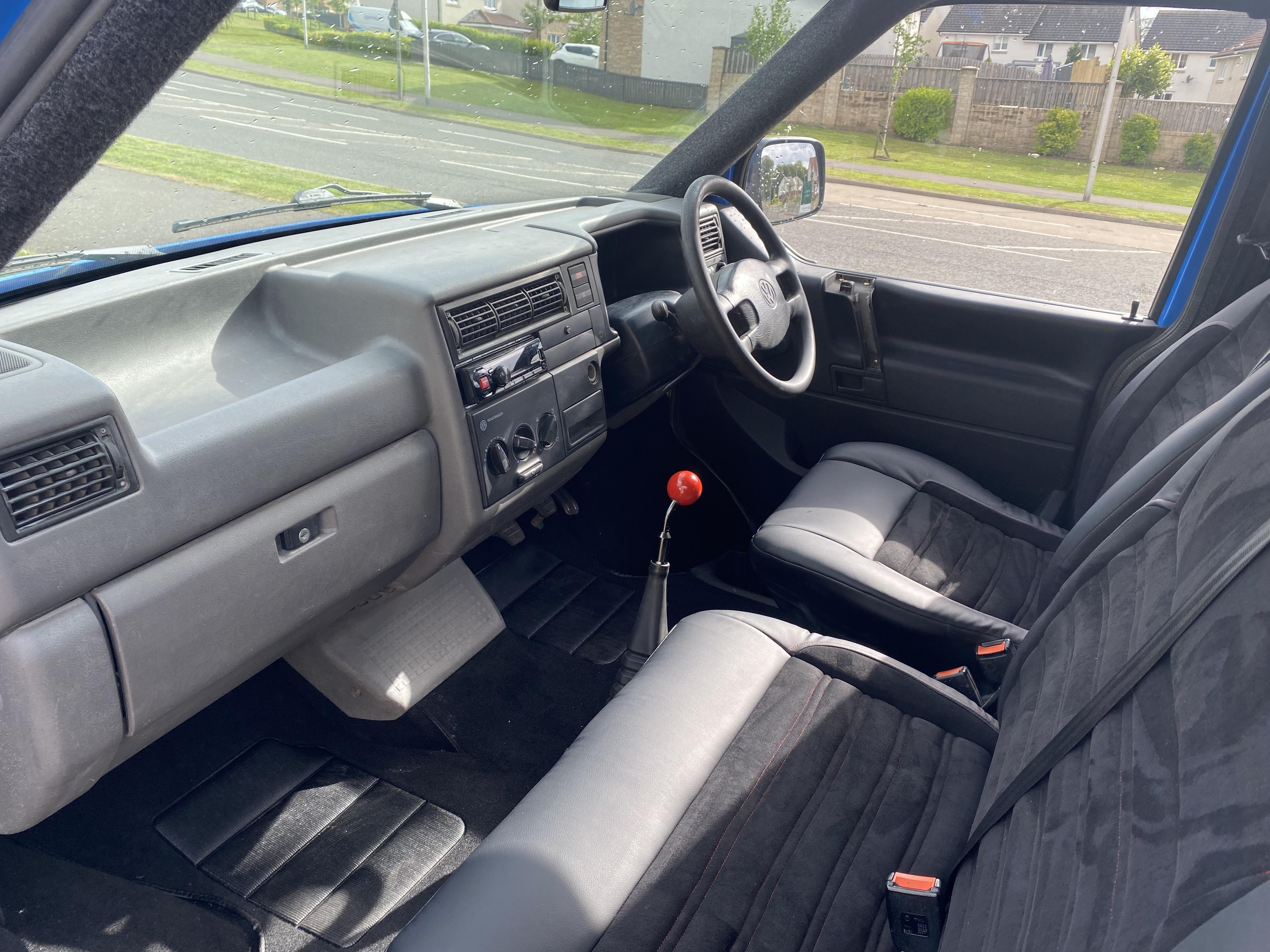

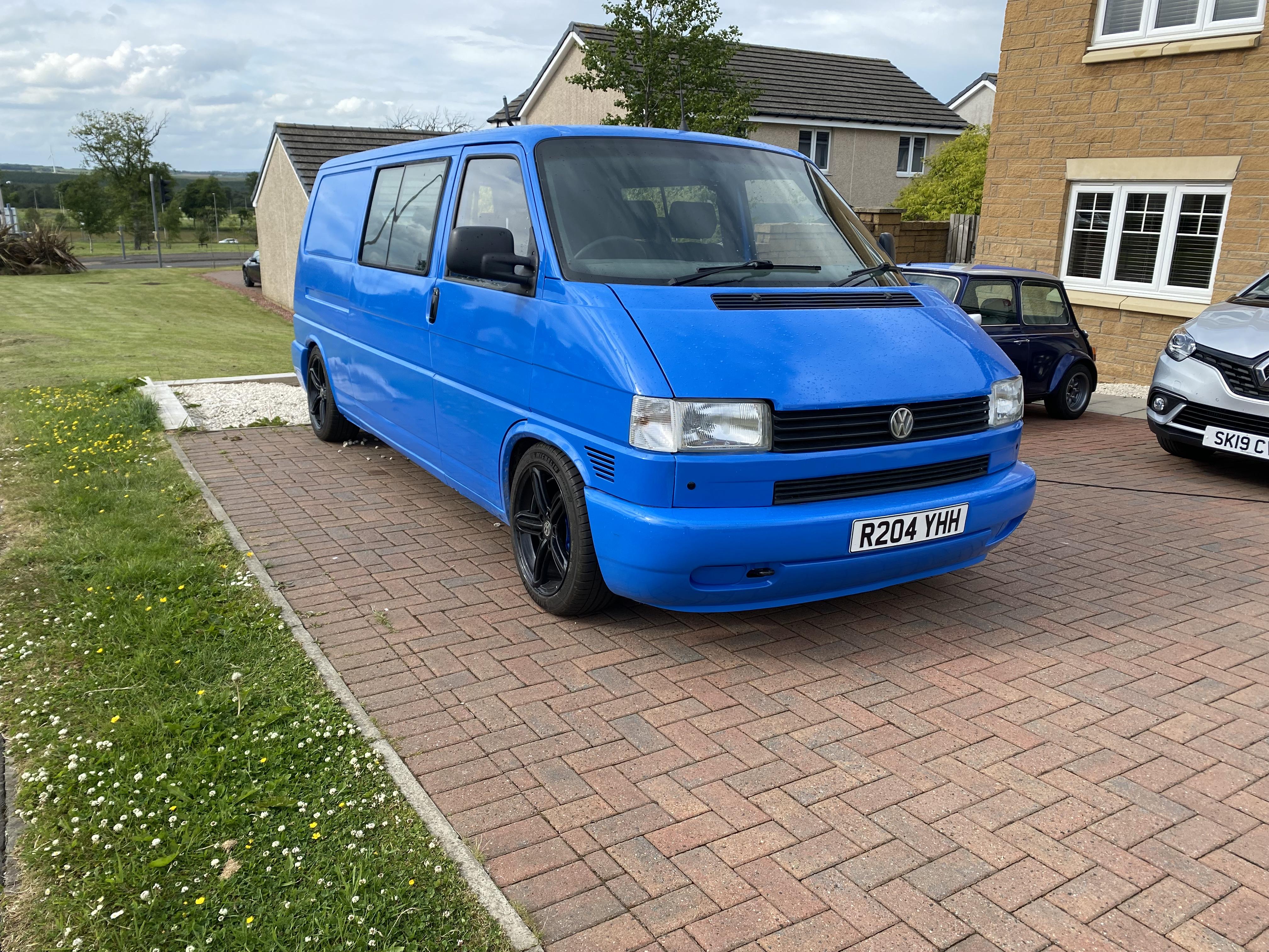

Today is MOT day. Progress on the van over the last week or so has seen the interior pretty much finished.
New cab carpet down. Very happy with it.
Seat back in and bolted down. Excuse the mess.
Front seats in. I’ll get a swivel base on the passenger seat in time.

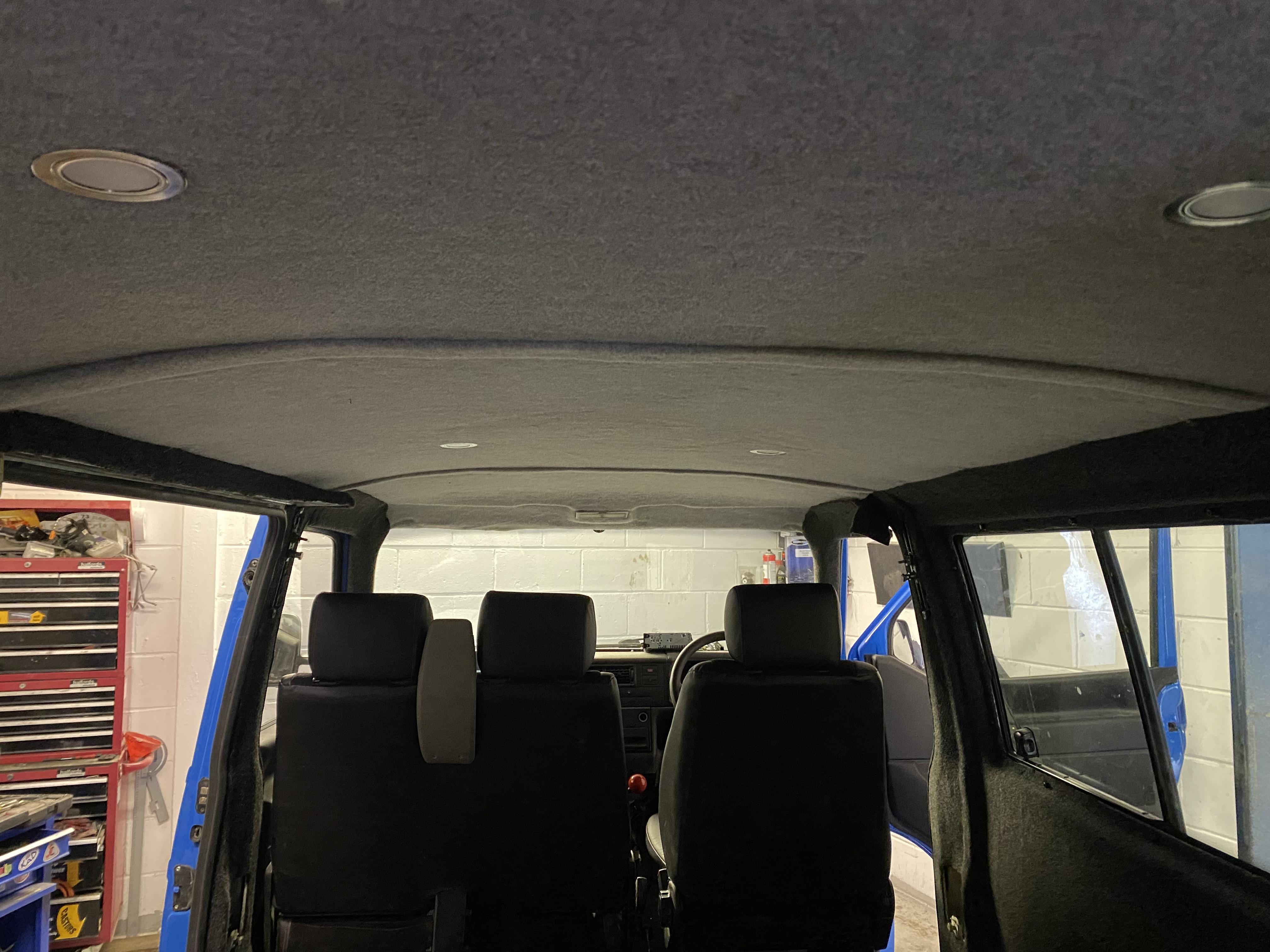

Front headlining redone in stretch carpet.
Headlining complete including touch style down lighters.

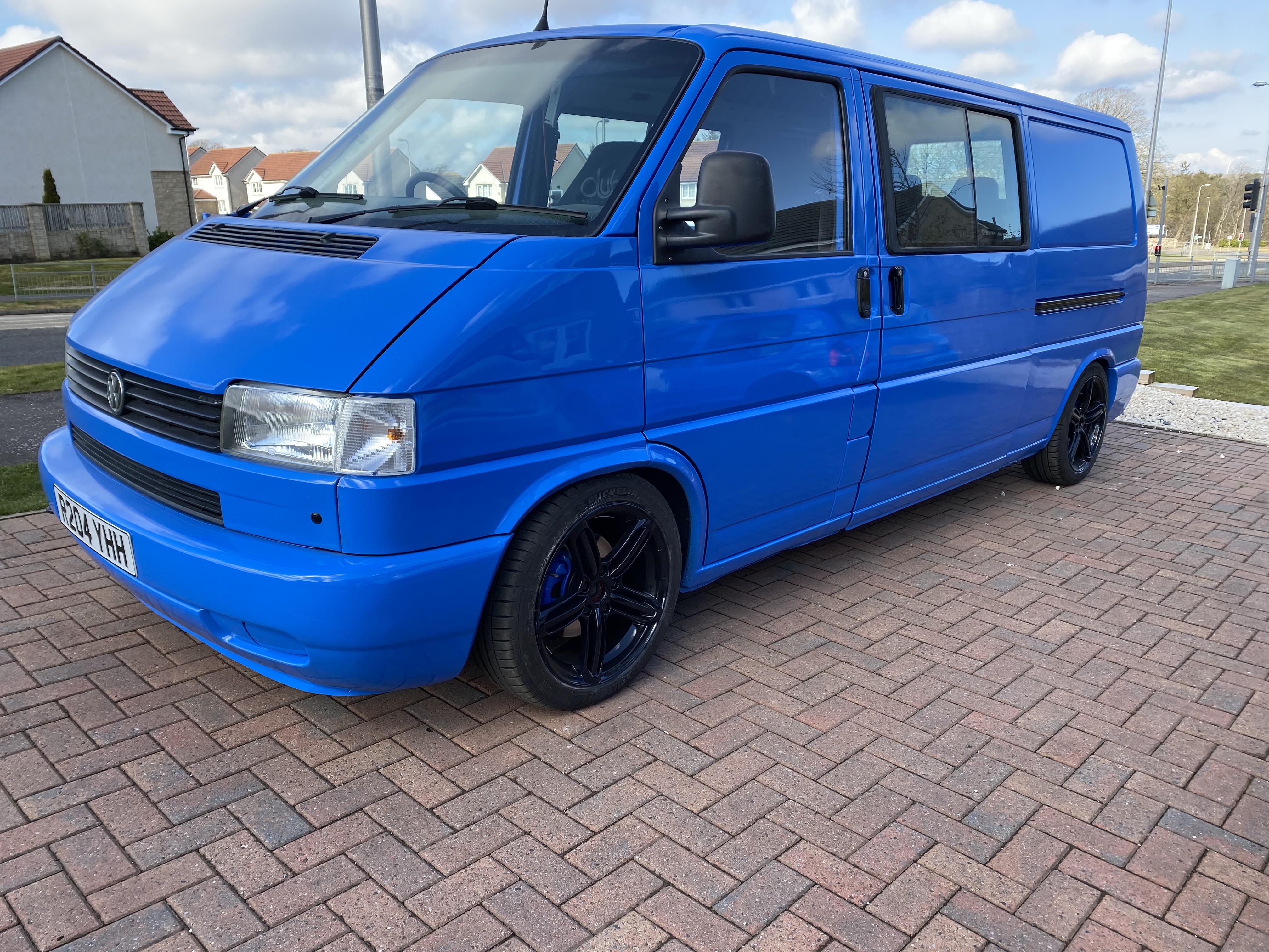

And that’s it. I’ve got a few little jobs before going camping but they can wait a week or so. I just want to get some miles on it and make sure it’s reliable.
MOT passed.
