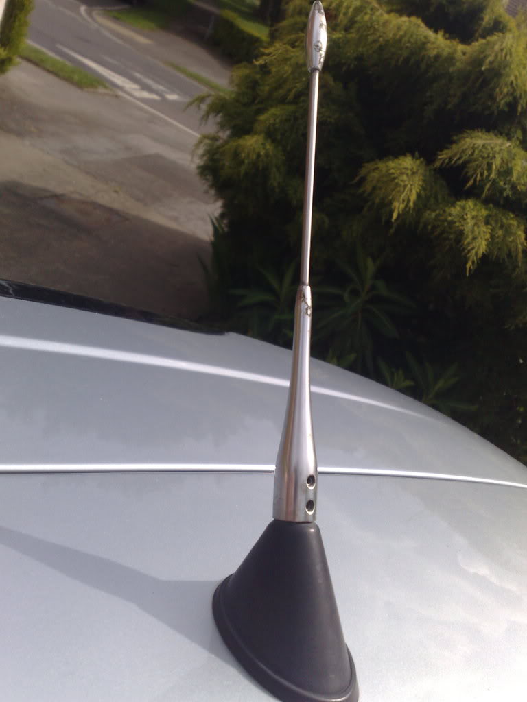

I cant remove this :(
Car  Clio Sport 172
how do i get this bloody thing off lol.
i have tryed turning it, unscrewing the allen key nuts. :(
cheers
Try giving it a good turn to undo it. If that don't work try tightening it up a bit, then un doing it. If all else fails, hacksaw it off.
Shoot abit of WD40 through those screw holes?
I took mine off the day after i put it on, Couldnt get any radio, Poorly made etc. Looked crap.
just keep trying mate!
In just PC'd my mates silver 172, same colour as yours, check the media bit in about 20 mins to see the results, might change your mind!!
Undo screws all the way, spray wd40 and try turning it with a bit of brute force. If that doesnt work get some mole grips, previous owner has probably glued it in.
Some of these have a lefthand thread as an anti theft device.
The more they try to undo it, the tighter it gets.
Try turning it clockwise with some force to remove it.....but not too much.
its off!!!!! wooop plyers to it :D didnt need to undo the allen key. i rounded them off anyway lol.
