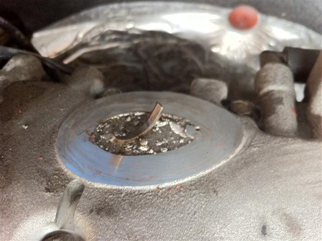

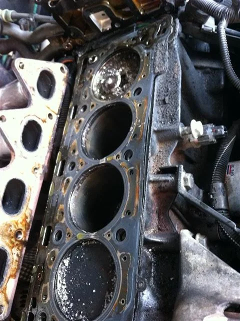

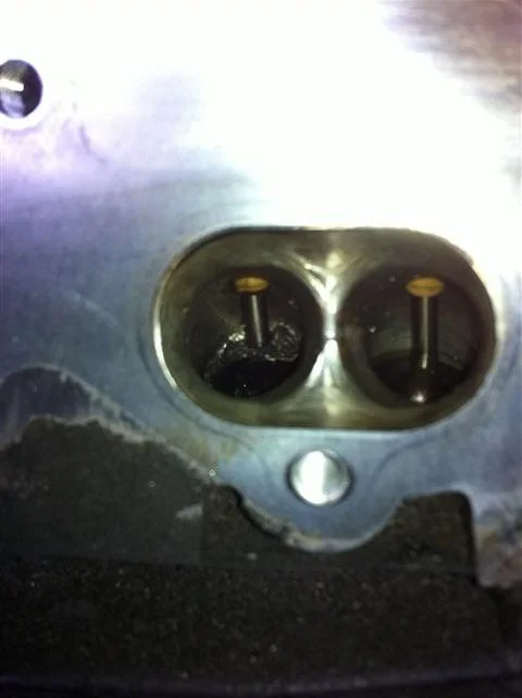

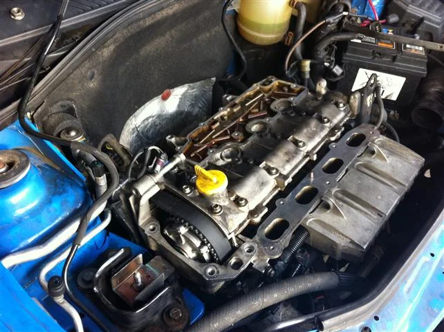

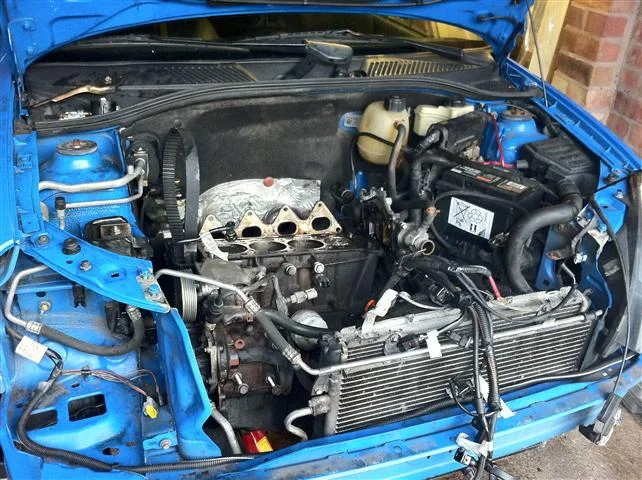

this is as far as i can go on my own, going to wait for the lad to come and remove the cambelt, rocker cover so we can see the extent of the damage.. its clear the inlet valves have dropped.
  DON'T SEND ME PM'S!!
That's a valve seat. I wouldn't even bother with taking the head off, there will be nothing worth using left
the same bloke? honestly? have you read nothing thats been said at all?

Sound like your pistons have munched most of you exhaust valves from slipping a few teeth. That's why you're getting no compression and the engine's spinning so fast when you crank it over.

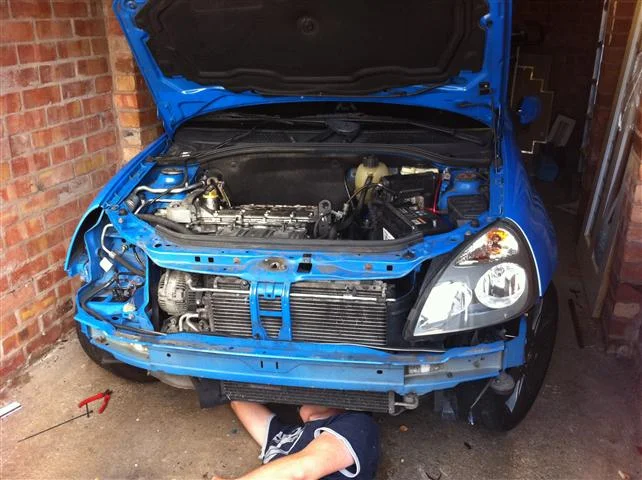

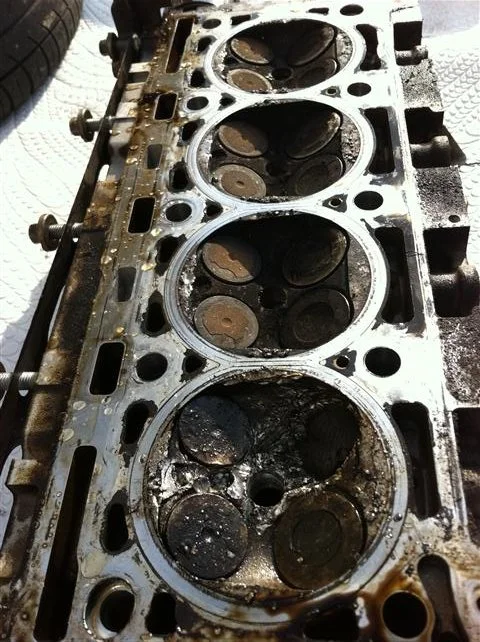

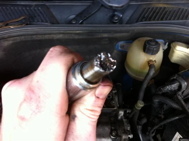

IMG_1915 (Small).JPGIMG_1919 (Small).JPGIMG_1921 (Small).JPGIMG_1923 (Small).JPGIMG_1932 (Small).JPG
maybe somebody should make a post on why "specialist" should be used, using my car as an example..
think a family member is going to lend me some money to try and source a motor from cliospares.. hopefuly my 172 motor, it made ok power and has had professional cambelt ect.. less than 1000 miles ago.
