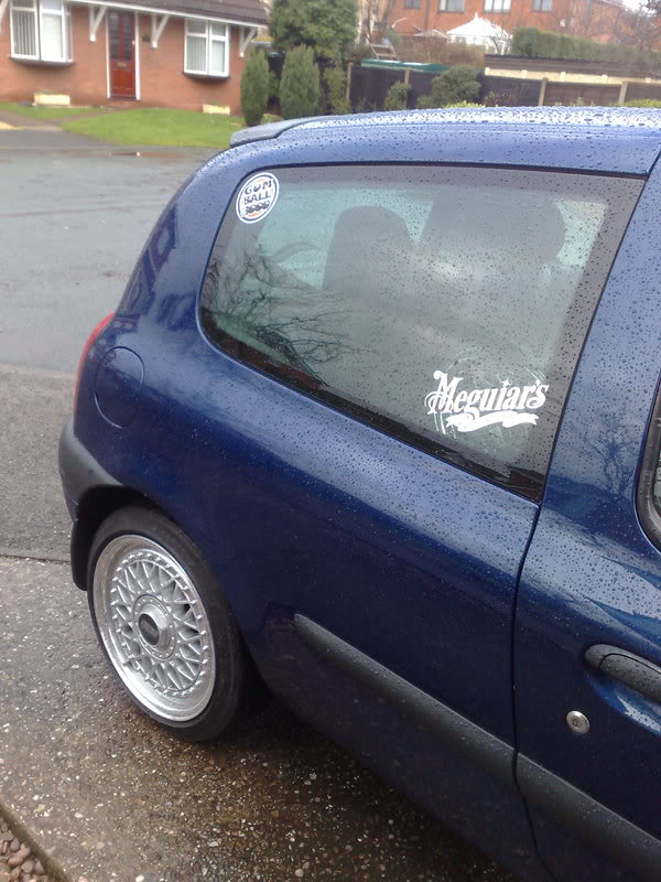

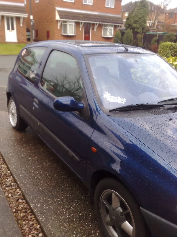

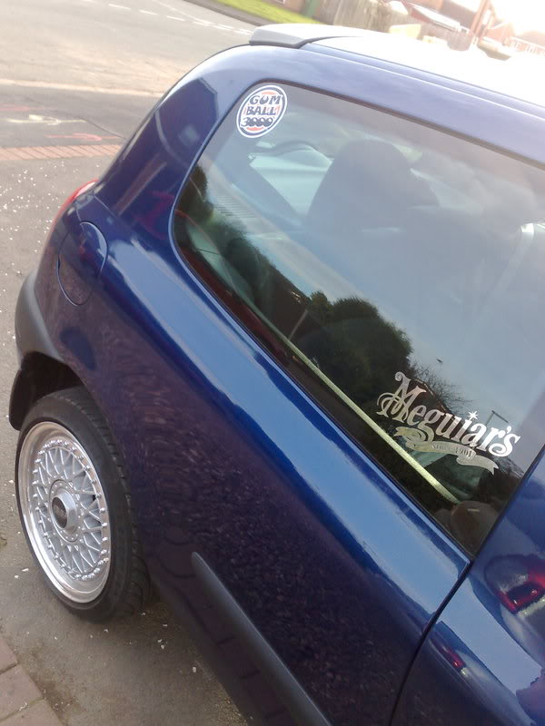

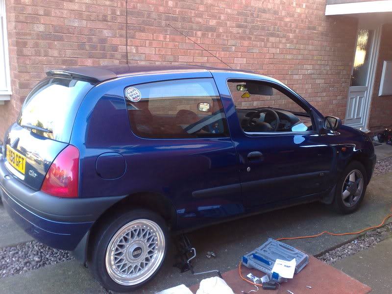

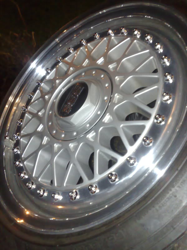

With the centre bores being the wrong size, its trial and error, grinding abit out with the dremel, and re-trying them on, got the 2 rears on now, and working on the front 2 later today :)
anywy, here are some teaser pics :)
hope you like,...

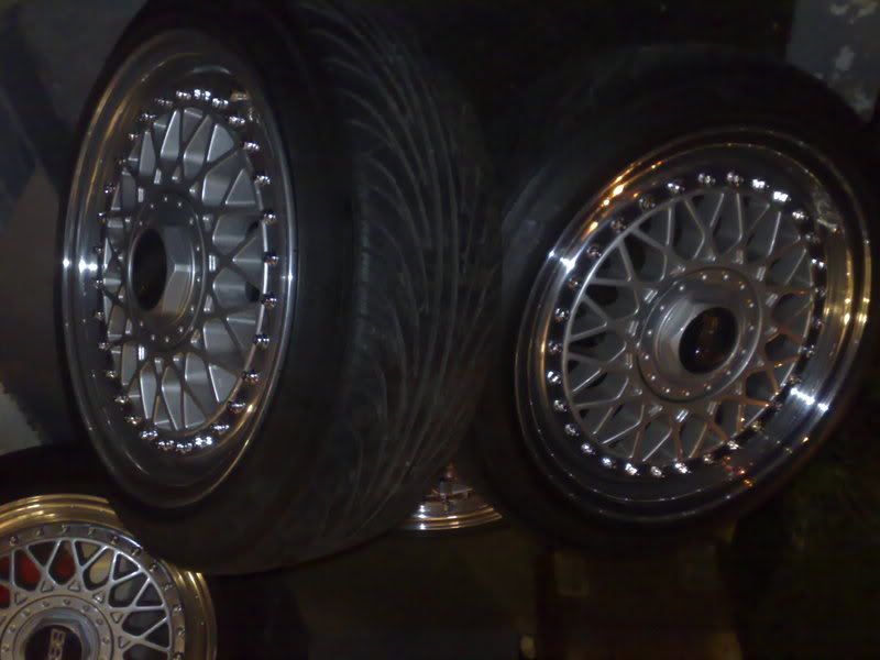

This is them when i picked them up :)
This is them in my living room, after the 9 hour round trip to fetch them!
Then here is a pic trialing them to fit..
And thats the first 2 rear ones on :)

How much did you pay rage? I nearly bought a similar set for mine a few months ago, love them! Whats the offset?

Grinding the centre bore out with a dremel? :eek: Now it might just be me and I might be completely wrong but is that not one of the most stupid f**king ideas i've ever heard?
How the hell are you removing exactly the same ammount of metal from each side so that the wheel mounts centrally?(sp?)? The center bore could be off centre now?
  Exige S1 + Honda S1
the bolts centre the wheel.
they are only 3mm smaller than the clio fitment anyway so not like you have to take much metal awah
  BMW M135i
spigot rings required imo
Doesn't matter if the bore isn't central.
Yeh I appreciate that but the weight of the car is taken on the centre bore not the wheel bolts as standard, i'd be using studs with that tbh. (well I wouldn't because i'd have done a proper job and had them machined, remember they're the only thing connecting the rubber to the car)
  Exige S1 + Honda S1
i had mine sent off to be machined but stopped the guy as they dont clear the brakes.
not so long ago cars never had centering holes...
