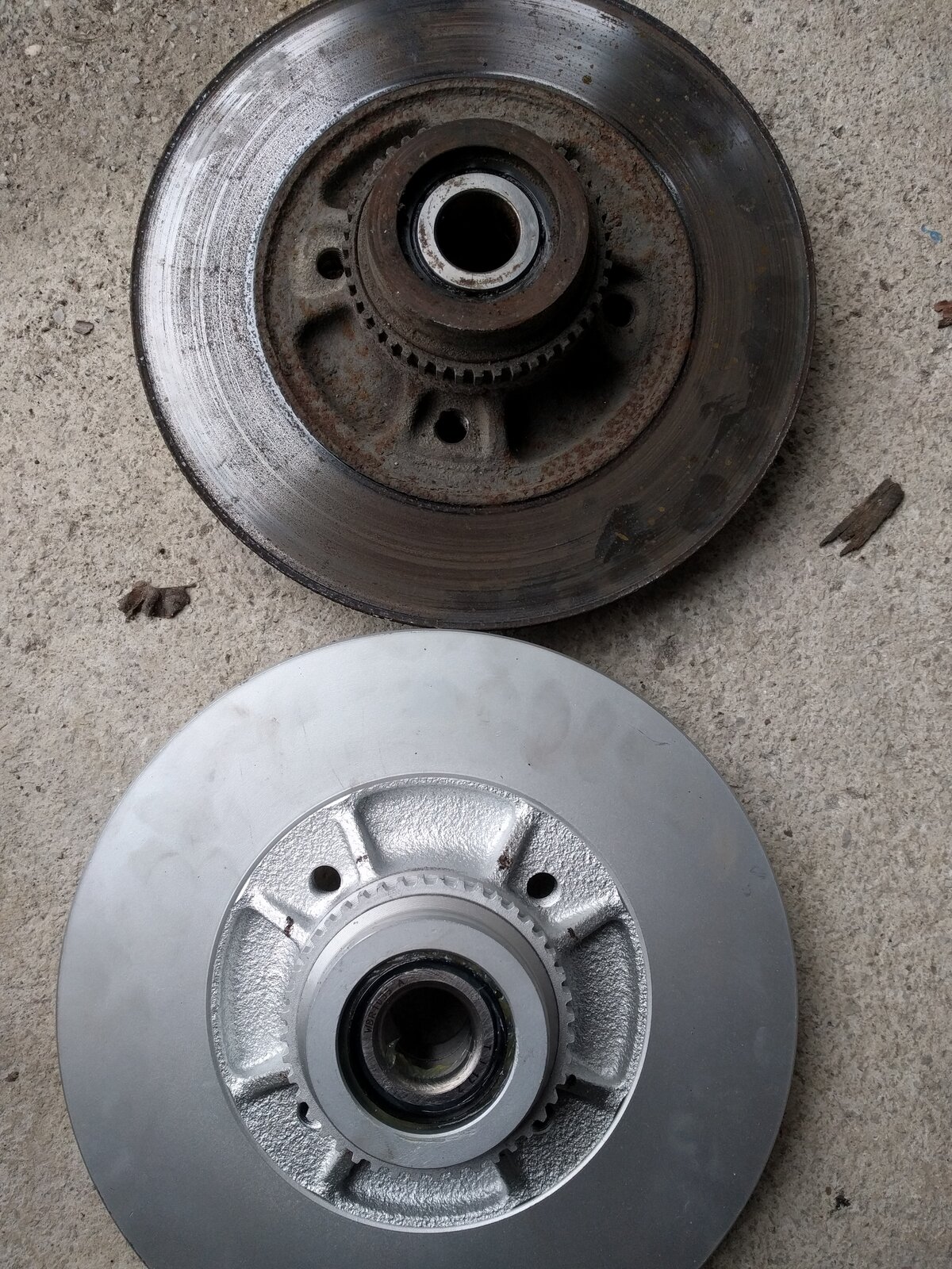

I need help with rear brake disc
Car  BMW E36
I bought new rear discs with bearings and now they don't fit. They slightly rub on stub axle housing. What can I do? Maybe grind disc a little bit where it hits housing or do I need some kind of spacer. On picture you can see where it hits.

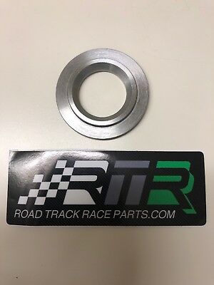

Yeah I will buy them, I just can't trust the first person who told me I need them.
Thanks for help.
Lol, but 4 people told you not Including myself and that was before you started getting funny about it.
Alot of garages forget to refit them when changing the rear discs which is why yours are missing, but they were there from the factory (please dont argue this, they were there) and it causes premature bearing failure and rubbing depending on the brand of disc your fitting.
