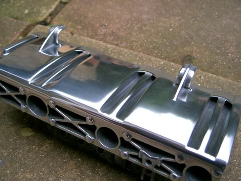

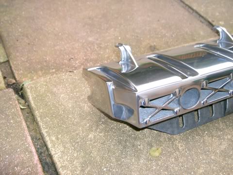

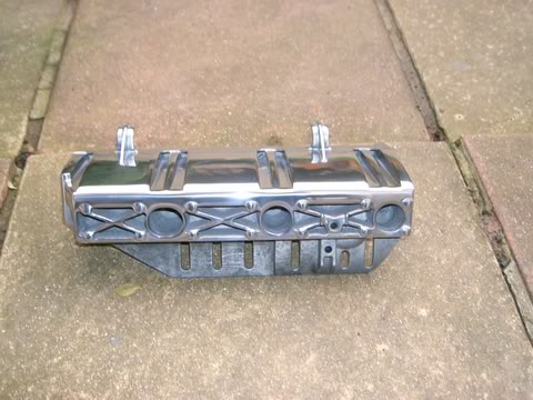

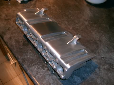

I Polished My Fuel Rail Guard (no 56K)

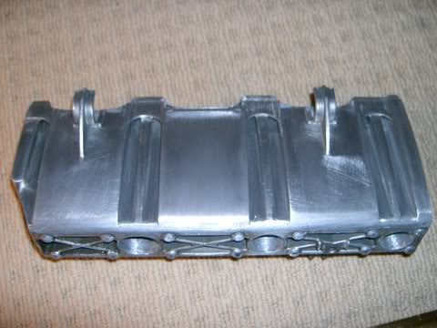

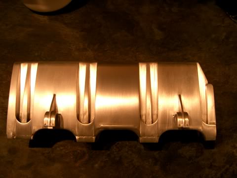

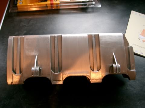

After an hour of snading with 40 Grit sandpaper it looked like this
Then went on to 120/220/440 Grit

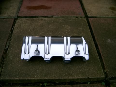

Decided to give the centre a coat of Auto Glym metal polish to see how it would look

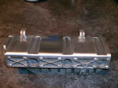

was quite pleased with that - went on to 500/600 grit then 700/800 grit and then finhally on to the 1200 grit.

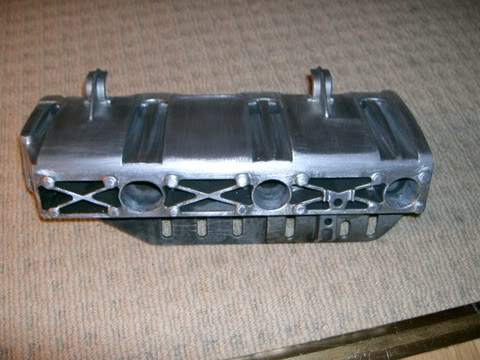

This photo shows how it looked after one coat of metal polish (just on the centre piece)

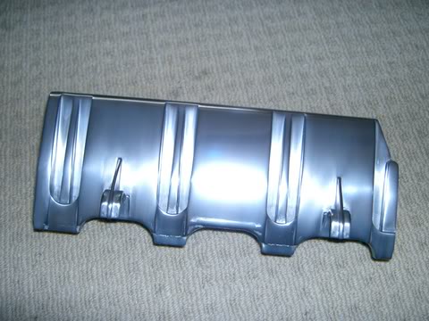

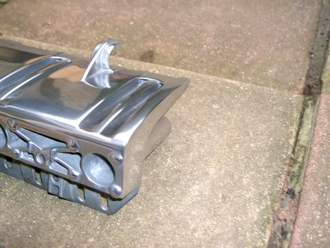

Then after one coat of metal polish all over

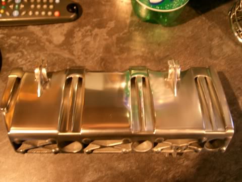

Then the Final Product

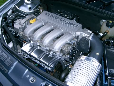

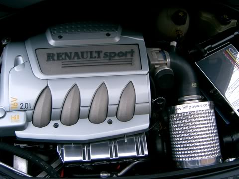

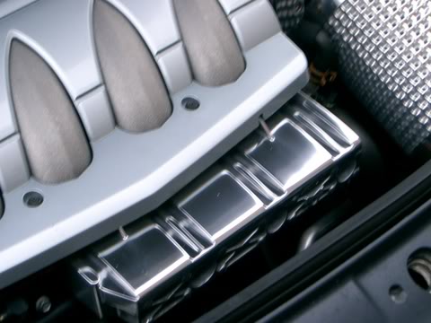

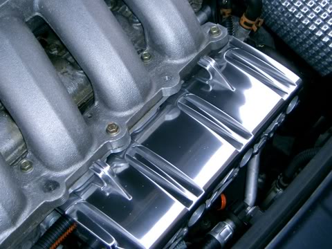

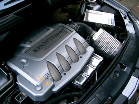

Then Back on the Car

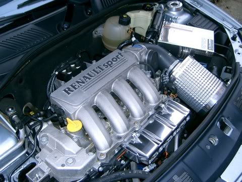

All back together
should be enough photos for everyone there!

Nice one. Looks great - some real elbow grease there, glad my best mates a metal polisher!

took about 8-12hrs roughly - started on monday and have spent roughly 2hrs a day working on it.
used aluminium oxide paper to start - emery peper did not seem to work very well - went on to wet and dry then - Richmcc gave me instructions and I am well pleased - was gonna pay to do it but thought I would save some money!

can u drive without that part or were u reattaching it each time, sorry if thats a silly question i have no idea what that thing does
You can drive without a problem - I think it is there in case of an accident so the fuel rail does not get damaged (but I could be talking crap)

If you want to finish it yet finer still than metal polish, apply a coat of an even milder polish such as Autoglym Super Resin as it will increase shine even more.

What did you use to apply the metal polish?
Sorry for all the questions lol. lots of people seem interested though.
just a cloth - bought some polishing cloths from halfords to save wrecking my girlfriends tea towels lol.

Best mate does it for a living, has worked on lots of the top show motorbikes over here. It's slightly less abbrassive then metal polish, so in the same way as stepping down in grades of paper when polishing, useing differt grades of polish does the same.
He does all his work by machine with different grades of mops, before using metal polish and then a milder polish still for the final luster, in most cases Autoglym Super Resin. This also leaves some protection behind to.
cool - shall be doing that then - should stop it tarnishing as well. Saying that though I just remembered it says long lasting protection on the Auto Glym metal polish anyway so shouldnt tarnish too bad - my exhaust stays looking good easily.
