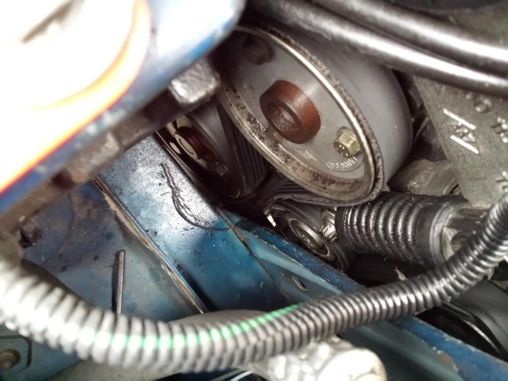

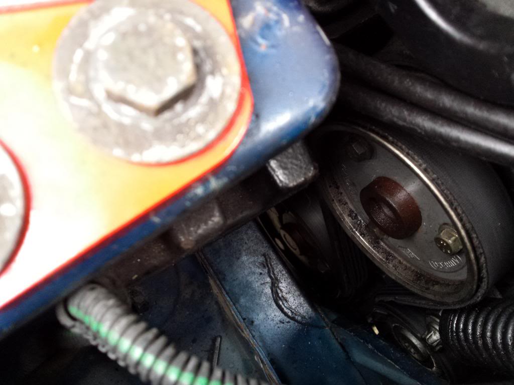

So, fitted the KTR engine mounts this weekend. Been having a squeaky AUX belt for a while, so yesterday I decided to spray the belt with this anti squeak stuff. Got to work this morning and I noticed my engine was making a horrible sound like bits falling off it. Popped the bonnet open and there was bits of rubber all over the engine bay and bits of string hanging out the AUX belt.
The AUX belt is still in one piece just with said string hanging out of it. I had to restart the car to move it and as I did there was a grauncing sound like the starter motor sticking or a belt slipping, I am paranoid as feck now that this is my cam belt.
Is it worth driving slowly to the nearest garage or is it a tow only job?
John Gordon
  Clio 2.0 RS 172 Ph1
Oh, I thought an AUX only did the power steering, alternator and AC.
Crap.
Guess my car is stuck at work then.
John Gordon
  Clio 2.0 RS 172 Ph1
Fingers Crossed I may have been lucky, just nipped down for a quick smoke so had a look at the damage. Seems the belt is fraying on the non cambelt side so I am hoping nothing has come in contact with the cam belt.

I wouldnt turn that engine over again with the belt in place.
As Dave says if you try and drive it without it then you are going to lose the use of your water pump which isnt good, (pas and alternator dont really matter for a short journey and your servo brakes are from the inlet so wont be effected, he is thinking of a diesel)
Did any of the spray go onto the cambelt?
If so change that as well!
The reason for the squealing in the first place was almost certainly your aux belt tensioner, so if you wanted to bodge it on the cheap you should have just taken that off and free'd it off, but belts on these engines are best treated properly!
Changing just the belt will almost certainly NOT fix it, if the tensioner is seizing (which Id be pretty sure it is if the belt was squealing) then you need to change that too.
Do the whole Aux kit as a minimum IMHO and if there is a chance any of that s**te got onto the cambelt then change that too!

Ahh, I see. Well I purchased a Stanley knife, cut the belt off and drove to kwik bodge. Engine seems OK but did not rev it. New gates belt and tensioner bearing should be fitted by the end of the day.

Yeah, they originally ordered just the bearing and a belt... bearing would not fit and gates don't sell the right one. So had to order the complete tensioner. Talk about an ouch moment.

As dan says, you need to change the belt, and the tensioner AND the idler pulley (the little pointless looking one at the bottom) as if that collapses it can also either detension or dislocate the belt.

EDIT, just realized that the part they ordered was the idler, and they thought that was a repair kit for the tensioner. And there was me being nice to the Kwikfit boys, haha

Although to be fair if not familiar with the car I guess its not the most ridiculous thing to think, but the problem you had was the spring on the tensioner seizing not the tensioner itself seizing I would wager, so even if that was a repair kit for the bearing part of the tensioner it wouldnt have solved your problem!
