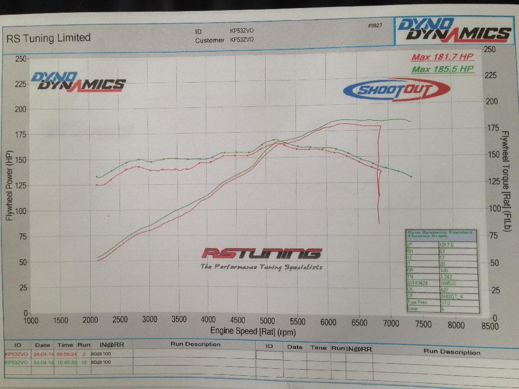

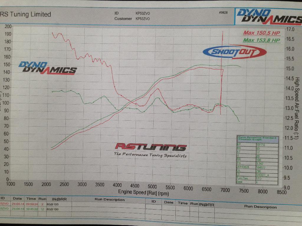

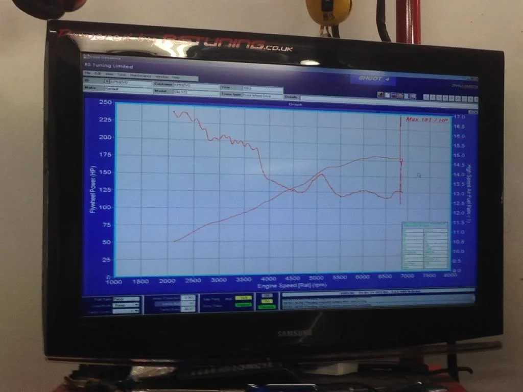

Got it the car on the rollers, bearing in mind the original engine made 165bhp totally stock, I expected no where near the figure it made modified, first run was 179, second run was 181bhp, at the flywheel. I literally couldn't stop smiling as there was more to come out of it. Here's a picture of the run with the AFR's and low down it was very lean!! Surprised I didn't break something as I've done 2000miles on the engine before it was mapped.
So Paul began to work his magic, loading up what I think was a 98ron rs tuner map, it hit the fuel cut at around 2000-2500 rpm, so he loaded on a map from a set of piper cams, and I think this was used as a base for tweaking, more fuel and adjusting the timing as it was knocking. A few more runs and she was done! Here is a graph of the before/after at the fly:
and at the wheels:
Overall super happy with the result of 185bhp, the torque is much better than before and it is definitely noticeably faster!

Just as a thought, comparing my graph to that of an rs2 inlet, they seem to have very similar torque until 4750rpm, where mine increases over that of the rs2, however mine drops under 150 at 6500 rpm where as an rs2 holds onto it. I wonder how the two would compare in a straight line.
