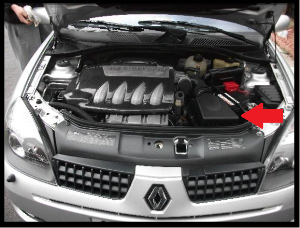

sorry not greatly clued up about anything under the bonnet, which pip exactly am I going to be looking at?
Hi HartZ
This is where the pipe were on about is:
There will be a large pipe (about 15cm diameter) entering the right hand side of the airbox at the top there. It is a push fit, so no tools needed. It is held in with tabs top and bottom, so to remove it simpley hold it at the top and bottom, squeeze it, and pull it out. You will have to give it a good squeeze (oo err) as the plastic is quite solid. Once out just tuck it down by the battery out the way.
It might have a minute loss of power, but it will sound much gruntier when you gun it now. Coupled with my aftermarket exhaust it makes mine sound proper chav :), lol.
