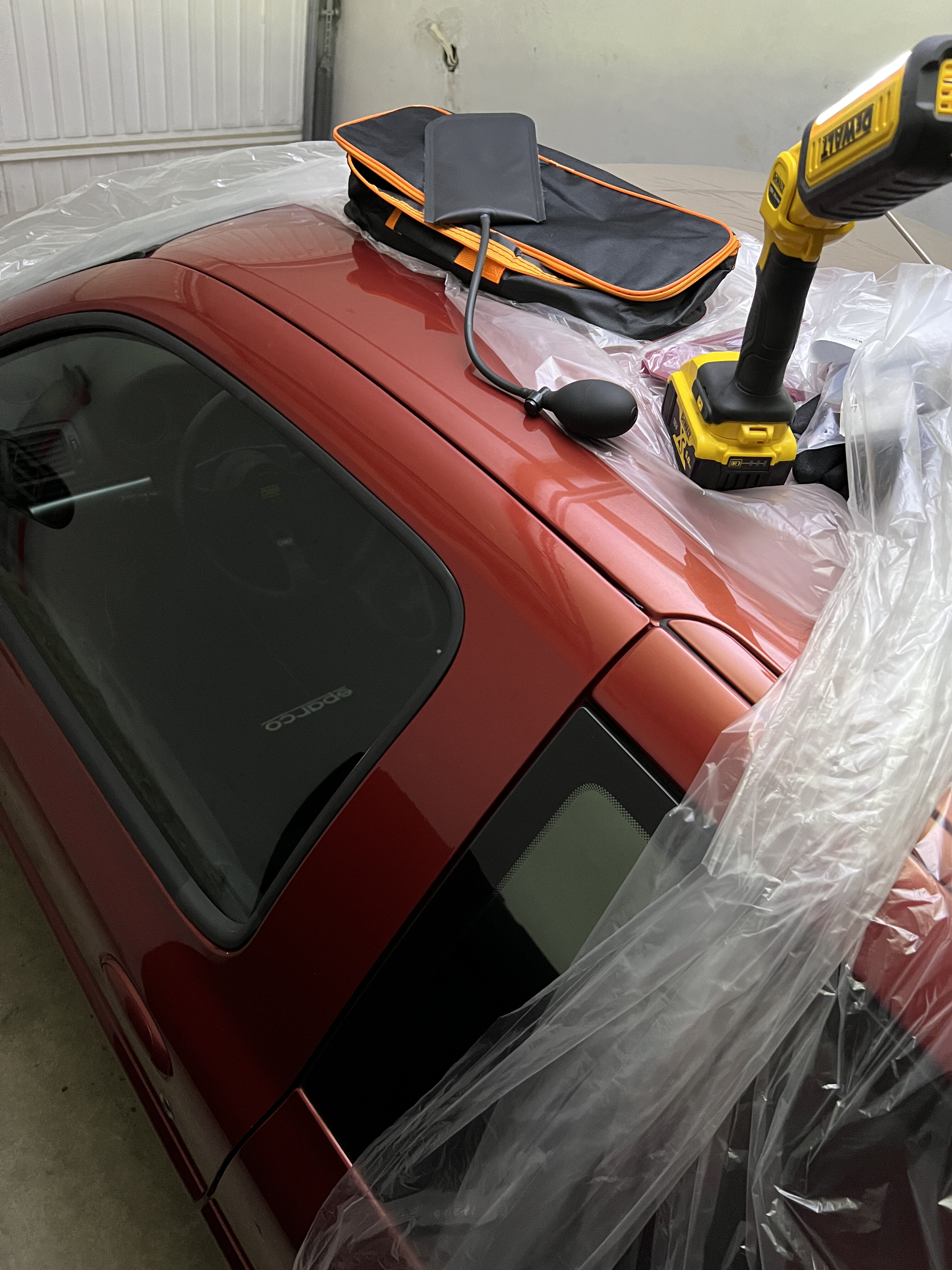

Getting a pump to open the door frame and using a hook to open the bonnet from inside also seems like a long shot..

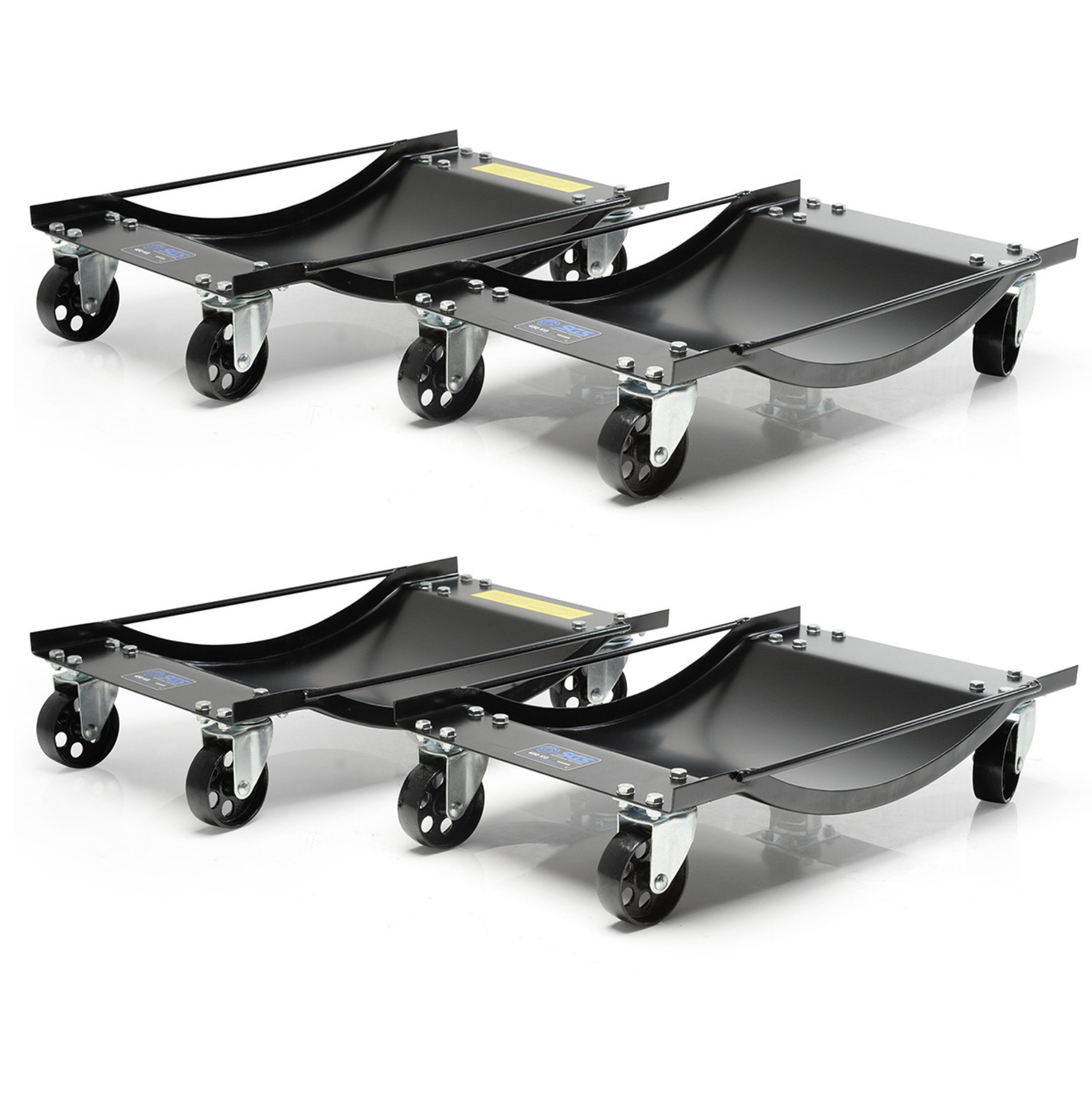

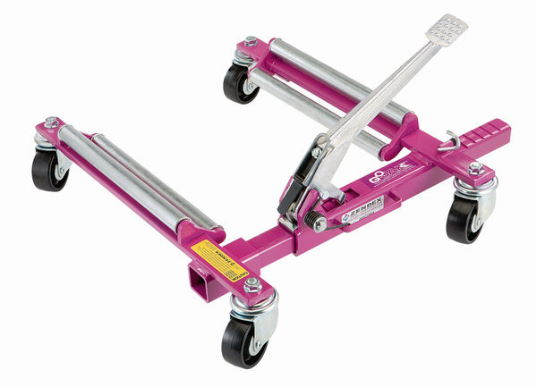

Jack the car up and stick it on wheel dollies? If its only got the handbrake on you should only need two for the rears

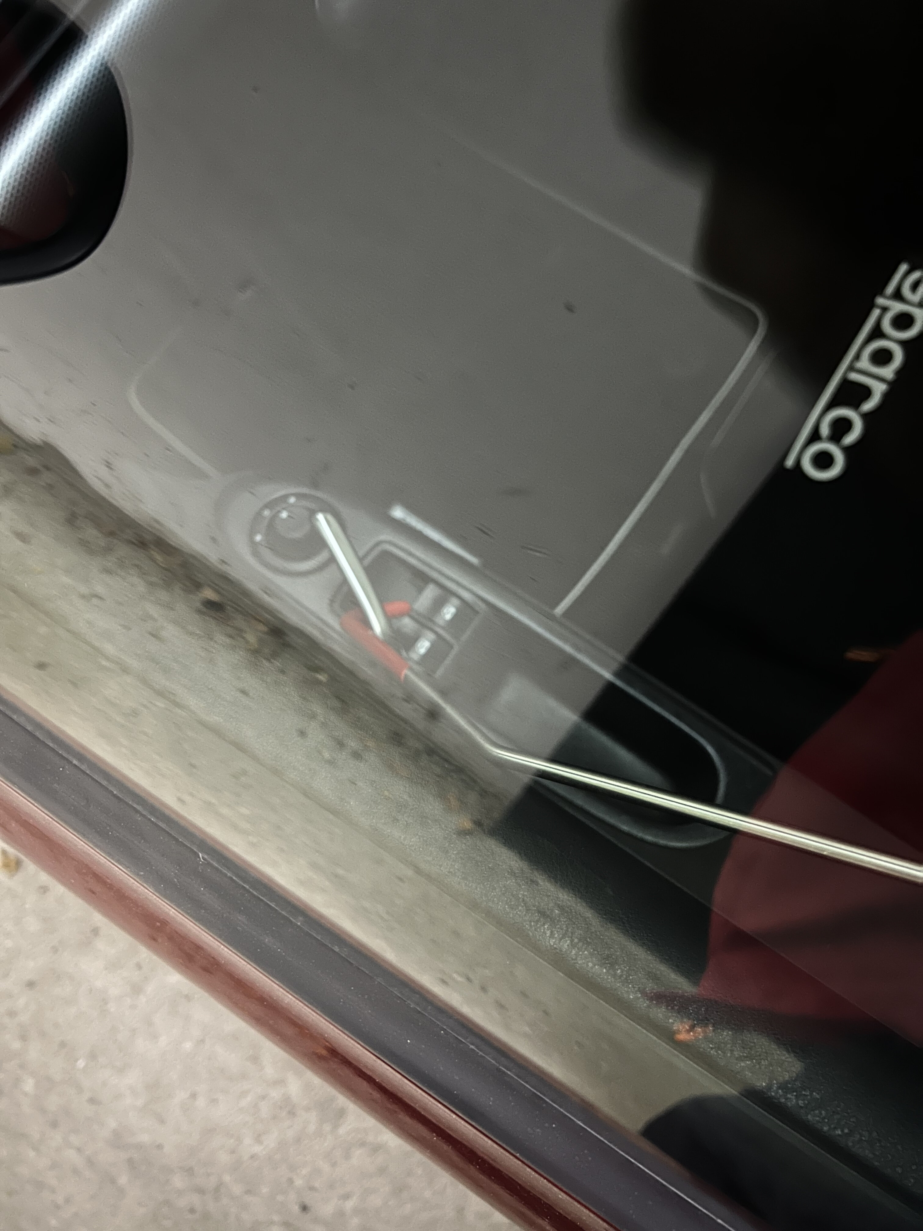

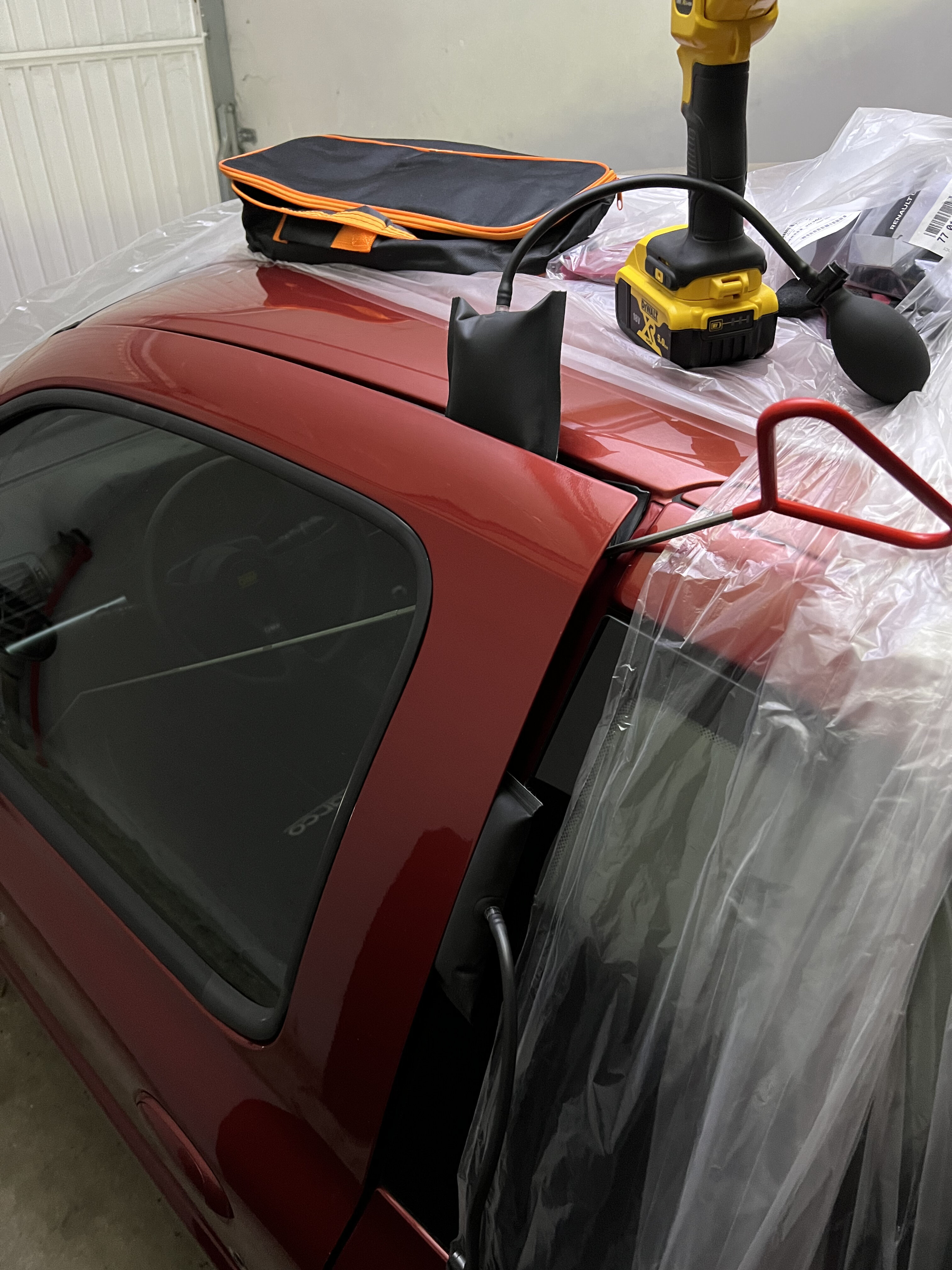

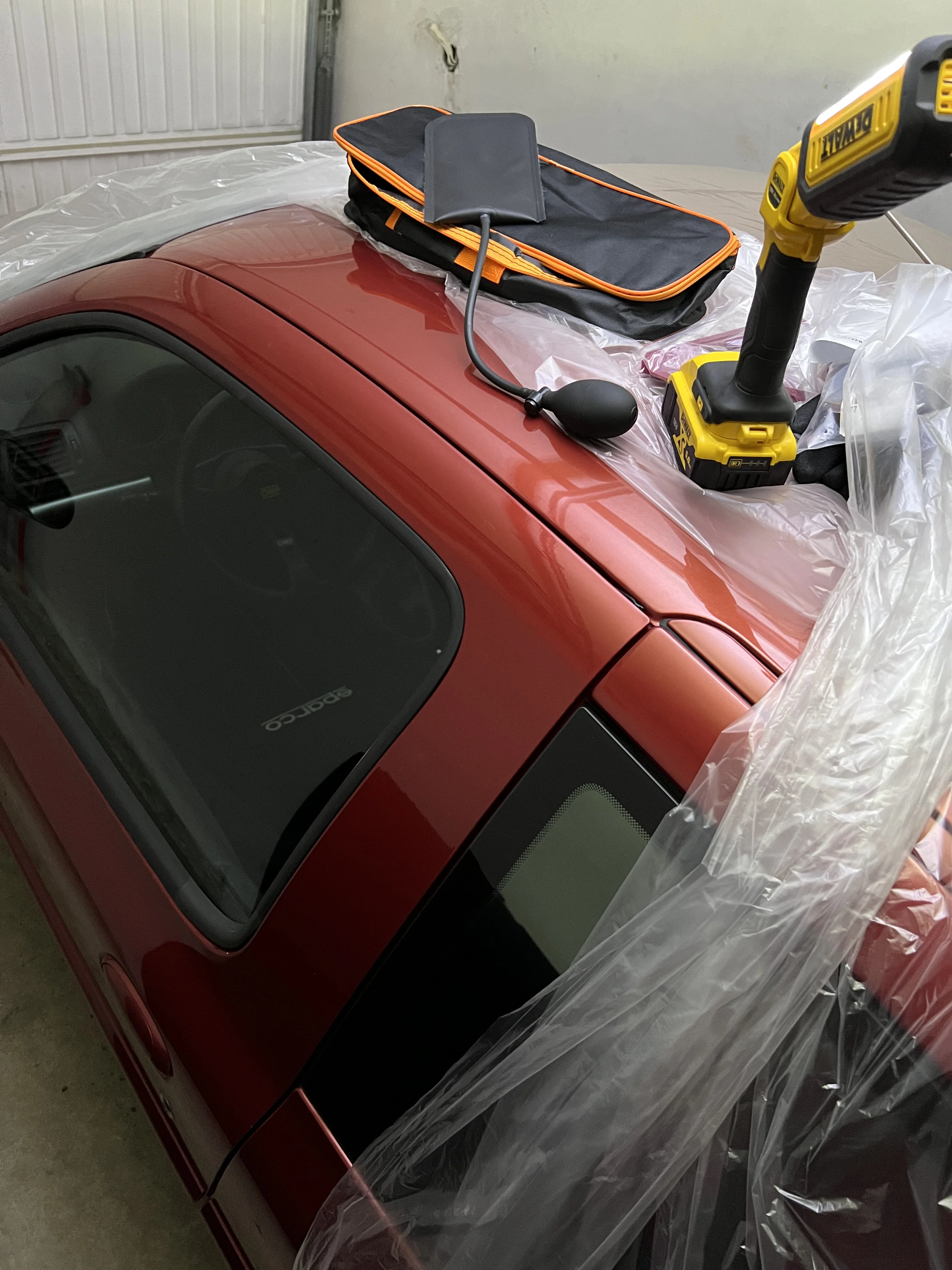

I had the same thing. Get some cheap household door wedges from the pound shop and a wire coat hanger.
From the top corner of the door where it joins B pillar put a wedge in, then another about half way and then another just above the interior door handle. The idea is to make just enough room to poke the wire through. Make a hook and then try to get it around the interior door handle. It took me about 30 mins of trying.

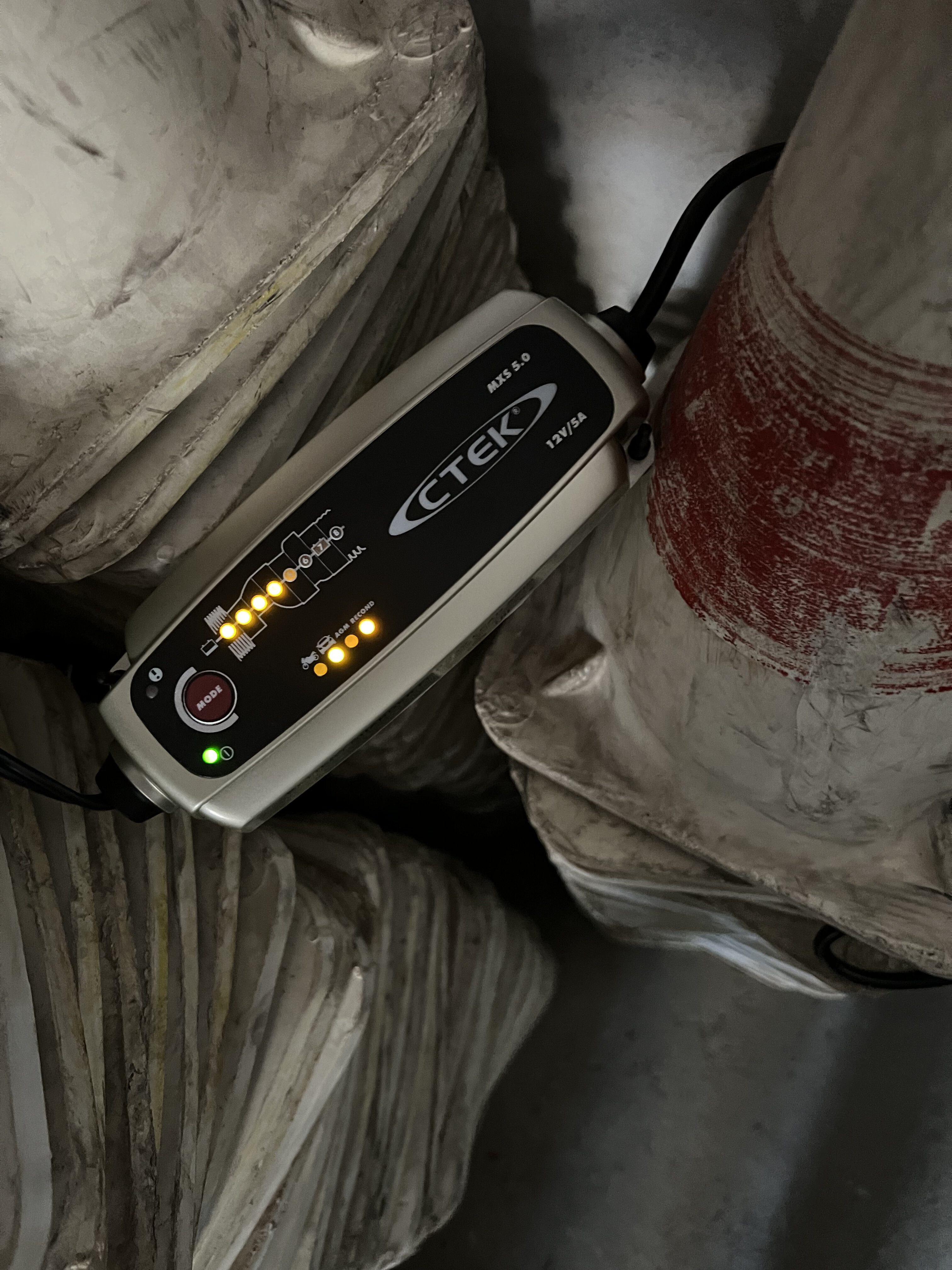

The easiest way of getting to an electrical cable to charge is by removing the side indicator or rear number plate light and cutting in that way. Save working from underneath.

Thank you for all tips. The good news is that I don’t drive the car regularly and the matter is not that time sensitive, which is the reason for this all. The bad is that it’s 300 km away from my main house in a garage. Looks like the starter is hard to reach under the exhaust manifold.. I think I will go with the B pillar opening and reaching the door handle. Can someone confirm that if there is absolute 0 juice in the battery the driver’s door handle still can open a locked door from inside? Meaning its hard wired and overrides the central locking?
Yes the wedge method will work on the inside door handle with a completely flat battery. The mechanism is mechanical and not electrical.
You can also pull out the side repeater/indicator and cut the wires, strip the ends and charge the battery with a trickle charger. Same with the rear number plate light.
But the wedge method is the way to go. You only need to create a gap big enough to get a wire coat hanger through, so don't go mad with the wedges.

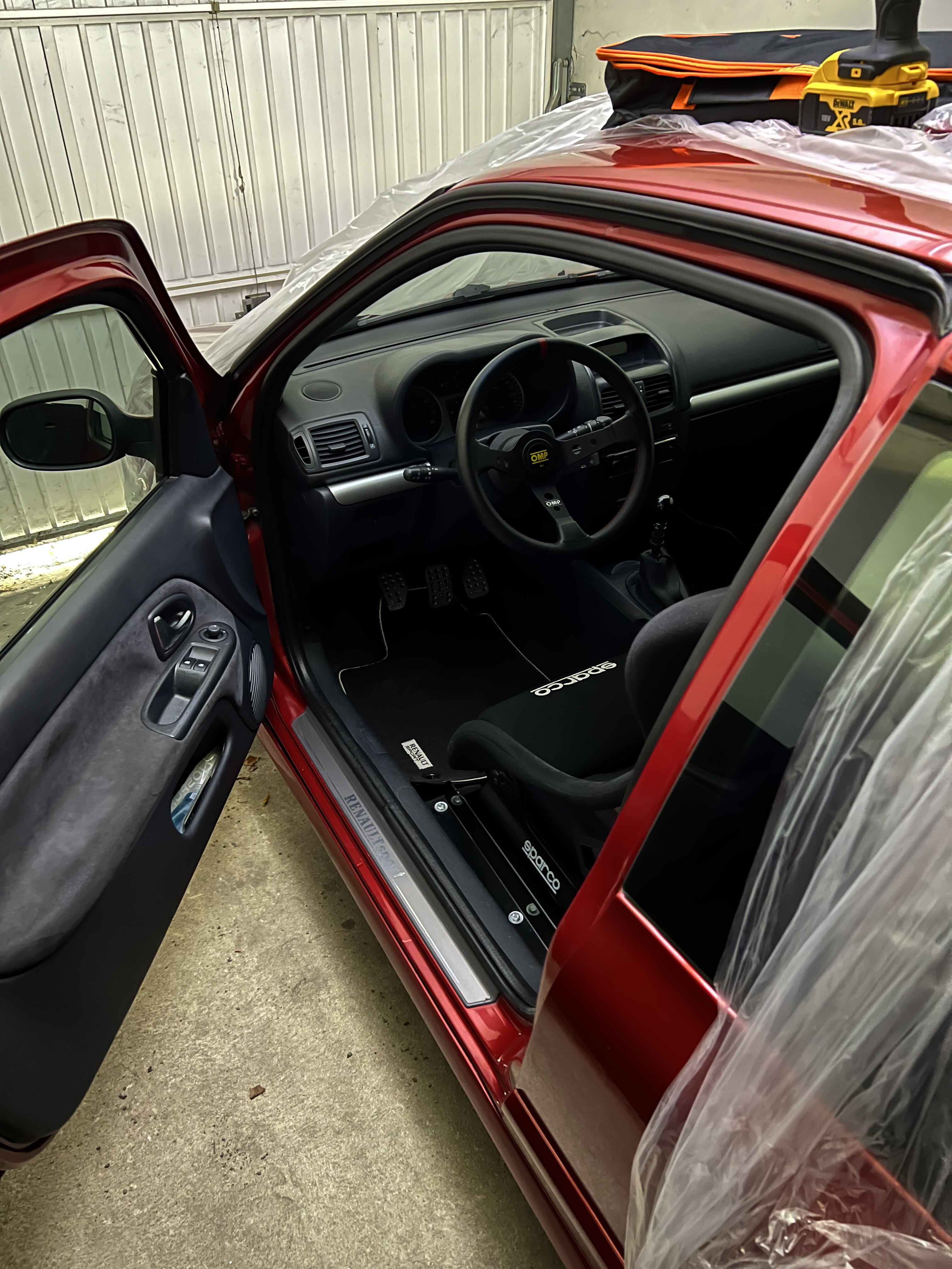

I'm glad to report that with your! support - the issue is solved. Thank you!

1. Use your bloody trickle charger on time!

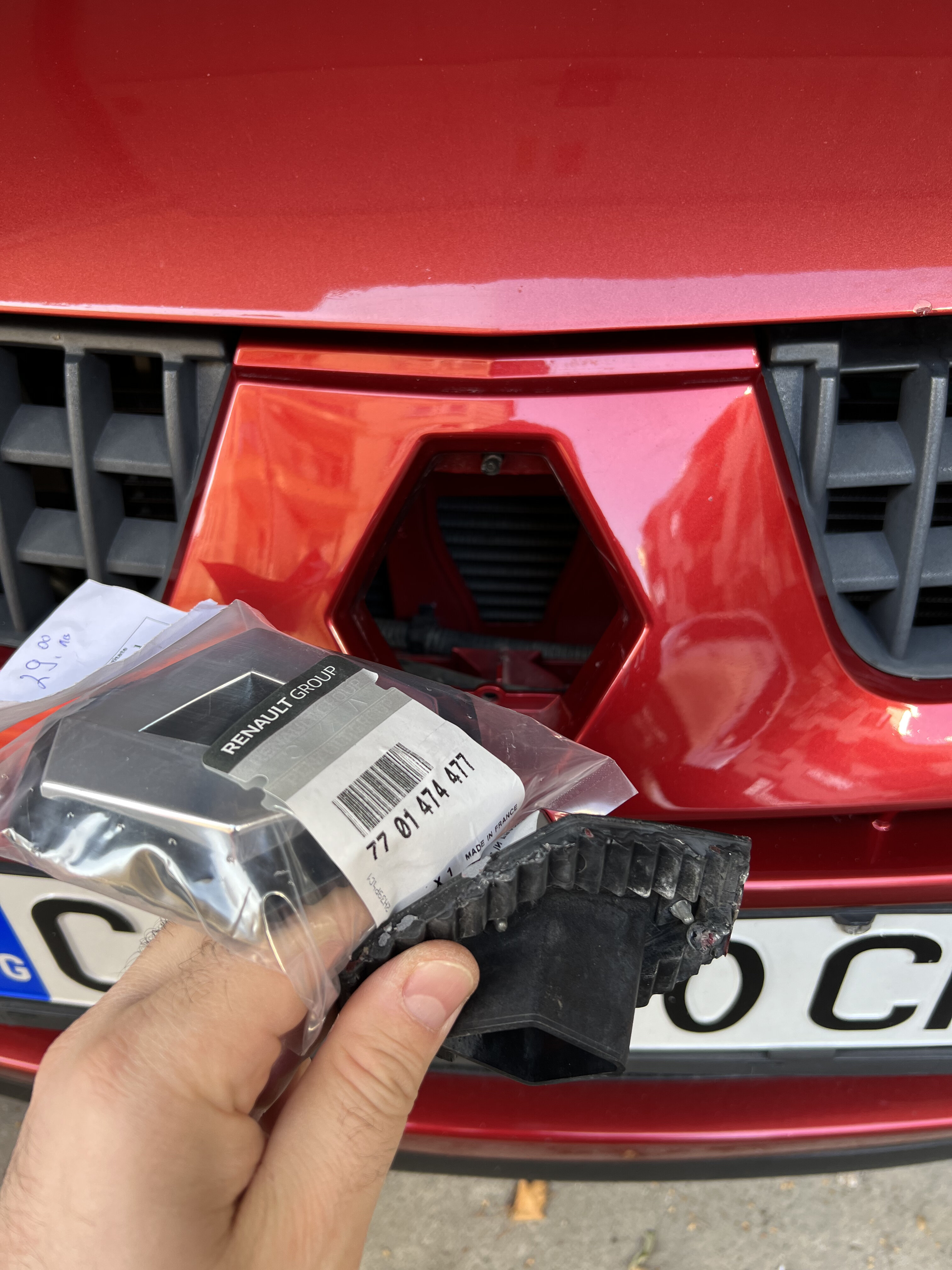

3. No point of breaking the front emblem - it doesn't cover anything than the radiator and a new one is needed afterwards.
4. Pull a bit stronger the door handle in it's final phase to open the door. I was a bit afraid it might brake and it's not hard wired for some reason.
