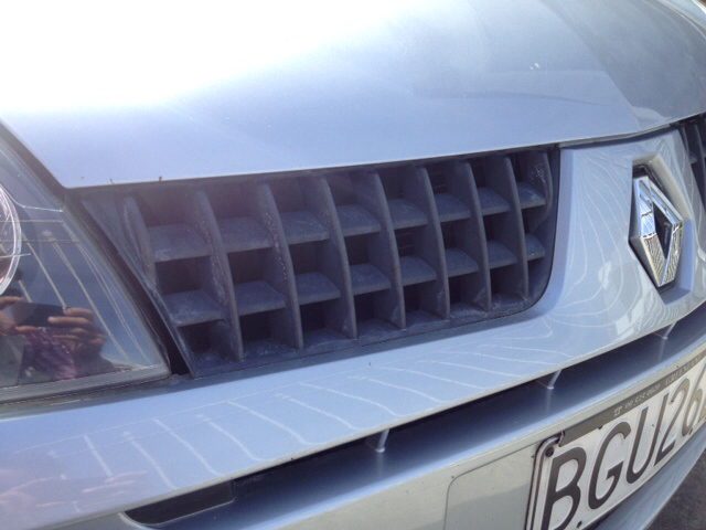

Here is what one of the grills looks like:
I would think that the New Zealand sun is harsher than that in the UK or Europe.
