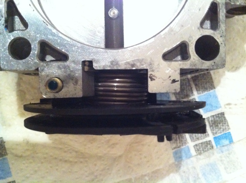

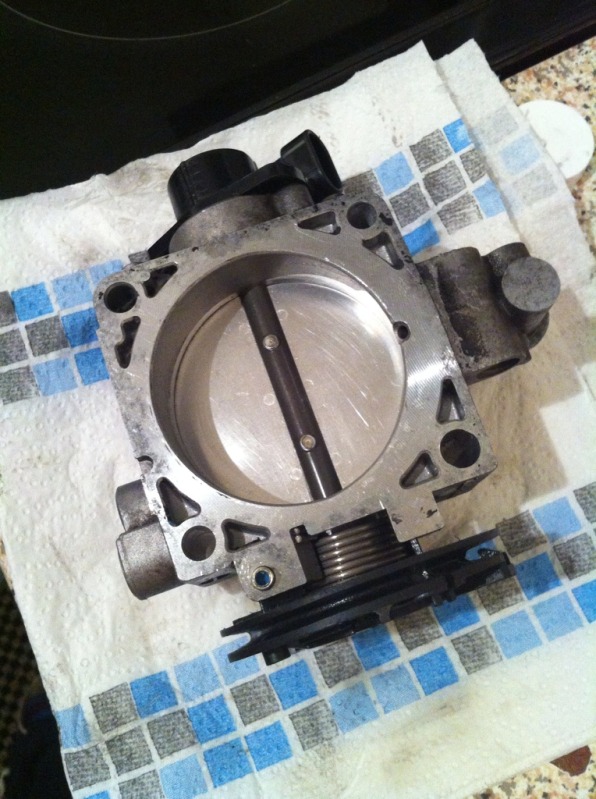

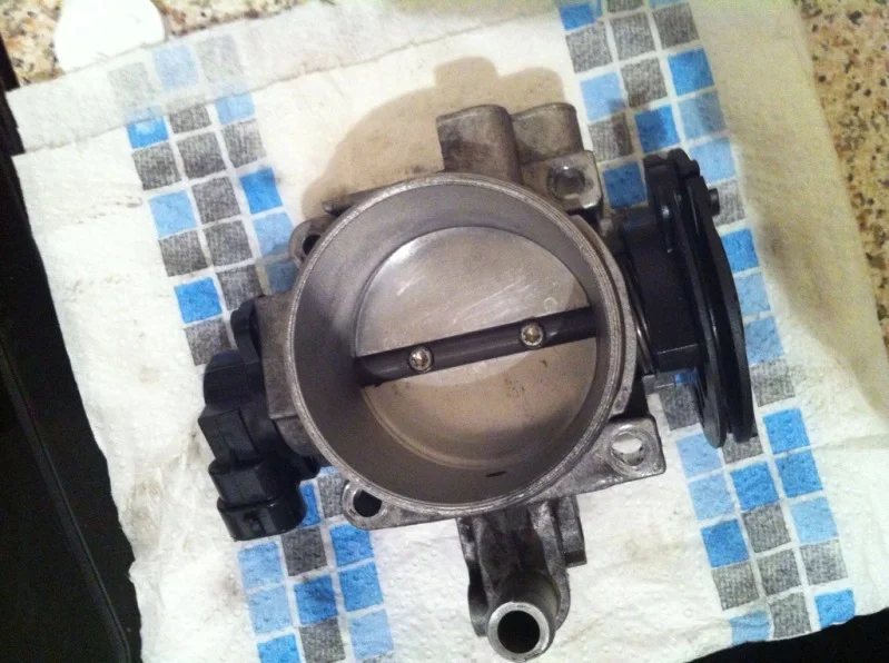

Right I've spent the last hour + cleaning the original throttle body up. It's virtually like new now so if this doesn't work the issue is elsewhere. It virtually snaps your fingers off on closing!!
Currently soaking in grease spray overnight.

yeah thats the tb sticking mate, as you hold the cable holder it closes the butterfly up - another issue iv found is the butterfly spindle wears, so if you grab the butterfly you can actually move it side to side, and it sticks due to the butterfly moving on the spindle and catching on the edges of the tb
if that doesnt work dude, post it to me and il have a look at it and try it

There is about 1mm of side to side movement on the spindle on this tb, so i'm wondering if this is causing some of the issue. I guess i'll find out if it's worked later.
The spring feels pretty strong to me, it really snaps shut, but it's hard to tell how worn it is without compairing with a new one.
  DON'T SEND ME PM'S!!
absolutely it will!! you should be able to tighten that up by tapping the circlip a little further on (the one beneath the TPS on the end of the shaft)

Dan, I'll try and tighten the circlip up as much as I can later. I assume a small socket over the end of the shaft will sort it?

yes, small socket and give it a tap, just make sure the spindle is moving freely and smooth afterwards (ie not over tightened)
The movement in the spindle, is that while the little torx screws in the centre of the spindle are in place and tight? Mine doesn't move until I undo those.
Also something else I tried was taking the butterfly out and flipping it around and putting it in the opposite way (if you get what I mean?) instantly it felt much better while opening the throttle body by hand where as previously it seemed to be catching slightly.
