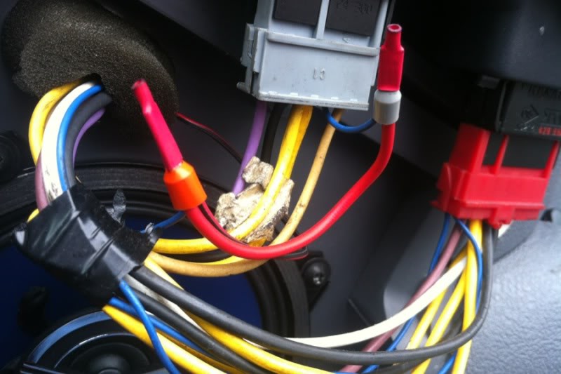

Chapster5 Car 2009 1.4 Astra SXI May 4, 2012 #3 Its usually a yblue wire if memory serves mate, Have a look at this picture my LEDs are spliced from the ignition

s0fty Car 387bhp RB Trophy SC May 4, 2012 #4 Chapster5 said: Its usually a yblue wire if memory serves mate, Have a look at this picture my LEDs are spliced from the ignition Click to expand... Were is that looks like a door..?

Chapster5 Car 2009 1.4 Astra SXI May 4, 2012 #5 Yeh its the door I know its not much help but give you an idea, where are you pulling the ignition wire from? behind the dials or from the stalks?
