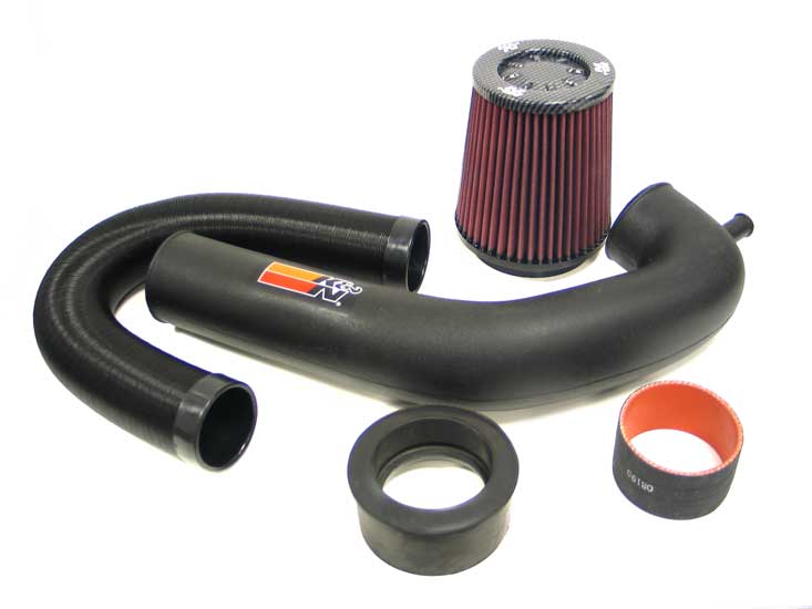

harry just done a quick search on www.knfilters.co.uk to see what the filter kit looks like for your car mate..... the pic...
So it looks like the kit you will get will come with some sort of relocation tube, If I was you I'd just buy the kit you want and follow the intructions, the intstruction I got with mine was very good and had detailed pictures of my actual engine too. happy gooooorrrming! :D
thanks mate, i bet in the small print it says *note doesnt fit care with air con* all the others i have looked at do.
