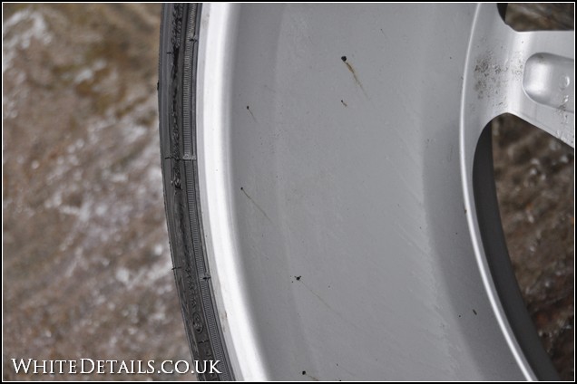

It looks like the wheels had previously been resprayed… Not too many contaminants to deal with though.
Before/after:
A few sections of wheel weight glue to remove (well done to those who’d previously tried ‘hacking’ these off with god only knows what tool (see scratches))
And a tar remover in action dissolving the odd lump of road tar.

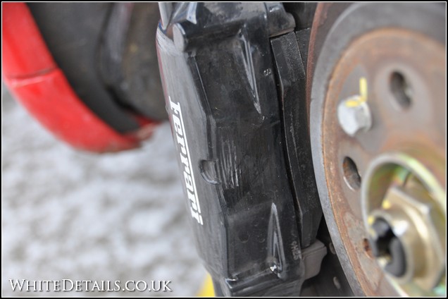

Ohh, oh… yep, confirmed… Wheels have been refurbed. On the car!!! Not ideal.
Silver overspray on rear passenger side brake caliper: (later removed with thinners)

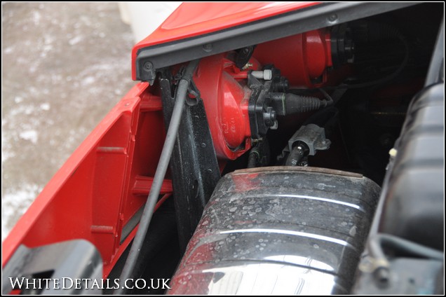

And a quick peak in the ‘bay to check it over:
Dull, slightly dusty. Not a biggy.

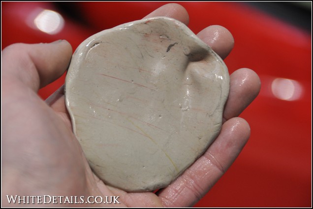

Inside, all exterior surfaces are clayed with mild detailing clay to pick up any remaining contaminants that must be removed before polishing commences.

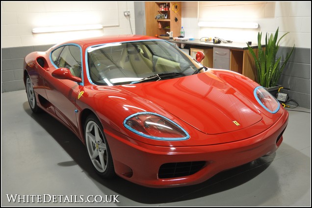

Blown dry to remove all traces of water/drips and manoeuvred into position ready for polishing.
Delicate areas taped and defects inspected:

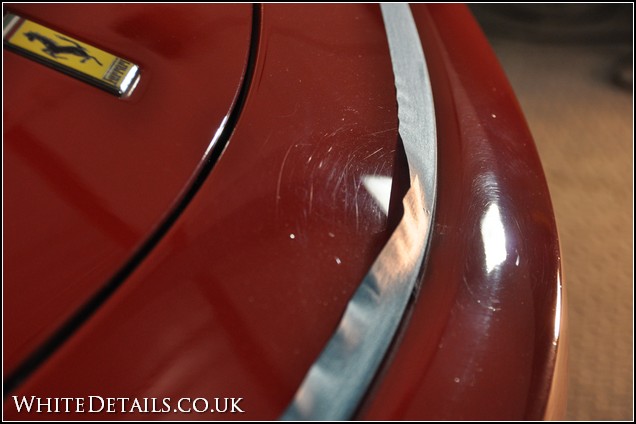

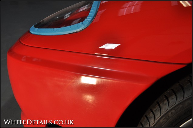

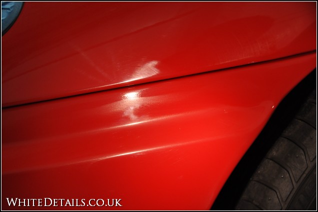

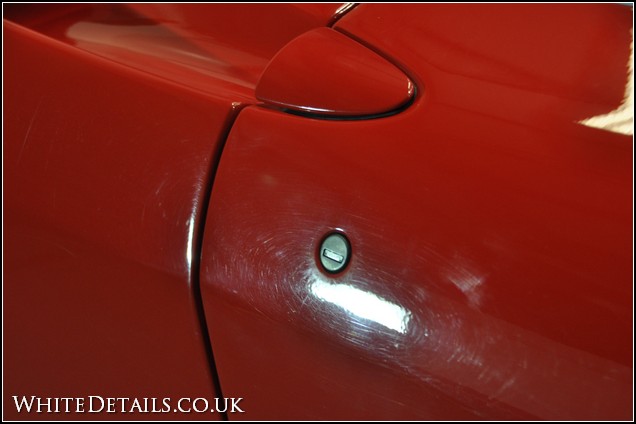

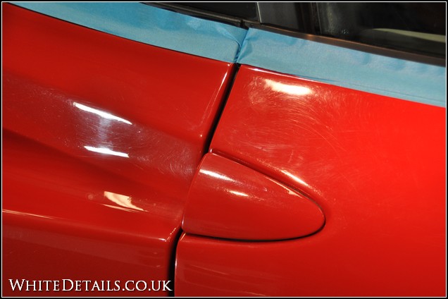

A good mixture of swirling and random deep scratches:

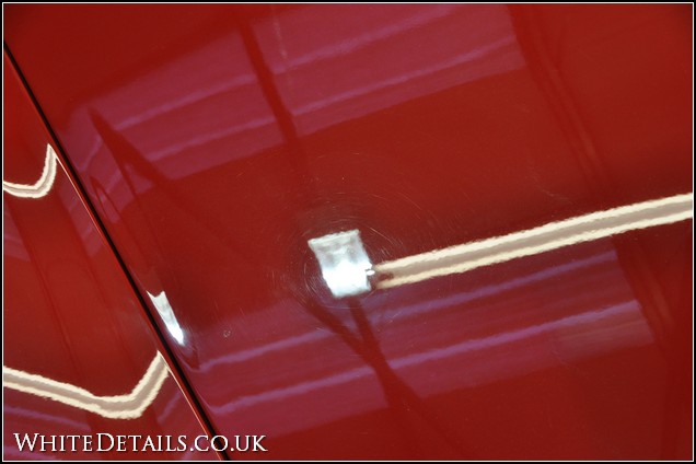

“Scrubbing” induced scratches from previous removal of double side tape in rear registration plate housing:
Masking marks and overspray:
Fisheyes:
And the washed out front end suffering from heavy unfinished DA sanding marks literally robbing the finish:

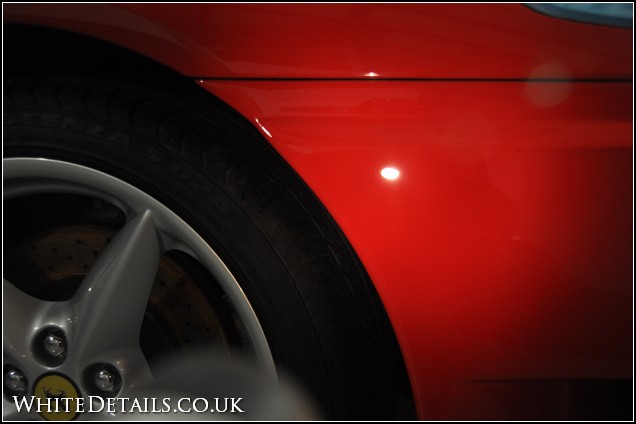

Starting my paint correction high on the roof with a DA polisher and microfibre cutting pads. Albeit needing two hits, the results are good.

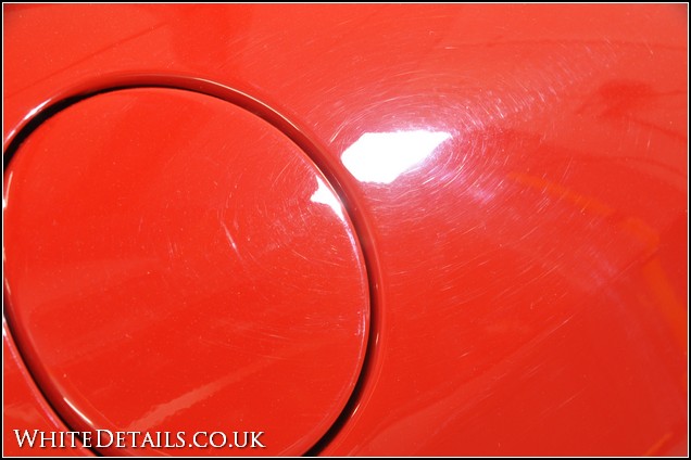

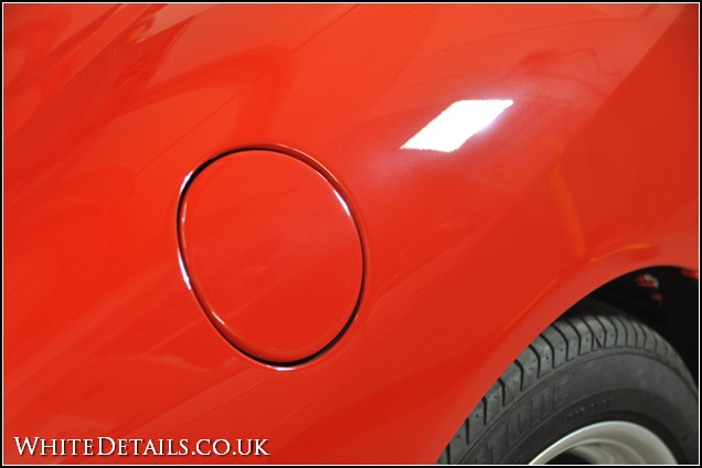

Before/after around the fuel filler cap:

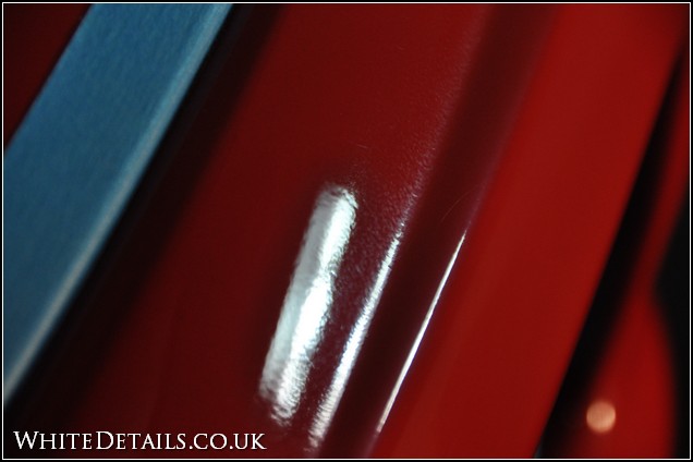

After DA compounding, a fine haze can be left behind. Requiring further refinement (rotary) to burnish to a sharp lustre and defect free finish.
Before/after refinement:

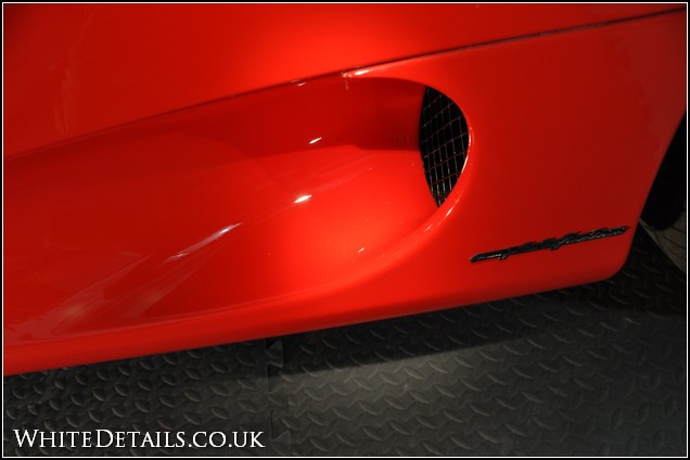

Continuing down the NS, a few tighter areas were hit. Before/after:
Even in the hard to reach vents, correction was good.

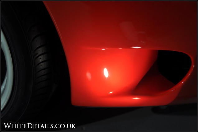

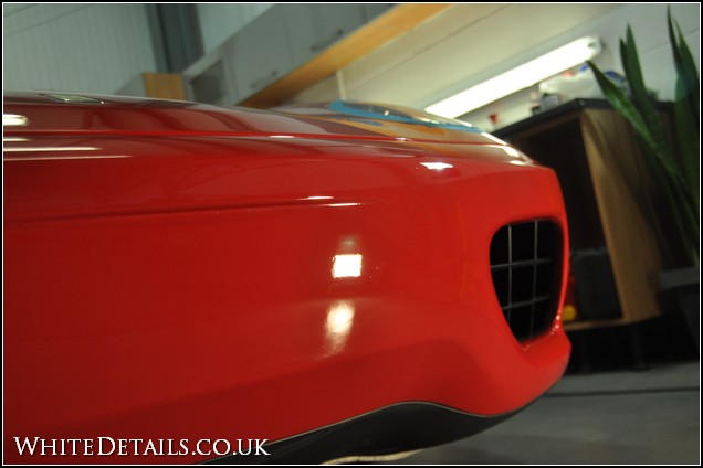

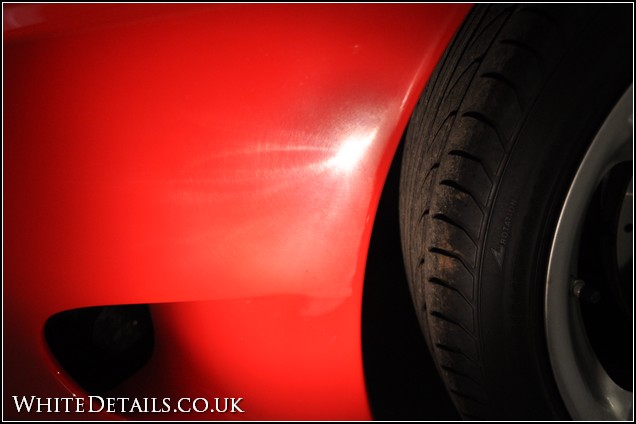

Once finalised, the NSF wing made the bumper look a little tired, lazy and dull!!
Bumper taped ready for a 50/50. Sure enough, massive improvements were made.

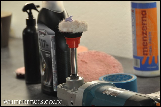

The horizontal edge around the bumper had a tight lip that I struggled to hit properly. A mini-wool pad was used to dig through the lip and remove remaining sanding marks that before weren’t accessible.
Before/after:
More before and afters from the front bumper:

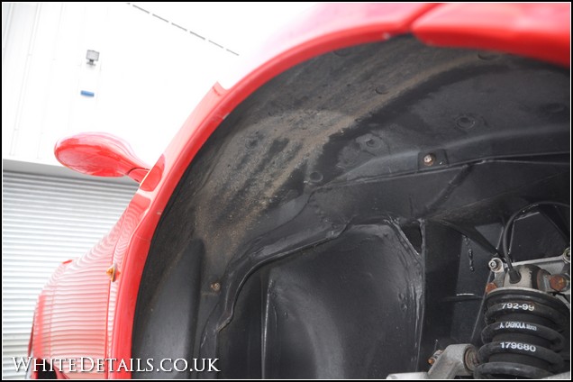

With the wheels off, the calipers were cleansed and arches dressed.

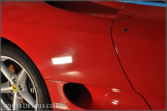

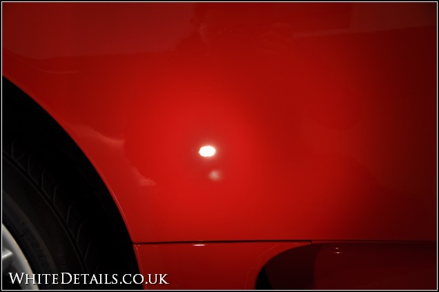

There were some good (deep) marks down the OS quarter.

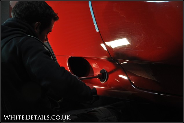

And requiring a rotary extension with a steady hand to safely correct the ‘hidden’ bits.
Before/after:
Before/after:

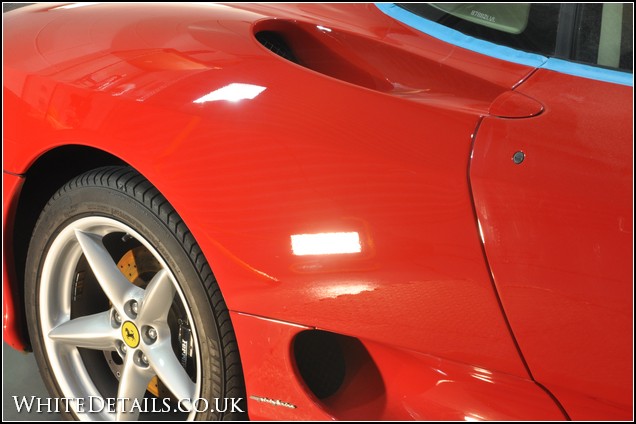

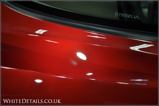

NS complete:

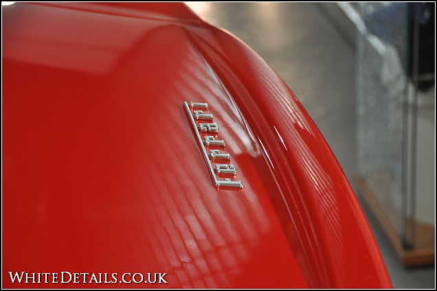

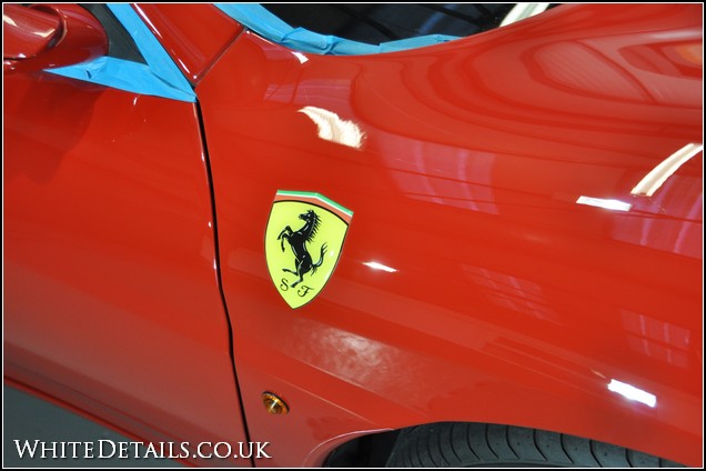

Ferrari badges removed to ensure true correction.

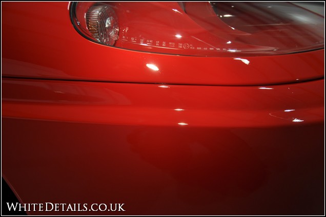

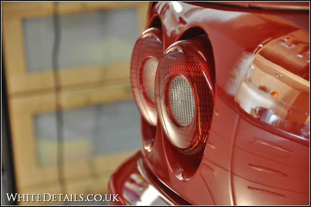

Light clustered freshened up after a two stage machine polish:
With the rear bumper complete, the machine work was about finished…

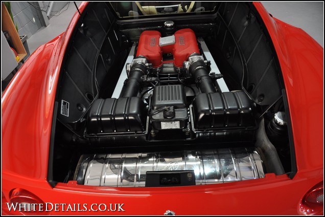

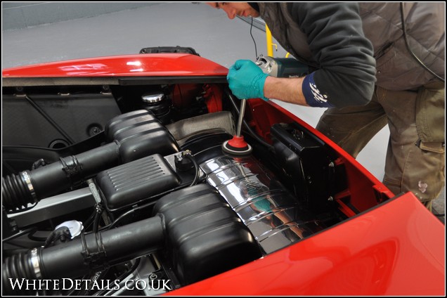

Before packing away, the exhaust box was given a quick fettle with a soft pad and metal polish.
A (blurry) 50/50:

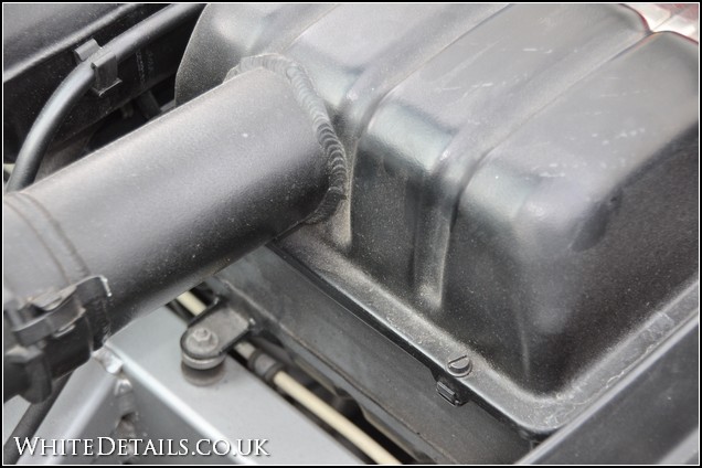

After a dust down, panel wipe and tidy, the rest of the bay was polished and dressed where appropriate.
This, leaving the car stripped, defect free, ‘clean’ and ready for protection.

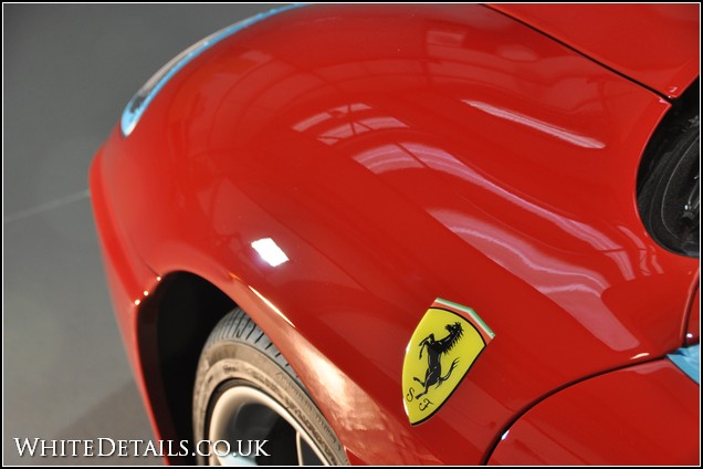

…even without its luxury layer of wax or ceramic sealant, its super glossy and slick already!

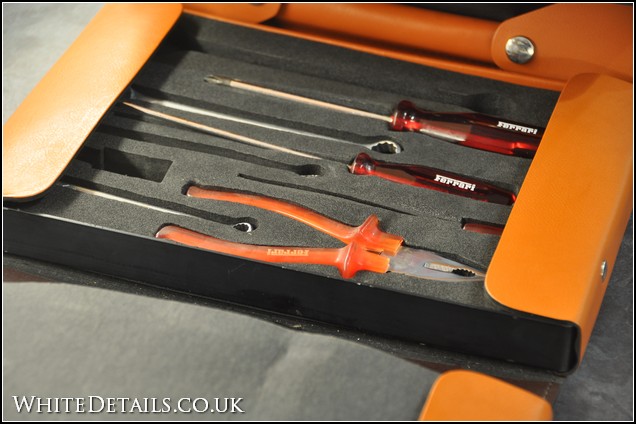

Tool kit given a wipe over:

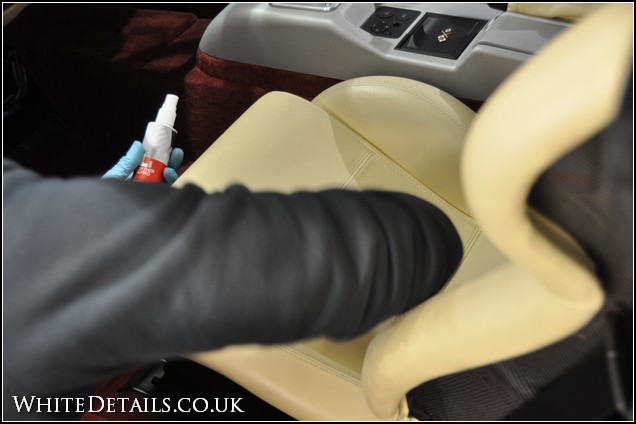

Interior dusted, scuffs and marks removed. Leather deep cleaned and protected with G-Techniq L1 Leather Guard.

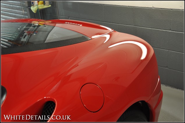

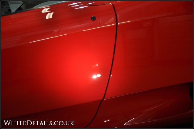

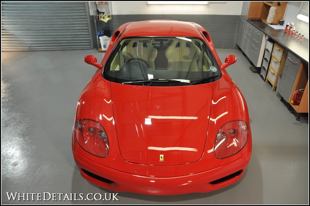

Now all that’s left is to grab a handful of after photos. Not bad for a 12 year old, eh?
There we have it. My first step into the New Year. A job that I thoroughly enjoyed and look forward to seeing the owners’ reaction on collection…

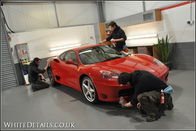

It must make it so much easier when there's three of you though? ::rasp:

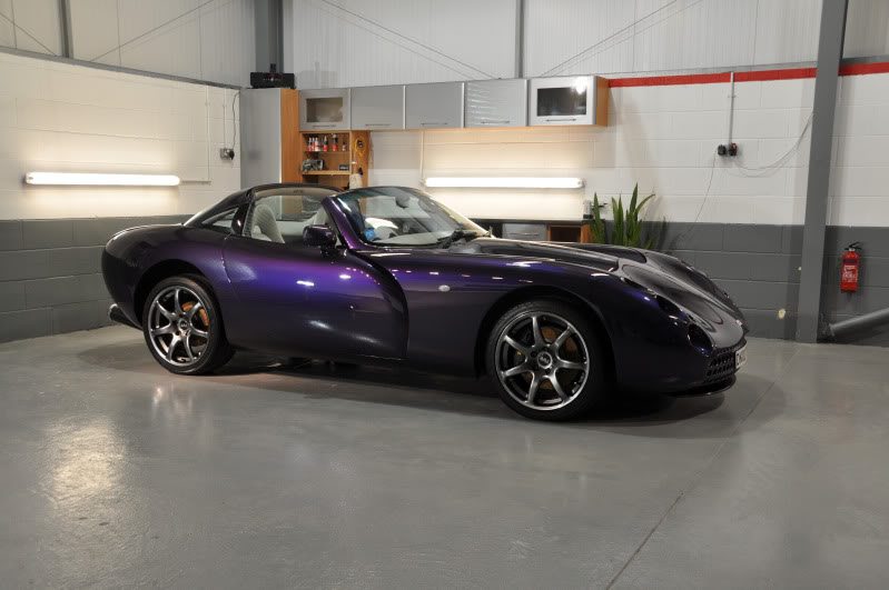

Now you just need to do a write up for Jons Tuscan ;)
