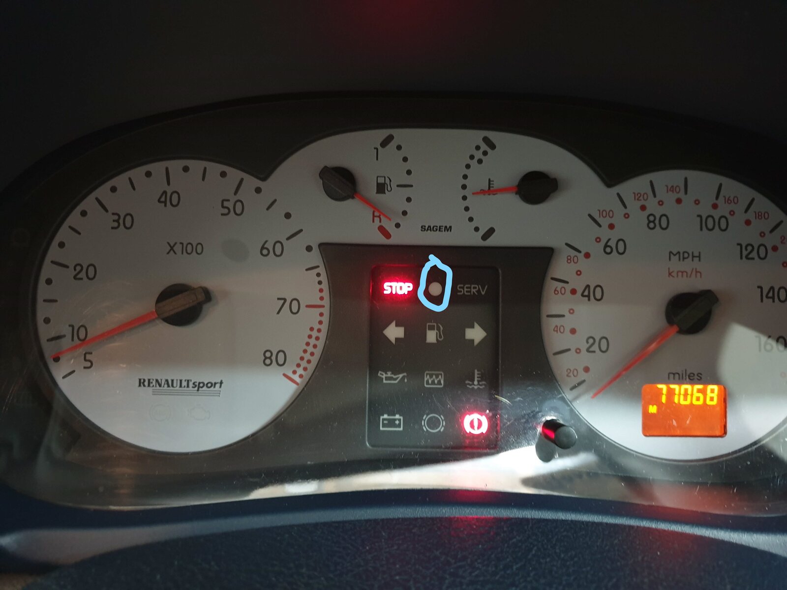

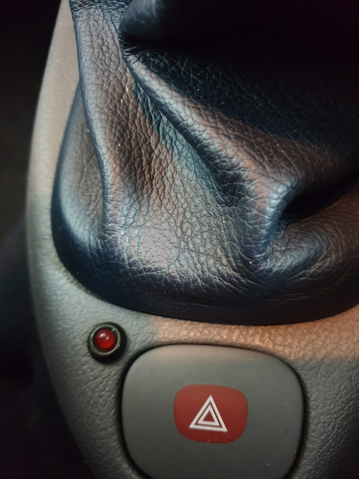

  • When car locked both red lights flash, on dash and by gear stick
  • Open car with fob, locks pop and red light near gear stick stops
  • Red Dash light still flashing
  • Key in and turn to position two, few seconds all dash lights go off including the red flashing one

Am I correct in thinking the immobiliser is deactivating as red dash light goes off and not the issue?
Any ideas on what to check / change?
Pics of lights I mention below, and assume one by gear stick is standard fit?

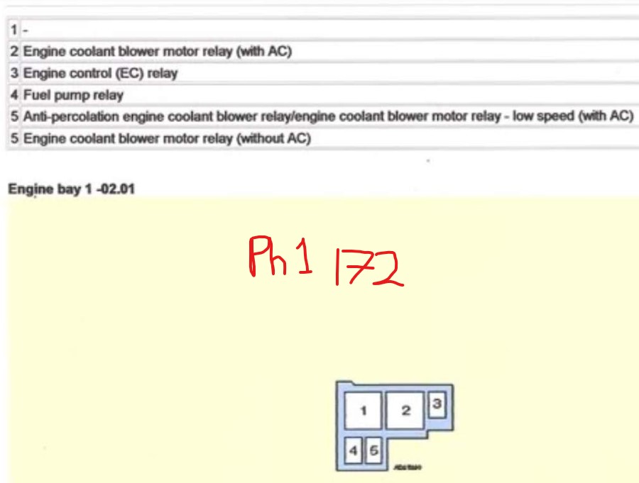

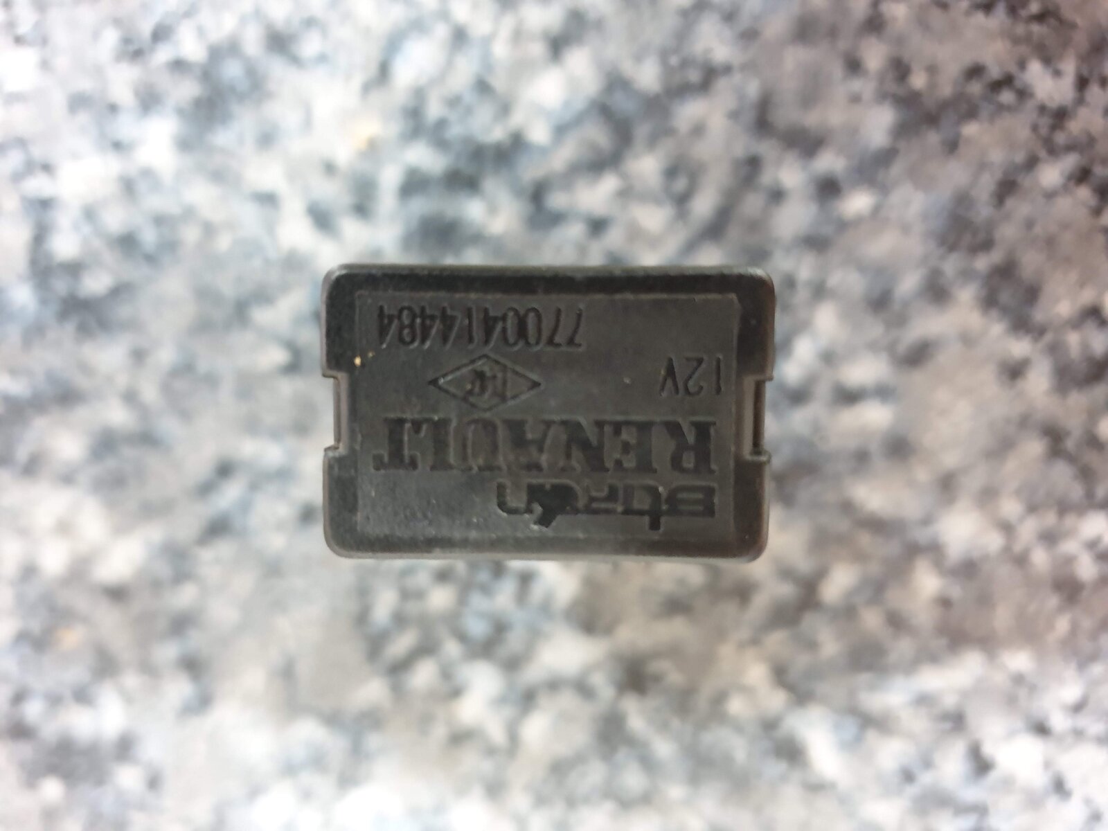

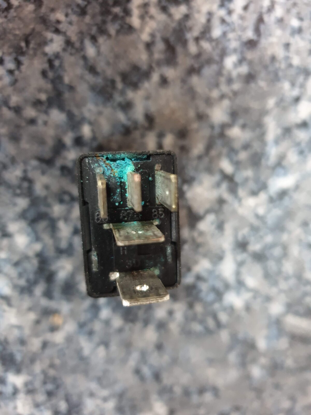

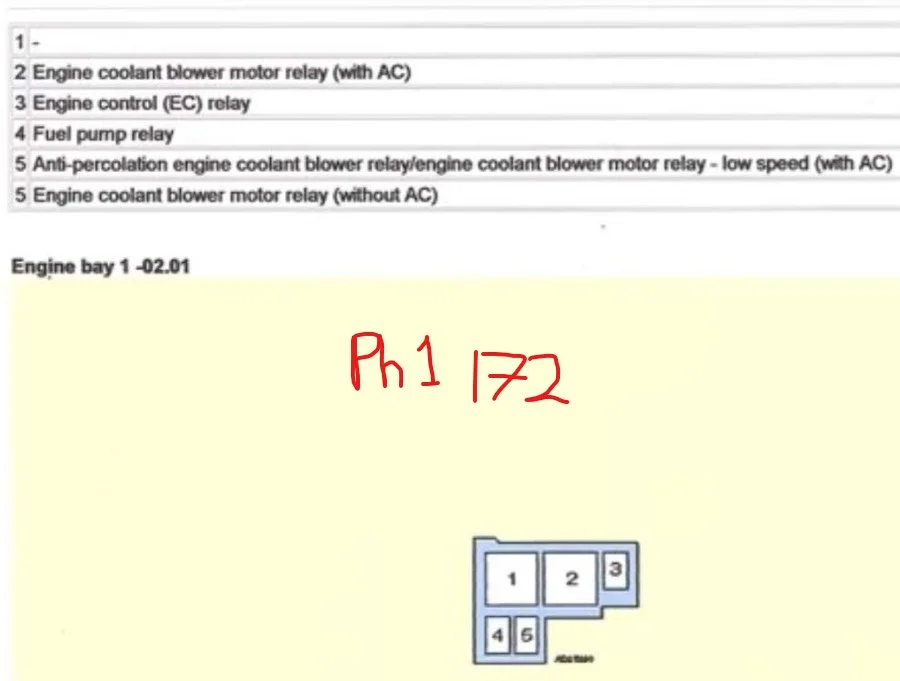

After a little more digging and checking electrical items it turned out to be the Fuel Pump relay had corroded and failed.
I found this by swapping over relays 4 & 5 in the engine fuse box and it sprang into life and then failed to start when I swapped back
1 x new 7700414484 relay ordered from RPD
PH1 172 engine fuse box / relay layout
