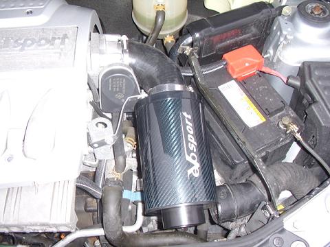

ive just fitted a closed ik that i got off ebay. 60 quid delivered. you will need a silicone elbow to fit it but i think its worth it. same benifits as a BMC but less that half the price.

its called an 'evo sport' carbon fibre induction kit. comes with a 1m of ally cold air feed. look it up on ebay. got mine for 60 big ones. you'll need a silicone elbow as it wont fit the origional bend. you'll also have to attach the IK to the elbow befor the install. I used four very small self tapping screws. works well and sounds awesome. :approve:

no, just wondering why you would use self-tappers to connect a silicon elbow to your IK?
its normally a jubilee clip
would have thought it needed to be air tight - not sure about using screws for that?
  RenaultSport clio 172 mk2

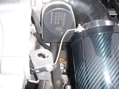

will post a pic tomorrow. yours looks great but i didn't want to spend too much. the evo sport IK comes with an 80mm opening that attaches to the elbow. The trouble is that its a soft fixing. The silicone elbow fits in nice and snug but a jubilie clip just squeezes them together. i pushed them together so they were air tight and added 4 small screws for safety. then added the jubilie clip and bobs your uncle - an enclosed cold air IK with silicone elbow for less than 80 quid!!!
have read your guild on fitting the cold air feed - will do mine next week.:approve:

not 2 take over , but daze im going for exactly the same set up , have u got a support for the viper or elbow underneath ?????????? or just held toghether as shown:boring:
the viper comes with a bracket which fixes to a hole left by the oe airbox! the jubilee clip which attaches the silicone elbow to the viper slides through the bracket and gives it all support! :D

Pics of my IK set up - no cold air feed yet, will fix it next week...

yeah the viper has a "bracket" but with the hill power elbow you dont really need it.
