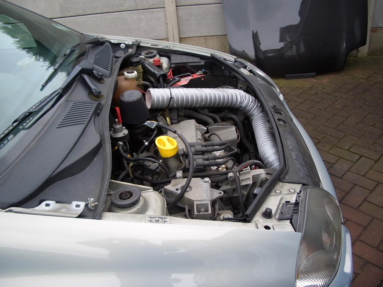

Sounds nice mitch. How much did you pay? Also mitch, does it look easy enough to return to standard when the time comes to sell up, also I guess you loose the look of the square engine cover as the top right part is the air box isn't it? I guess that black pipe is your cold air feed? lol

yeah that massive blue thing is your airbox, it seriously takes 5 mins to take it off and fit the k&n, the intructions you get are very good.
The airbox is only held on by 4 bolts iirc, and the k&n has a fitment bracket that you bolt down with 2 of the bolts you took off. then just plop the k&n on to that, job done :)
yes that black pipe is my CAF (cold air feed) it was tempary and still is :eek:
I will be ordering a new silver one soon, and the engine is cleaner than in that pic too :)

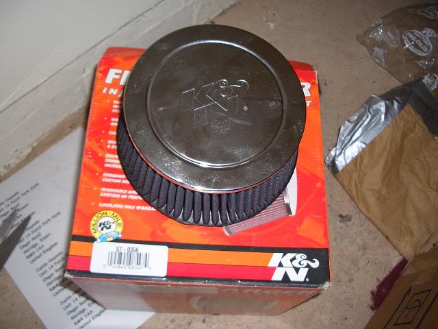

found it on www.knfilters.co.uk
this is the one you want.
2000 RENAULT Clio 1.4L L4 F/I - 8v Automotive 57i Kit 57-0356

sorry I'm chatting shite! its deffinately the 57-0356 you want!!

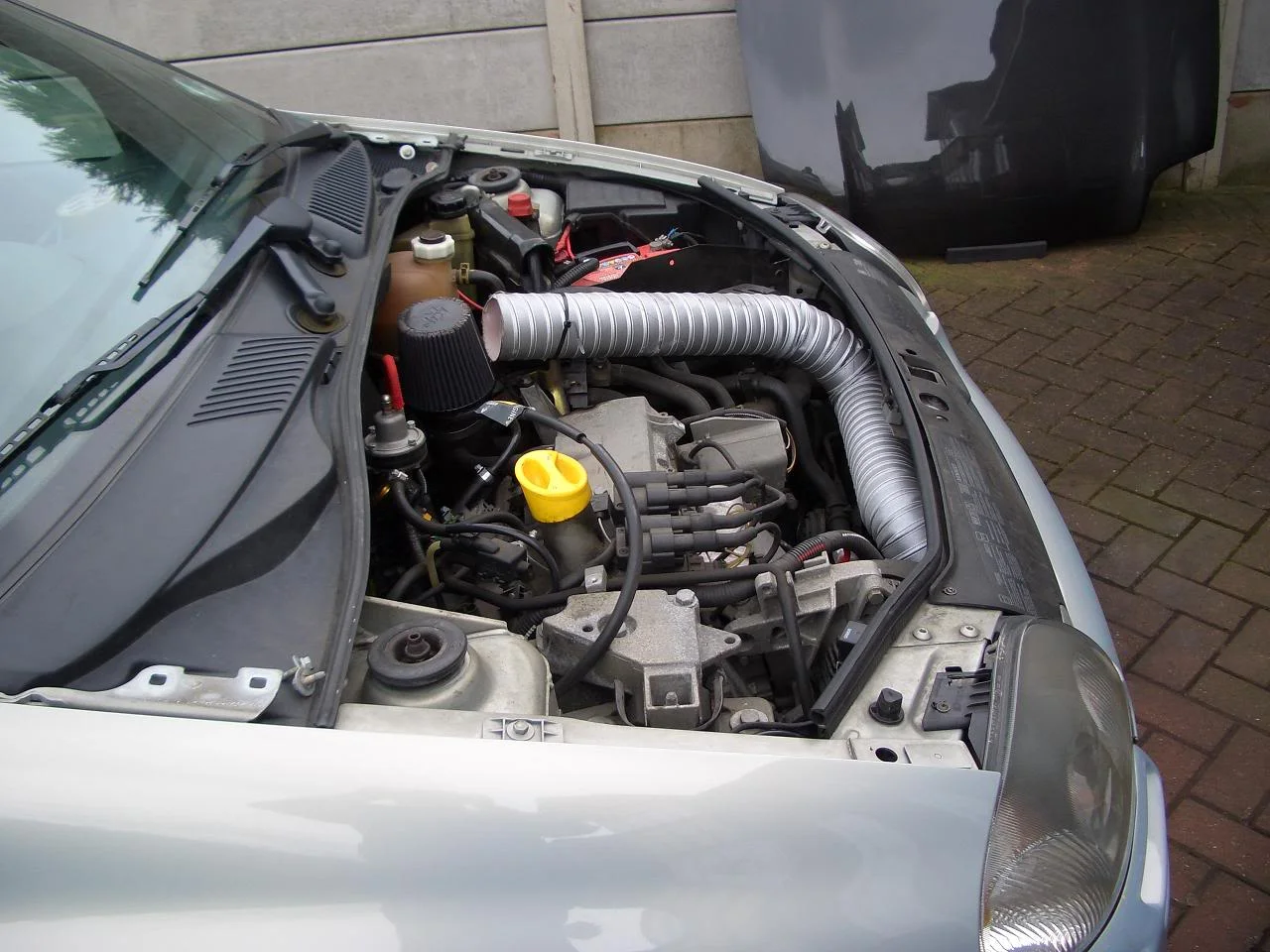

heres mine, dont know where the bonnet went lol, if mitch posts a pic of his then you can see

Don't know where the bonnet got to - FPMSL!!
