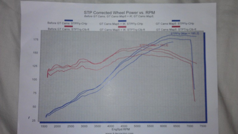

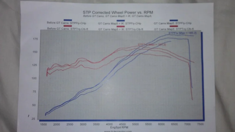

I am one of these 'someone's. tank is the other one. We had 438's fitted, with cams but without induction it ran 186bhp, with k-Tec induction prototype and mapping (with the cams) again to suit, it ran 197 bhp. Tanks ran 203 bhp.

Tried the new Ktec induction the other day. Made over 7bhp difference from a ph1 airbox, and an average of 5bhp over the entire rev range. Also tried a maxogen and it gained slightly less

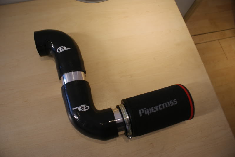

Seems £60 can build you something pretty cool -
Exactly this, level of stupidity on this forum is slowly going up. People paying a premium for a KTec name on stuff when it can be made your self for less than half price!
For the last ten years nobody has made any decent gains from a filter, most were said to then found out they didn't, I imagine this is no different.
Although prove me wrong I'd love to see a comparison between a few again now there are new methods around.
As for this funnel inside the filter that only adds an extra £10 to the cost, can easily be made up.
