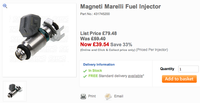

I got my injector from euro car parts and it was made by the same company as the genuine renault ones (magnelli Martelli) or whatever there called
Eurocar parts supply Genuine Renault injectors which are made by Magneti Marelli. (IWP 0042)
These can also be bought new from Renparts from there ebay store
