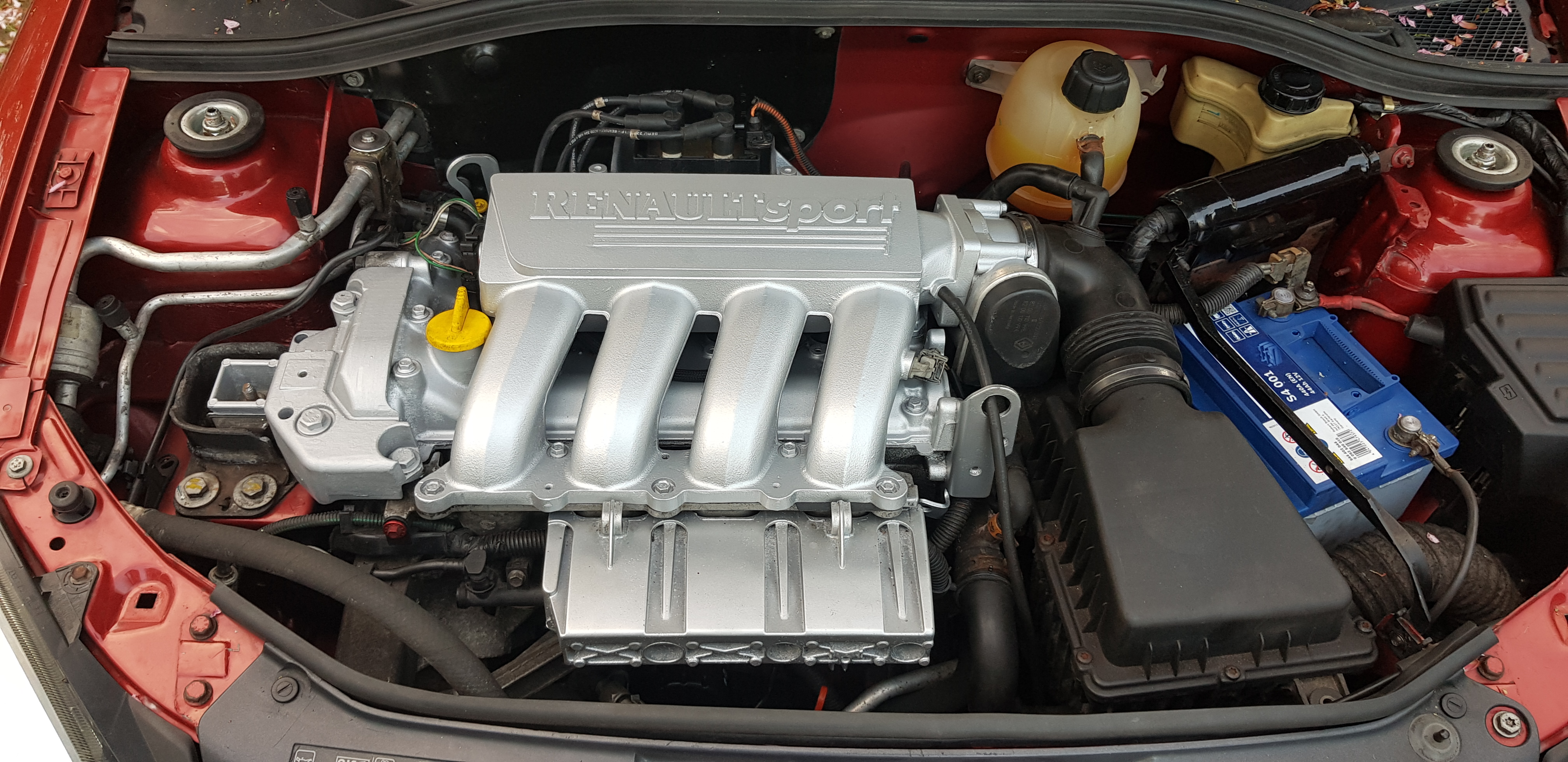

I used Hamerite Smoothite on my inlet, looks as good as the day I did it 2 years ago
DomP182
  ph1 172, Arctic182
