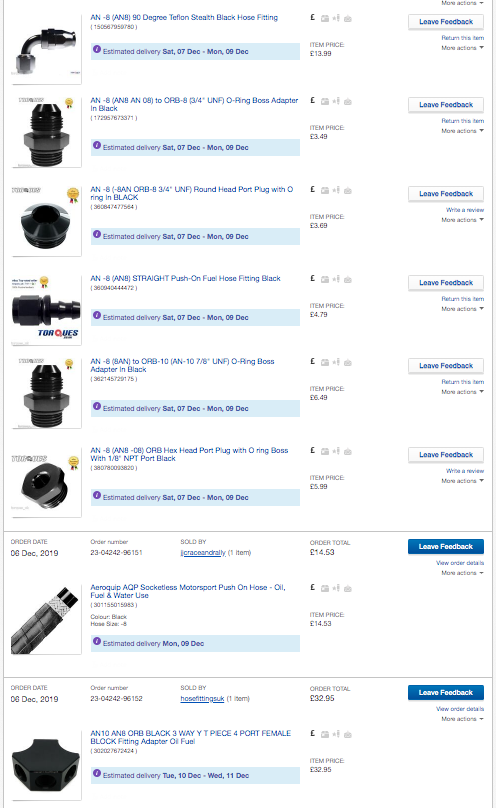

Managed to find a t piece with lugs to bolt to a bracket, just needed to search for all the correct fittings, should be nice and neat. Still to order gauge and sensor but deciding on gauges.

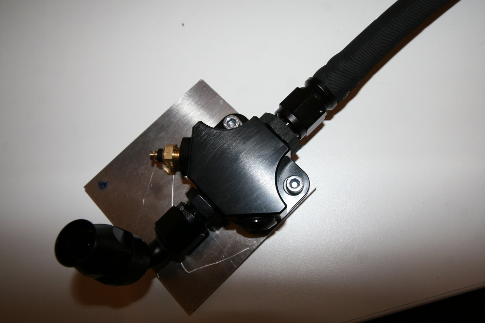

This is what I was trying to make, was about to trim the plate around the block and then just fasten to under the rez bottle. Well It will come in handy for something Im sure
