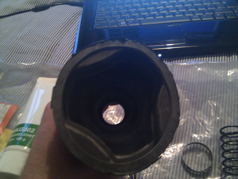

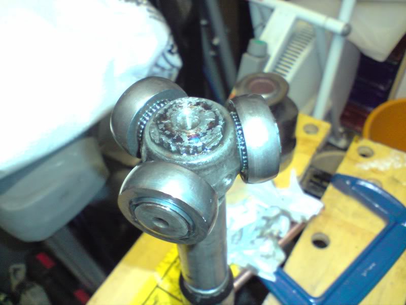

I'm changing my inner drivers CV boot.
i can't remove the the tripod on the shaft. i thought they were held on using clip but mine is isn't it seem to be wedges.
has any got a clue on how to get it off.
also are the boots Renault only because the one I got from the local factors and it attaches on the out part of the joint whilst the valver one attaches on the inside using a retaining ring.
you can just see it in the pic, sorry for the rubbish pics just wouldn't come out properly

the end of the shaft is peened over to retain the spider. Probably have to carefully grind the peened part. DON'T get it hot or you'll weaken the hardened splines of the shaft.
The boot on some shafts (mine for sure) is a sealed unit, and not available from renault, new shaft only

thanks i think its time for a new shaft then, far to much ball ache for a cv boot.
if iwas to remove the tripod using a grinder as suggested how would i reattach it.

Id say new shaft too - a lot less hassle! My tripod thing had a circlip then just tapped it off gently, came off really easy. 172 shaft though so probably different.
