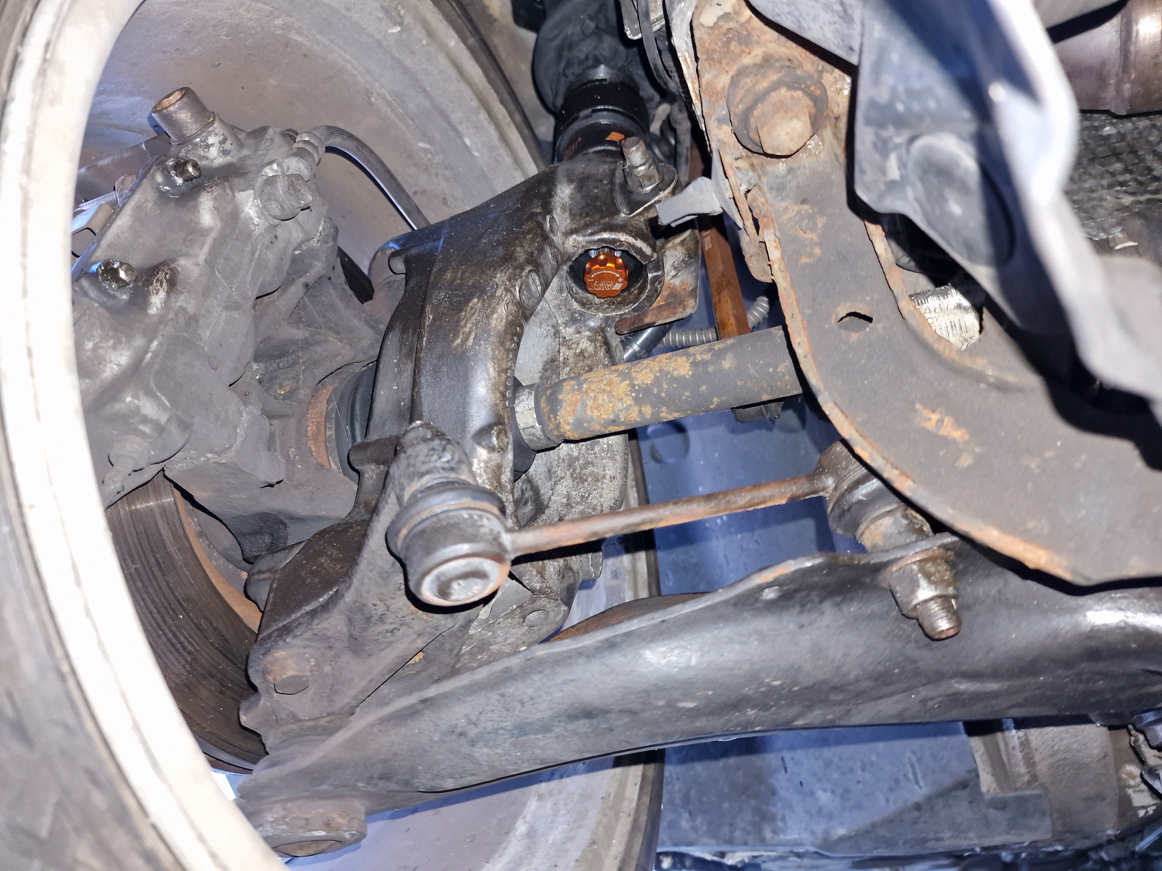

So usually I use the boot clamps in picture 1, but I have absolutely no clearance on my Megane 225 cv joints so need the most slimline clamps I can get. I had to use a metal cable tie type like pic 2 as its all I had to hand.

Every time I tried hammering them down they loosened off on me. There's barely anything. Like using those type clamps it was hitting the hub and undoing itself

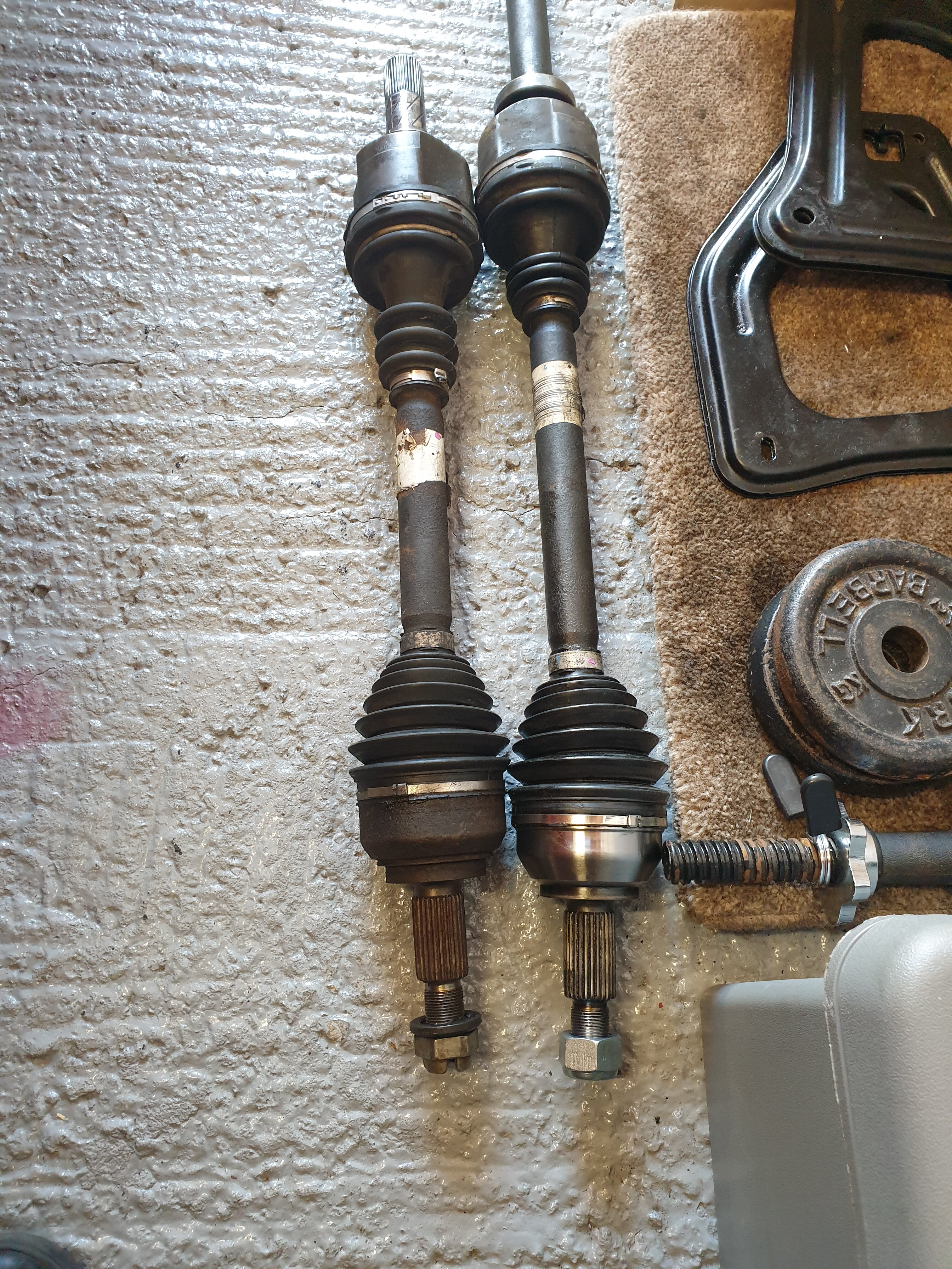

I managed to get away with the j&r cv joint/boot but like I said, they supply the wrong clip that fouls. So il order some of these style clips to do the other side
