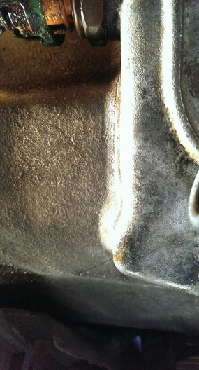

The frustrating thing is, I know my box is good if not for the crack in the main box housing :(
I'll chuck it on and take my chances before stripping the old one down to have the casing welded.

Honestly mate it's just a suck it and see situation unfortunately. Wheres the crack in the casing mate? Any ideas what caused it?

Runs from up along side what I presume is the reverse switch and down along the bottom of the casing
Not sure what caused it. Theres the odd scuff and scrape, so I guessed it was probably an impact of some kind.
That said, I tried a temp bodge with Chemical metal and the chemical metal has cracked in the same place, so there must be some load on it.

Is it the box with a bolted in diff by any chance?

Do you mean a 130, ie. 182 box? I think that was what they did with the 182 to stop the diff circlip issue?
If so, yes.

Not all 130's are the bolt in diff mate I don't think. I've seen a few where the bolt from the bolt in section has come out and gone inside the box. It gets in between the gears/shafts and forces them apart, a la, split casing.
I'll have a look at that.
The box has had a lot of abuse since the new suspension - lower to the ground, more vibration, not to mention the drive shafts hitting the chassis legs (just as you warned me :p )

It's worth a look when the box is out mate for sure.
