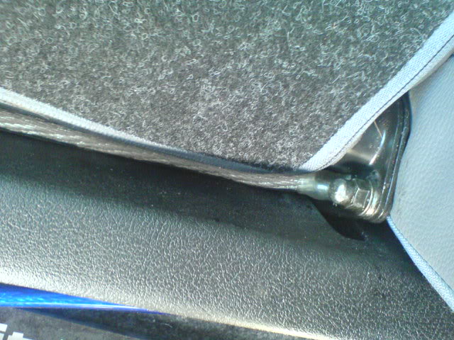

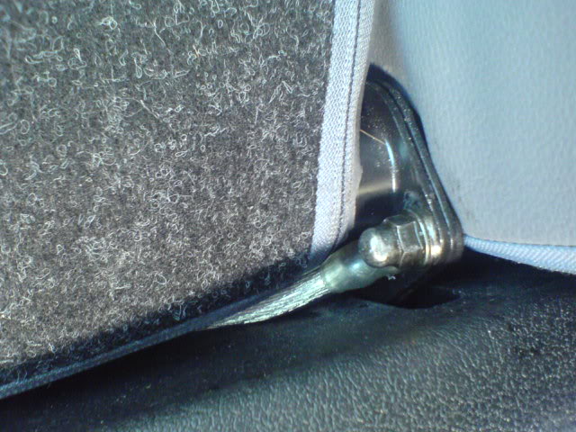

So, earthing to a seat bracket, interesting.....I like the threaded hole in the rear panel.....

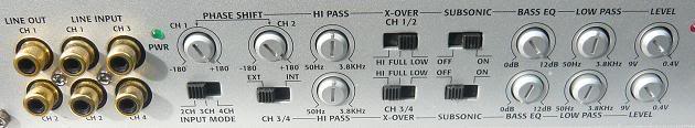

RCA leads into Ch 1 & Ch 2......LINE INPUT
Phase shift, both central or zero degrees.....
Input mode, 2 Channel.....
Ch3 & Ch 4 set switch to INT......
High pass, Both set to min, (50hz)
Crossovers, Both set to LP, (LOW).....
Subsonic, Depends on enclosure tuning.....(Sealed enclosure set to OFF)
Bass EQ, Set to min, (can adjust later if required)....
Low Pass, Both set to around 100hz to start, then adjust downwards to taste.....
Level, Both fully Anti-Clockwise to start......
THIS THREAD gives some basic info you may find useful....check out post number 3, gives a little basic info on amp setting up by ear......
Obviously your going to have to set your amp up twice, once for each sub, but the basics are the same.......

OMG OMG OMG that is really bad!!!!!!!!!!!!
What a sh*te earth!!!! whos is that???? :S

Err, that would be my earth which, by the sounds of it, isn't any good.
Where would you suggest putting it, and can I just pull it off and move it somewhere else without disconnecting the rest of it?
  182
Just run it under the boot lining up to the thumb screw that holds the rear light cluster on. Unscrew the thumb screw, place it through the eye on the cable, and screw it back in, bobs your uncle, mine worked like that, altho i did take it apart again, and scratch some paint off!!
Have fun!
