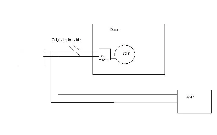

It does, wire the crossovers door side (either inside or outside the card). The speaker cable is still in place which can be amped at the head unit.
Ah thanks,
But I also need to attach the tweeters to the crossover, and if the crossovers are in the door that means I still have to get wire from the dash tweeters through to the crossovers in the door?

You should also find the tweeter cables inside the door panel to the main speakers.
