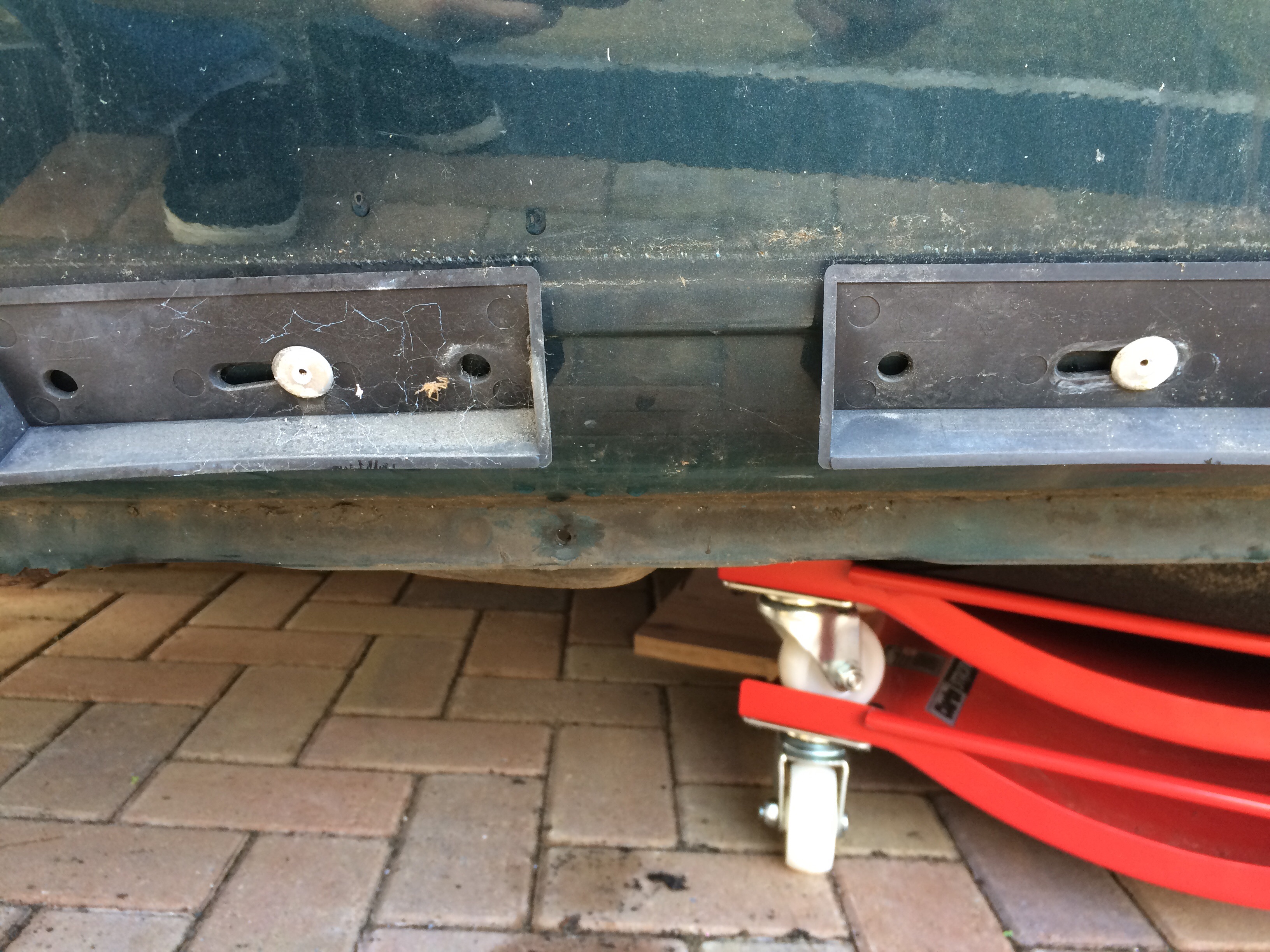

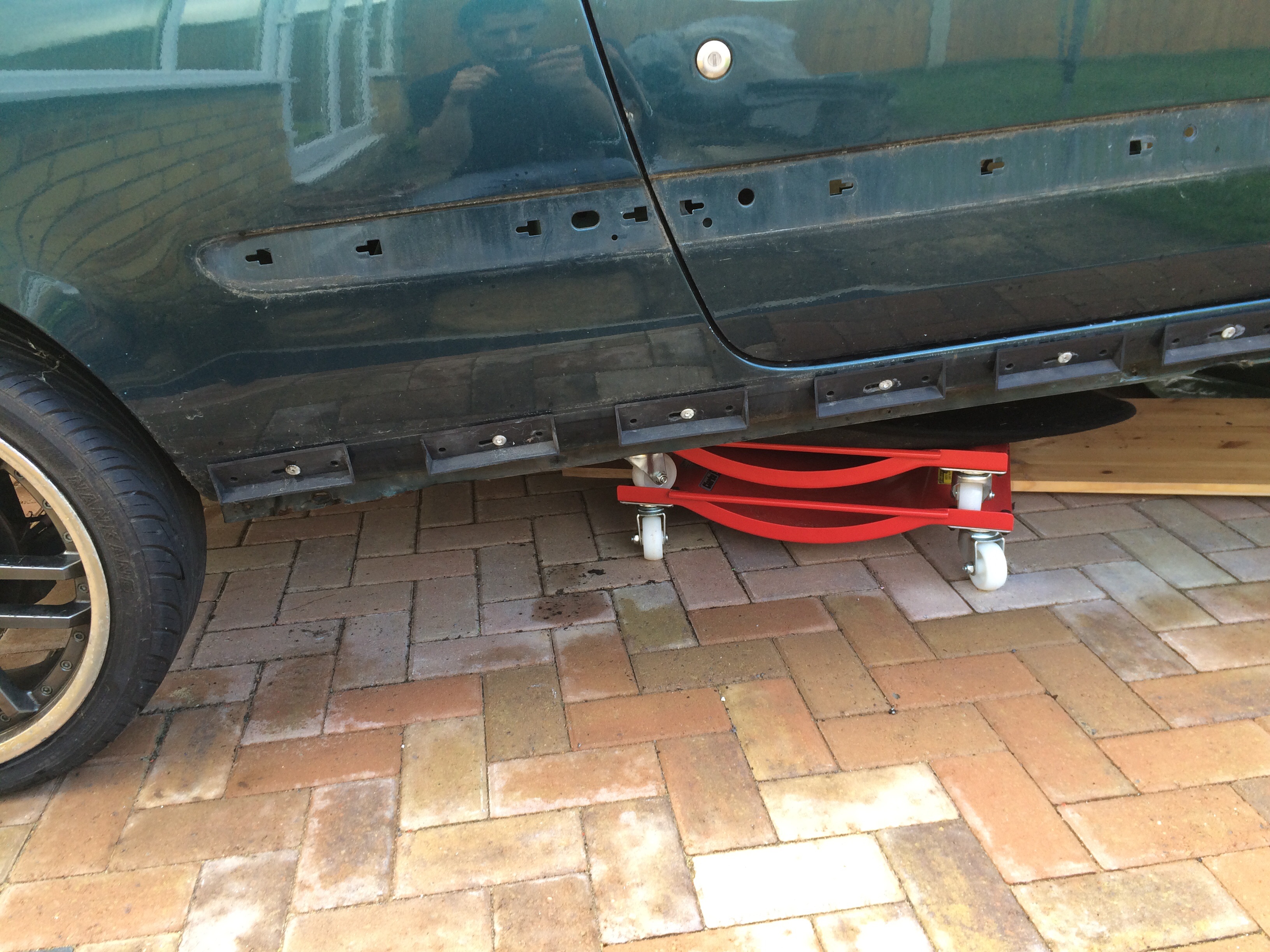

Basically the skirt is held on at the top by slotting the top lip of the skirt over a series of brackets (will get pics in a sec).use pop rivets to secure these brackets.
Anyways, these brackets do the job of lining up the skirt. You may have to use some blutac to test mount it. The skirt is then fully fixed to the sill by a line of pop rivets on the "jacking sill". You can use pop rivets to secure this. And you're done.
The rivets on the brackets will be protected from most weather. The rivets on the bottom will stay good long after the jacking sill has turned to rubber

The body work shouldn't rust. You can put copper grease on the rivets before fitting them for peace of mind. But the holes are so small that if there was rust it would be insignificant. But a thin line of sealant on the top contact point of the skirt will suffice.
Drill them out from the centre. The head will come off with the drill bit but the rest will be lost on the other side so make sure you test fit.
It's hard to make mistakes with the sport skirts as there is grooves on the wings and the ottom edge should line up with the jack sill.
