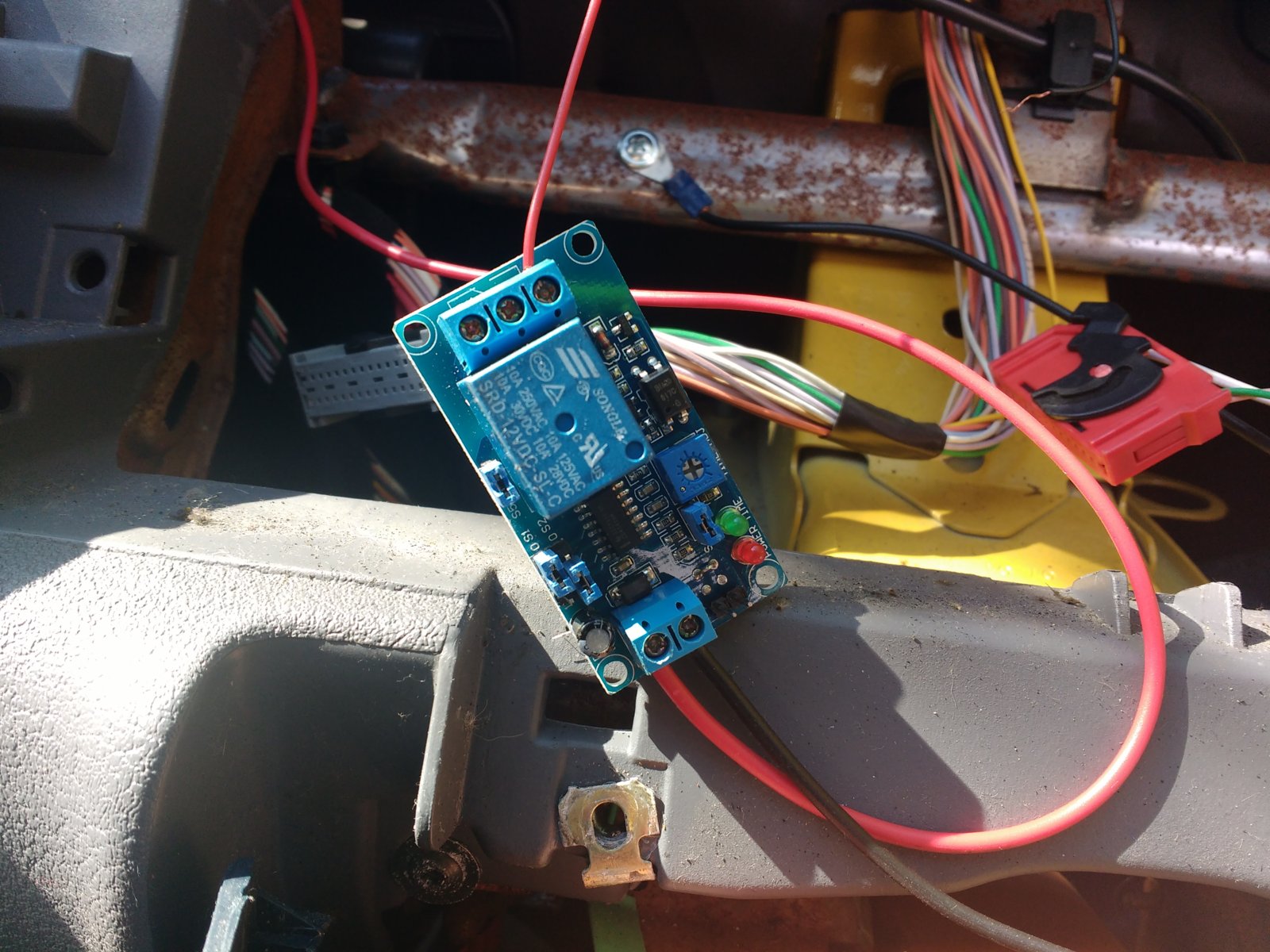

I discovered this witchcraft hidden beneath/hotwired into my speedo yesterday.

Correct me if i'm wrong, but i'm pretty sure that wires aren't supposed to go straight into the speedo assembly through a gap at the bottom. After disconnecting it cluster.exe stopped responding so I think the red and black wires have been pilfered from the loom/main connectors somewhere.

Where should the ground and positive wires for the clocks actually live?? Atm I'm thinking they belong in the orange connector but I have no idea which pins. Bonus points if you know what this box is and can confirm i'm not being tracked by MI5 or Aliens.
The big blue thing is a relay of some kind - there's a 5v version also:
Other than that, I am no use here whatsoever :p
Can you trace where all the wires go?
  Clio Mk2 Ph1 1.2 16v
Well at least i can rule out aliens :D The earth seems like it belongs there (although the ring connector reeks of Halfrauds) and the positive disappears somewhere into dashboard removal land.

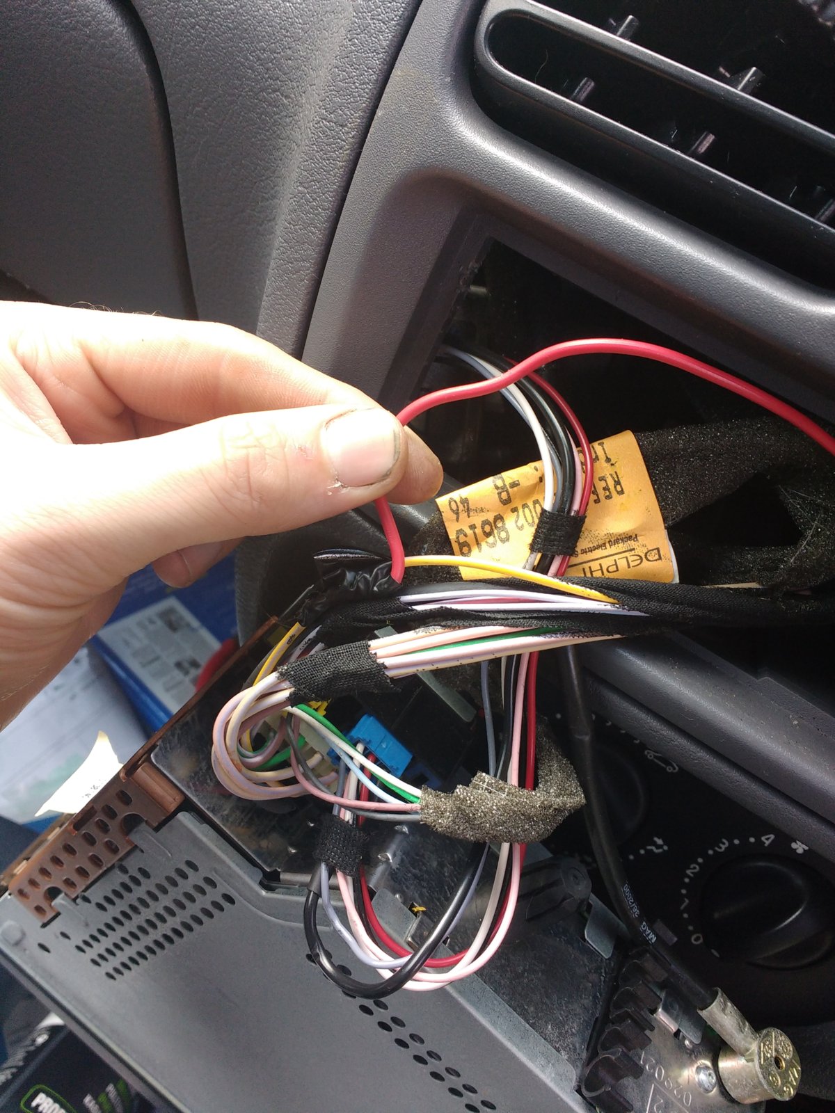

Minor update: I found out that the thing was wired into the radio using electrical tape for whatever reason:
1420484
Bought a new instrument cluster and it's absolutely unresponsive. I swear I am going to John Wick all the previous owners of this car...
